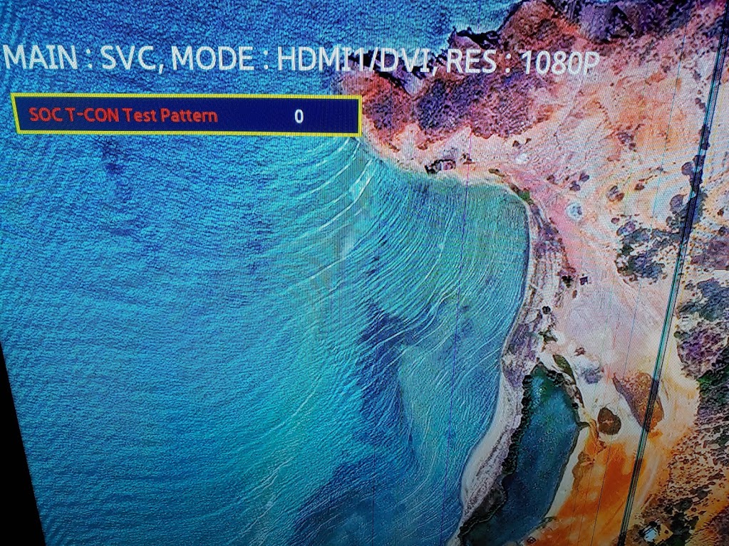

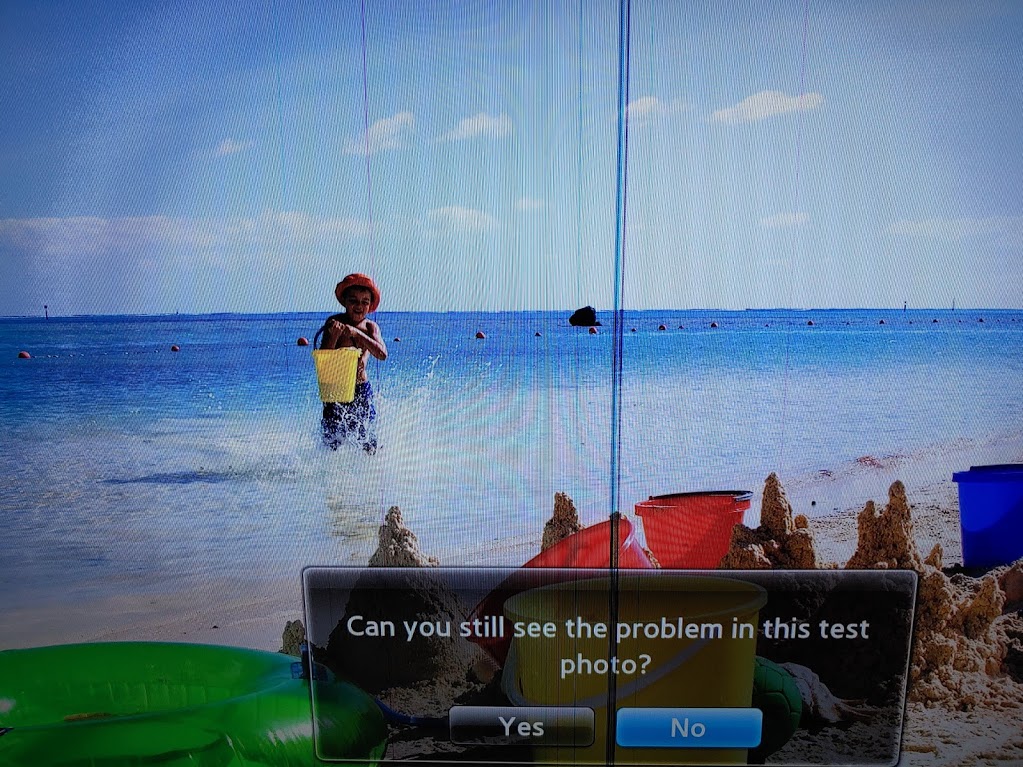

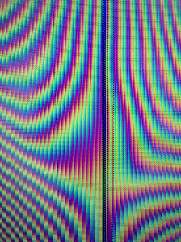

    I have one thick vertical line right in the middle, along with a few smaller lines about 1 px wide of various colors.

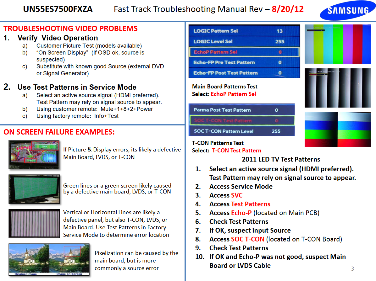

    I understand that this is most likely a defective panel? But wanted to rule out a bad tcon or LVDS cable just to be sure there's no hope before tossing it. I've read that this model has a built in tcon test pattern accessible via the service menu, but I wasn't able to see any difference on screen while scrolling through 0-18 of the patterns, unlike the mainboard test patterns.
    My question is: is the screen supposed to change when viewing built in tcon test patterns? If not, how do I verify if the tcon is good or not in this case? I've already tried reseating and shifting the 4 ribbon cables between the panel and tcon around.
    Photos attached of the symptoms. I followed the service instructions in the slide below, but got stuck at the tcon test patterns.

    Re: Vertical lines on a Samsung UN60ES8000 - salvageable or bad panel?
    Bad panel. Sony Tcon training manual pg 39

      I've read suggestions online to heat up the edges near the tab bonding boards and apply pressure. Is this worth a try, or is the panel just toast?

        This guy had a bad solder joint on one little resistor: https://www.youtube.com/watch?v=Jsbw5wroTRM
          New user here... I've done this in the past with about 50% success; sometimes
          it kills the entire panel. If you're willing to take that risk you have nothing to lose by trying... Good Luck!
