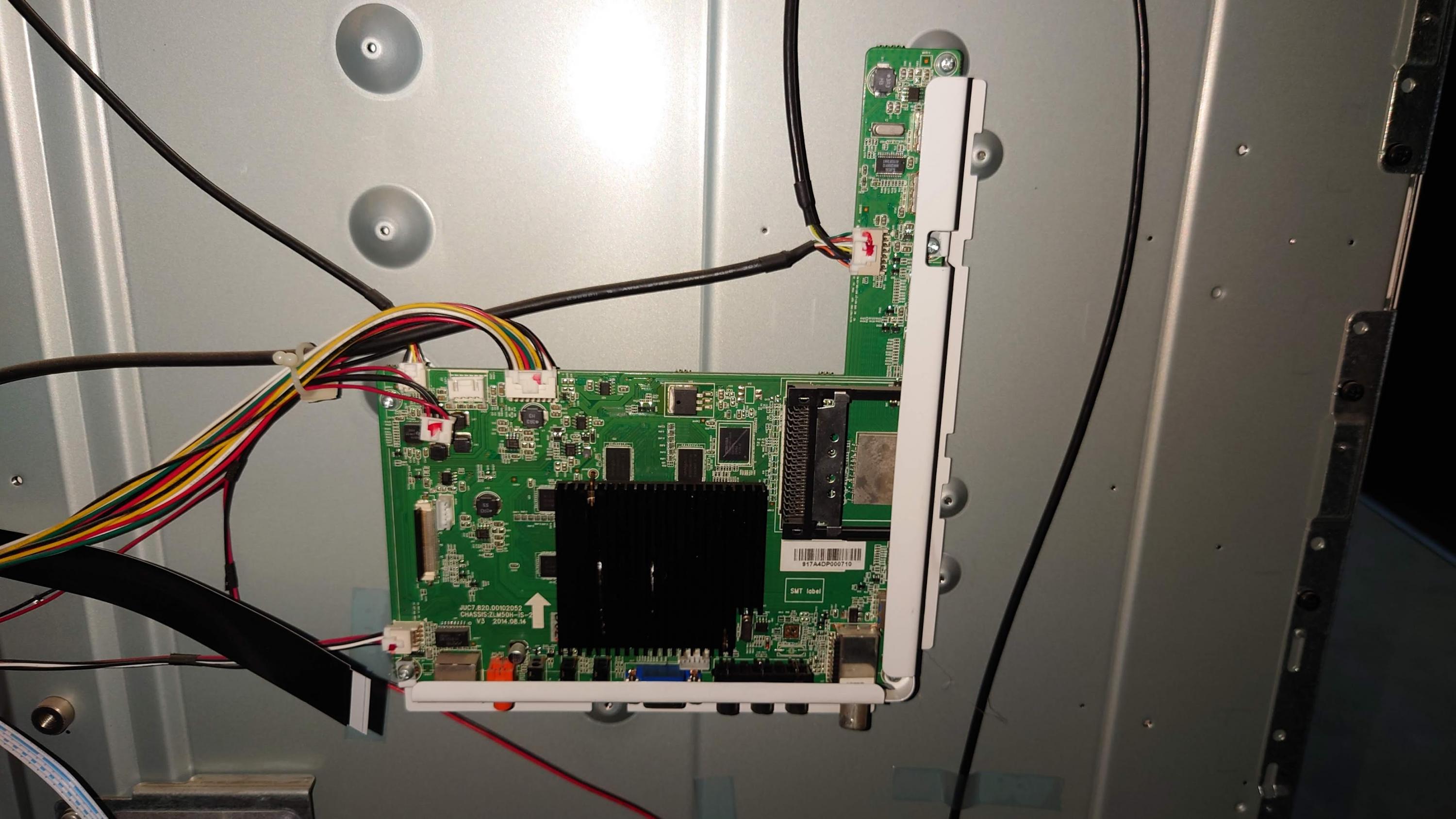

    Hi all
    Looking for some urgent help
    I have a JVC (Changhong) 65" TV and the Android board has gone faulty to what is believed due to a power surge.
    The TV comes on with the JVC logo and power light at the bottom, but the board does not boot into android.
    I therefore need a full replacement of this board, one which I found on Ali Express, but upon receiving the item, realized it's for a 42" variant of the TV and not working on the 65" panel.
    In South Africa the TV is assembled as JVC, but seems in the east it also trades as Chanhong as well as MicroMax.
    This was the one I bought from Ali Express ... but did not work.
    I have attached an image of the board and herewith the specs on the board as well and also a link to the (non-working) one I ordered but not working.
    Model No: JVC 65" 3D Smart TV LT-65NU45
    Board No: JUC7.820.00102052
    Other Info: 65Q1N
    CHASSIS: ZLM50H-iS-2
    V3 2014.08.14
    Is there any other forums or places you know of that I can try an source this board, please?

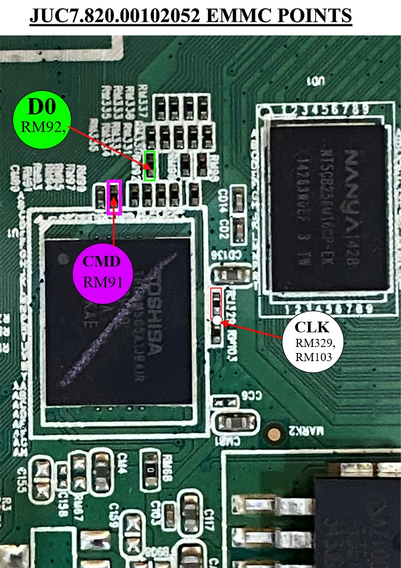

    I am stuck with the problem you encountered on the same JVC model. I had saved EMMC data from another board (Condition unknown). I tried to write but when i finished it is still stuck on JVC logo.
    Did you find a solution, please kindly help if you did.

        Can "Electronic Centre" explain how he downloads the EMMC data of the chip. It would really help to know what the procedure is. Currently i use a eprom programmer to read eproms from those all in one boards used in Sinotec, hisense etc. Those 25Q32BVSIG chips, i think 4MB download size. Perhaps a photo explaining what the EMMC chip looks like?

          I am using RT809H for read and write of EMMC. I have attached the points _ d0, cmd & CLK.

                              Ok, thanks - please ignore my lack of technical understanding, but when I get the EMMC Data, would I need to remove a certain chip off the board, program it, and put it back on?
                              Or, can I take the board to a TV repair shop and get them to "program" it with some sort of cables without the need to take components off?
                              Regards
                              Dave
                              • angelos
                                • Dec 2012
                                • 573
                                • South Africa
                                Re: JVC / Changhong 65" Replacement Motherboard (android)
                                I think you solder the three wires namely cmd, D0 and CLK from the RT809H programmer directly onto the board and read or write the chip. This is my understanding from this thread.
