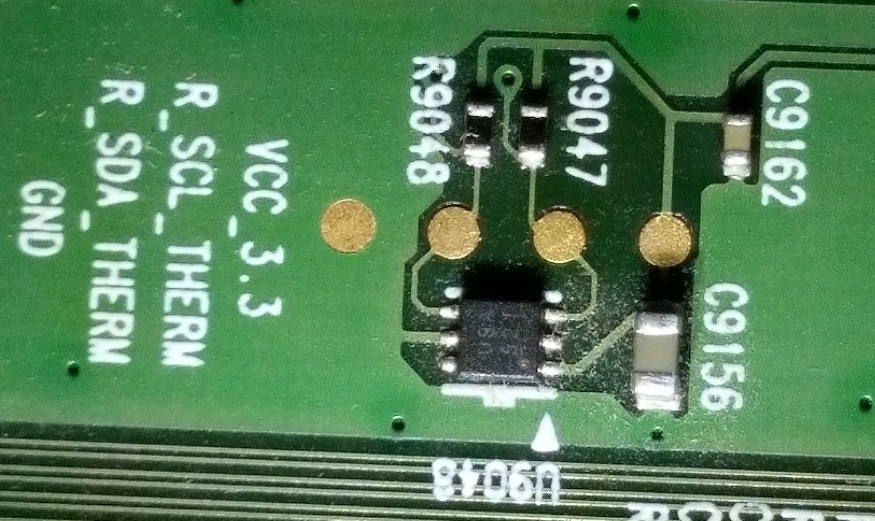

                              #74
                              Re: Sony OLED XBR65A8G no video, PSU problem?
                              Originally posted by flusher
                              with your found the T-CON already shutdown. but you trick the MB to keep on.

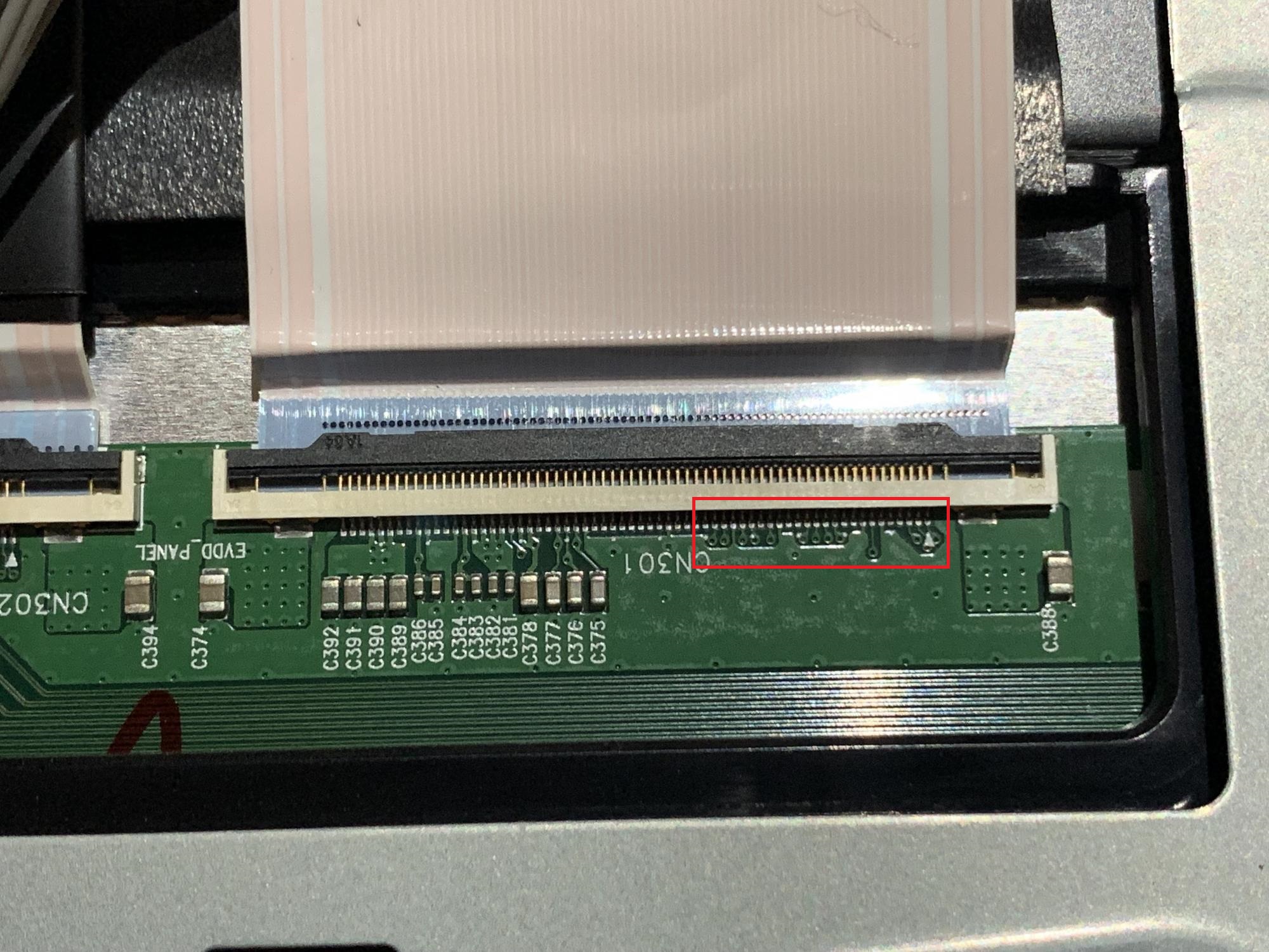

                              on the Panel Module buffer boards there are only 1 8-pin IC on each side.
                              their SDA and SCL connected to the ribbon socket (1 at Left side and 4 on the R side ) L&R we talking now as you look to the TV from front display.
                              i don't know which protocol they communicated with t_CON but i think its I2C, and of sure the BOTH are SLAVE and as you can see from the photos they are the Thermal Shutdown Protection. you may find on T-CON the MASTER
                              the location of this SDA/ SCL pins of the ribbon socket are at the middle in my case and they are one beside other.

                                #75
                                So for you it just worked to mask those pins so the slaves ics wont report errors?
                                How can i reach full buffer board without damaging the housing? Is it possible?

                                  #76
                                  i used bread knife after i heat it by flame. you can try first the hide 2-3 pins at the middle of the effected side socket other wise i think you have on T-CON chip EVSS.
