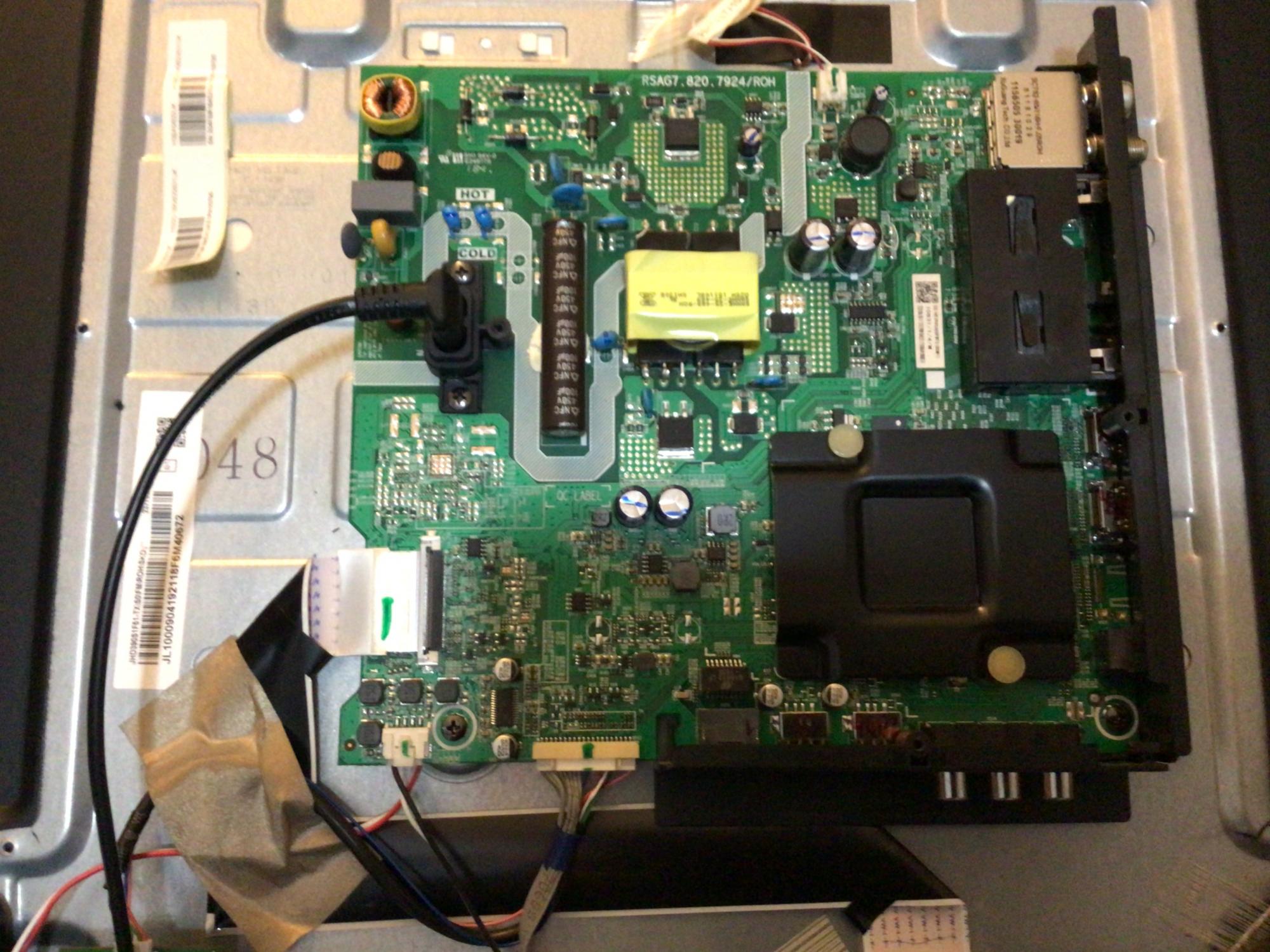

    Right I have a HISENSE H39A5600Uk it has an issue of boot looping
    Screen displays “HISENSE then an animated VIDAA” then repeatedly does this between HISENSE and vidaa showing the red standby light flashes,
    I called Hisense “customer services” and explained everything and fell at the first hurdle when he asked for proof of purchase which I don’t have, so he would not entertain me any further
    So I’m here asking for help
    Note: I have tried it with screen, WiFi board, and backlights unplugged
    Any help will be appreciated

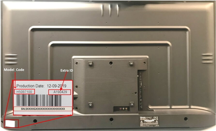

            • Diah
              • Feb 2013
              • 6376
              Re: Hisense h39a5600uk

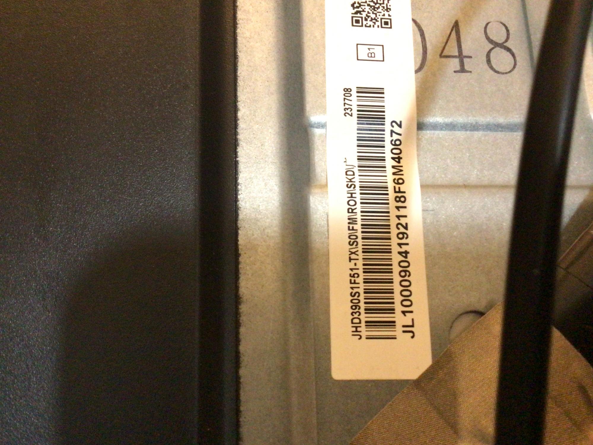

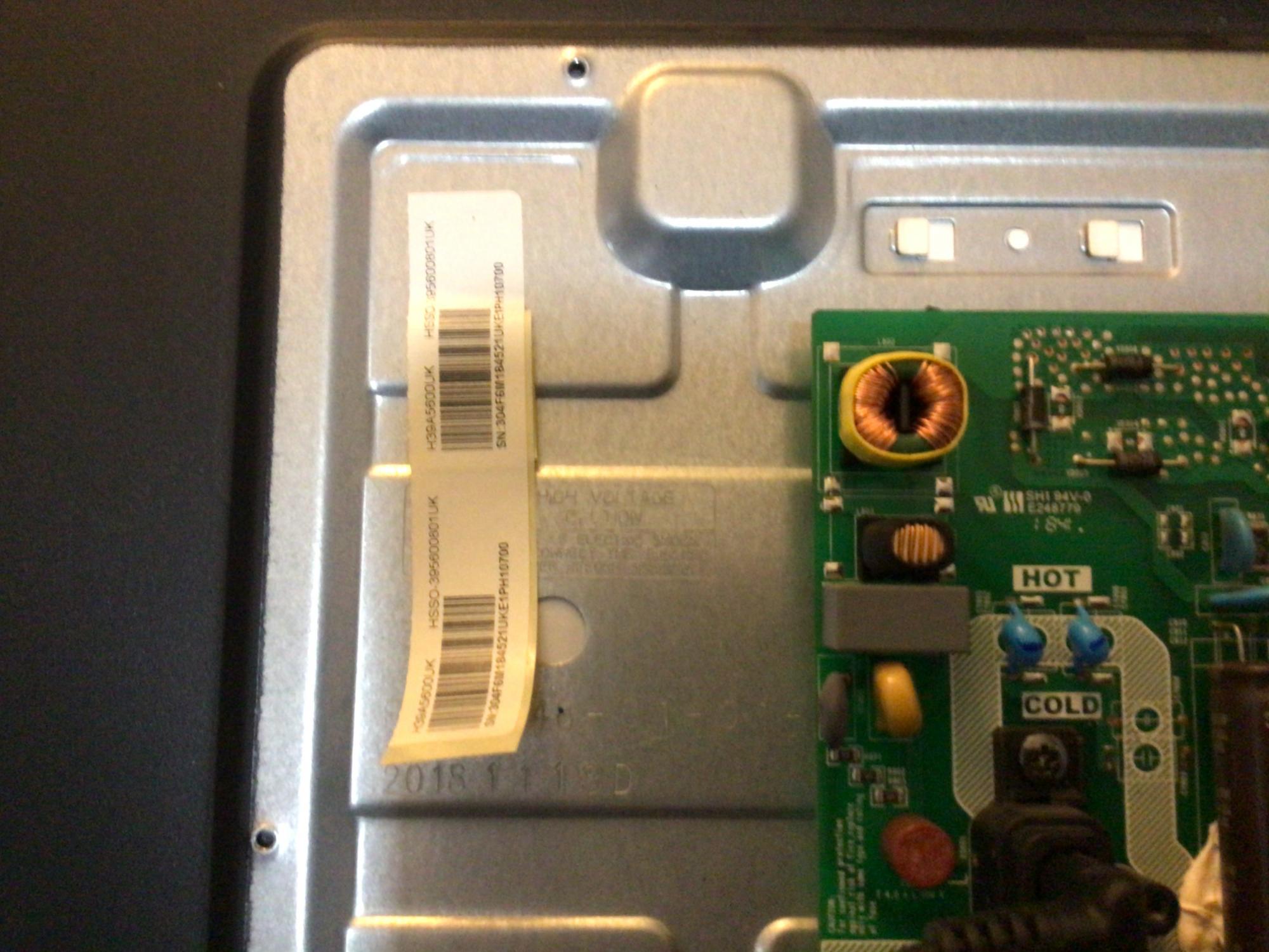

              write down here yours set extra ID see photo

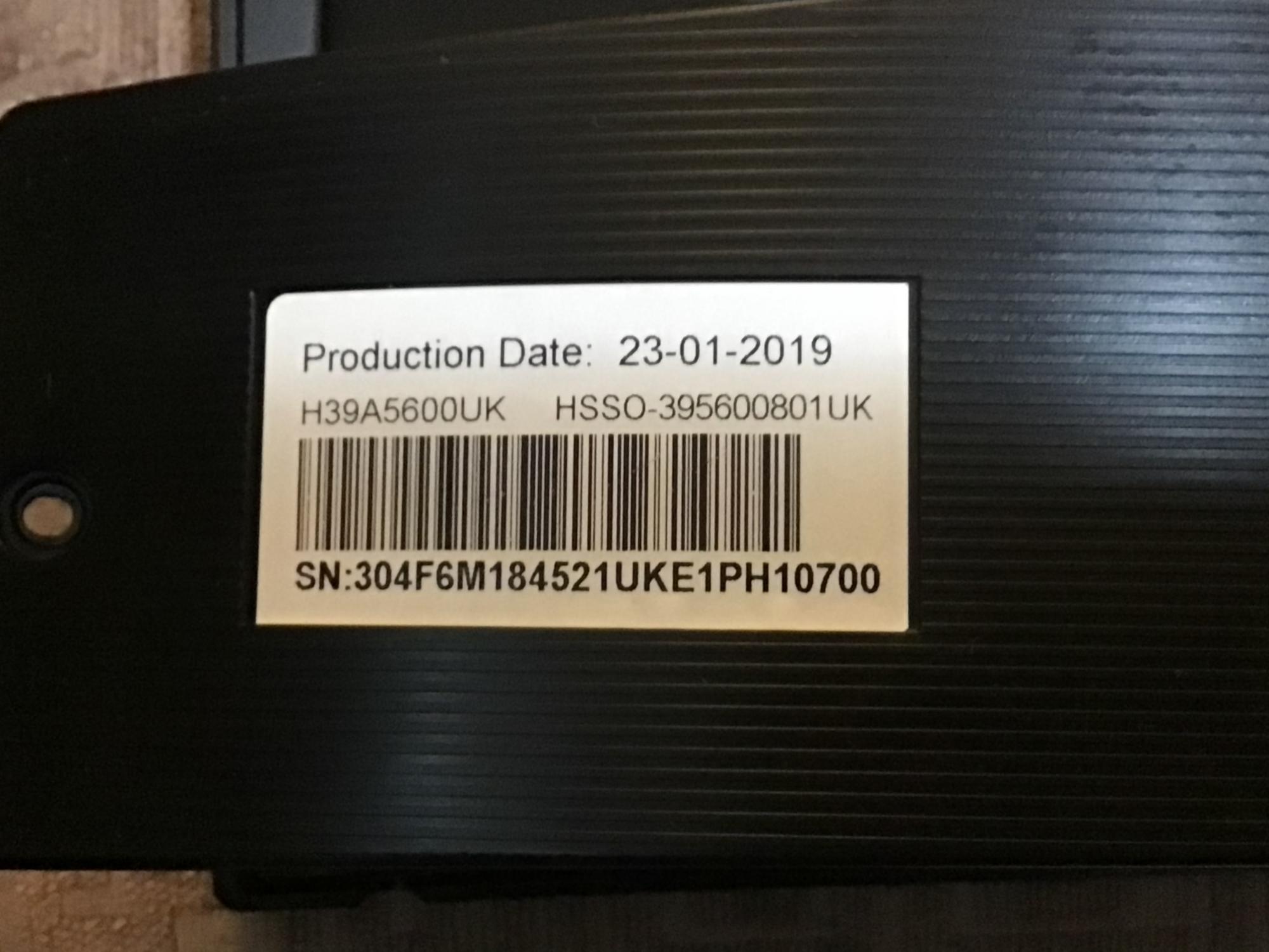

                Hi Diah
                HSSO-39600801UK

                  extra ID not HSSO see the photo i attached.. its small label on the cover
                    Hi this is the label

                      hmmm, funny hisense as always.. i know they are hiding this type of TV because its sold under other name in south america
                      this the link i was trying
                      go down and click on TELECHARGEMENTS

                        hi Diah no joy im afraid it comes up not valid when i put the hsso info in
