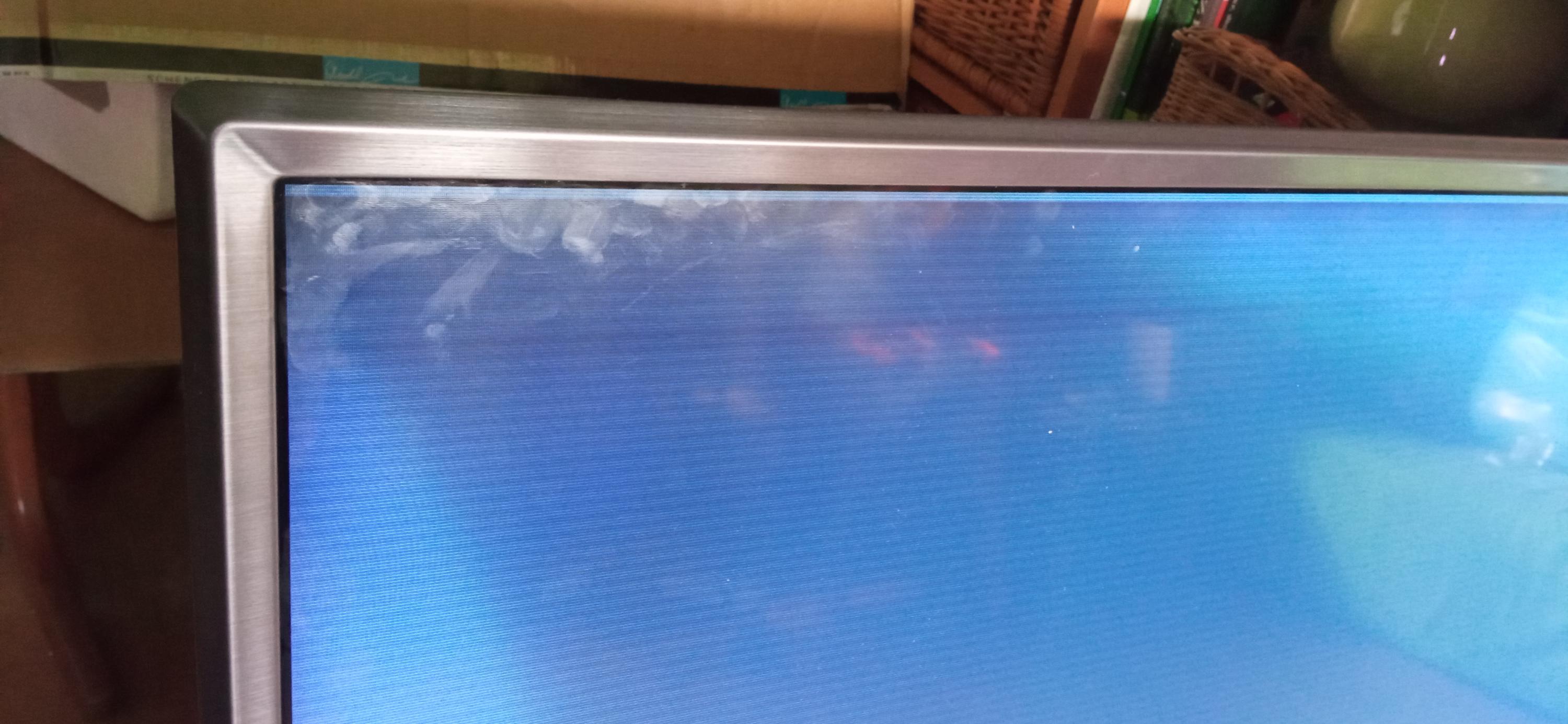

          I'm back, with some success

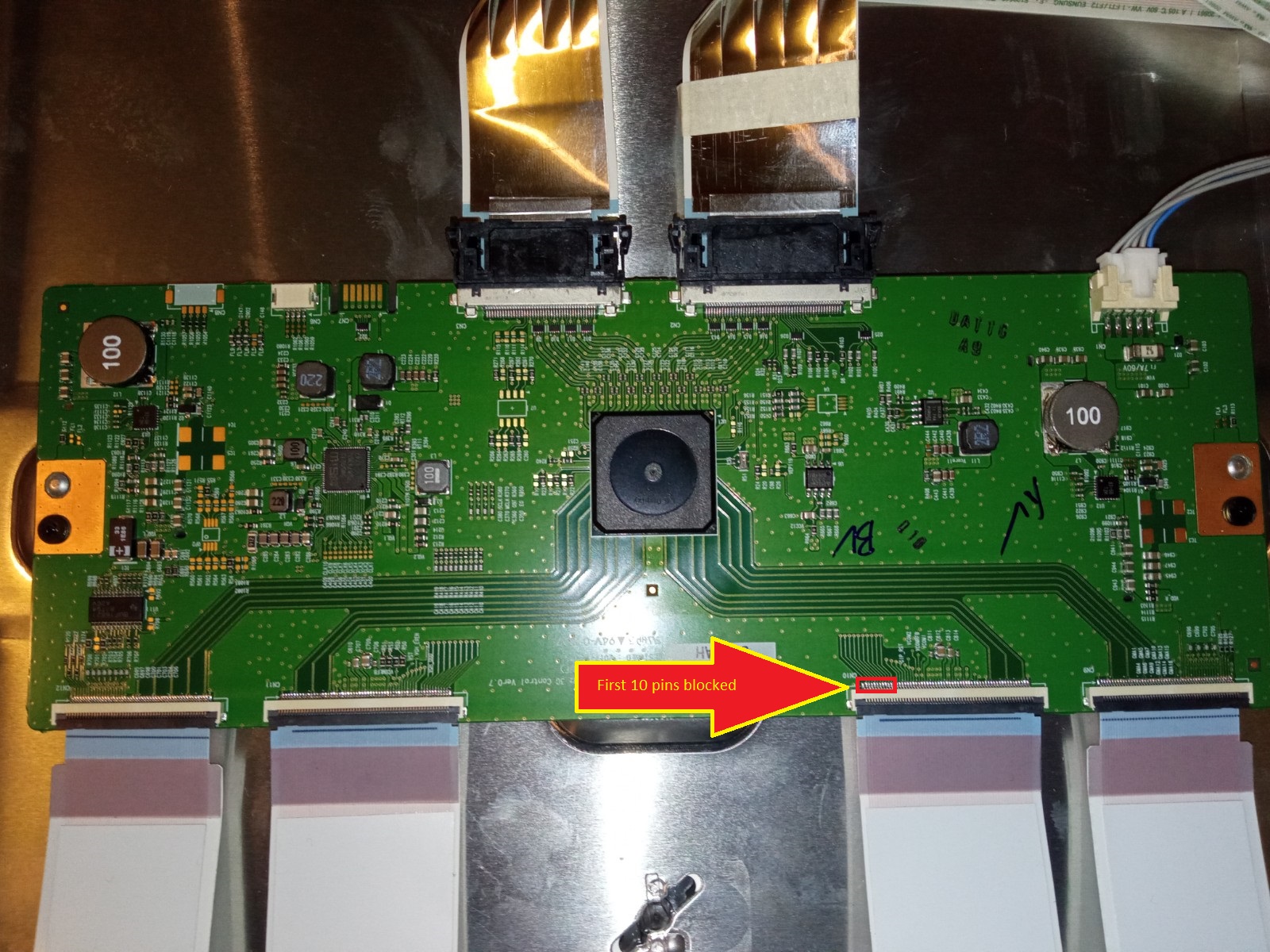

          I was able to run the LCD panel, so it doesn't stops anymore. What was done? I have blocked a error signal from the panel driver to the t-con board. With a scotch tape I blocked first 10 pins on the third ribbon, which connects the t-con and panel driver boards.

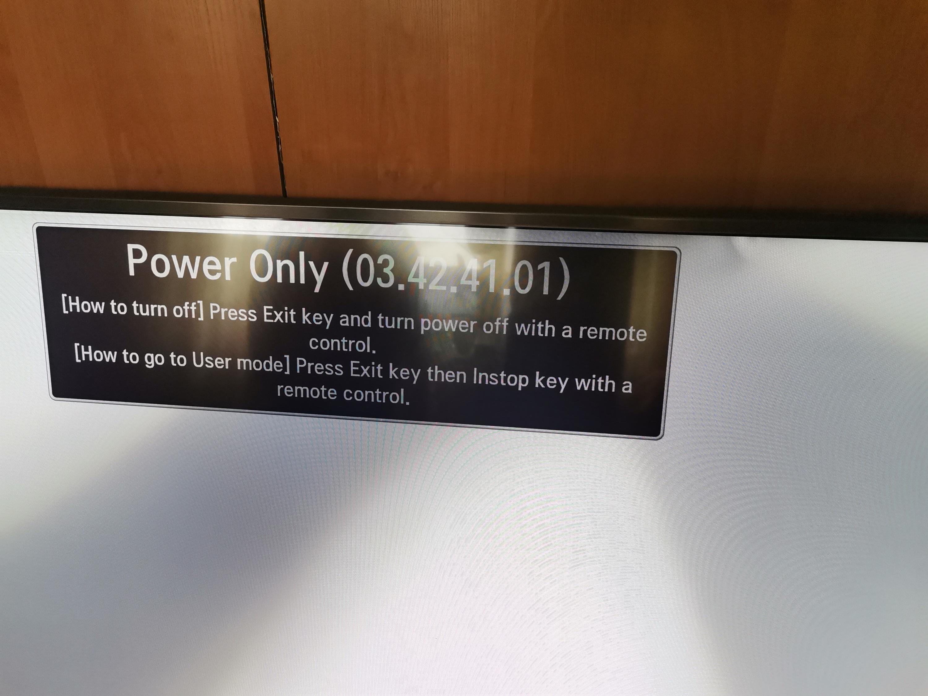

          TV started, but I had to reset it wit a service remote control, as it was in the power only mode, after my previous actions. I'm attaching the message that was shown by the TV in this state. It shows the software version and a short guide how to run it to the user menu. Now I have the picture from the external source (laptop with HDMI output).

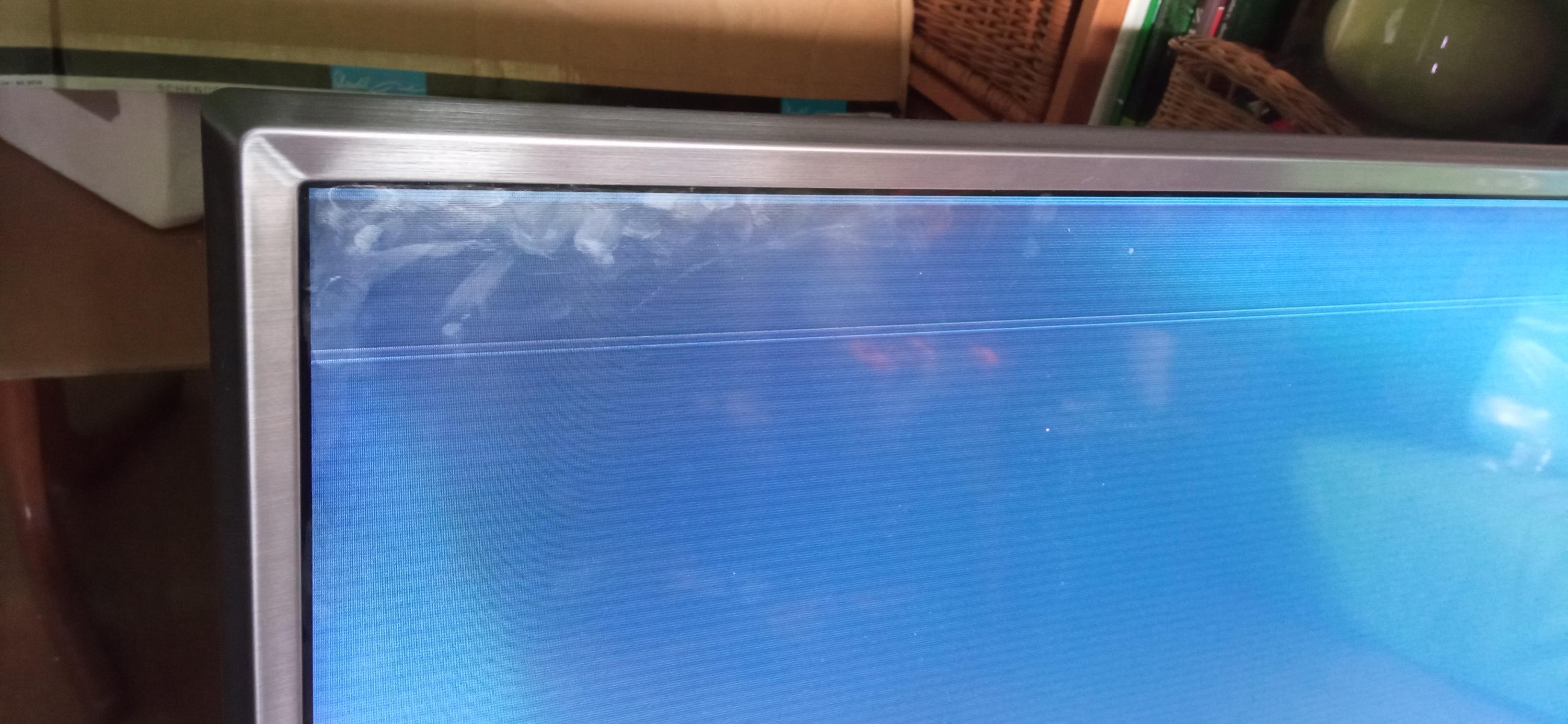

          Probably I can see now, why it goes to the protection mode. There is a blinking line at the top of the screen. I made a video, how it looks.
          So now I need your help guys. What should I try to check, to identify the root cause of this blinking line. The line is visible only on the bright background. With a Youtube menu, or when the black backgroud is displayes, all works fine.
            can you make remark of the 10 pins you blocked at T-CON ribbon on yours T-CON Photo

              Take a look at the attached picture. It seems that the most important is PIN-9. I realized that the VCC is lost, after a first 2-3 seconds, when the display boots up, and shows LG logo. On the 9-th PIN must be an error signal, because a signal appears on it, after the VCC goes to 0V. It was hard to mask only the one PIN, so i decided to mask a few first pins. After this trick, it started to work.
              Now the only problem is this blinking line. Any ideas how to start? Probably it may be a bad capacitor. You are more experienced, could you advice me what to do?
                so as you wrote pin 9 was active at time vcc cut off, so its sending SOS signal.. normally SOS signal will turn off the T-CON first. as i remember you wrote before you owned another T-CON, so with it trace the connectivity of this PIN9 if it goes to SPI/eeprom on T-CON via L or R

                        The problem is in the third driver so the U ribbon doesn't affect the display. When it is disconnected, than there is no picture on the display. The line which blinks is not broken from any sides. I will try to fix the masking, to disable only the 9th pin, to chceck if those vertical lines are show due to masking too mamy pins.
