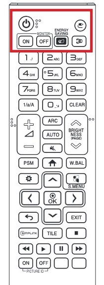

                                    #37
                                    Re: LG 86ul3e-t logo blinks and then nothing (but backlight stays on)
                                    did you took a look on yours monitor RC ? how it had function monitor ON OFF,, beside main power ??
                                    i encourage you to install SmartRemote.apk and choice TV ---LG write your model 86ul3e and choice the most model option.. beside the key platter the page and you will find all what you can use to turn on.
