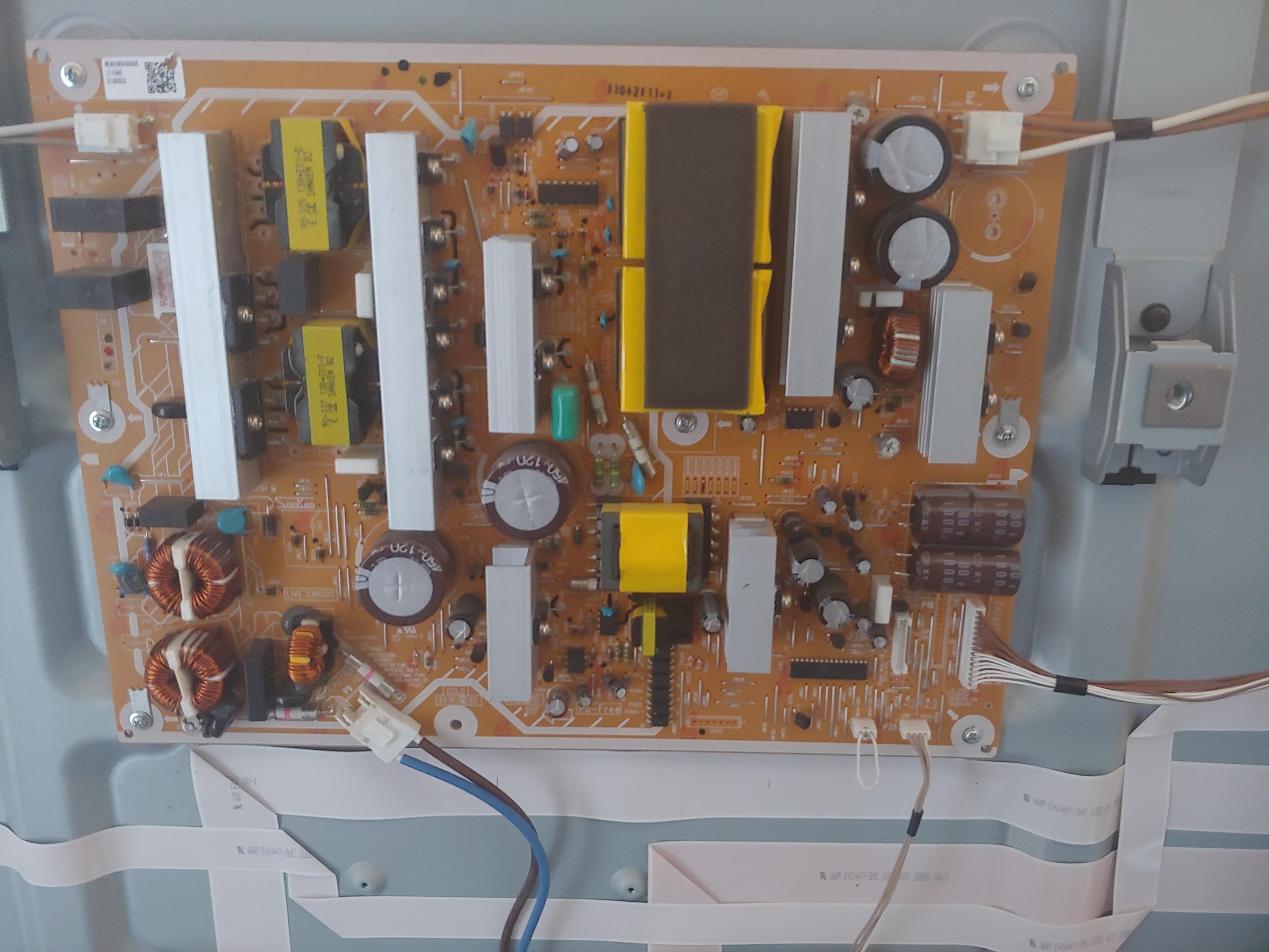

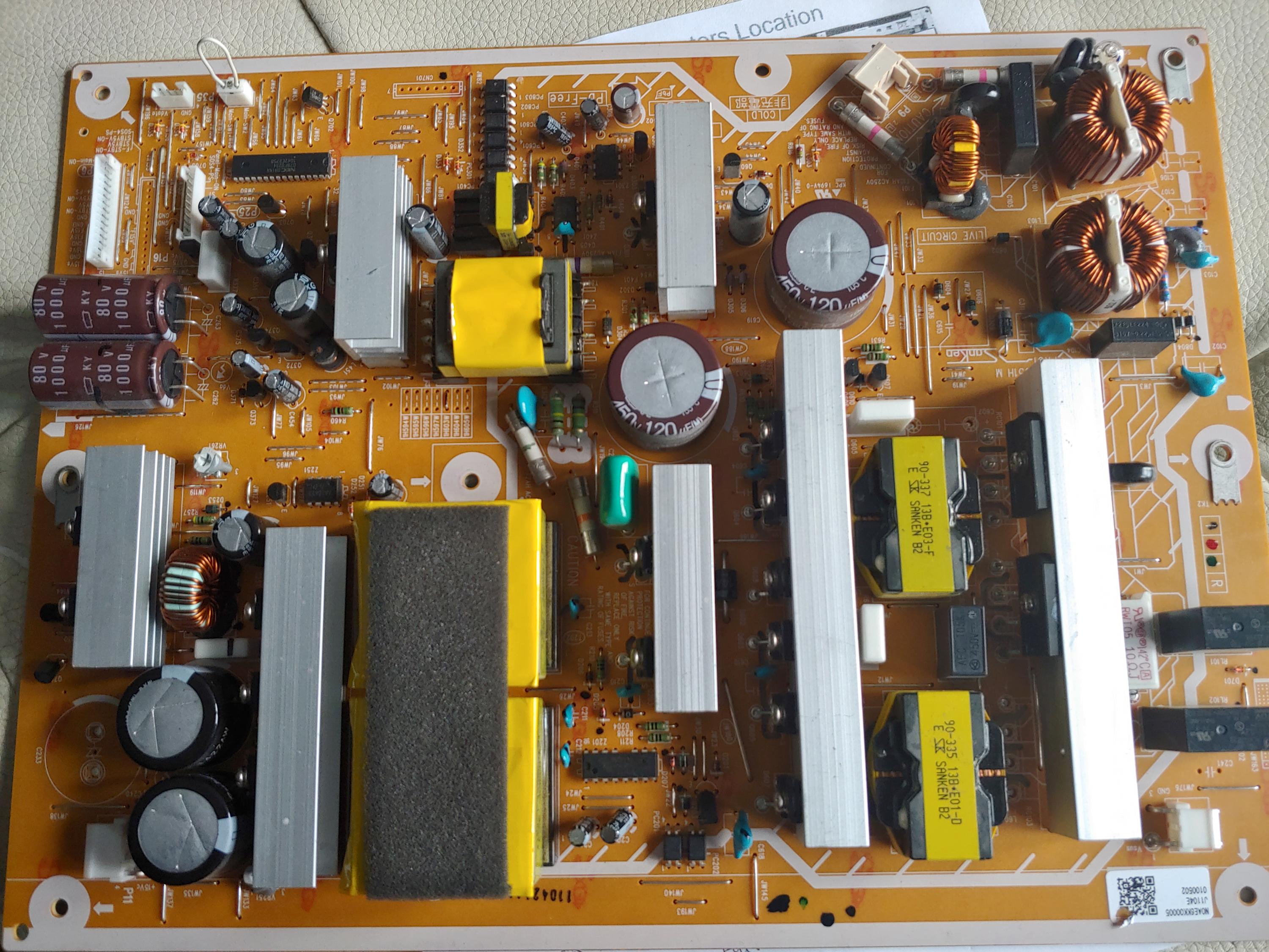

    Hi guys,
    I have this Panasonic plasma tv which exhibit a no standby led. I read through a few posts and even bought a new A board from eBay and the set still has no standby light. I am measuring standby voltage of 4.99vdc at P6 pin 6 on the P board. Any help will be appreciated.
    Photos attached.
    Thanks in advance

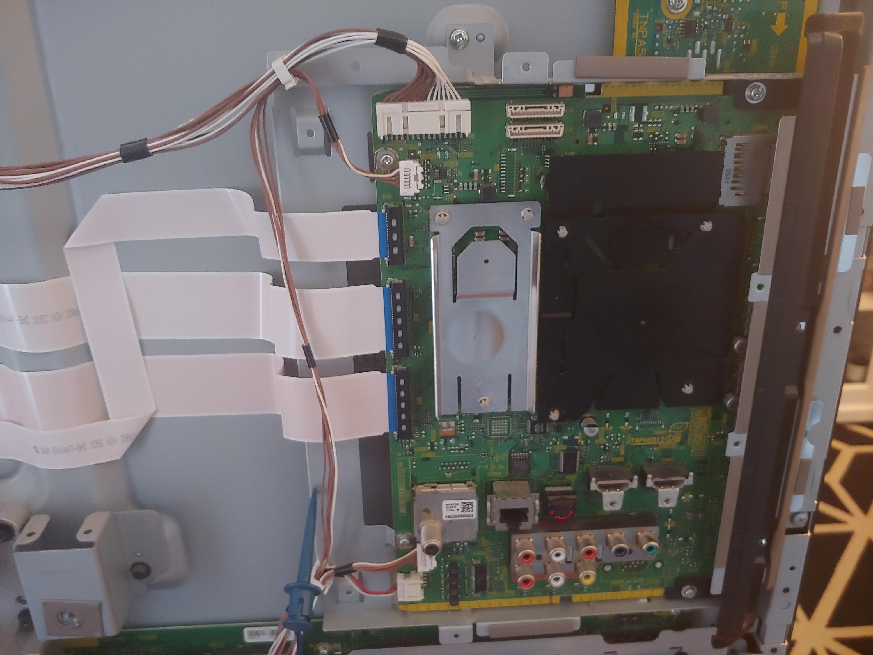

        Re: Panasonic Viera tv P46st30 no standby light
        yours photo
        the mainboards its working and you have the Optical Audio OUT LED indicator lid ON ..!!! so you should have the 15V on power boards..

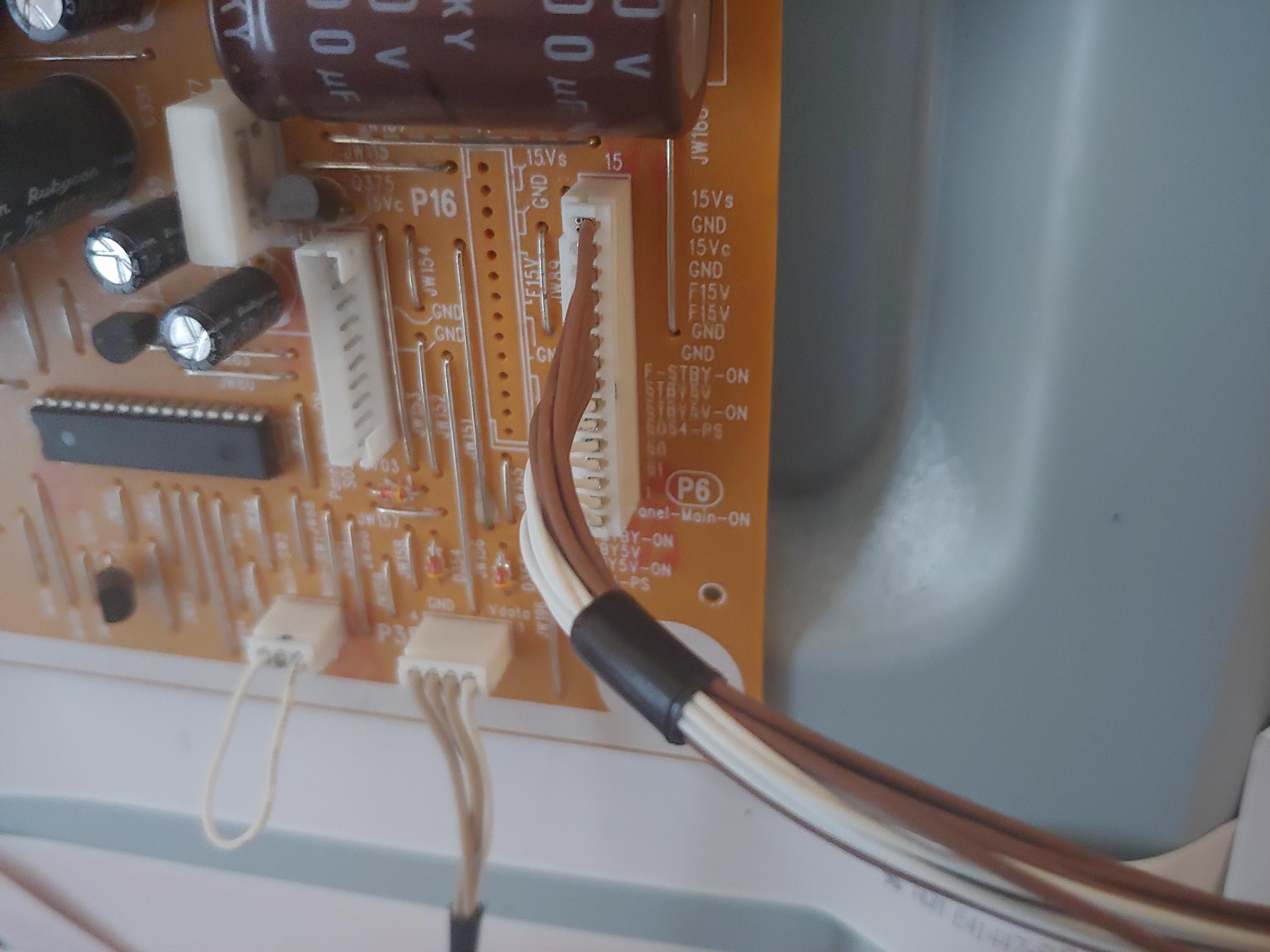

            This is the measurements on all pins on P6
            Pin 15 (15Vs) = .922vdc
            Pin 14 (GND)
            Pin 13 (15Vs) = .922vdc
            Pin 12 (GND)
            Pin 11 (F15V) = 15.73vdc
            Pin 10 (F15V) = 15.73vdc
            Pin 9 (GND)
            Pin 8 (GND)
            Pin 7 (F_STANDBY_ON) = 4.98vdc
            Pin 6 (STBY 5V) = 4.98Vdc
            Pin 5 (STBY 5V_ON) = 25.8mv
            Pin 4 (SOS4_PS) = 0.1mv
            Pin 3 (S0) = 09.2mv
            Pin 2 (S1) = 09.3mv
            Pin 1 ( Panel_Main_ON) = 3.8mv
            Thanks guys for your help again. Is it a power supply related issue?

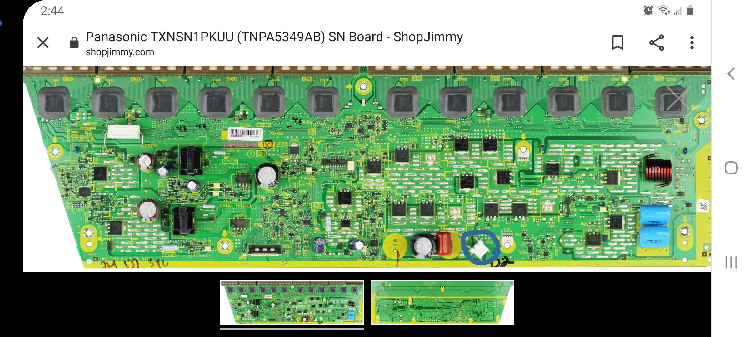

                Check s20on the sc board for a short across the 2pins.
                    Sorry, I meant SN2. Check across the unplugged connector pins. A beep longer than 3 seconds means you have a short.
                      I can't seem to locate the SN2. Is it on the scan board?

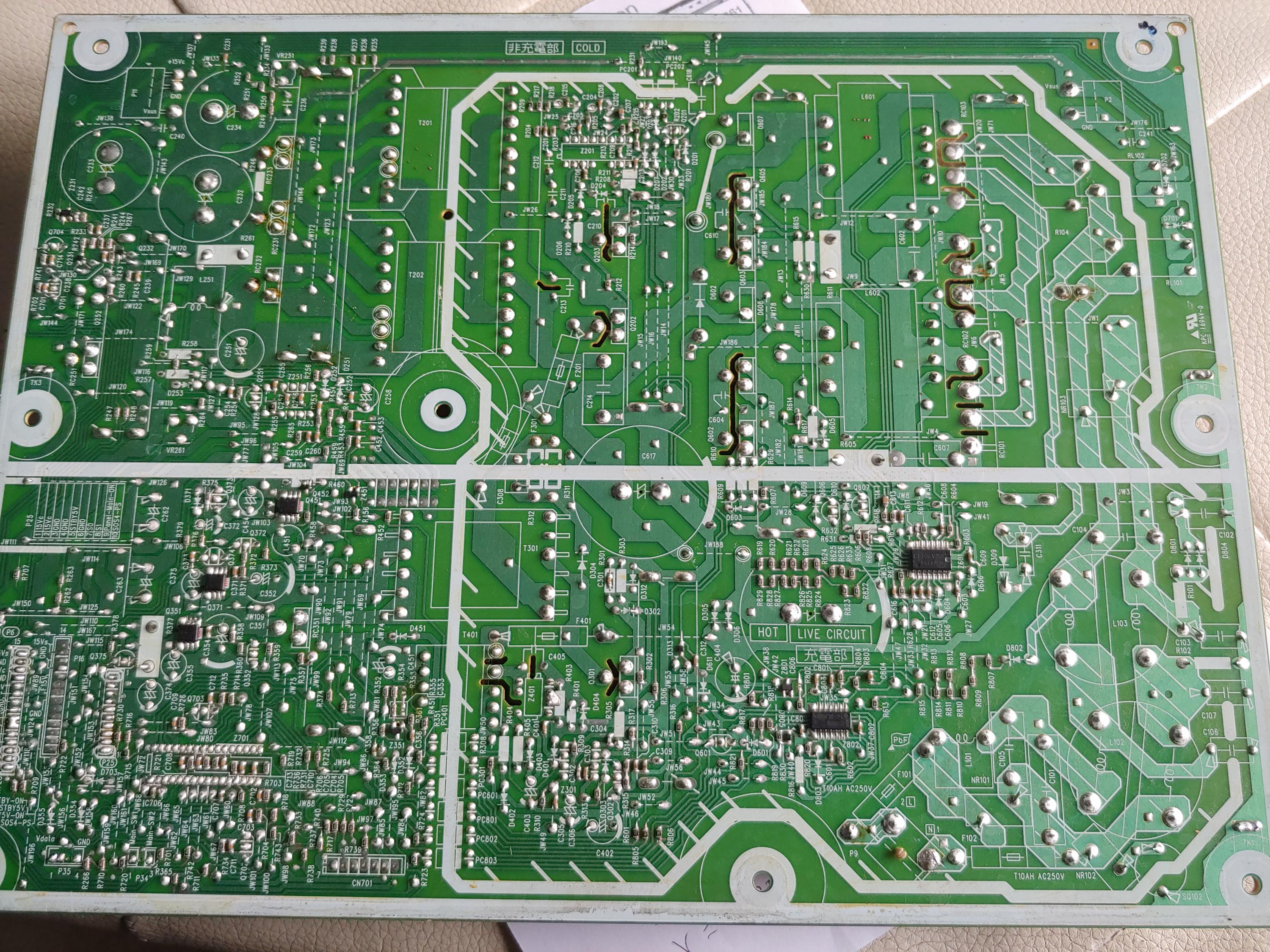

                              For some reason I cannot locate Q502 nor Q500 on the power supply board or just my eyes are no longer good.
                              I have attached the back side of my power supply board.
                                The sn board is tbe one with all tbe brown ribbon connections. Here is the sn2.
                                        tvtimmy, the measurements on SC20 on my board reads short(00.0ohm)
