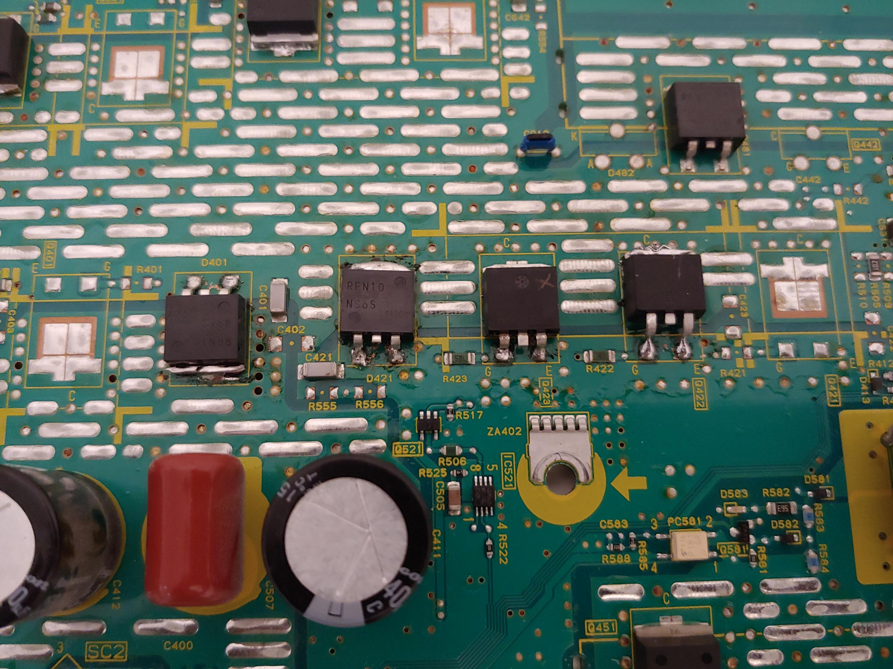

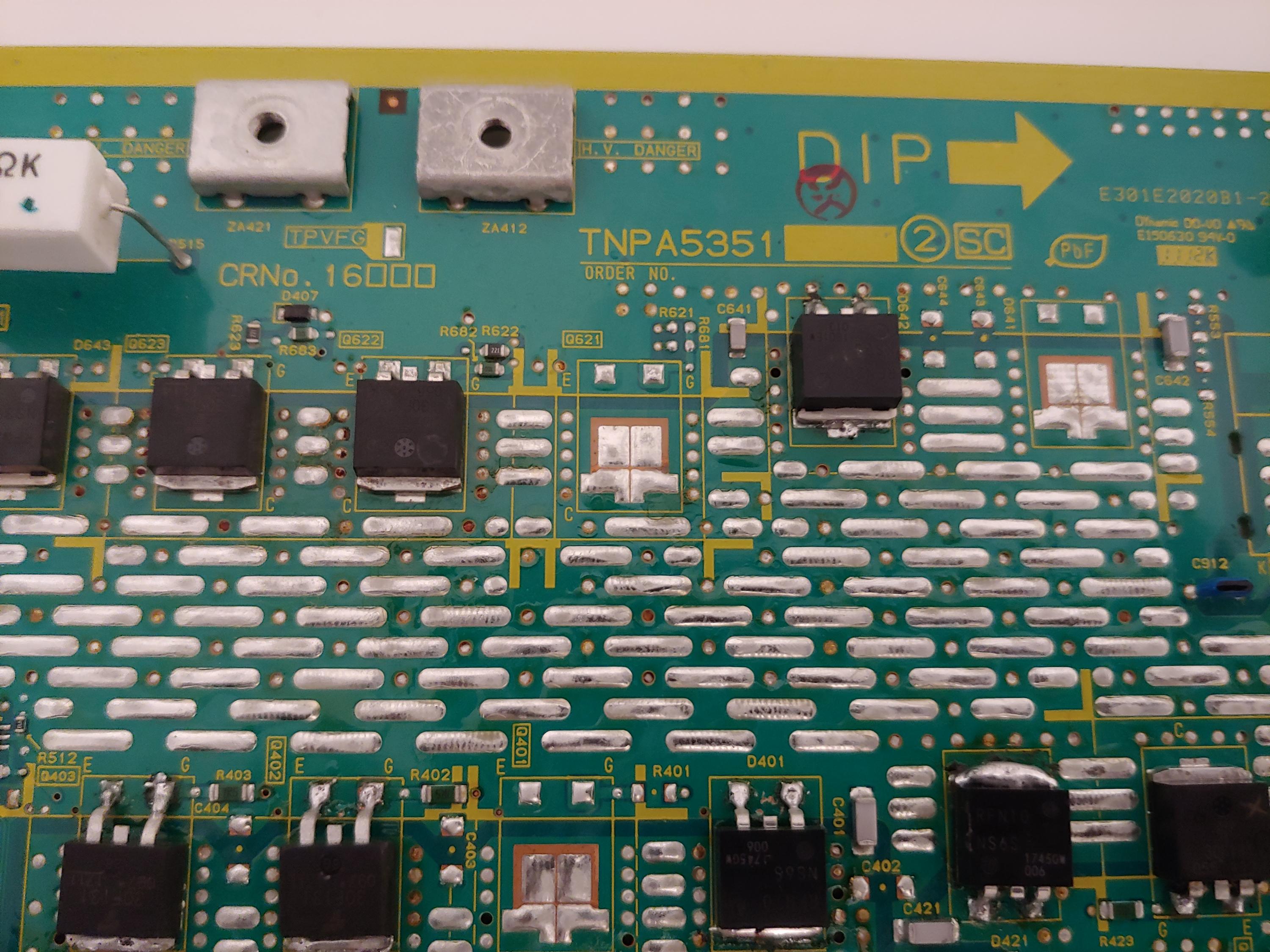

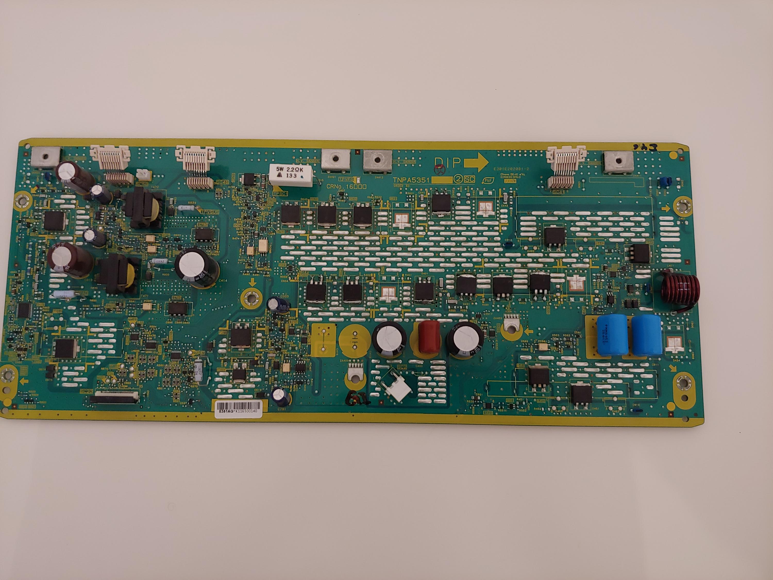

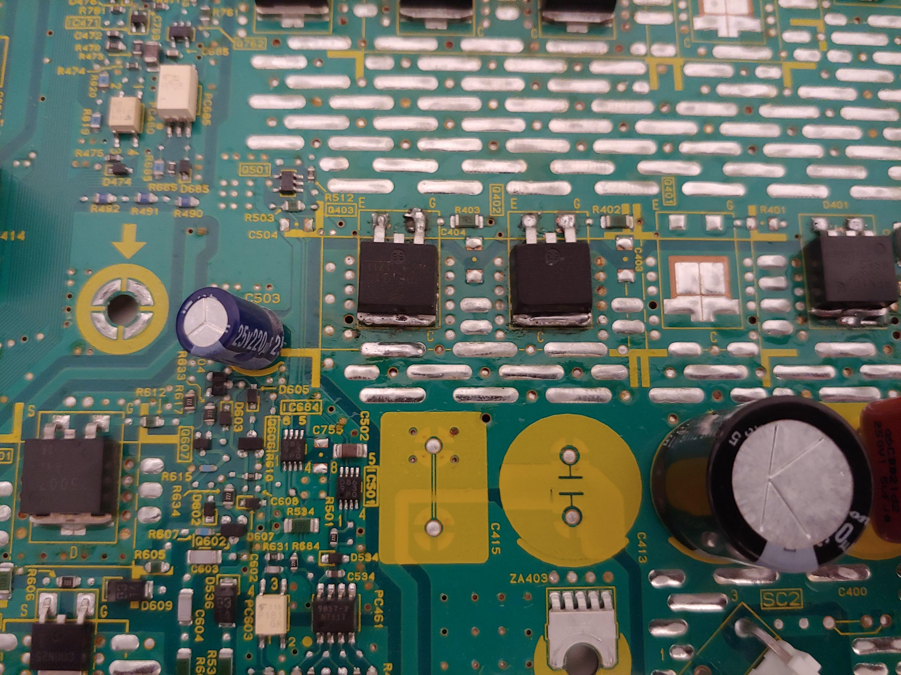

I would start with finding all the shorted parts on the SN board. That is where your problem is. Check the parts marked with a Q for a short. You will find 4 to 6 of them to be bad. Tbe SN board is the one with the orange ribbons.
