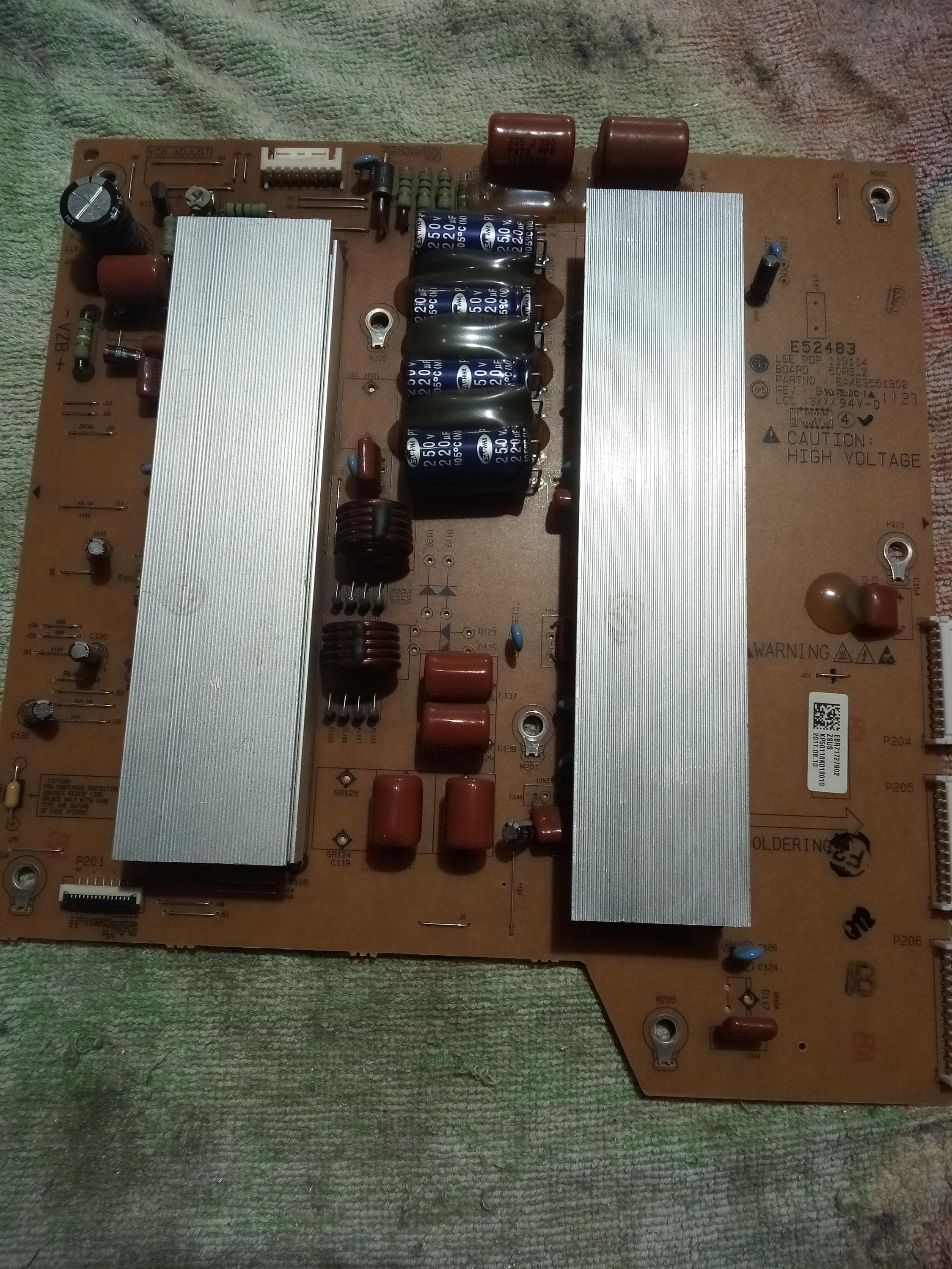

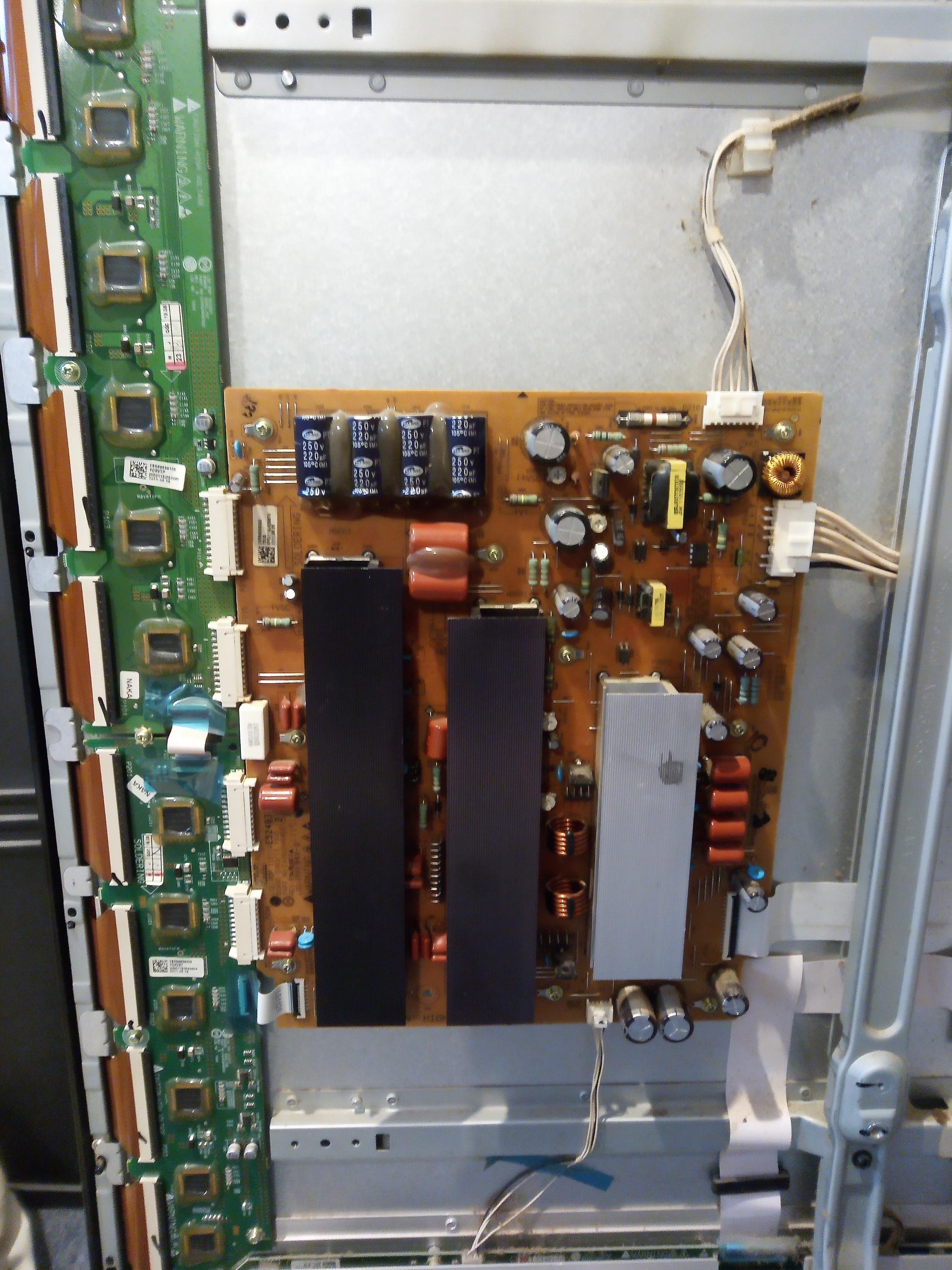

    Hi everyone ,ive had limited success in the past lg plasmas usually with igbt,s lasting a few minutes before blowing on y sus boards ,
    however this one had s/c on Z SUS BOARD q114,q115 igbt ,and q104 all s/c
    i removed both y sus and z sus
    and soldered up the coils that cause problems i also checked the buffer boards i,cs for s/c(often the top i/c)
    So rather than repair the board this time
    i bought a replacement z sus board
    and before fitting i soldered up the coils and checked for dry joints .
    My big mistake was i DIDNT check with my meter the igbts and mosfets on the replacement board
    i was greeted with same symptom at switch on one click then off . and the same items were s/c.
    so here are my questions can you run the psu into a load such as a100w bulb to ensure the psu is not over volting?
    can you run the tv without the z sus ,to test the vs 201v?
    is it possible that the y sus board can damage components on the z sus?
    i suppose the replacement may have been faulty ,(knowing my luck)
    im about to order the parts to repair original z sus ,but dont want it to fail at switch on .
    any advice from experienced plasma repairers would be very welcome

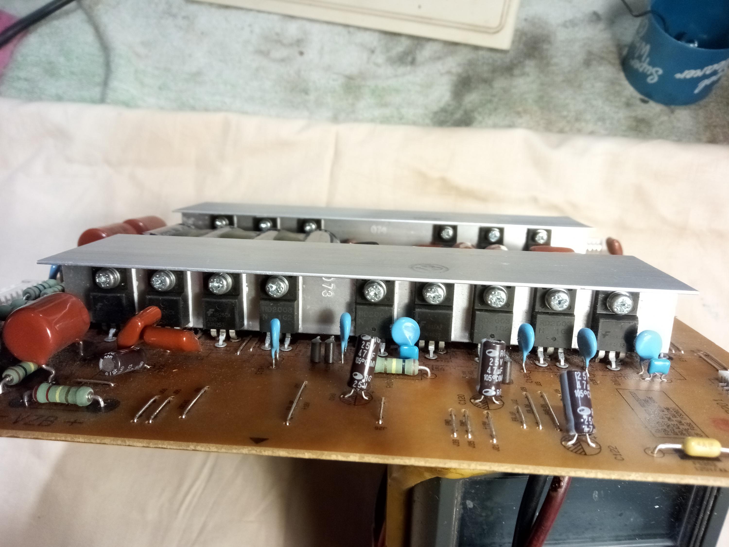

    on the side view of the z sus ,the front heatsink its the 3 mosfets /igbts ,on the left hand side that fail at switch on

        Hi , yes Y-SUS can damage Z-SUS , as well as a faulty display .
        I have used a 100W bulb on VS supply line from PSU as a load .
        To be honest whenever i repair a plasma TV with a sustain board issue , i use a variac to gradually increase the AC supply , as it can save damaging boards if there's an additional issue .
        Did you also reflow the large coils on Y-SUS ?

            I wouldn't run set without Z sustain board , as you might cause additional problems .
            Potentially i would assume that there could be one of 3 possibilities .
            Firstly , you may have bought a faulty Z board .
            Secondly , Y board might have taken it out , although , not sure how you would prove that without replacement , if semiconductors reading good .
            Last but not least , potentially the display panel could be taking it out .

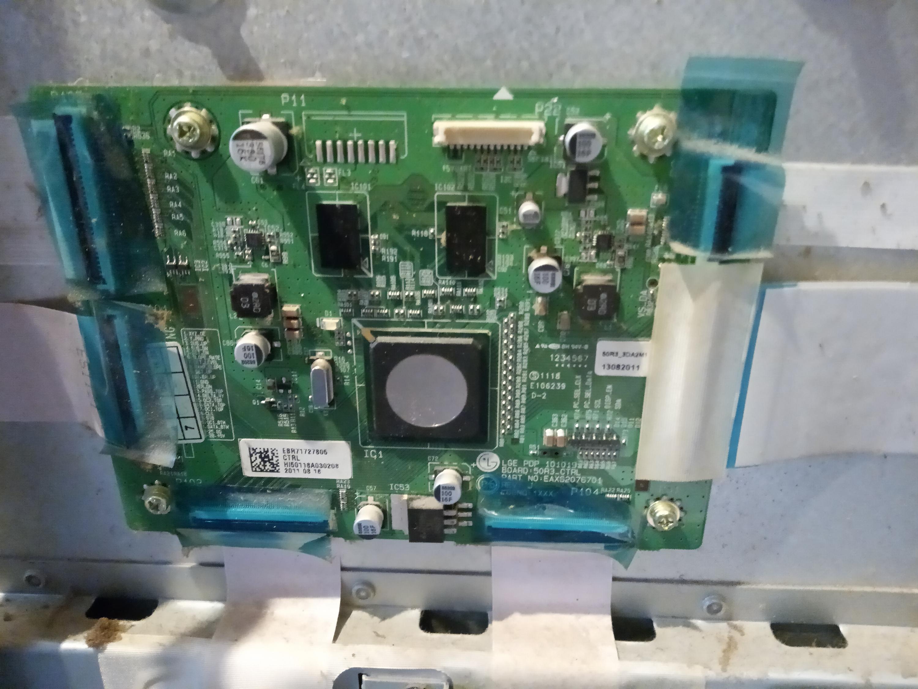

            I would assume buffers are good , if you have carried out the pin test on chips for short or low readings .
            May also be worth pulling out the power supply & attending to any poor joints .

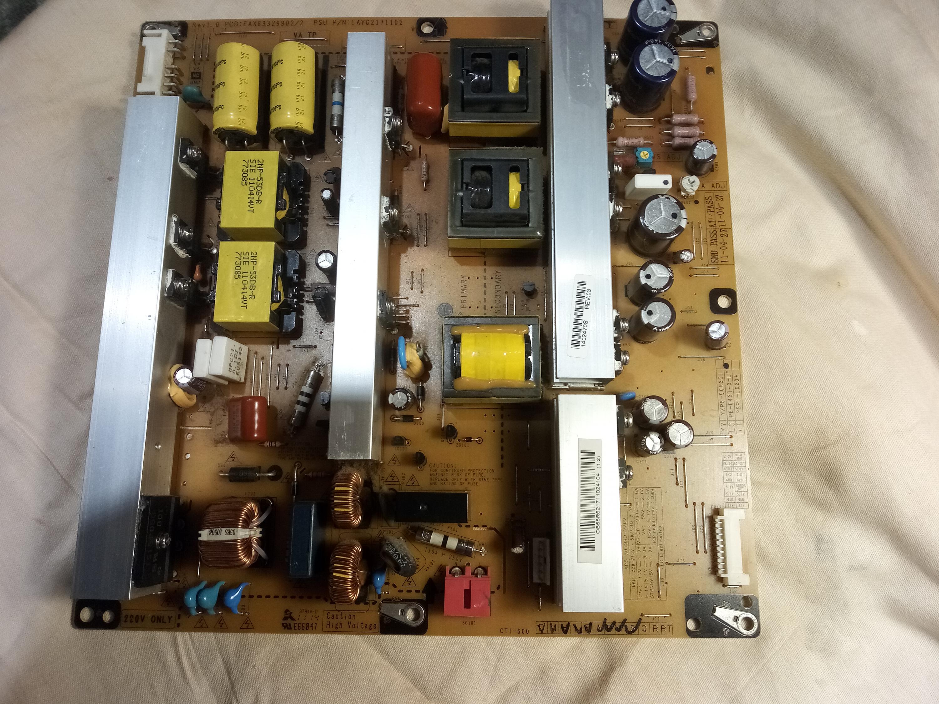

              ive soldered up and checked psu caps with esr meter
              i will run psu into 100w bulb ,if i can find one,and measure o/p volts
              i will try to get my hands on a variac as you sugested
              • jimbofz
                • Apr 2013
                • 539
                • uk
                Re: LG 50PZ550 plasma help with diagnostics
                psu runs happily into 100w bulb,all o/p volts correct ,

                  No way that i know of when display develops internal issues , apart from risking more boards .
                  Chance are , if you cannot find any shorts on y-sustain board & power supply is good , then root cause will most likely be display .
                  • R_J
                    • Jun 2012
                    • 9588
                    You can also unplug the buffer boards from the Ysus board (leaving the buffers connected to the panel) and see if the tv comes on and the Vs voltage stays up. If it does then only connect the upper buffer board back to the ysus (powered off of course) and try again, if it shuts down, remove the upper buffer and only connect the lower buffer. If the fault is with one of the buffer boards, the good buffer should show half a screen (either upper or lower half)

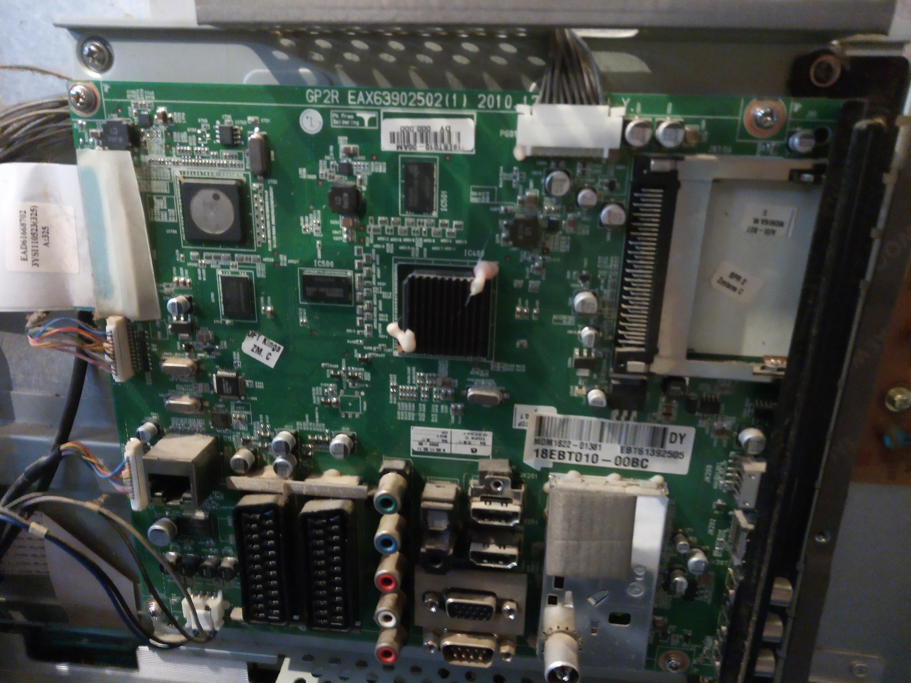

                          Thanks for the reply! The problem my TV has is that sometimes when I press the "power" button on the remote or the power button on the TV itself (which is a capsense button), I hear a click but the screen never turns on AND the Red "standby" light on the front never turns off. I do see the screen turn a little "milky" and I see a faint ghost image of whatever was there before it went to standby, but the screen doesn't light up. When it gets in this mode, pressing the power button again does nothing (no click and the screen stays "milky"), so the only way to get it un-frozen is to unplug/replug it. This happens in about 1 of every 5 times that I press the power button. In the other 4 out of 5 attempts, when I press the power button it works normally ... the Standby LED immediately turns off and then a few seconds later the screen lights up.
                          Note that I had originally asked what the blink code for the logic board means, but I have since realized that the blink code is actually THE SAME, when it works and when it fails. Even though the front red LED always follows the problem (LED doesn't turn off in the failure mode), the green LED pattern on the logic board is always the same after the power button is pressed, long-short-long-short.
                          After reading some threads, I checked for bulging caps but nothing obvious. I checked the solder joints on the large coils on the Z-sus board, and they looked fine. I made a very half-hearted attempt at reflowing the big chip on the main board by blasting the heat sink with a heat gun for ~10 seconds, and after that it SEEMED that the failure occurred less frequently ... it went from almost always failing to failing maybe 50% of the time. Once I realized this, I heated the heat sink for ~30 seconds and it seemed to be closer to 75% success. Tried again for ~60 seconds (most I could stand), and now it's at ~80% success. So I'm pretty sure that my poor attempts at re-flow are helping, but it could just be random.
                          Advice? at this point I'm ready to trash it if I can't get it to work reliably.
                          Thanks!

                            I'm pretty sure it's a mainboard problem.
