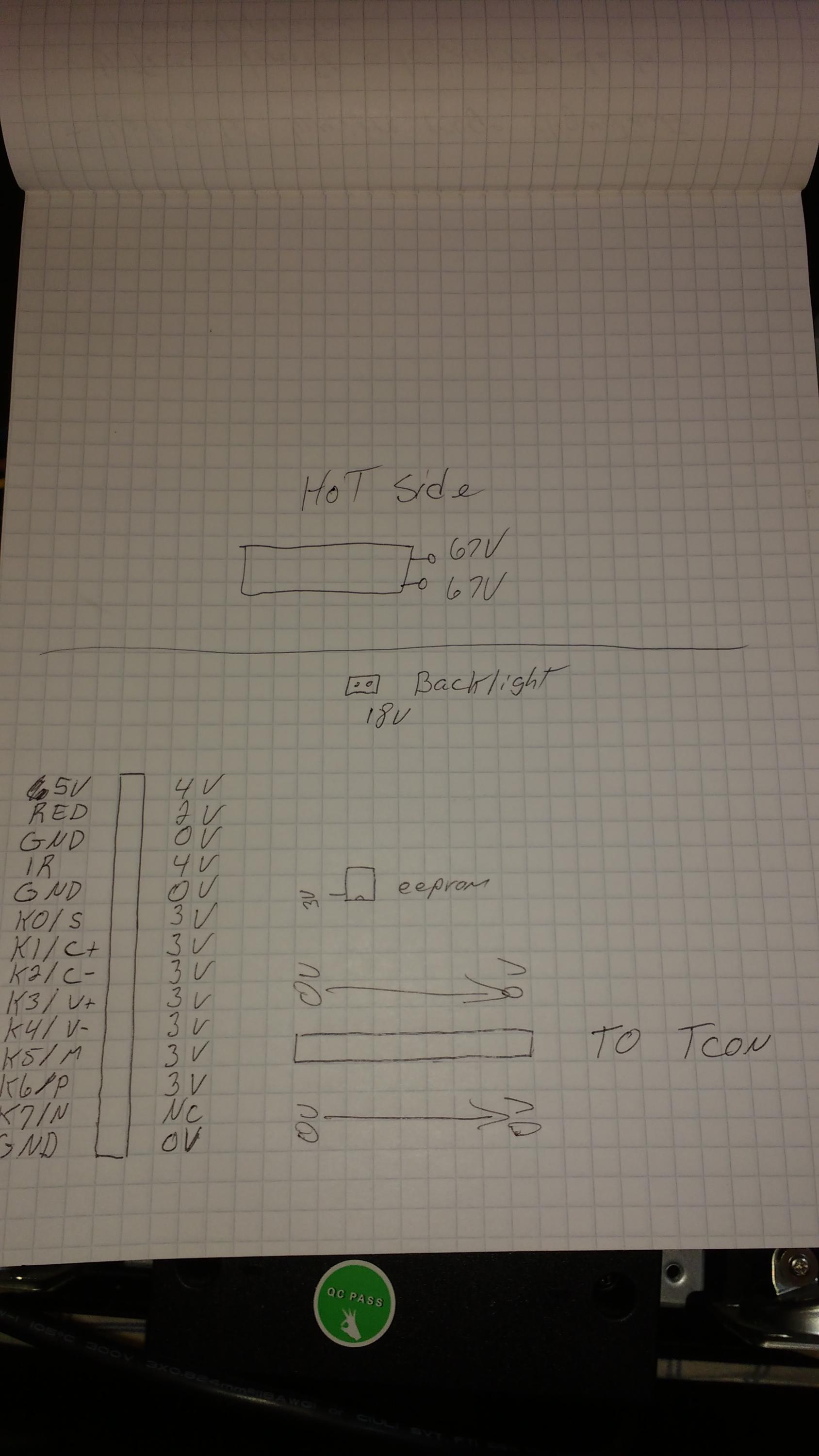

    RCA RLDED3258A-B, Board TP-MS3393.p81
    Stay in stanby, red light.
    Have change the eeprom but it seem the old one was ok.
    Now I have notice there is two photocoupler "L817"
    One show 17v on pin 1, 16v on pin 2, 68v on pin 3 and 67v on pin 4.
    The second on have nothing on pin 1 and 2. It is normal?

    Re: RCA RLDED3258A-B wont turn on
    Photocoupler's are opto isolators, One side (pin1&2) are likely on the cold side, Pins 3&4 are on the HOT side and to check there voltage you must use HOT GROUND (main filter (-)
    It is not likely a photocoupler problem.
    Was the new eeprom pre programmed?

            Well, I finally found the right file. Still nothing, stanby light that's all.
            The only difference is the eeprom I bought. It has the number 25q16csig instead of 25q16bsig, can that be the problem? Also, should I have used the lock function?
            I now need to check the voltages on the board. It is difficult since there are not many notes. I took the ones I have.
            Thank you for your time. Happy Holidays
