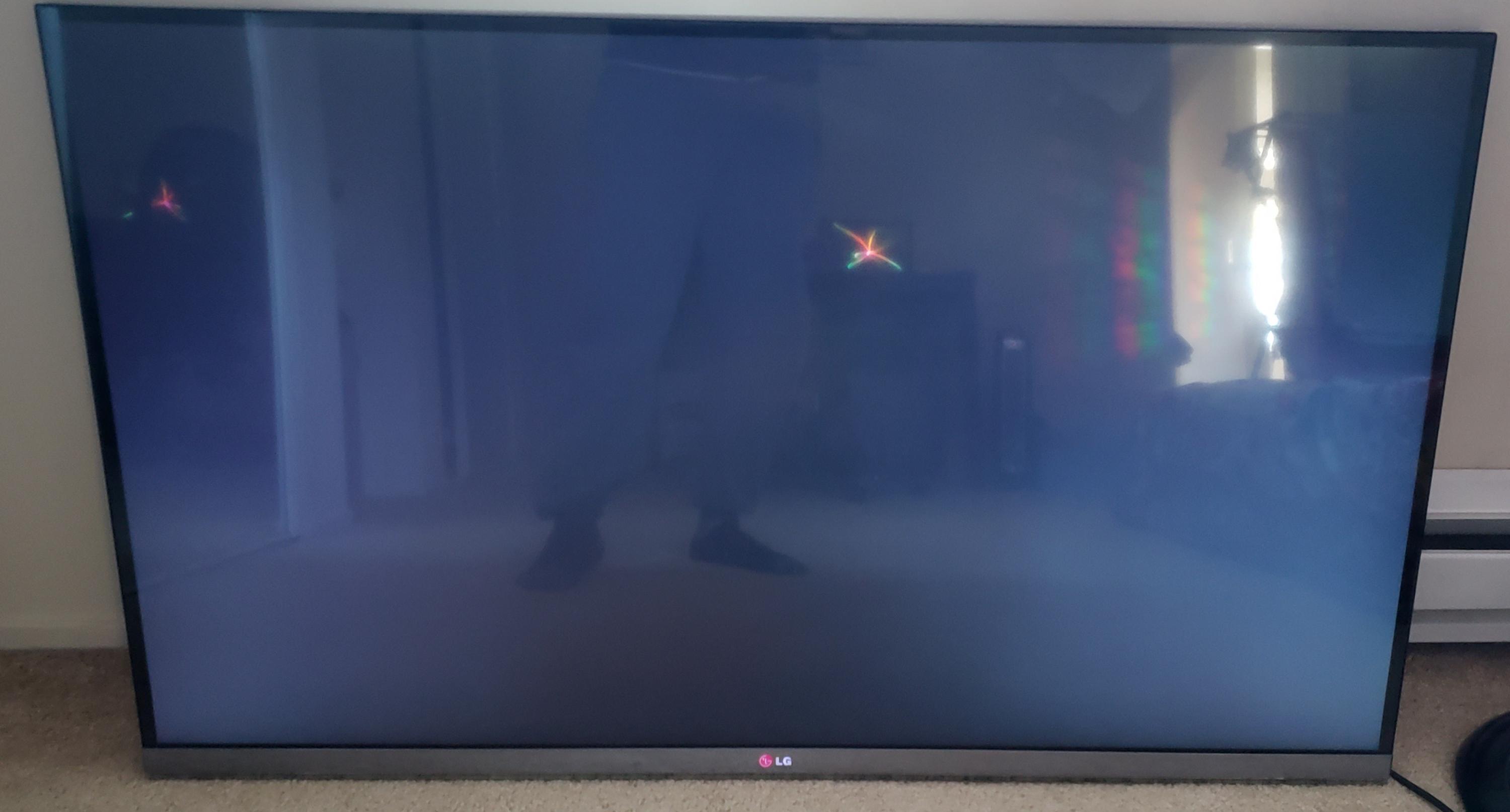

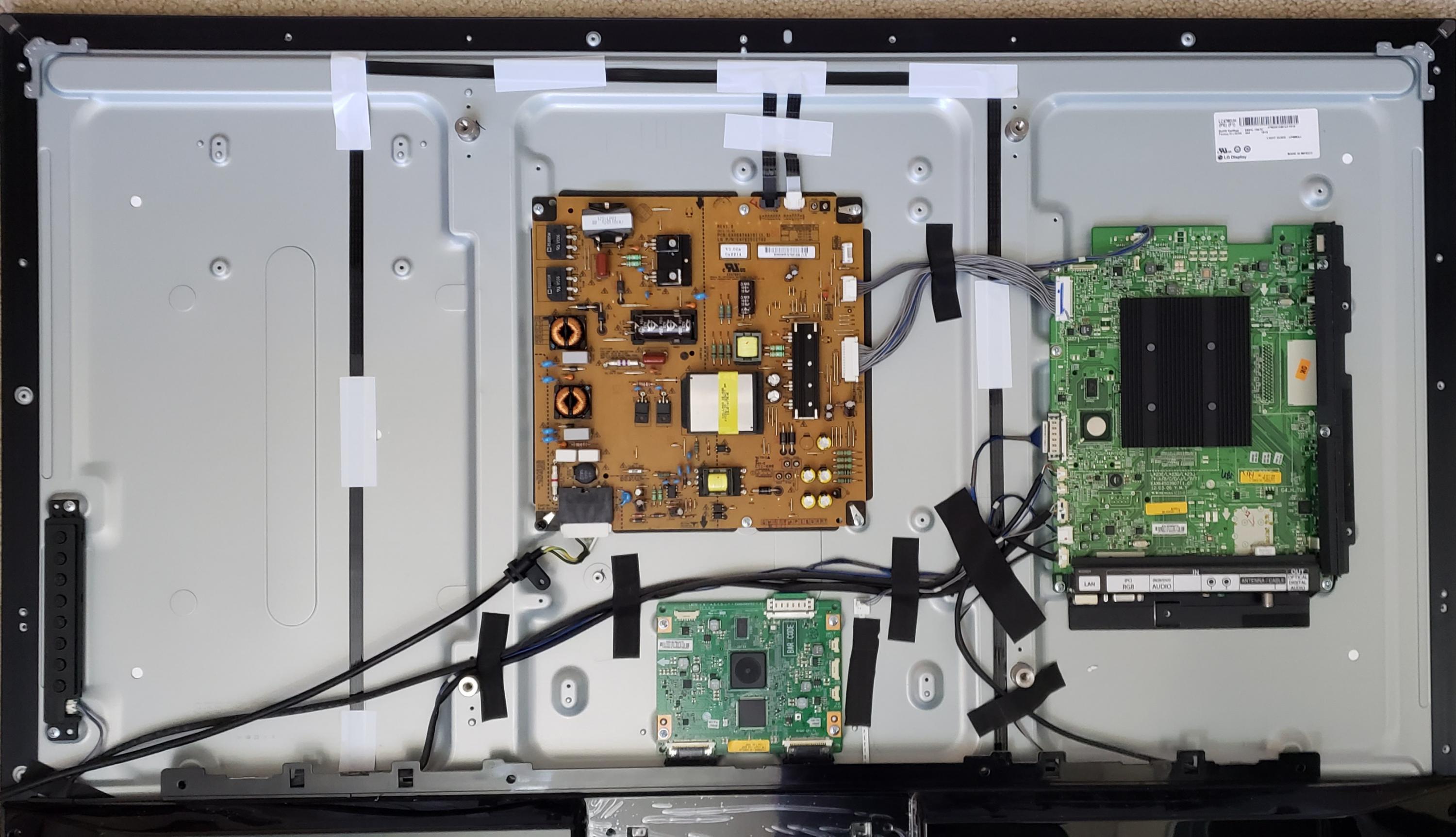

    LG 47 LM8600 - No Video
    I have got a LG 3D tv with model LM8600. It has no video however can hear audio when connected the source. All the voltages on PSU are present like 3.5/12/24V. I could see backlight is working properly. Also I could measure 16.42V across the caps on TCON as marked in the picture. I suspect the bad t-con however not sure. Can somebody tell me what's going wrong with this set?

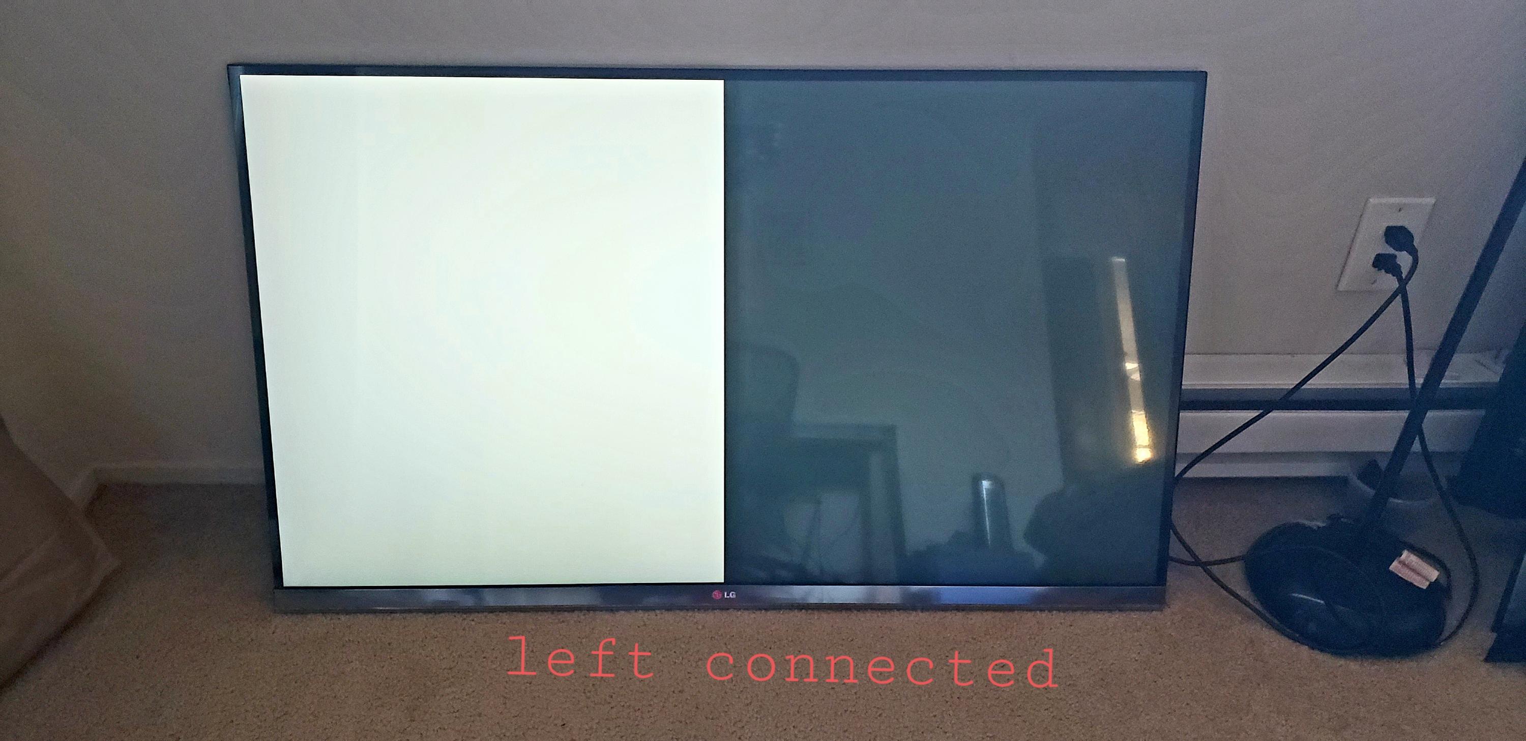

    Since you are able to hear audio, there is a chance your panel is bad.
    Disconnect half of the screen by disconnecting one of the two ribbons which connect the T-con board to the panel and power it on. If you see picture on the half still connected then then it confirms a bad panel and we can deal with it from there. If no picture appears, reconnect the disconnected ribbon and disconnect the other and power it back on. If still no picture appears then you could have a main board or T-con problem. Most likely your main board is defective if the panel is not the fault and is not sending proper signals to the T-con and in turn not sending signals to the panel.
    Use hot air or a blow dryer and heat up the large heatsink in the center of the main board while it's disconnected from power then power it back on and see if that allows it to work temporarily. If it does then indeed our main board is the issue. If not, then you could have a T-con issue.
    None of this is very scientific or very accurate, however 75% of the time it will allow you to identify the source of the problem quickly without having to bust out a buch of tools and equipment you may not have on hand.
    Let us know of your results and we can proceed from there.

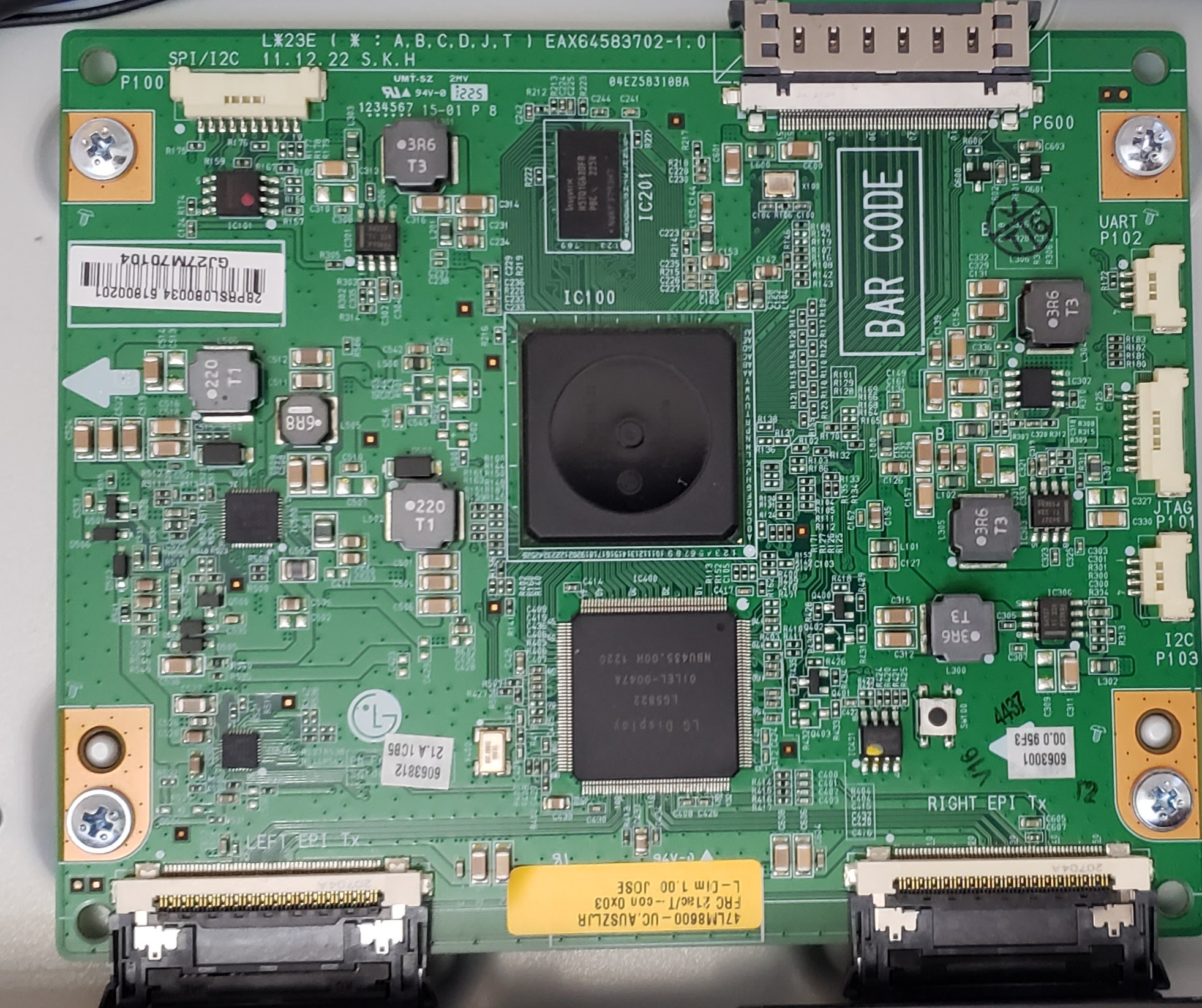

      this is wrong points to make measurements on T-CON. you could toasted the T-CON self or one of COFs of panel. because any load you ad with yours DM there will be increase of mA feed to the panel.
      you should only test the F1 fuse close to LVDS sockets on T-CON if there 12V. on both side of the F1.
      beside the test suggested above.....
      you have on T-CON SPI ( Flash eeprom ) RESET Micro switch. press it and keep pressing while you plug in the SET at wall sockets. give attention to your screen at this moment.

        Thanks Nick and Diah for replying on this. I did the test by removing ribbons from t-con to panel and looks like issue is with panel as I could see half white however no picture. Please find the attached photos. Let me know if this can be repaired or this set is done with its life.

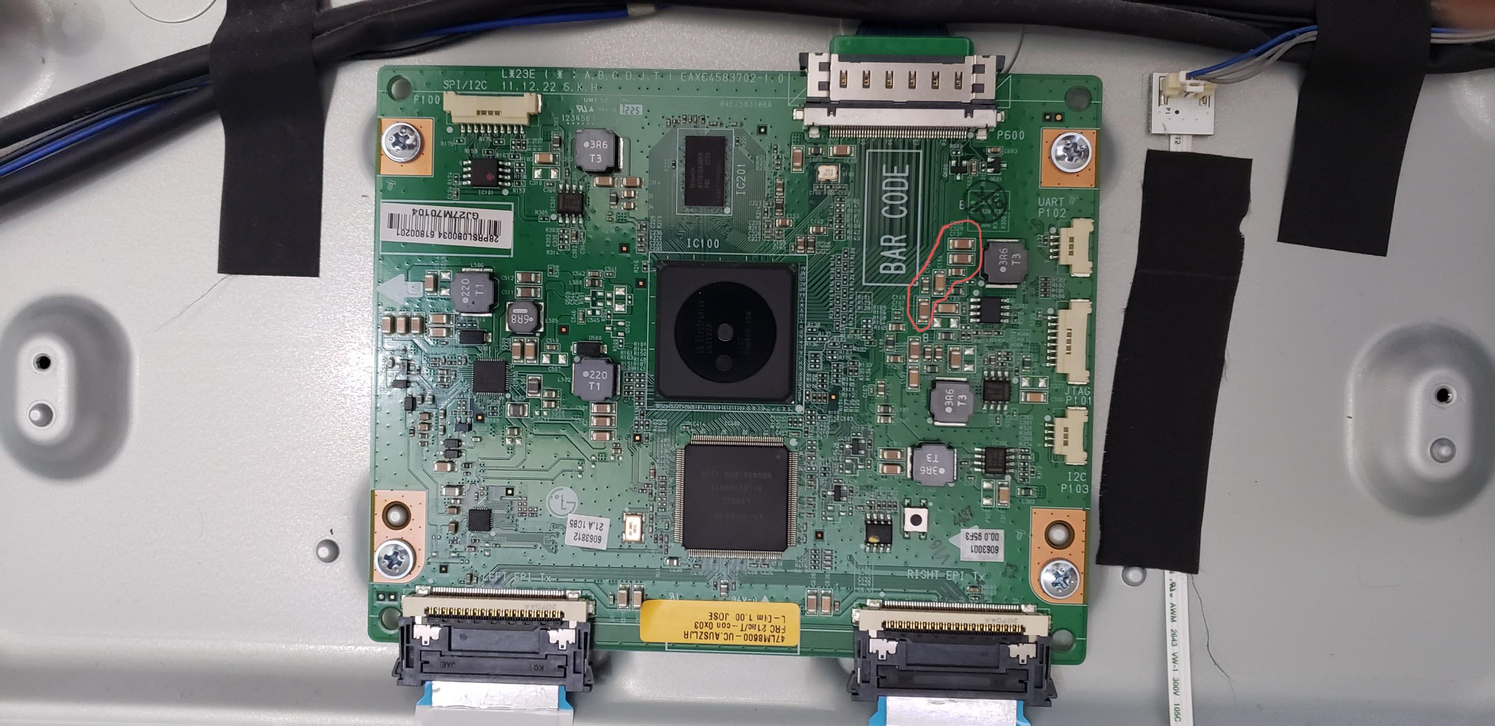

                  Posted observations in comment #4. I'll attach the photos with shorted caps, however those are not on panel edge.
                  • anupkg1985
                    • Sep 2020
                    • 180
                    Re: LG 47 LM8600 - No Video
                    All the caps marked in red area are showing shorted, could be one or more are bad among them.

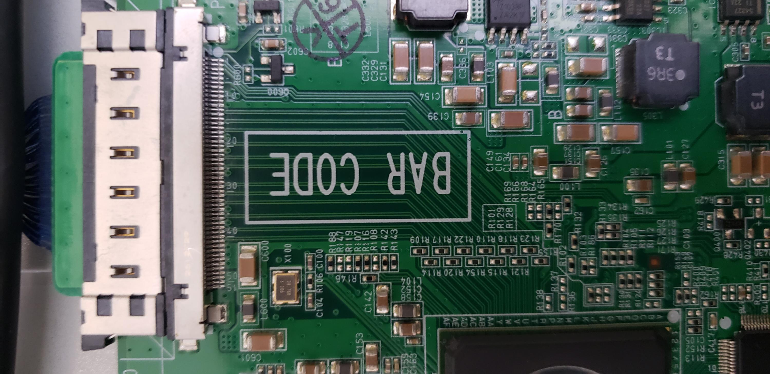

                          please shoot close photo on this socket p600
                          • anupkg1985
                            • Sep 2020
                            • 180
                            Attached snap of P600 connector.
                              okay thanks,
                              my judgment:
                              A- yours measurement at this post not correct
                              B- yours Panel OKAY. the line you saw after disconnecting right side ribbon cable are related to signal share at the panel self as it is 3D panel ( we understand how signal shared by side by side for example )
                              C: the SMD caps you mentioned are not shorted because they are related not direct to T-CON Normal operation.. ( they related to UART section for out source signal )
                              Issues: because you dont owned any further test and measurements instruments i will try to narrow the issue.
                              1- T-CON as you suspected .. but before you go for replacements make visual sight check to the panel edge boards and the glass too.. no need to test or touch.. just eyes sight enough.
                              2- if T-CON replacements didn't fixed it then the last OPTION BGA at Main boards...
                              3- as end from my side ..all up to you if you would like to start with points 1 or 2.
