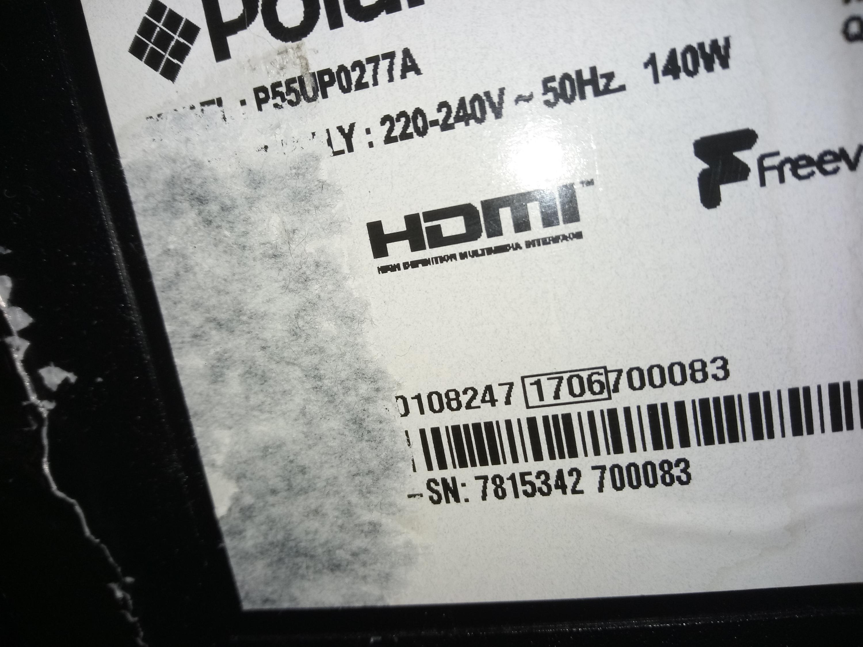

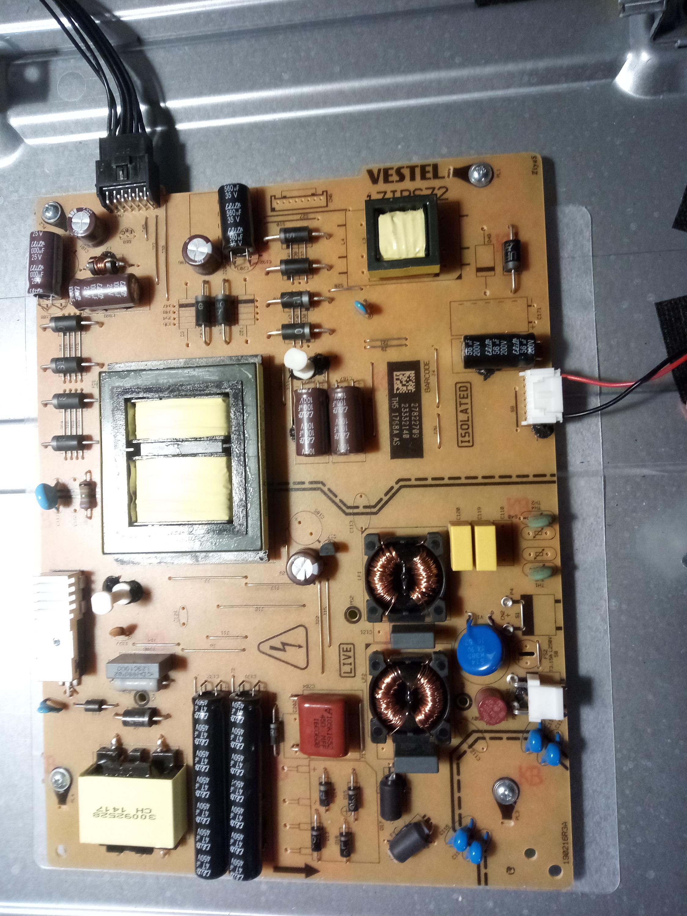

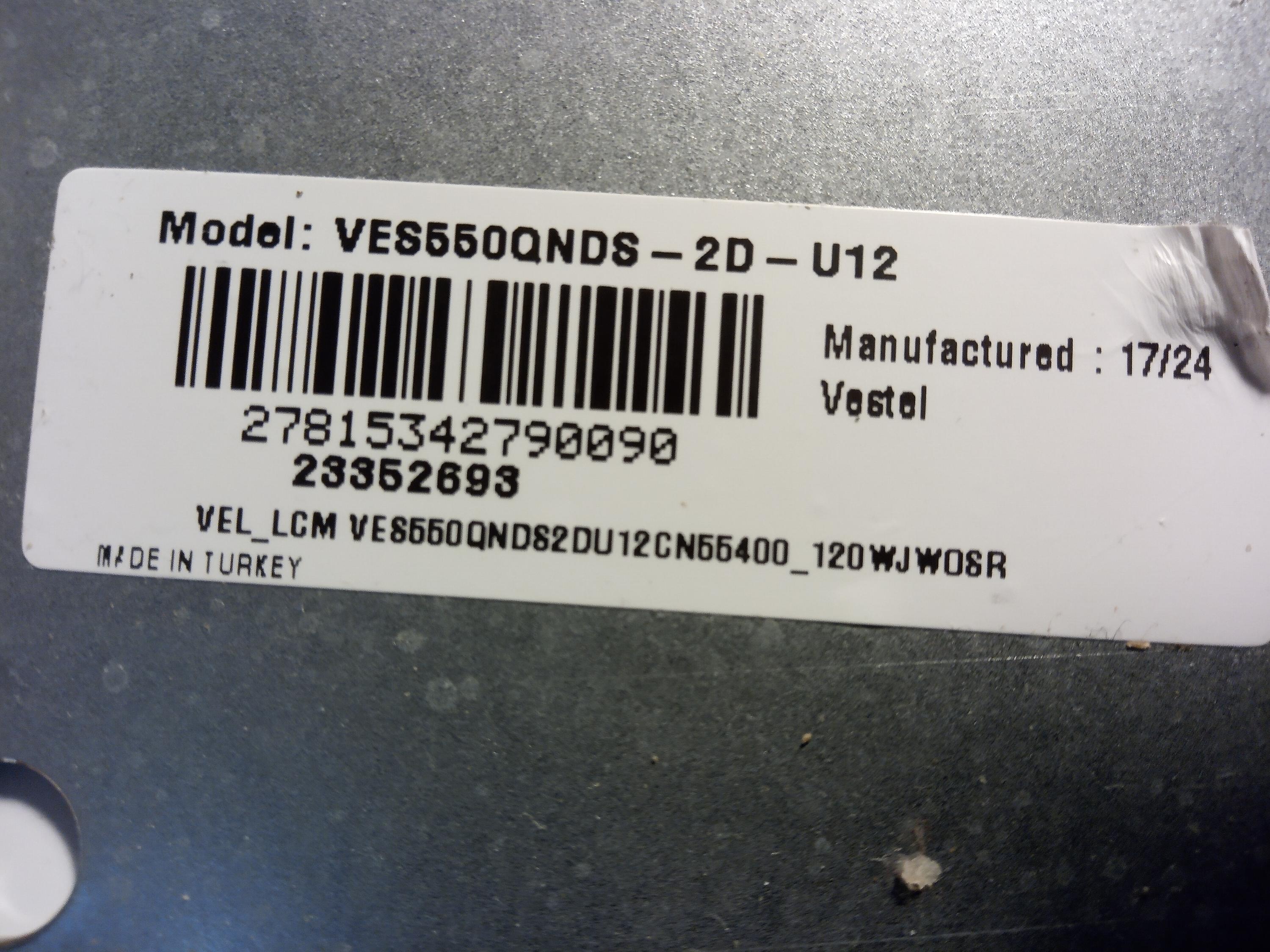

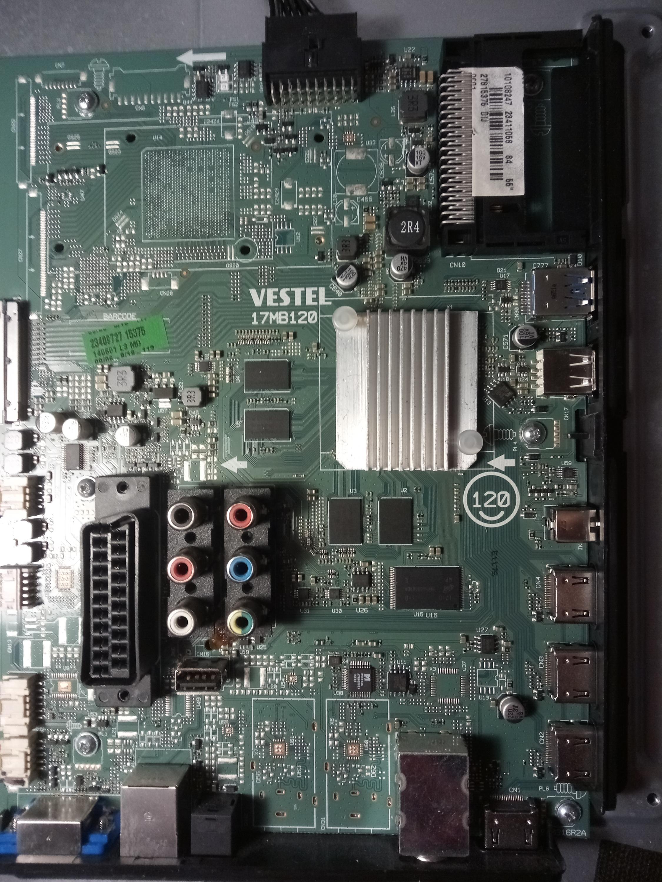

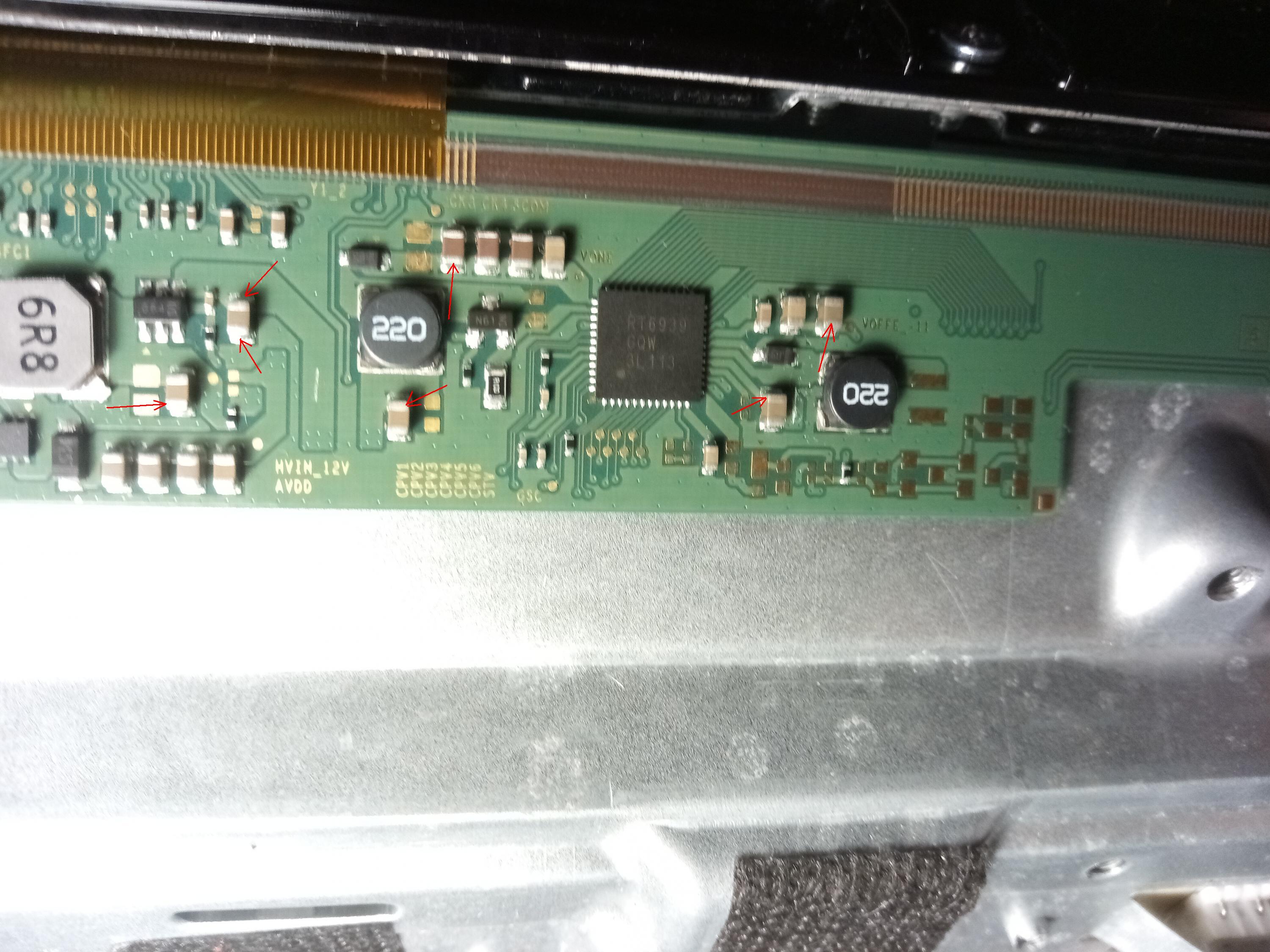

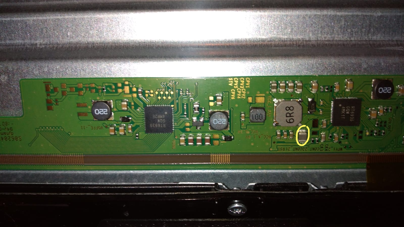

intergrated tcon board ic rt6939 vestel polaroid p55up0277a
  • jimbofz
    replied
    Re: intergrated tcon board ic rt6939 vestel polaroid p55up0277a
    Originally posted by nos_feratu
    hi mate, the cap is the one marked in the picture attached. If I hook mine to an input source it will scan and autocomute on that particular input and sound will come through, however limited interaction with the remote is observed. I cannot do anything else than power on/power off. As soon as I finish setting a more suitable workshop than the floor of my living room I'll continue investigation. If you can tell me the value of the capacitor it will be great, very much appreciated.
    as well I'm considering buying a logic board as it is a good candidate for failed items category
    the component circled in yellow is not a cap its a fuse ,its confusing as it looks like a cap bur slightly bigger and grey in colour whereas the caps are usually beige ,with regards to your fault are you using the original remote control as some will opperate in/out sby ,but may not have correct codes for as example volume ,just a thaught.
    Leave a comment:
  • nos_feratu
    replied
    Re: intergrated tcon board ic rt6939 vestel polaroid p55up0277a
    Originally posted by jimbofz
    thanks ,ive removed caps to test on cap meter
    both esr and cap value and all ok
    if you post a pic of the cap location on your tv i can tell you what the value it should be if that helps
    its strange you have limited response to remote .on mine i use scart i/p as it will auto select scart (as i cant see any on screen menu) then i can set vol mute ,and go in and out of sby ect
    hi mate, the cap is the one marked in the picture attached. If I hook mine to an input source it will scan and autocomute on that particular input and sound will come through, however limited interaction with the remote is observed. I cannot do anything else than power on/power off. As soon as I finish setting a more suitable workshop than the floor of my living room I'll continue investigation. If you can tell me the value of the capacitor it will be great, very much appreciated.
    as well I'm considering buying a logic board as it is a good candidate for failed items category
    Leave a comment:
  • jimbofz
    replied
    Re: intergrated tcon board ic rt6939 vestel polaroid p55up0277a
    Originally posted by videocentro
    Hi.
    Some questions
    1 can you check the tensions on the points indicated?
    2 Can you check if you have short circuits on the points indicated?
    3 can you please insert a picture of the panel tag?
    4 you can put a retro tv label photo please
    thanks for trying to help
    all the following are zero volts,
    vcc 3.3v, vone, voffe, 1,8v, hvydd,
    hvin is ok at 12v
    ive removed the 4 caps in parallel as there was a resistance of 250ohm to deck
    the caps are fine they measure 22uf each ,
    i then removed the coil marked 6r8
    as i thaught there may be a short underneath it,but the coil is fine also .
    all the other missing voltage test points are not s/c and threre is no short between them
    if you look to the right of the 4 caps in parallel the next cap (same size)has 12 volts then theres two tiny components (one a cap the other black is a resistor) then theres another cap and across it i have 5volts .i think theres something o/c feeding one of the chips or possibly a enable start up volts missing
    Leave a comment:
  • jimbofz
    replied
    Re: intergrated tcon board ic rt6939 vestel polaroid p55up0277a
    Originally posted by nos_feratu
    @jimbofz I've got same problem on a different TV set, Toshiba, same Vestel integrated tcon sh@t. I found one cap straight connected to 6935 which was shorted, replacing it didn't made any difference. problem is, there is no way to find values for them as there is no markings on. Actually somebody suggested the problem might be on the actual logic board as, at least in my case, the interaction with the remote is limited. basically I can get only power on/power off response. I've started a thread couple of days ago here, so keep in touch if we have any updates.
    thanks ,ive removed caps to test on cap meter
    both esr and cap value and all ok
    if you post a pic of the cap location on your tv i can tell you what the value it should be if that helps
    its strange you have limited response to remote .on mine i use scart i/p as it will auto select scart (as i cant see any on screen menu) then i can set vol mute ,and go in and out of sby ect
    Leave a comment:
  • videocentro
    replied
    Re: intergrated tcon board ic rt6939 vestel polaroid p55up0277a
    Hi.
    Some questions
    1 can you check the tensions on the points indicated?
    2 Can you check if you have short circuits on the points indicated?
    3 can you please insert a picture of the panel tag?
    4 you can put a retro tv label photo please
    Leave a comment:
  • nos_feratu
    replied
    Re: intergrated tcon board ic rt6939 vestel polaroid p55up0277a
    @jimbofz I've got same problem on a different TV set, Toshiba, same Vestel integrated tcon sh@t. I found one cap straight connected to 6935 which was shorted, replacing it didn't made any difference. problem is, there is no way to find values for them as there is no markings on. Actually somebody suggested the problem might be on the actual logic board as, at least in my case, the interaction with the remote is limited. basically I can get only power on/power off response. I've started a thread couple of days ago here, so keep in touch if we have any updates.
    Leave a comment:
  • jimbofz
    replied
    Re: intergrated tcon board ic rt6939 vestel polaroid p55up0277a
    here are some pictures pic 6 shows clearest image of the chips i need info on thanks
    Leave a comment:
  • dick_barton
    replied
    Re: intergrated tcon board ic rt6939 vestel polaroid p55up0277a
    If you can post some photos of your boards and also one showing the interconnection may catch peoples attention.
    Leave a comment:
  • jimbofz
    replied
    Re: intergrated tcon board ic rt6939 vestel polaroid p55up0277a
    seems very strange nobody has posted any replies? i wont bite tee hee
    Leave a comment:
  • intergrated tcon board ic rt6939 vestel polaroid p55up0277a
    this tv has working psu b/light and sound with dark blue screen ,
    no on screen graphics the t con is part of the tab bonding boards .
    the ics used to produce the various dc supplies are :
    RT 6939 and RT 6935.
    .i have 12v going to board ,but need to know what pin is the enable pin on these ics
    because these ics are not switched on i get no 3.3v vone voff 1.8v ect
    ive spent hours looking for data on these ics
    ive checked all the mlcc caps for short or low res to deck ,diodes ect
    ive tried to search for details of the panel in case it included details of the tab bonding boards, no luck
    does anyone have circuit or data sheet for these ics please?
    i also removed the bevel to see if there was evidence of spillage or corrosion
    and all seems clean none of the test points for the various voltage supplies have low resistance to earth
    so im convinced it could be a feed o/c or no enable volts to start up the ics missing
    all supplies on the main board seem ok 3v3 ,5v
    this design without separate tcon makes life very difficult you cant unplug one side then the other to help with diagnosis any ideas please
    Last edited by jimbofz; 11-09-2020, 02:09 PM.
  • kca
    by kca
    Hello all ~
    08-31-2025, 06:38 AM
  • x_orange90_x
    by x_orange90_x
    03-29-2025, 11:02 PM
  • advant
    by advant
    02-03-2020, 12:25 AM
  • snimmits
    Polaroid P43D300 (vestel 17MB97) issues (bluetooth & various sw bugs)
    by snimmits
    Good afternoon,
    I have a Polaroid P43D300.
    It shipped with WiFi and Bluetooth.
    Two weeks ago, I ran through the first time installation.
    This did a full reset and went through the first time setup.
    Once complete, I went to settings > sound.
    selected Audio Link, changed setting from disabled to enabled, pressed green button on remote and the tv does a search (discovery) for Bluetooth devices.
    search completes and doesn't find any devices.
    I have tried everything I can think of.
    Can someone provide...
    03-01-2024, 09:26 AM
  • Hakuu
    by Hakuu
    Hi There,
    More Details
    TV Model - LG OLED77G1PUA
    07-12-2023, 02:37 PM
