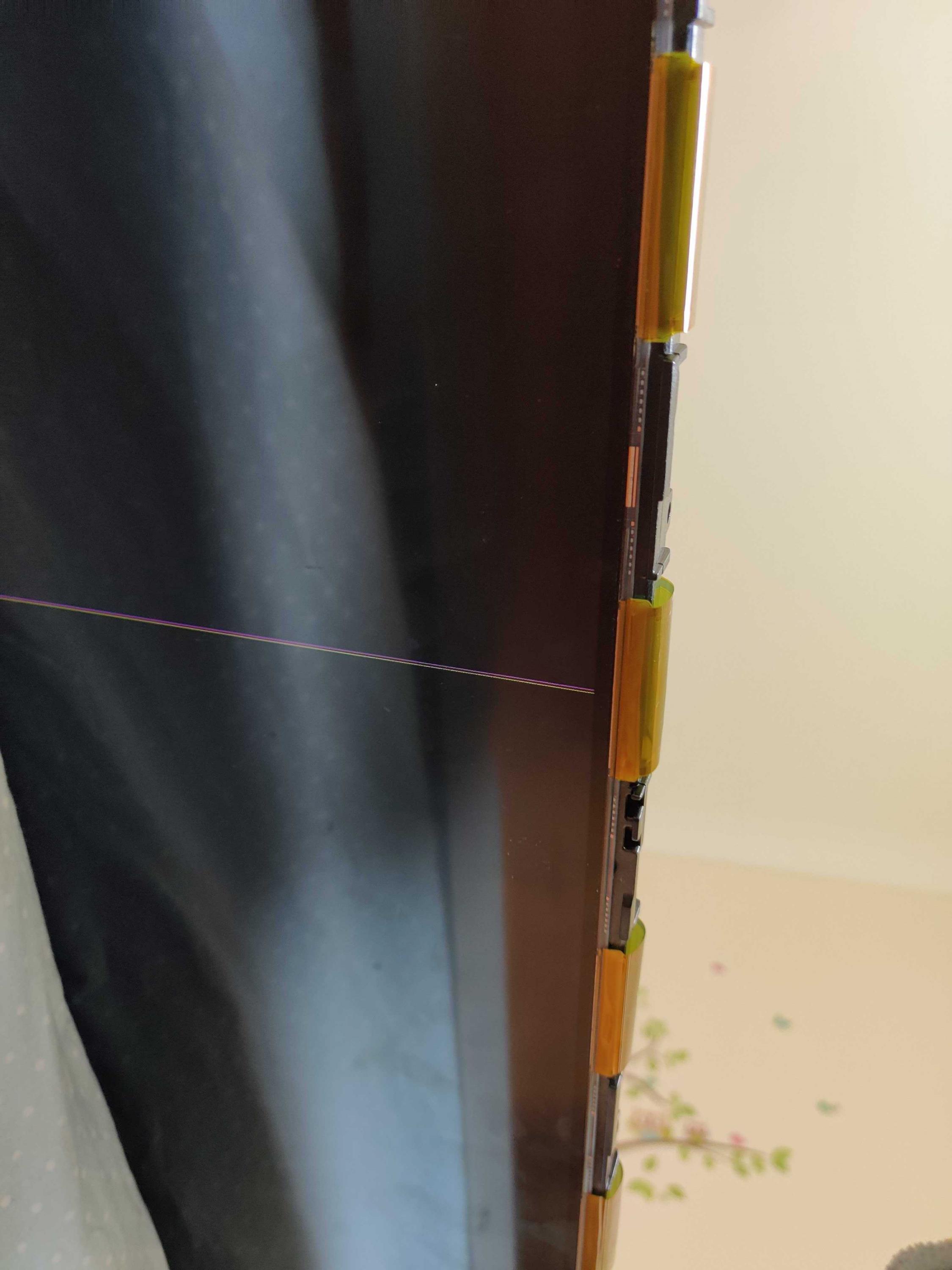

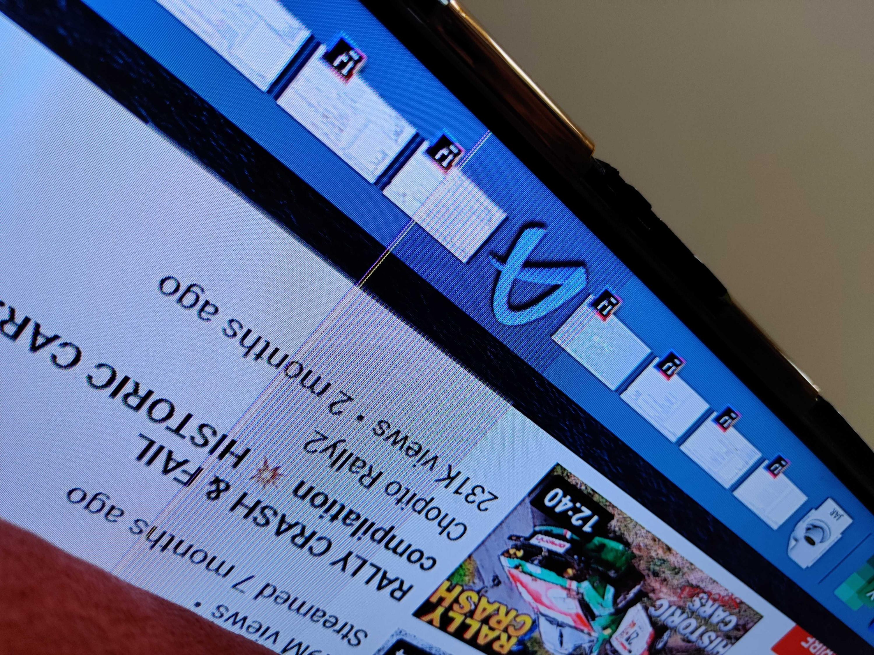

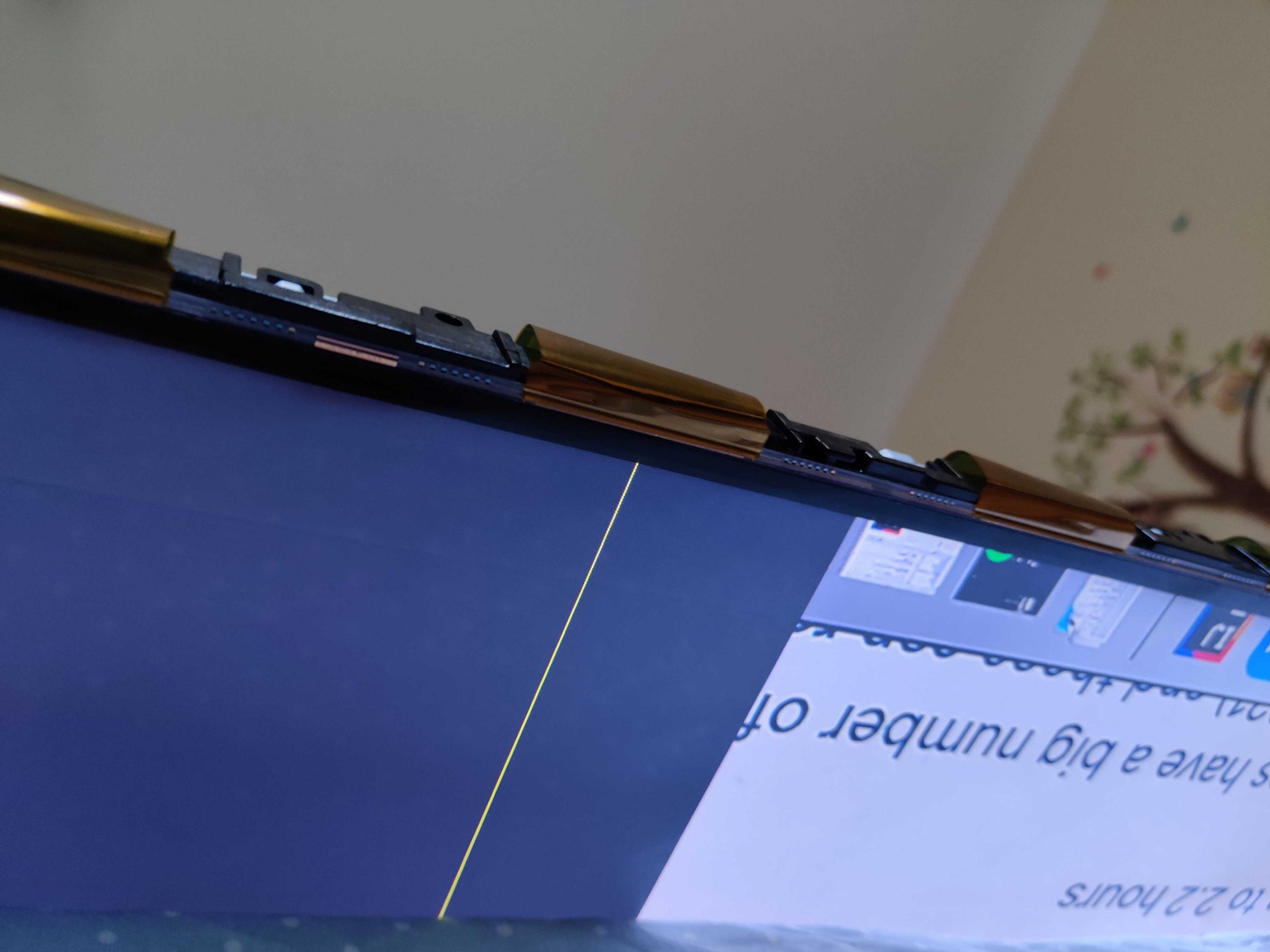

    Hi Folks,
    My Samsung TV has some vertical lines. If I don't have any input connected to the TV, I can see just 2 lines (read and yellow - the 2 lines shown on the left side of the scroud image)

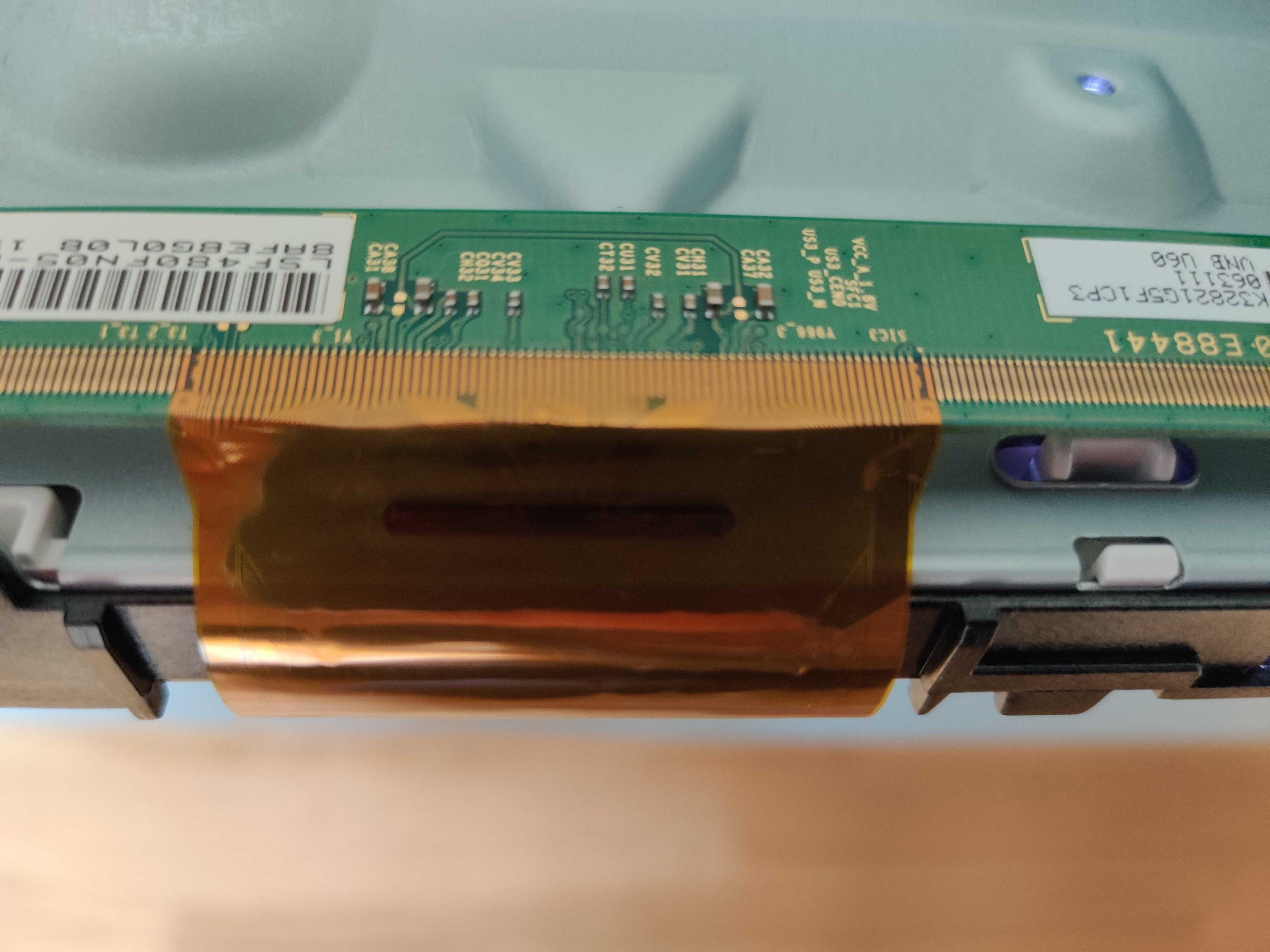

    Another symptom is that the COF tab is super hot.
    Do you think this is a screen issue?
    Thanks in advance,
    Tezeteta

    If that cof is "super hot" and the rest are not, then yep that area is the problem.

        Are the rest of the cof's black like that?
        • tezeteta
          • Sep 2020
          • 9
          • Ireland
          Re: Samsung 48' Vertical Lines
          The picture might appear to show a black spot on it, but it's not actually black.
          I cannot find any differences between COFs with my eyes.

            Not sure, here's a guy who cut a track, not sure if it will work for your issue, I wonder if the cut-tape method would work for this issue: https://www.youtube.com/watch?v=6WOuIMt2W3U

              Example of tape-cutoff method: https://www.youtube.com/watch?v=pfrRhw7-ZII
                        Hi nomoresonys,
                        I have try to apply the tape-cutoff method and I could get rid of the red vertical line, but not from the yellow one. Does this make any sense?
                        I apply the method in a random way as I don't have the pinout description of my tv board. Do you know any place where I can search for it?
