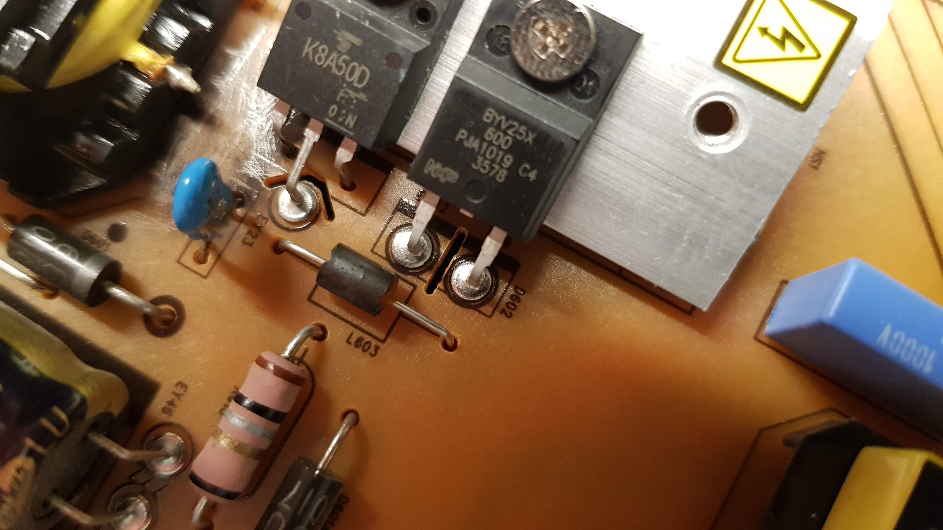

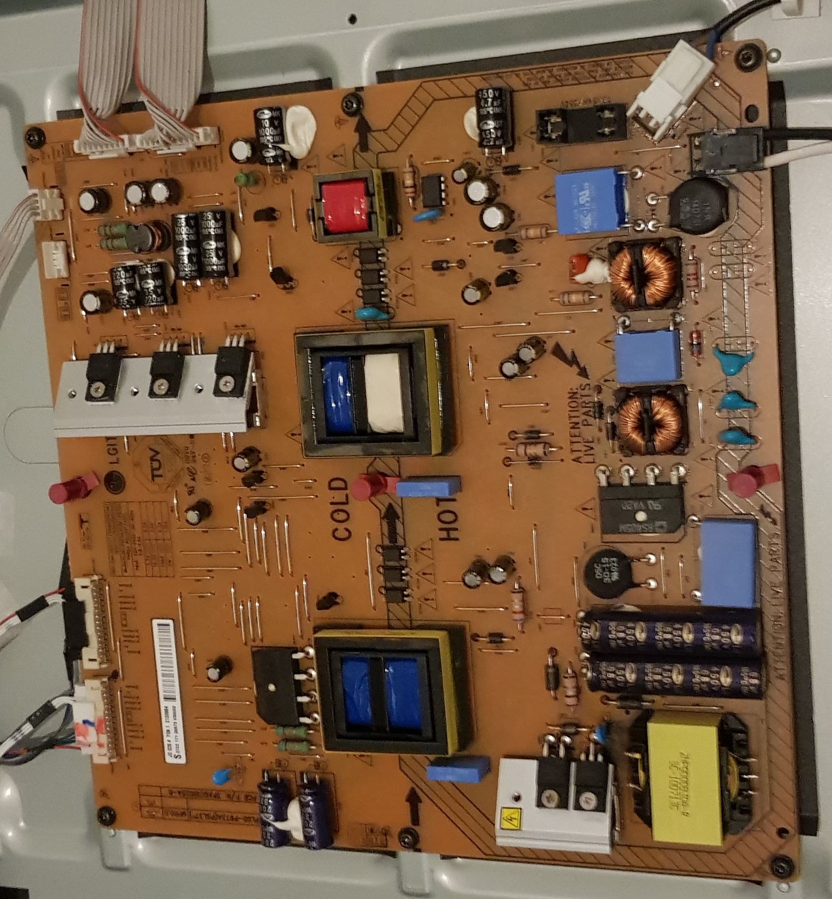

    hello folks
    i recently bought a broken 37pfl7605h/12 TV
    the pre owner said it broke during watching tv. then he brought it to a technican and now i got it here. it seems like the fuse has taken out. guss there was some kind of shortcut? i couldn´t find any topics for this type of power supply (p973a)
    maybe someone can tell me - what parts are the most common shortcuts... is it a good idea to just buy another fuse and set it on power ?
    any suggestions are more then welcome =)
    Just found this topic
    https://www.circuitsonline.net/forum/view/134865

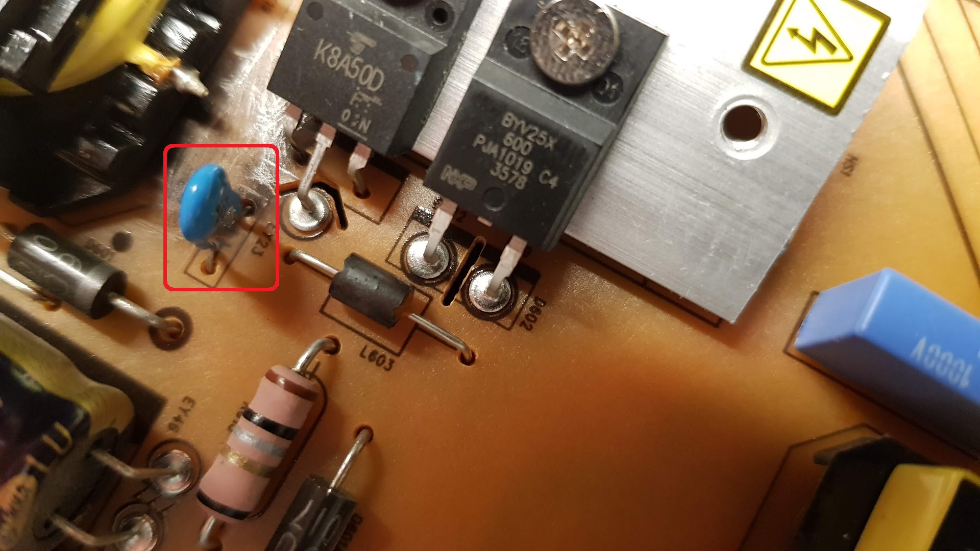

    and i also have some burnt marks in this area.. guess this is the spot we are looking for ?!

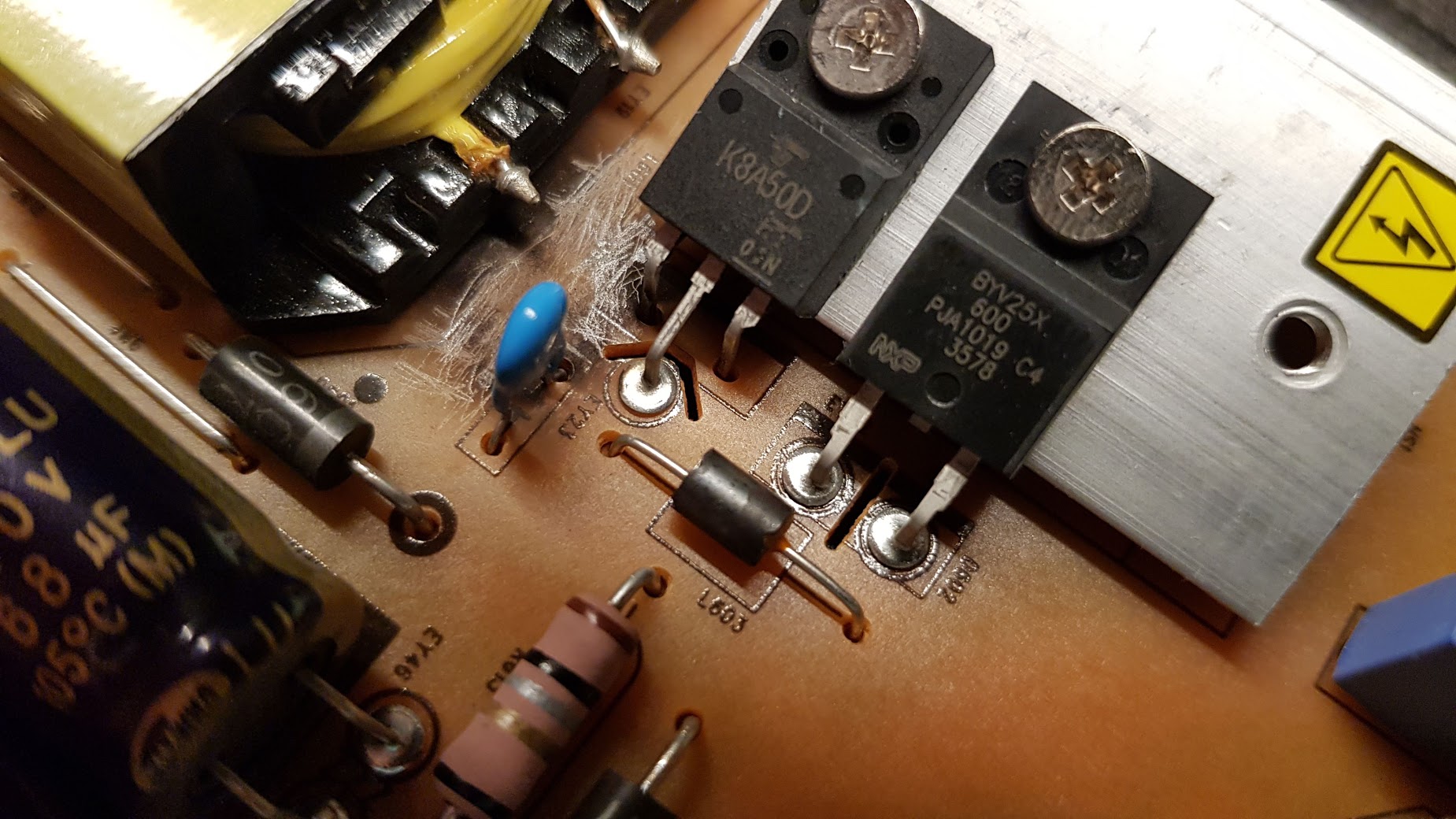

    More details of the burnt area-
    • dick_barton
      • Aug 2015
      • 6643
      • Wales
      Re: 37pfl7605h/12 power supply
      Has that blue capacitor burnt? If so that will need replacing. You would also need to check the two mosfets alongside.
        The fuse blew for a reason, don't just replace it. You've tested the components in the photo to see if any are shorted ? ?
          hello dick-
          i bought this tv from someone else.. and he told my a technican already changed a component...
          and this is the only area where obviosly something happened =)
          so this SHOULD be a good capacitor... but for sure if i buy new parts i can change it.
          but the real question is.. what caused a shortcut :/ i think its only one mosfet... and a diode. i am more a newbie.. so i measured only resistance in the circuit... no shortcut...
          L603 has a very low resistance...

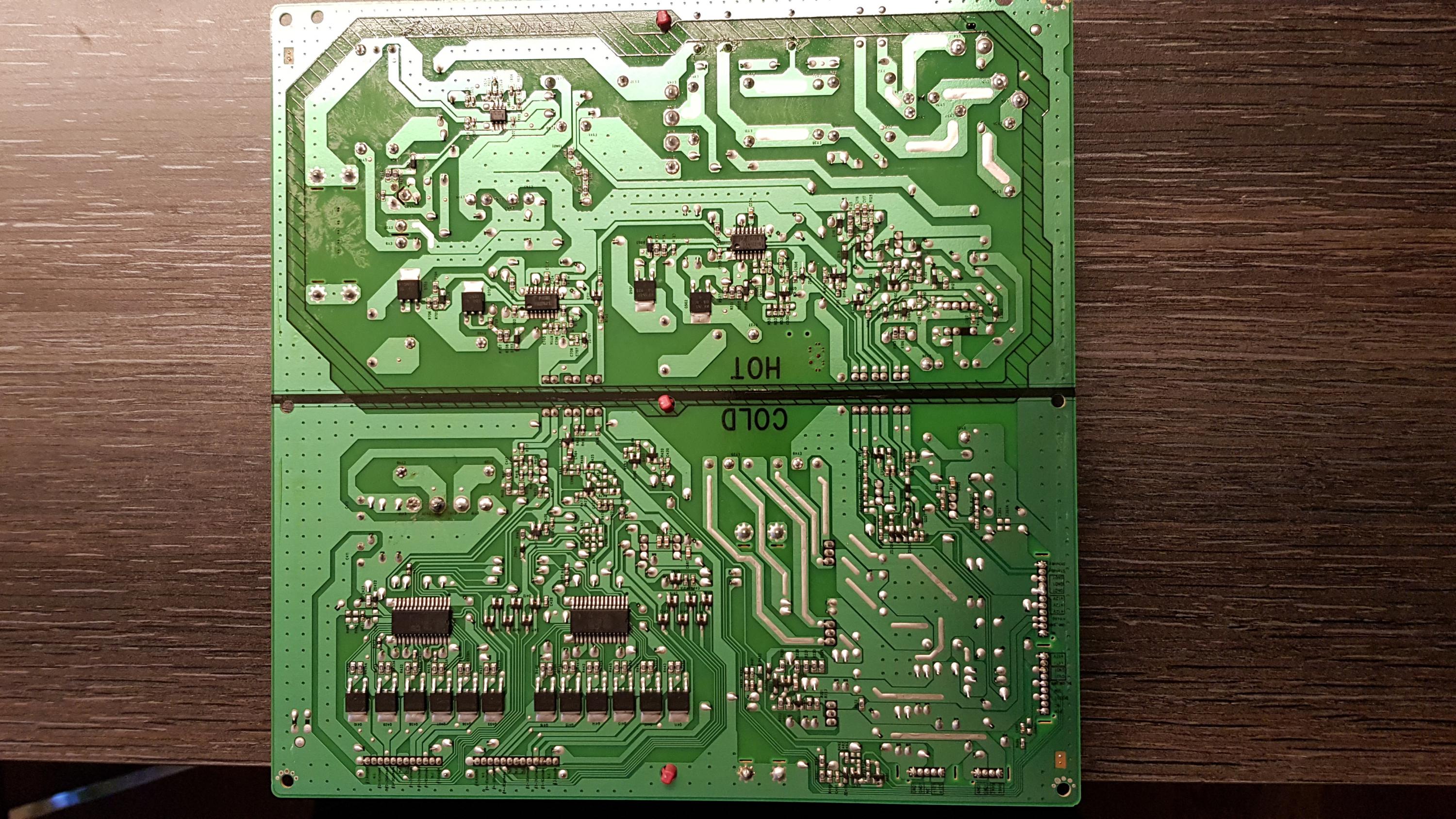

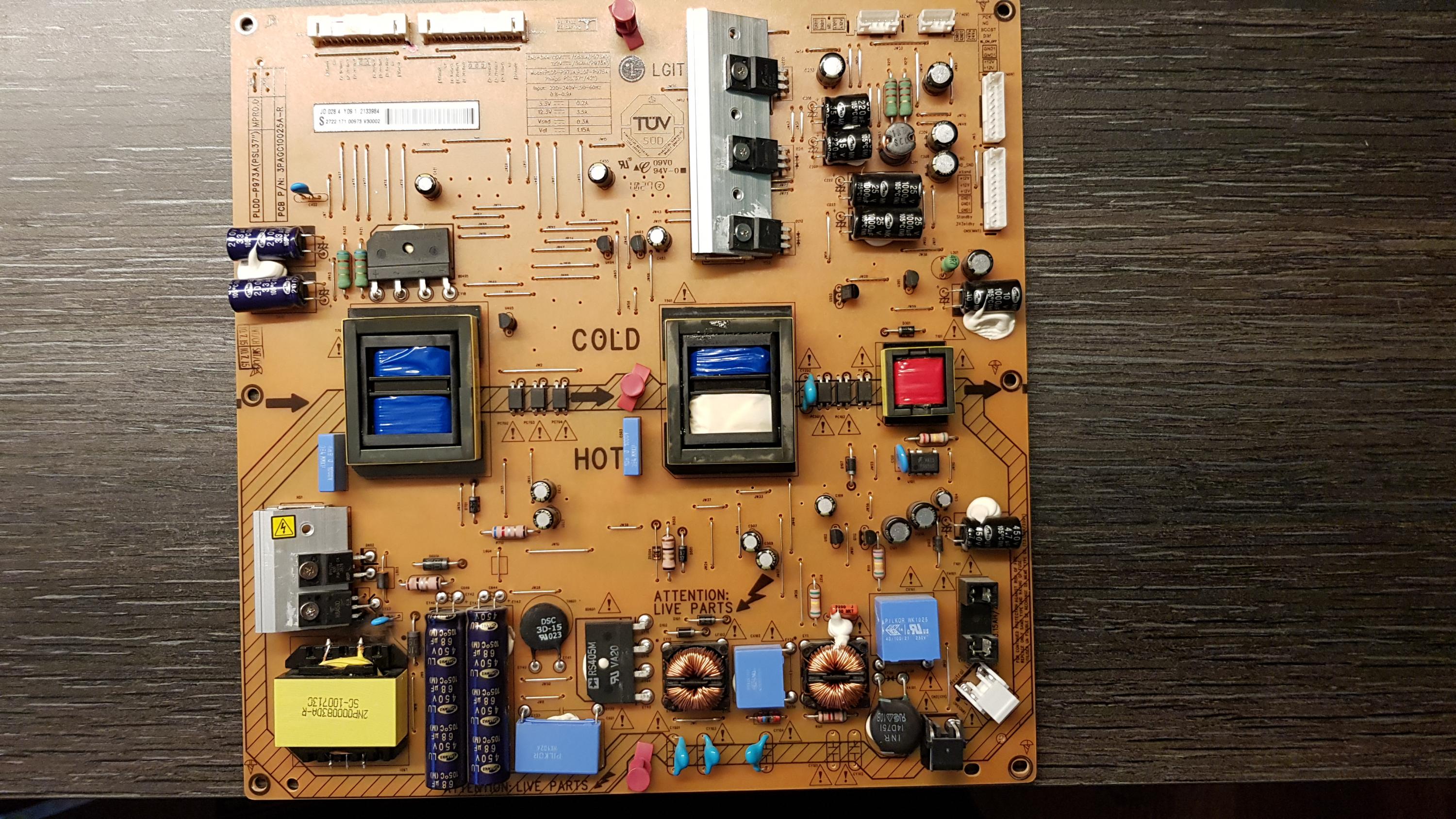

                    Can we see good clear straight shots of the whole bottom side of the power supply board?
                    • storexxm
                      • Oct 2012
                      • 107
                      • Vienna
                      For sure!
                        What were the results when you checked those two mosfets on the heatsink alongside the blue capacitor.
                        What is written on that capacitor?

                          The blue one says:
                          471k
                          1kv
                          Measured 15k-20k ohm
                          Mosfet Q602
                          1-2 28k
                          2-3 14k
                          1-3 9,5k
                          Diode D602
                          9,1k
                          L603
                          0,3 Ohm
                          D601
                          96k or 1,00M depends on + -
                          R613
                          0,3 Ohm
                          TH601
                          3,3 Ohm

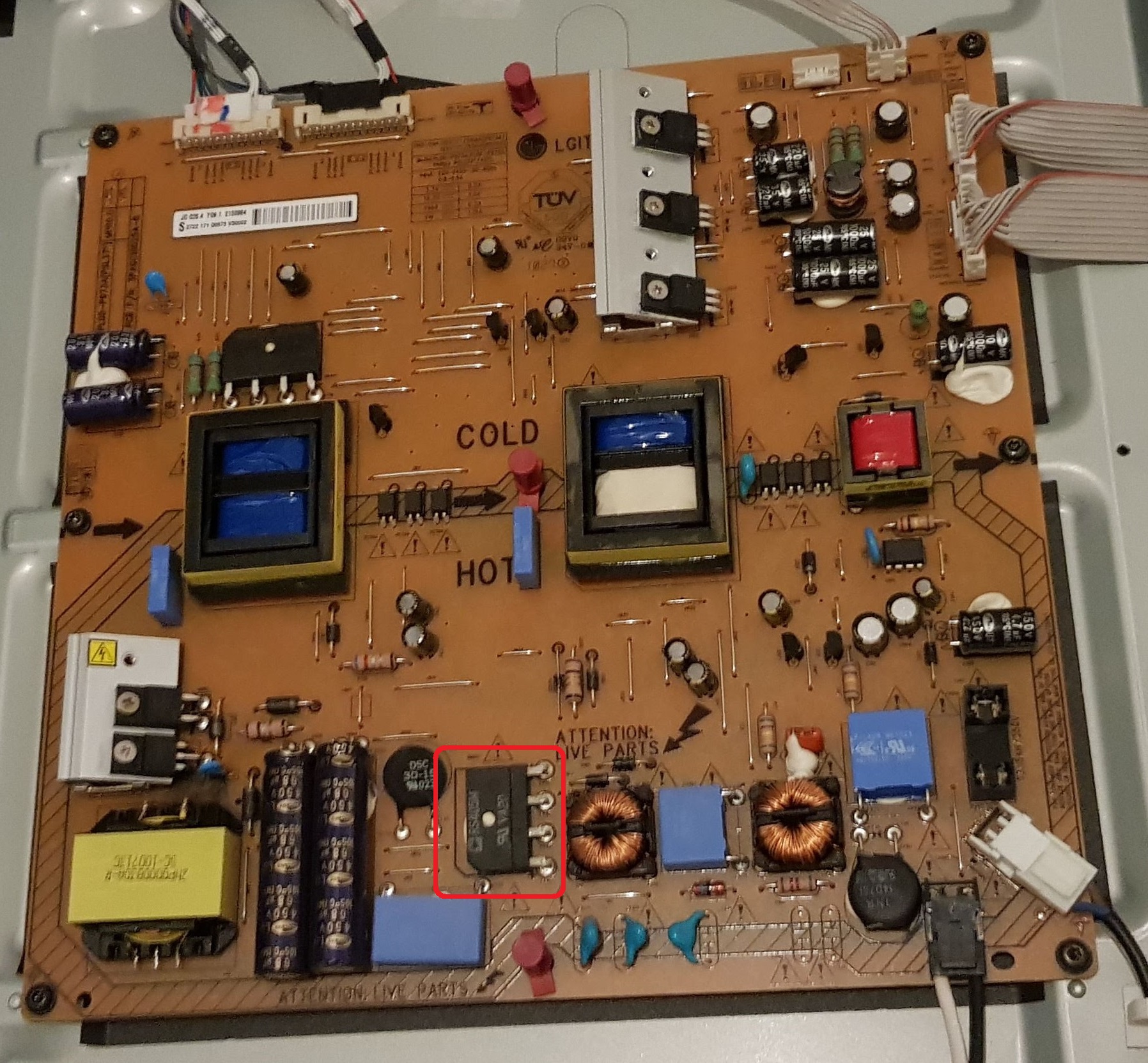

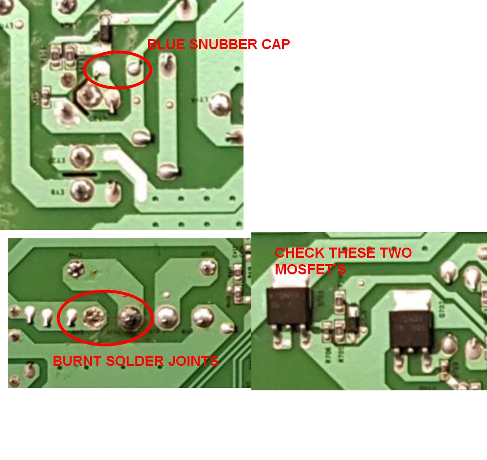

                                1) Looking at the solder joints of the Blue Snubber cap for the PFC MOSFET, it does not looks like it was replaced, I do not see any flux residue at all, but then the pictures may not be showing it.
                                2) There is burnt solder joints in the transformer legs, you need to clean it up and re-solder them well. It looks like it has been arcing for quite a while.
                                3) Check those two MOSFET's to make sure they are not shorted.
                                4) You should also check all other solder joints real well too.

                                  Hello budm. Honestly when i looked at the board closer i had the same thought... looks like this condenser is original... but where are those burnt marks at the surface? From the yellow coil? Will check the two mosfets for a short. Didn't measure on the bottom side yet (shame)

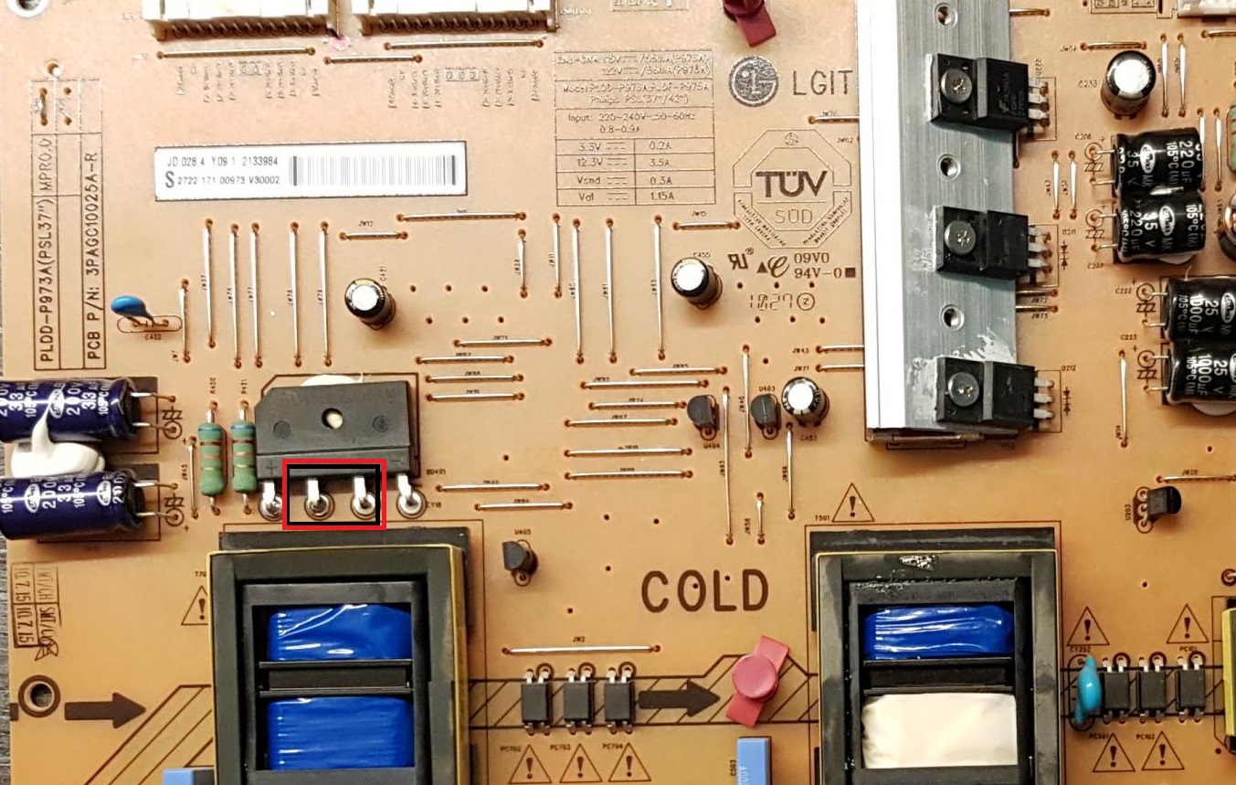

                                    Thanks for your tips!!!
                                    Make sure to look real close at those solder joints I marked in the picture.

                                      • storexxm
                                        • Oct 2012
                                        • 107
                                        • Vienna
                                        Ooops. Those solder joints u marked... BD401
                                        The two middle legs are a short !
                                        Thank u budm! Can this be the issue ?
                                        Part No. says: D4SBL20U and smaller letters 6304 afterwards.
                                        Is the D4SBL20U enough to look for a new one?
