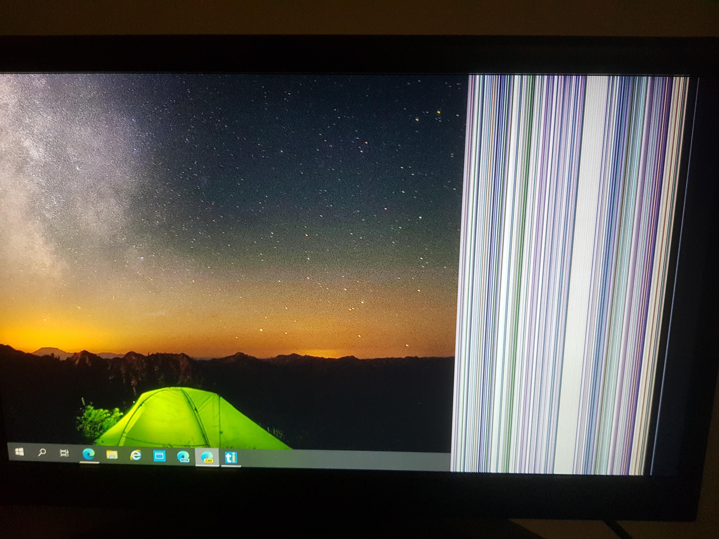

AOC led monitor
  • rigeback
    • Mar 2011
    • 421
    • Malta
    AOC led monitor
    Hey Guys, I have problem with a power supply board which I think is not starting up since there is no 5V.
    The board has a PWM Controller LD7576AGR (IC901) and might be bad according another post although there is 105V on the photocoupler pins.
    I changed the caps in the high voltage zone hoping for a quick fix but this is more complicated and not sure where go from her.
    Any thoughts appreciated.
    Last edited by rigeback; 10-18-2020, 02:34 PM. Reason: attachments
  • R_J
    • Jun 2012
    • 9633
    Re: AOC led monitor
    What voltage do you have ACROSS the main filter, C907? check R924, it should read 0.47Ω.
    What photocoupler are you talking about? U902? if that is it, what ground were you using? hot ground or cold ground.
    • rigeback
      • Mar 2011
      • 421
      • Malta
      Re: AOC led monitor
      Yep I thought it was strange when I tested the big cap again and found I had 0 Volts, thought my multimeter was messed up.
      After seeing I wasn't getting 220V on board I tested the cable and low and behold the fuse was blown, not sure when or how this happened maybe before I changed the caps!
      To sum it up I replaced the fuse and every thing works. monitor is up and running.
      Thanks for refreshing my memory.
      Cheers
      • rigeback
        • Mar 2011
        • 421
        • Malta
        Re: AOC led monitor
        New problem with this monitor regarding the panel.
        It has developed a flickering to lines on the R/H side, I have tried adjusting it with display properties which helped a bit but I can see that it could be the panel at fault.
        I am considering the ribbon shim trick although it will be a complete tear down of the panel.
        Any thoughts suggestions??
        • rigeback
          • Mar 2011
          • 421
          • Malta
          Re: AOC led monitor
          Tried the ribbon shim trick but the problem does not seem to be with connectors and I'm thinking there could be some thing wrong with the T-Con?
          anyone had this issue before/
          Much appreciated any thoughts
          • nomoresonys
            • Jan 2013
            • 12323
            • U.S.
            Re: AOC led monitor
            Full model number?
            • rigeback
              • Mar 2011
              • 421
              • Malta
              Re: AOC led monitor
              Hi there,
              Its the led AOC 19" e950SWda the service manual is attached with the first post.
              Most of the panel is good al; though with a quarter missing its a bummer
                by momaka
                03-15-2023, 10:17 PM
              • keepread
                Dell monitor PSU vs Dell laptop PSU
                by keepread
                Hi there!
                Someone gave me their old monitor, it's Dell S2715ht.
                The owner was using it when his PSU began to smell and then to smoke. It literally began to melt. He turned the monitor off, pulled the PSU, and ditched it because it was smelly even after it cooled. So I got the monitor but not the plug.
                Now, I tried to bring the monitor back to life, by plugging one of my many Dell laptop PSUs. They are of the same 19.5V, and the wattage of the laptop PSU is higher than that which the monitor is rated for. Visually, the socket on the monitor seems compatible, and the plug plugs...
                10-30-2025, 04:45 PM
              • wattage
                AOC AG493UCX 49-inch monitor - Firmware request
                by wattage
                Hello Badcaps Community,
                I purchased a preowned AOC monitor that is not working and out of warranty. It was sold as not working. I am looking for guidance on self-repair. In particular, I am after the firmware for the monitor. At the end, I have included monitor model information and links to pics and vids of the issue.
                The problem is that it will not display a picture on any of its inputs. And the on-screen menu does not appear. The power button works properly. It powers on with the remote as well. But the on-screen menu does not appear, even when not connected to any...
                07-13-2025, 04:41 PM
              • ant3202
                by ant3202
                Hi Everyone
                03-20-2025, 07:30 PM
              • Rick_1234
                LG 23MP55HQ LED Monitor turns off after a few seconds or flickers.
                by Rick_1234
                Good evening, gentlemen.
                I have a problem with my monitor. It turns off after a few seconds or flickers. Shining a flashlight on the screen doesn't show any image, so I guess it's not the "2 seconds to dark" I read in the forum.
                To turn it back on, I have to press the power button twice. Then after a few seconds it turns off again or flickers. See video.
                https://drive.google.com/file/d/1L6S...ew?usp=sharing
                Things I tried
                - Bought a new AC adapter thinking that was the problem but the problem...
                06-22-2024, 04:44 PM
