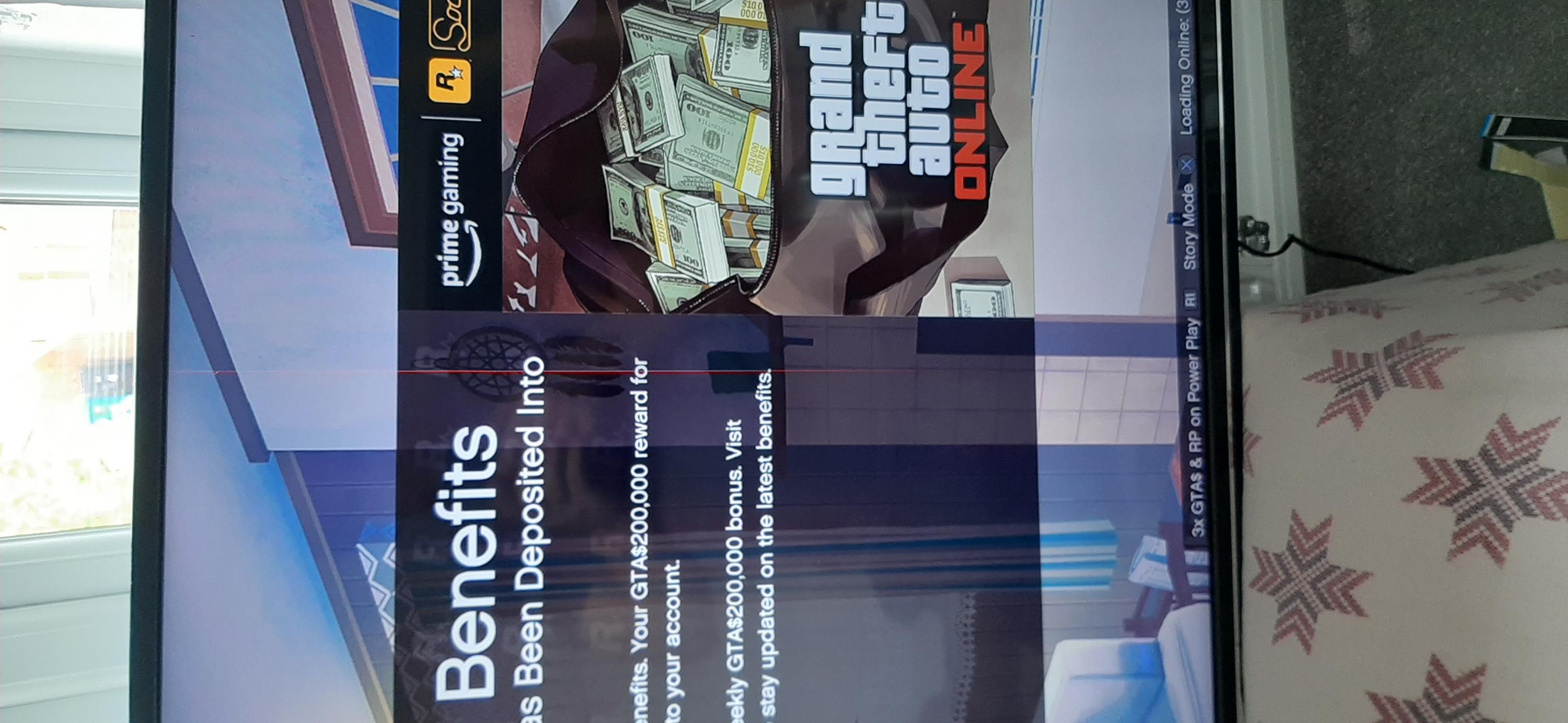

    55 inch vestel linsar with half line on the screen
    Hi does anyone know how to fix this or had this before I have checked tabs changed ribbons but still no different
  • adamp91gvm
    • Jan 2014
    • 706
    • uk
    Re: 55 inch vestel linsar with half line on the screen
    Sorry this is the pic

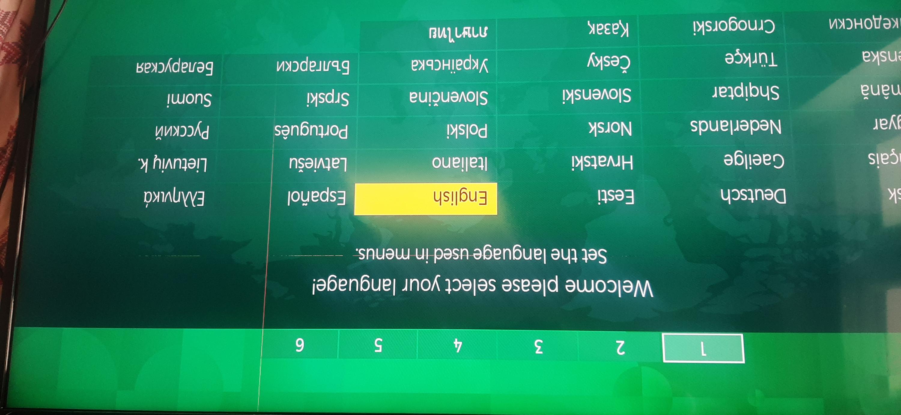

      which model No.?
      can you finish the first installation after you reset it from service menu ( Not from setting menu ) and play signal feed to show us photo of the issue..! did you clean LVDS too?

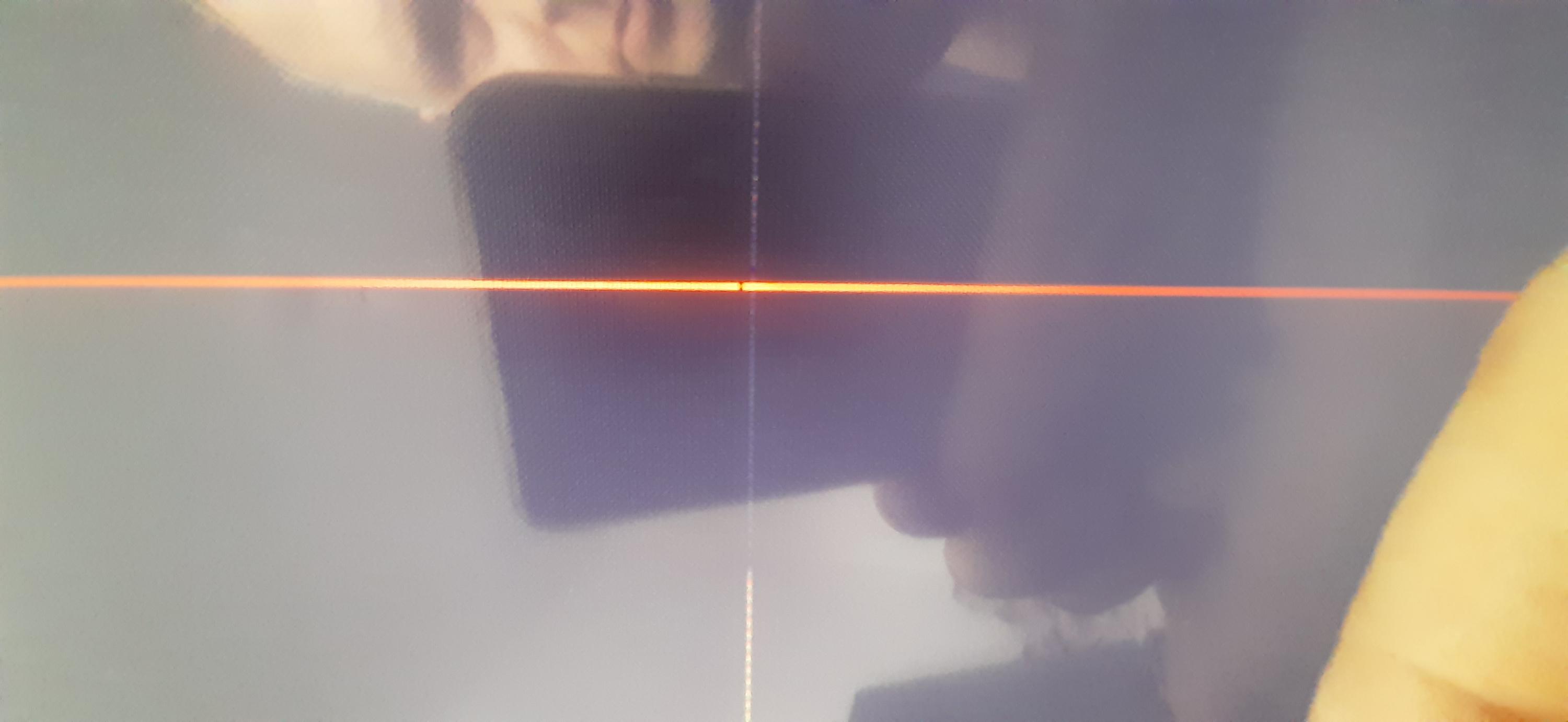

            the line at the 3/4 right side correct?
            if you remove one ribbon on the effected side... did you got clear white screen or there also the line.. also you have on the effected side at the panel lower boards U ribbon cable did you check it... and what it will show if you disconnected it ?
              It's a clear white screen if its disconnected Al's checked the connection ribbon between the two boards
                dead pixel.

                    yes... but before you need to take MRT
                    focused x10 your camera on the line to see how they are dead LOL
                      Looks like 1 dead
