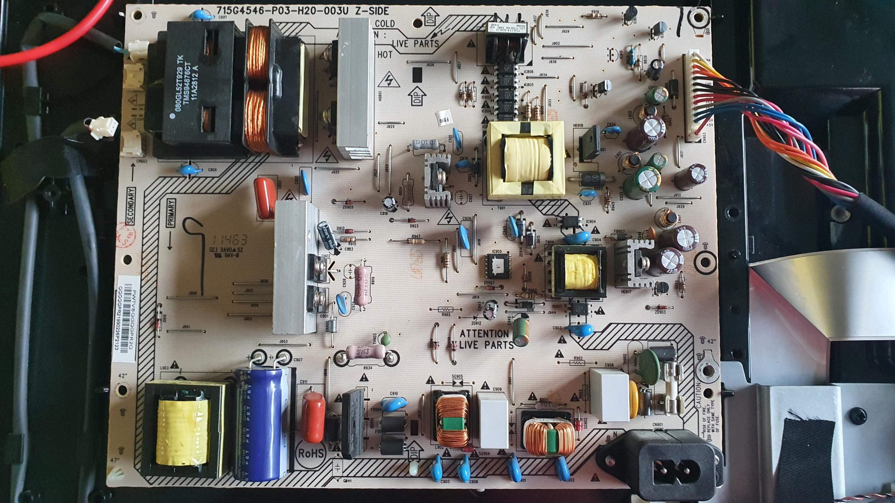

    Hello Guys
    This time ive got an 4606 again but with totally different issue
    When powering on the unit you see the logo for an few second and after that only with an flashlight, ive tested the tv with an 47 SMPS and the all is working fine, So problem must be located in the 42 SMPS.
    When measuring ENA and DIM i get 4,9V and 2,6V this while the tv is powered on.
    Also between PIN 17 and 22 iam getting an High ohm reading 83K.
    Which section do i need to check ?

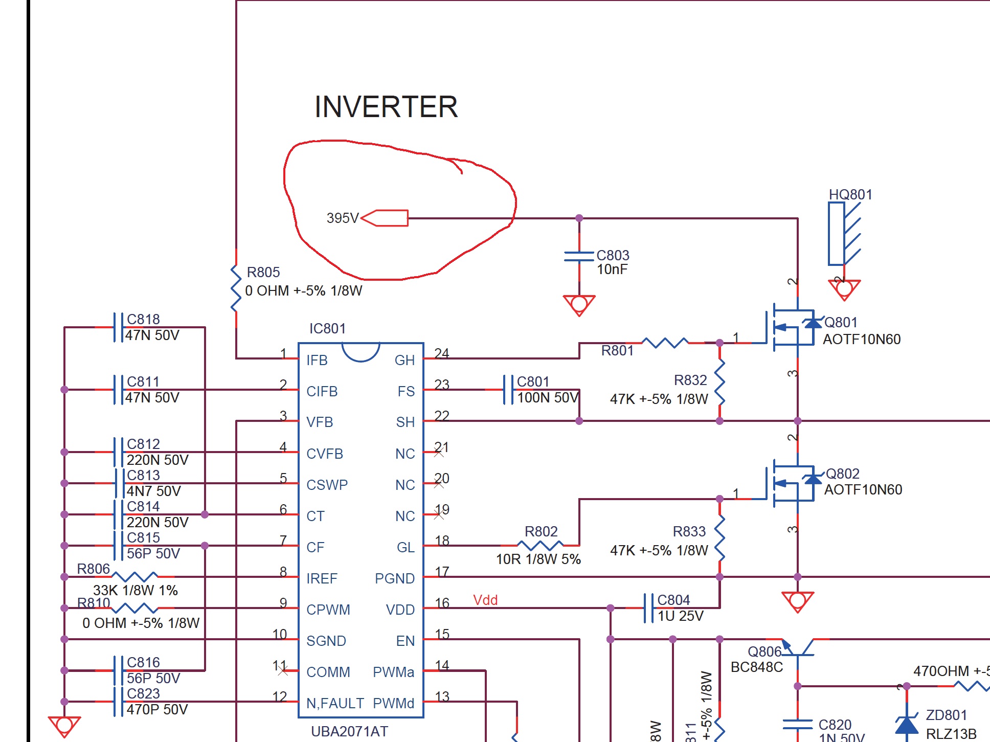

    Changed IC801 (UBA2071AT) no difference

      Iam getting the 395V on the inverter side
        Re: Philips 42PFL4606 No Backlight
        Does the VDD on pin 16 of IC801 stay present after the backlights cut off?
        The 395VDC PFC Boost Voltage also stay when the backlights cut off?
          hello Budm,
          the pfc 395v is present even when BL cut off,
          on pin 16 ive an stable 12v
            Check the resistance of the two high Voltage windings (PIN 5 & 6, 7 & 8) of the inverter transformer T803 and also compare it to the working board.
              Hello Budm
              Both boards measure an 12ohm between pin 5&6 and 7&8

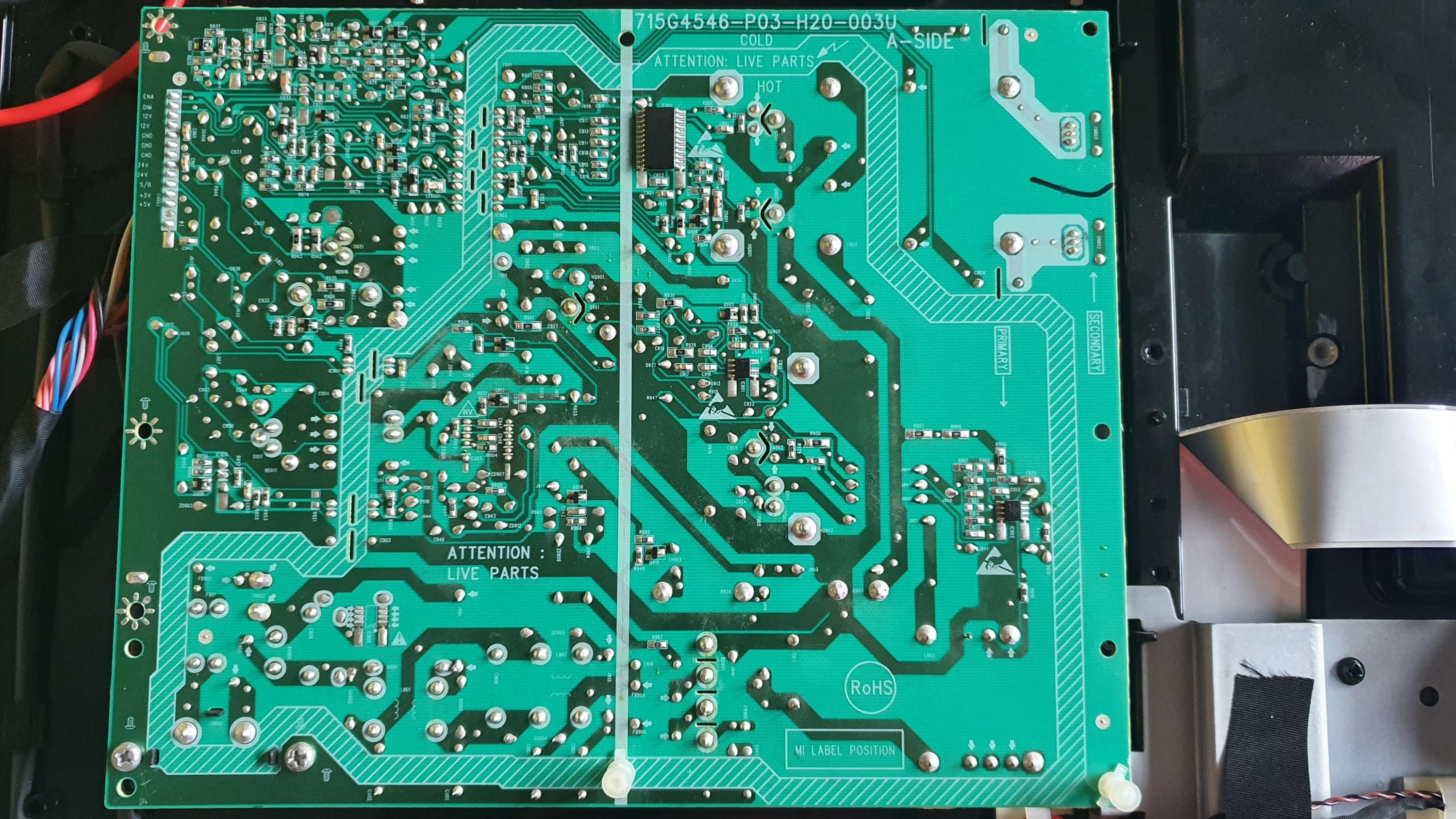

                Hi i did some very intensive research i measured all resistors in the Inverter part.
                Where needed i desoldered them of the board to measure.
                iam not sure how to measure the ceramic capacitors ? any ideas how to do that on a good manor
                  I would have thought that R801 and R892 resistance to be identical.
                  Have you check C802. These high voltage capacitors in series with transformers do tend to fail.
                    Hello
                    C802 is checking out oke, Desoldered it an did an measurement it reading 330nf
                    Did you mean R829 ? and R801
                          What is the Voltage on EN pin 15?
                            Ive got 5.8V on EN pin 15
                              What does that voltage mean ? while measering on the other board i accendently made an short so for now i can not use tjat board
                                That means the Backlights on command is still present on the EN pin but the IC is in protection mode some how.
