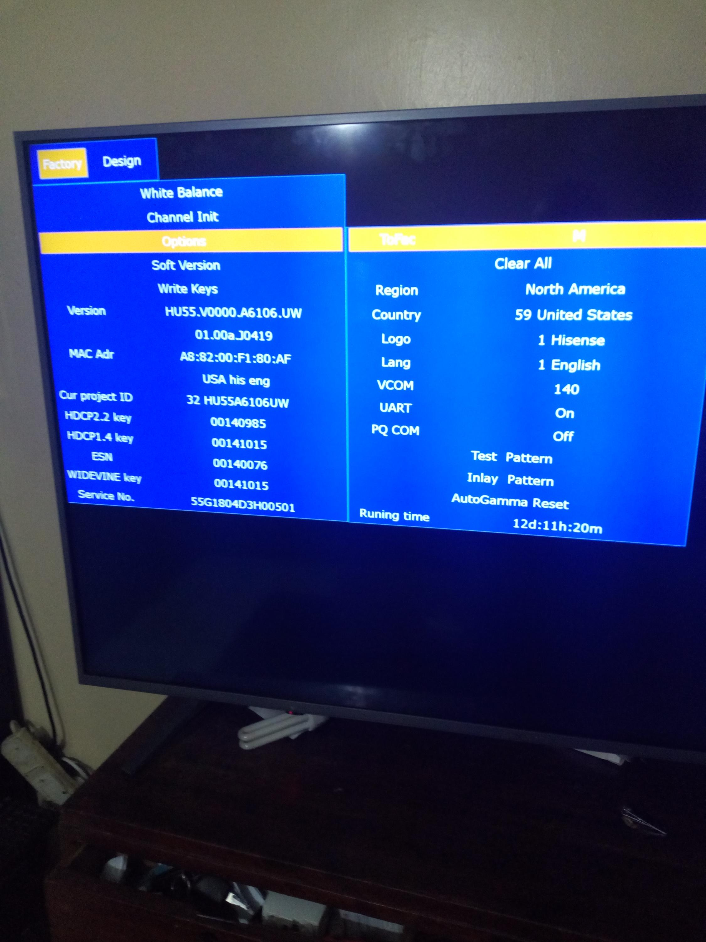

                              I did however manage to get into the service menu... Took a pic.

                                if you renamed the FW as the current model as the replacement boards, you need to use the upgrade method i wrote at my post #28 !!
                                between it show yours now HU55A6106 !!!!! not as you told us H8000 ??? LOL
                                try now from service menu option clear all.. when the tv restart go to setting and make factory reset from there again.

                                  HU55A6106 Is the new boards version. The original was A6103
                                  I realized that the option will not work as on the replacement board there is connector which sends a signal to an oscillator board on the power supply to control the backlights.. So the firmware won't work per say.

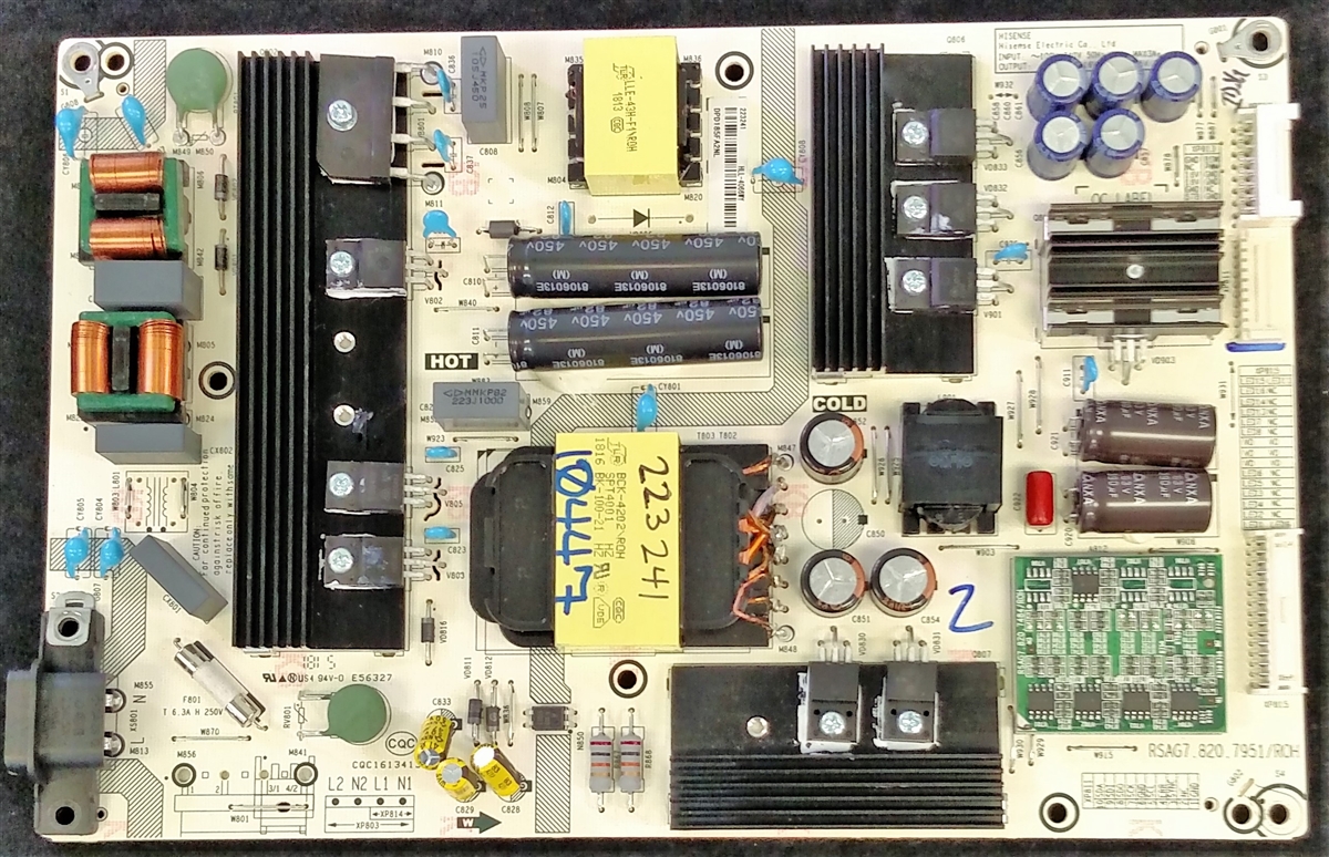

                                  The power supply board for this specific board has an extra board which i assume is a power oscillator.

                                    Your main problem is not mainboard, check the V of the STB pin on psu, if is not over 5v place a jumper SW-STB , if yes place a diode and detach mainboard, leave it to stay and watch if BL comes off after a while, if yes you have bad strips. In alternative, let tv work normally and place voltmeter on SW pin , if when BL comes off the SW pin changes then you have wrong mabo otherwise bad leds.
