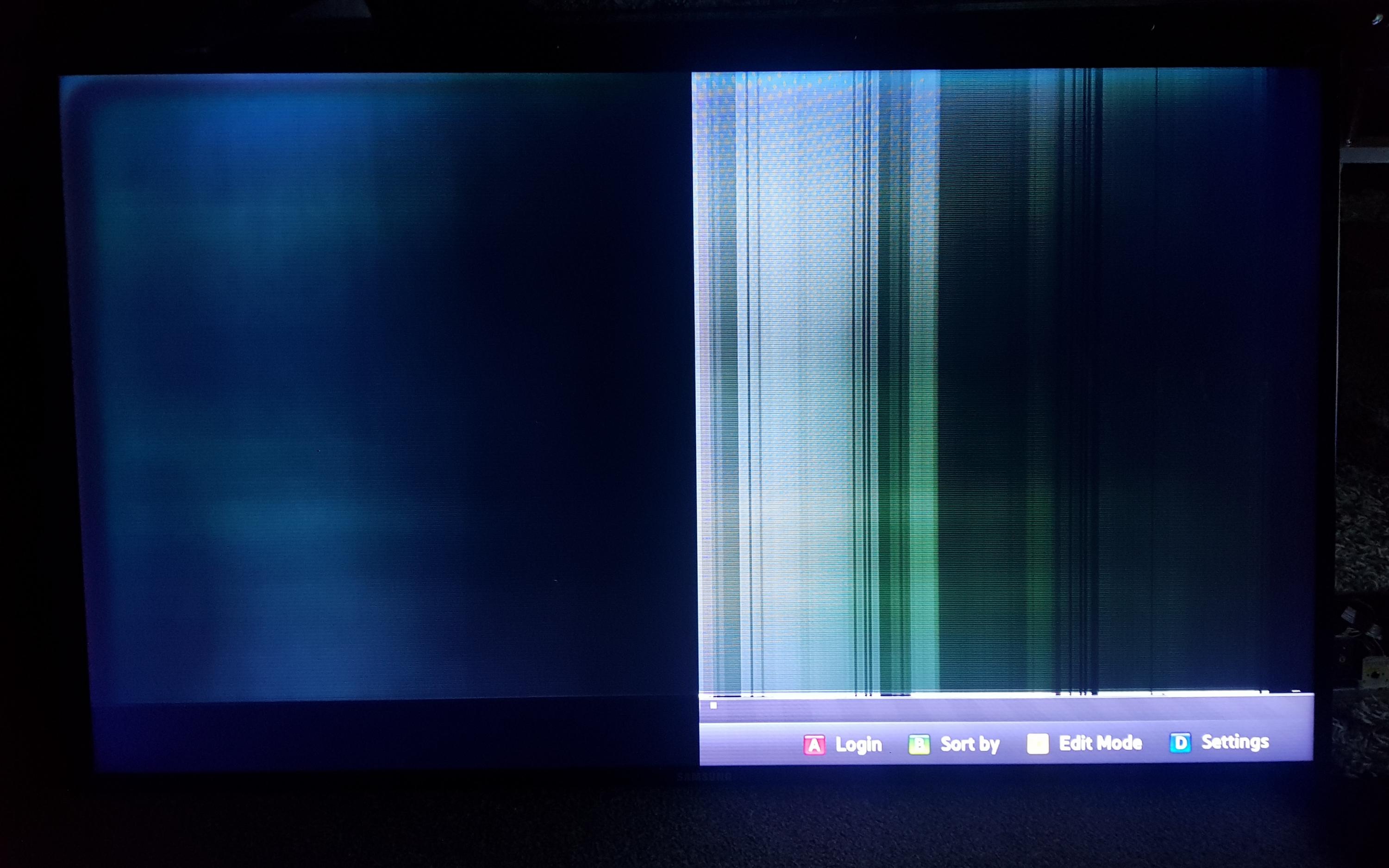

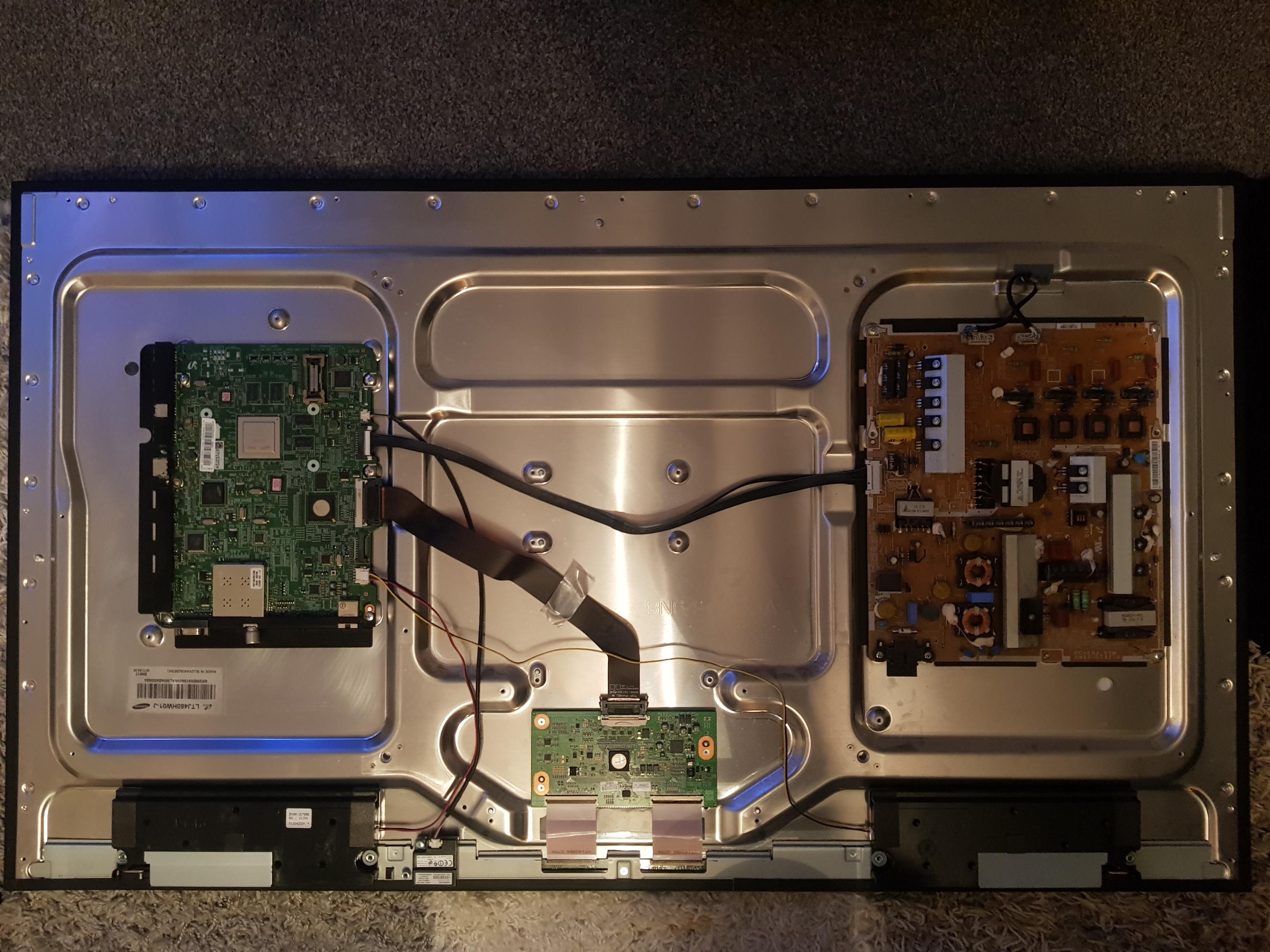

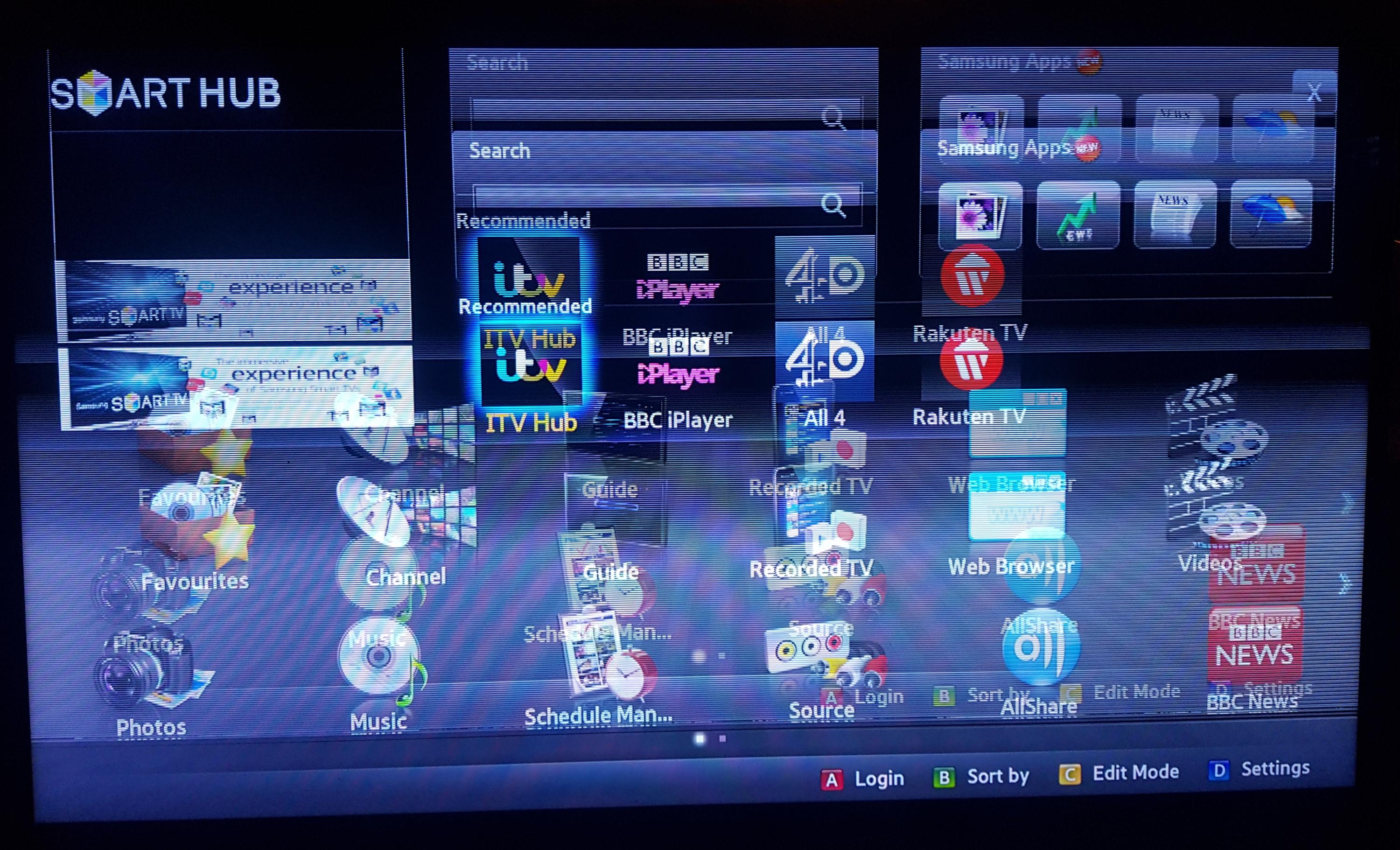

    I have a Samsung UE46D6750 Smart TV.
    The image on the screen is doubled (only way I can think to describe it lol) please see attached pictures.
    The lady who owned it said it was working fine until she lifted it down off the wall. I dont know if this is just coincidence, or may be a factor.

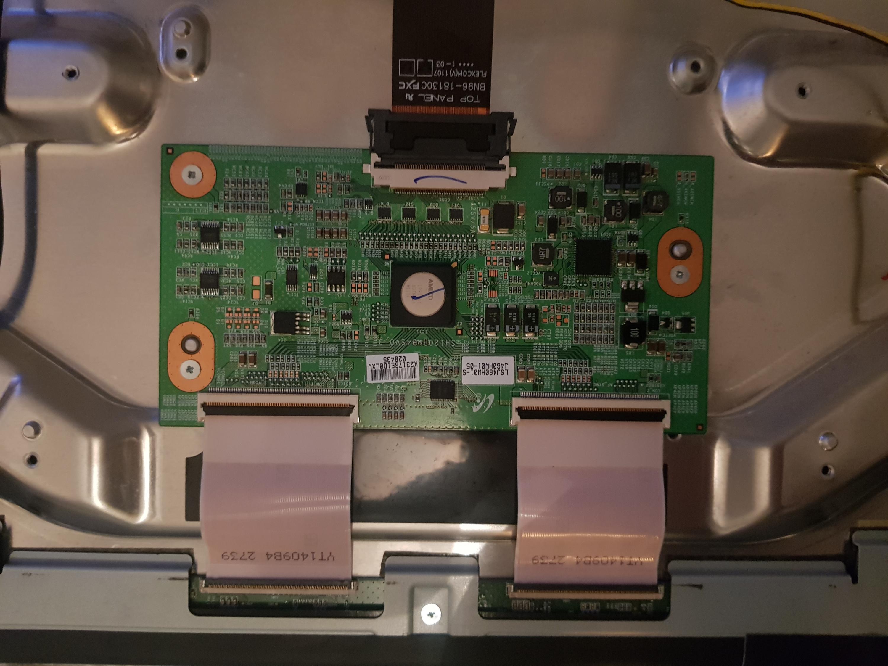

    I have cleaned and re connected all cables from main board to Tcon, and ribbon connections from Tcon to drivers.
    Any help greatly appreciated, thanks in advance

    Power up the tv with only one side connected at a time between the tcon and panel. If one side is good, you can try the tape cutoff method on the bad side.

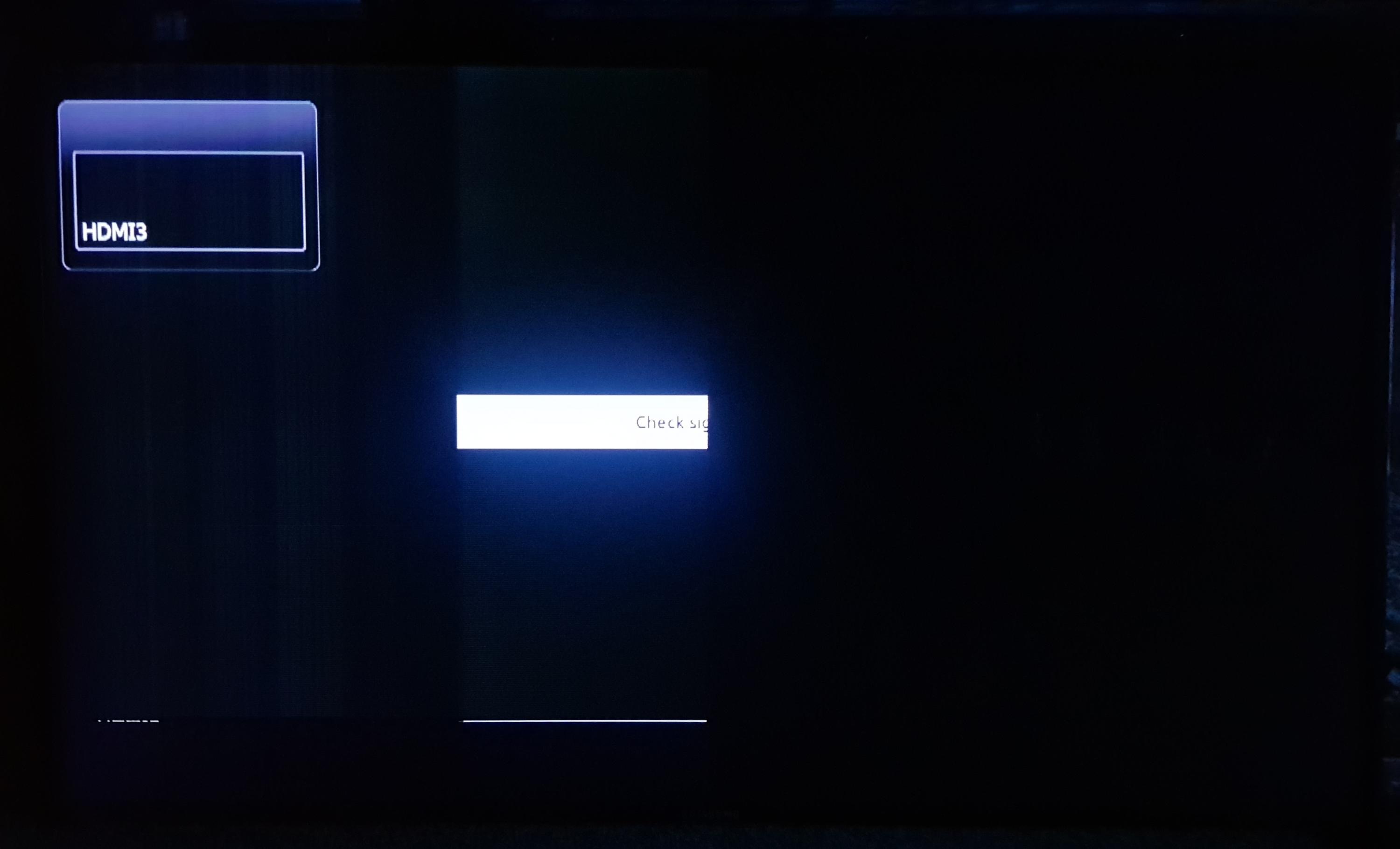

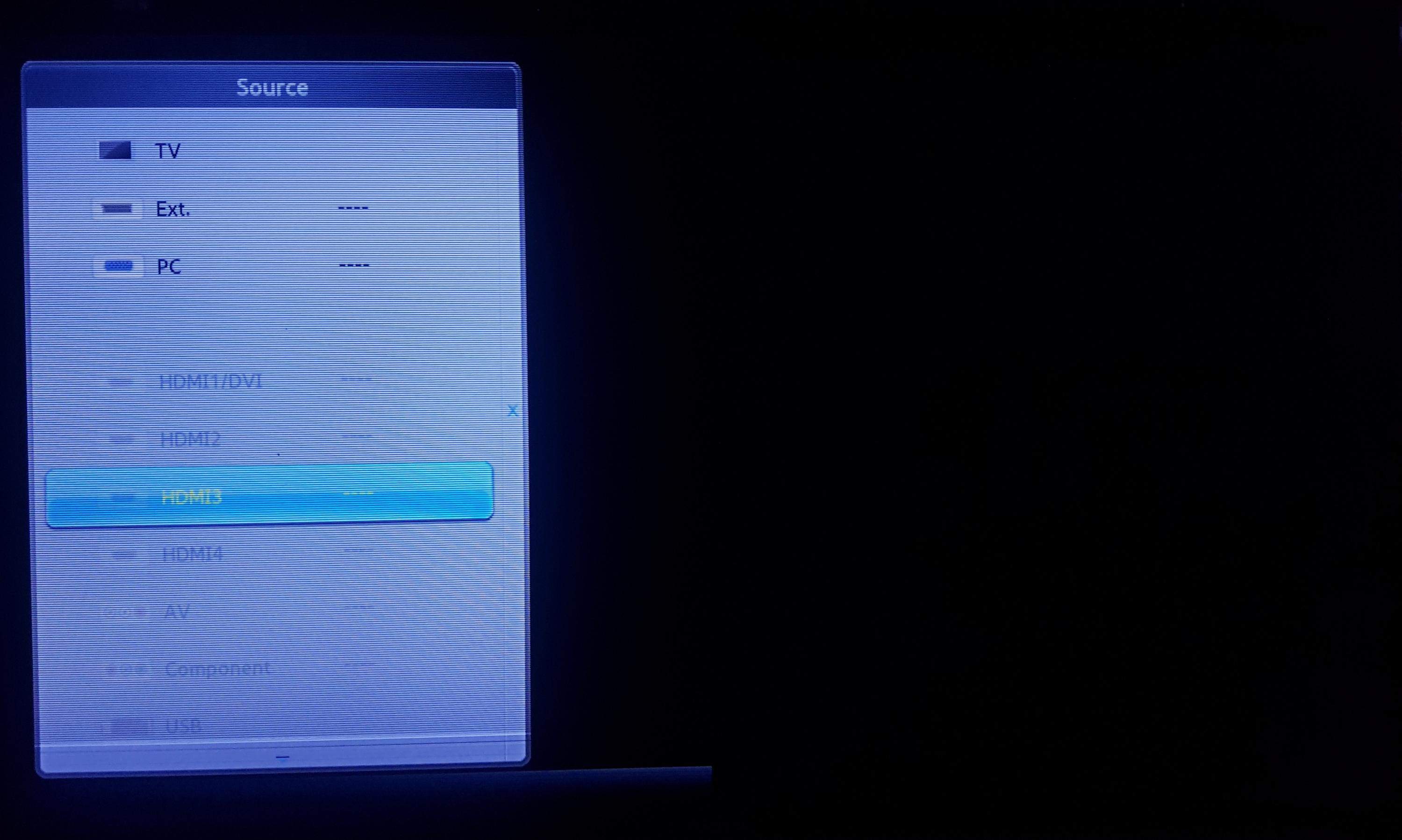

      Here are some pics of what it is like with only 1 side connected at a time.
      Im not familiar with the 'tape cut off method'

          • dick_barton
            • Aug 2015
            • 6643
            • Wales
            Re: Samsung UE46D6750 double image problem
            Hi Bloopeta
            There is a lot of information on this site on the cut-off method if you do a search using the Search box above.
            The fault is extremely similar to a tab issue so perhaps too much pressure was exerted on the one side when taking it down off the wall.
            You could check if any of the small IC mounted on the tab ribbons are running hotter than the others.
            If you put some slight pressure along the side where the defect is does it alter the image?
