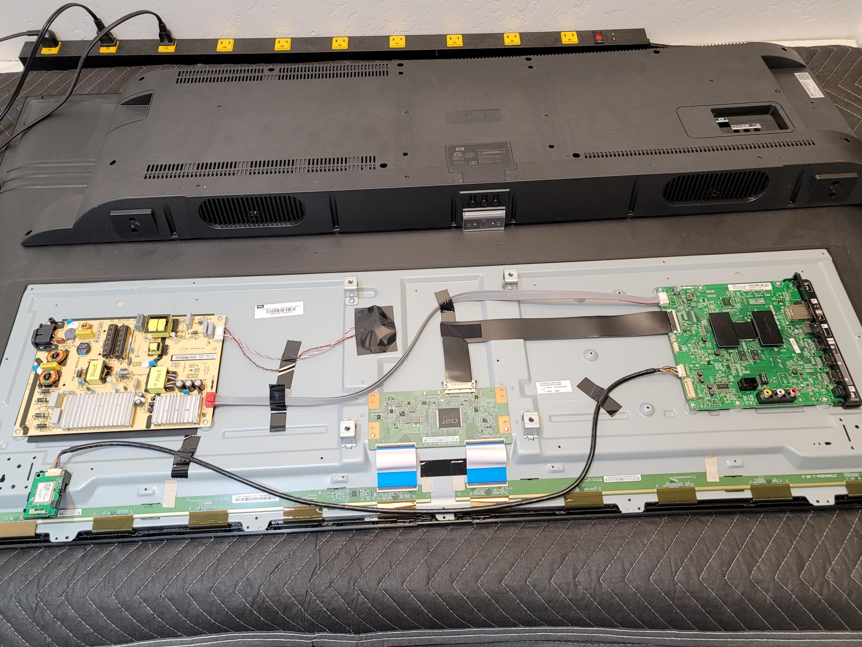

    To start, my electronics repair shop is pretty new to the TV repair game so forgive me asking noob questions. Plus I am fairly new to this forum so if this has already been answered, I may need some help using the search function more efficiently.
    I have a 55" 55S403 that turns on, produces sound and backlight but no picture. Tested voltages on the T-con and mainboard and voltage is present. Honestly, don't exactly know what voltages to look for but we know it at least has voltage present. No panel ribbons are torn. Reseated all connections between boards.
    It sounds like it might be in need of a T-CON replacement..... However, we are new and don't really know what we are doing.

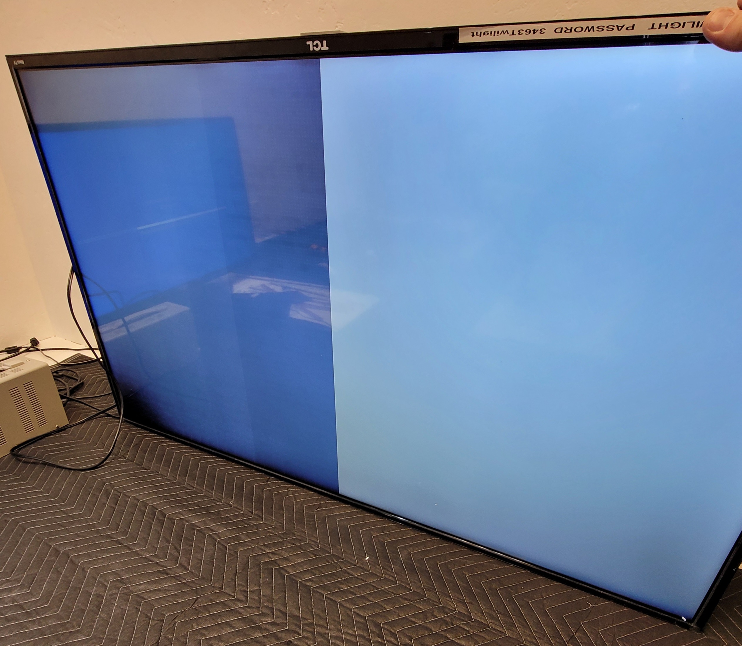

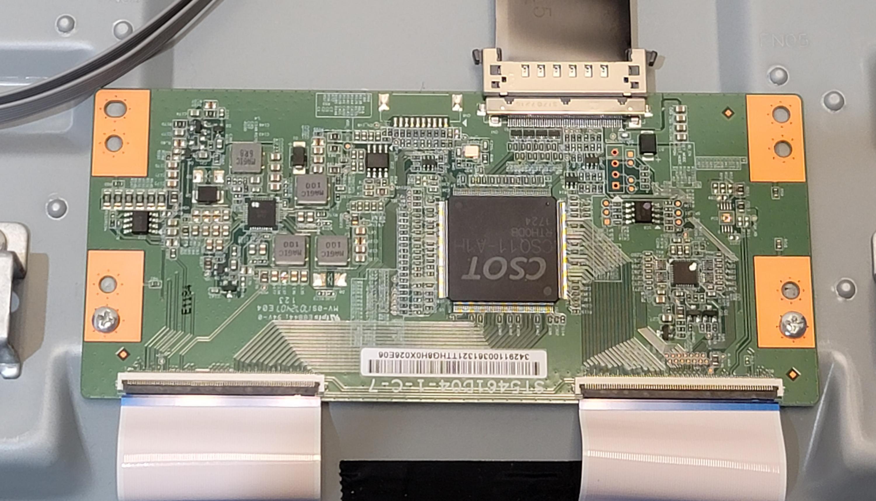

    With a TV turning on with backlight and no video, the first suspect is the tcon board. Some newer models don't have tcons. To make sure it's not the panel, power up the TV with only one ribbon between the tcon and panel connected at a time to see if one side displays a picture. If one side is good, it's a bad panel and not the tcon.

      Show us good clear pictures (using 'Go Advanced' to attach the pictures) of the whole backside of the TV showing all the boards so we can see what we are dealing with.

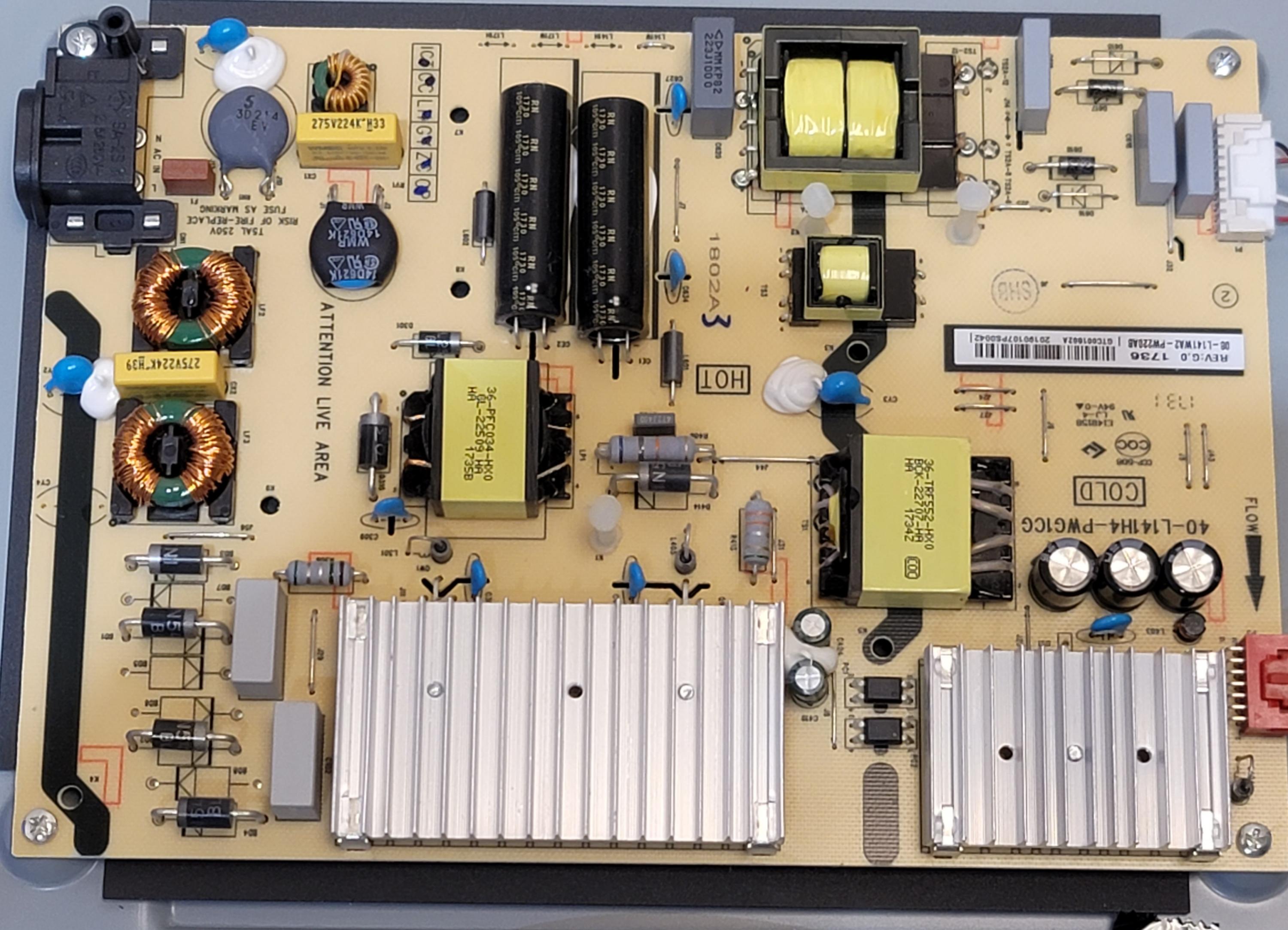

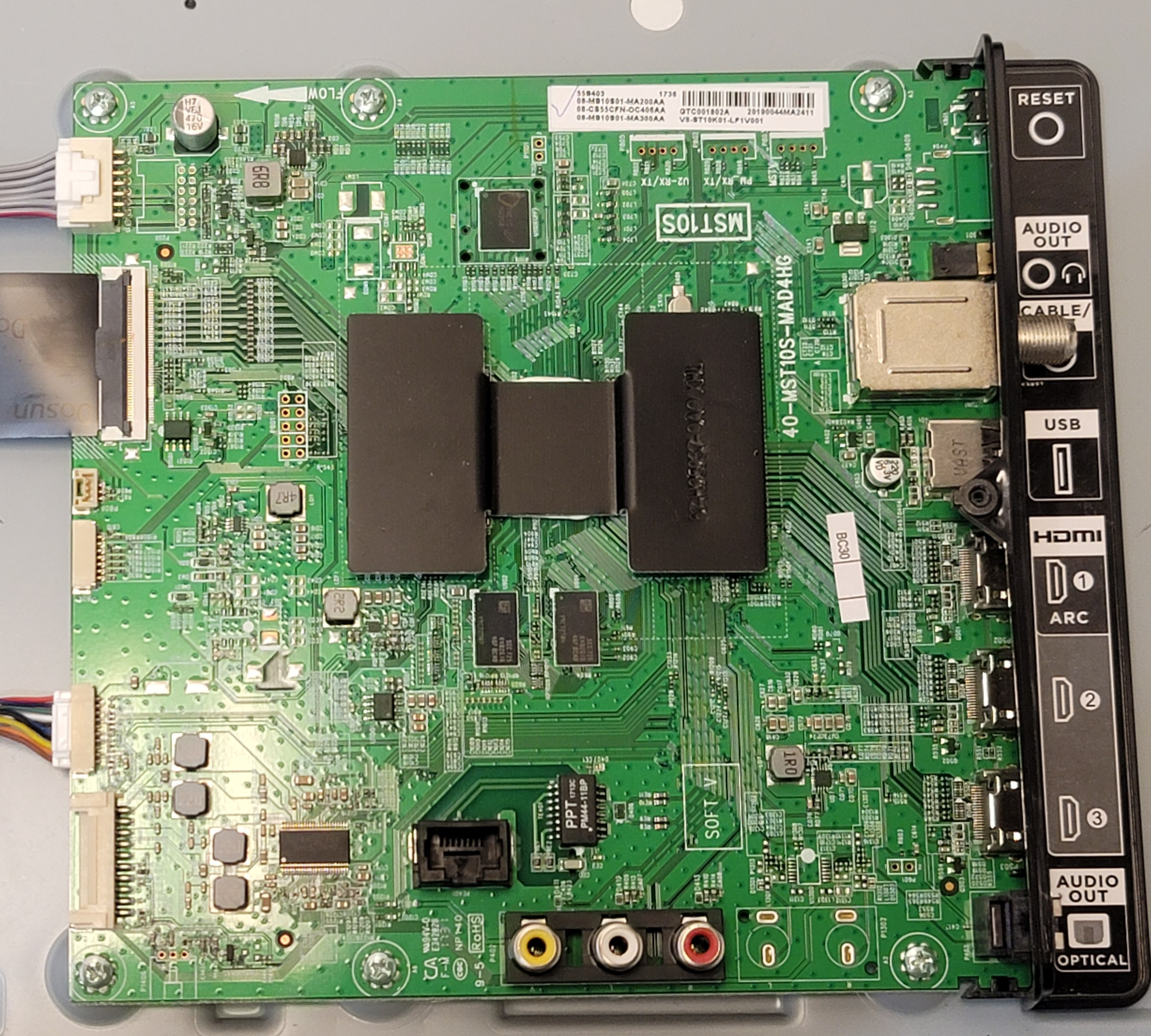

        Here's some pictures of the back of the TV and all the boards. After we unplugged one side of the tcon, this is what the tv looked like. it was mirrored for when we tried the same thing with the other side.
            Checked both sides by unplugging panel to tcon ribbon on left side only then on right side only. Neither side displayed an actual picture. Just black with one side white and vise versa for the other side. I posted a picture above with what it looks like.

              your panel has a problem in the top right corner of the panel... the black "corner". Not sure if you can do anything about it on a TCL set as they are somewhat different than others because of a "roku based" operating system.
