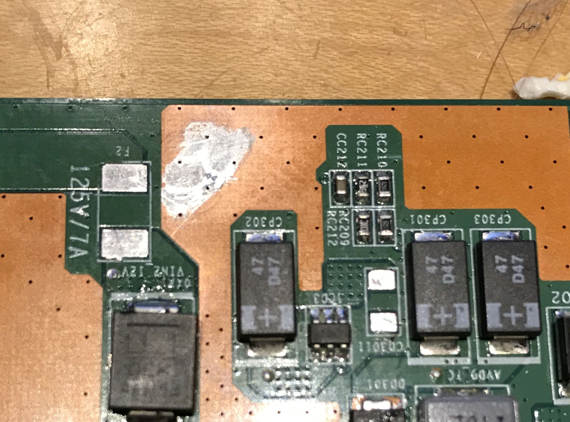

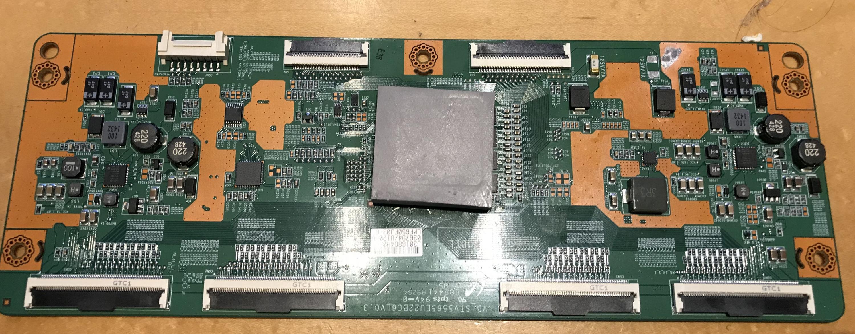

    I have a UN65HU900 that CD3011 on the T-con shorted. It has no markings. Dose anyone know what it may be? I can not find service info anywhere.

    Please attach good clear pictures of the board so we can see what we are dealing with.
      Re: UN65HU9000 T-con
      Here are some pictures. Let me know if you want to see anything else.

        At the risk of sounding like a half a$$ed fix.. When i cant ID a part like that I usually look for an exact size match off a donor board, 9 times out of 10 the value is close enough that the circuit just dosent care.
          What is the P/N of that ICD3?
          i should be the same capacitance of the cap used on the left side of the board where it is connected to the same type of 6-pin IC on the left side..
              Great thinking. I will look.
              T

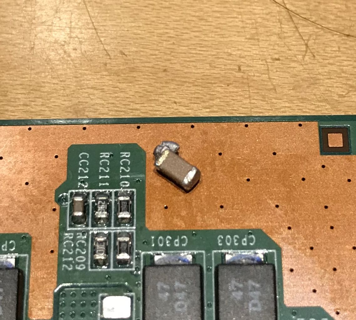

                The part numbers on the left are all the same less the 30. so CD3011 should be the same as CD11. I will see if I can get it off without killing it.

                  Does the tcon work without the cap ? You may have other problems beside it.
                    I have not tried it yet. I was going to hook it up to my bench supply and see if it has any other shorts. I have a replacement on the way. I like to try and fix things like this to learn.
                    T
                      I was able to hookup 12 volts to the board and nothing over heated. I have a new hot air station coming. I will see if I can find out what value CD3011 is.
                      T
                        It is a 10uƒ. With 12 volts applied the current is even lower then before I replaced it.
                        T
                          That has done the trick. It is working. I will let it run for eight hours tomorrow with the cove on to see how it goes.
