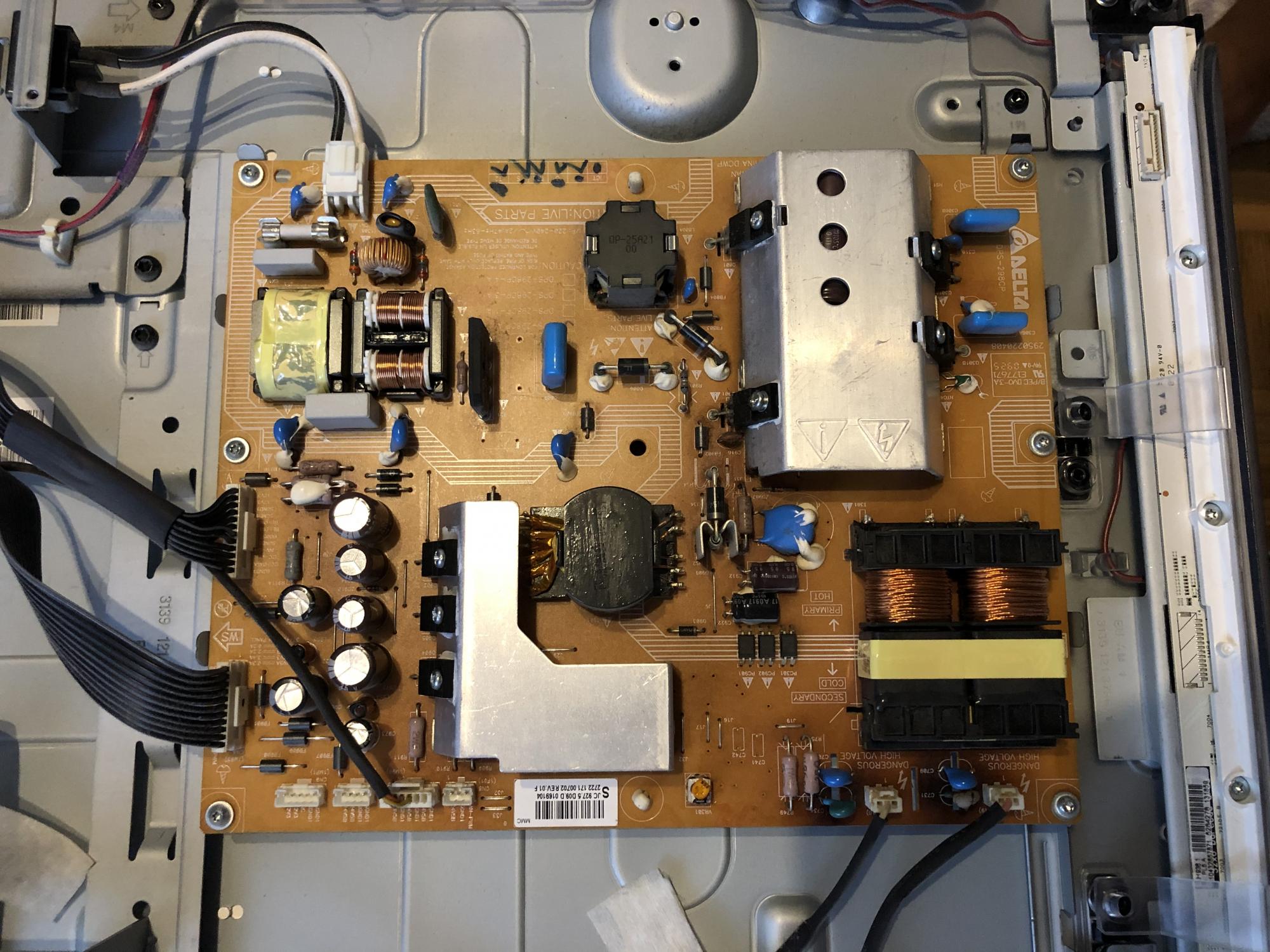

    Can you post an photo of the powersupply board ?

        Re: 42pfl8404h/12 no backlight, sound is OK
        Show us the pictures of the back side of the TV showing all the boards, and then good clear straight shots of the whole power supply board.
        What Voltage measurement have you done so far?

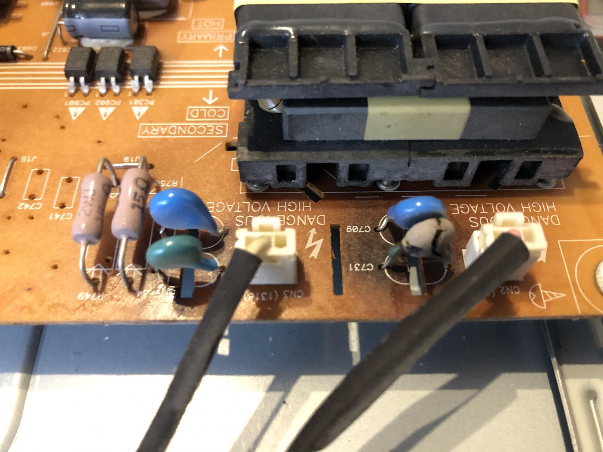

          this isnt a led tv but an CCFL, Most common fault on these boards are the blue caps at the inverter

            Trunks81 you have right. I found this 2 blue little buddy
            I will replace them. It is good to replace all 4 of them?
            What is the text on this broken one? I cant read it, know everyone?
              I found it, this is might be okey
                if iam not wrong it is 2x22 and 2x33 you can read the values on the side that is not broken.
                Better to replace them all. Also they are 5kv you should replace them with 6kv
                  It is 33 6kv like on that ebay link.
                  I have a local store with electronic parts, they only have all this values 33pF and 22pF, but only 5KV, it is okey if i read 6KV on old ones ?
                    no you need to replace them with 6KV
