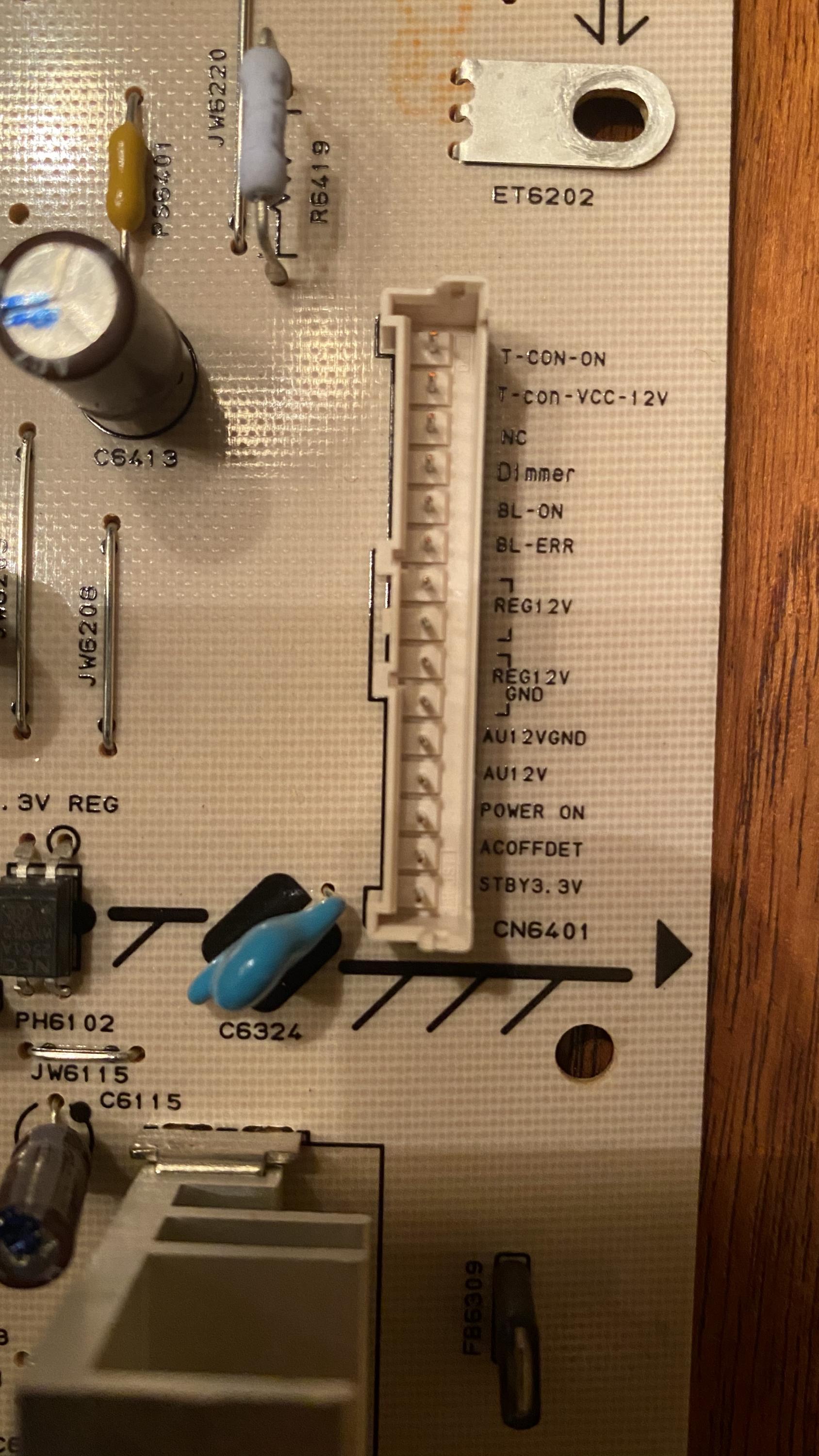

                                      Are you talking about the connector in the attached picture? CN6401? If so, can I use either REG12V and either REG12V GND?
                                        #39
                                        Re: Sony KDL-40EX40B - No power
                                        If my post above is what you asked me to do, the answer is the display did not change. With the jumper in place, I put the black probe into the 6th pin from the bottom (REG12V GND) and red into the 7th pin from the top (REG12V). I then plugged in the power cord but the display did not change. No indication of any kind.
                                          That means that IC is not driving the MOSFETs to produce the needed 12V, so need to look deeper to see if it is bad IC or something is locking out the IC.
