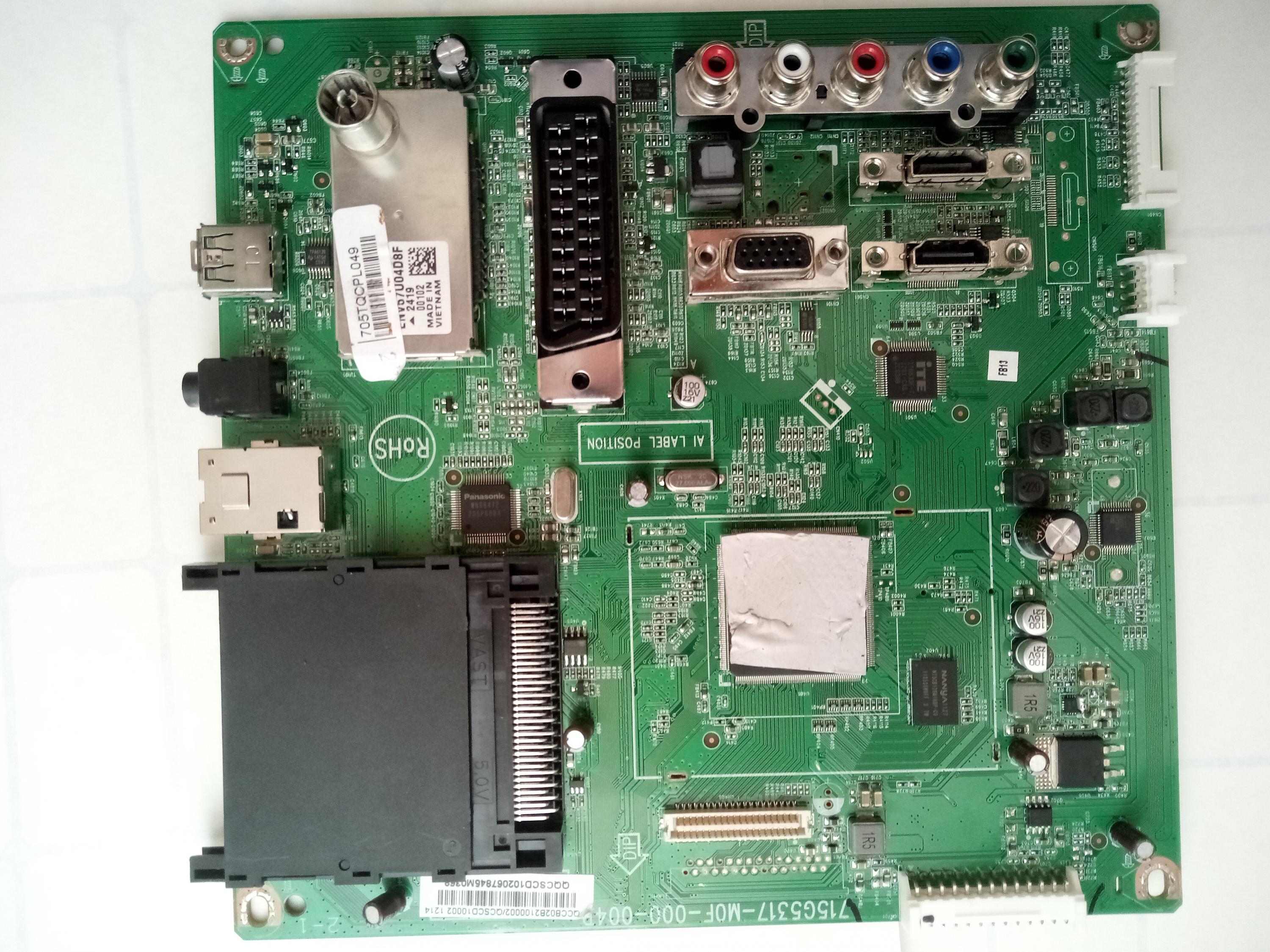

        Re: panasonic TXL 24X5B surface mount zener diode colour codes
        Can we see good clear pictures of the main board and also where the diodes are located?

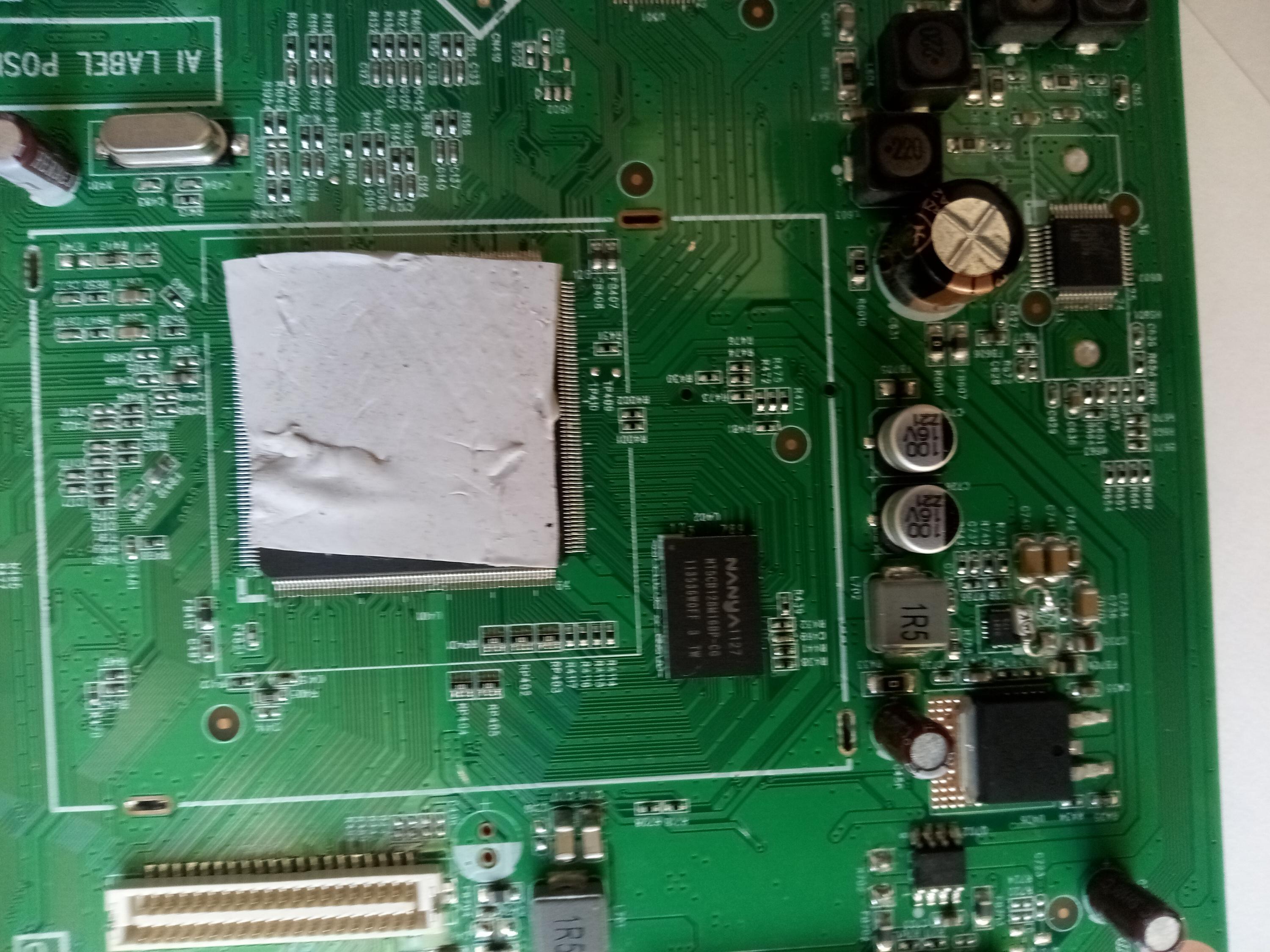

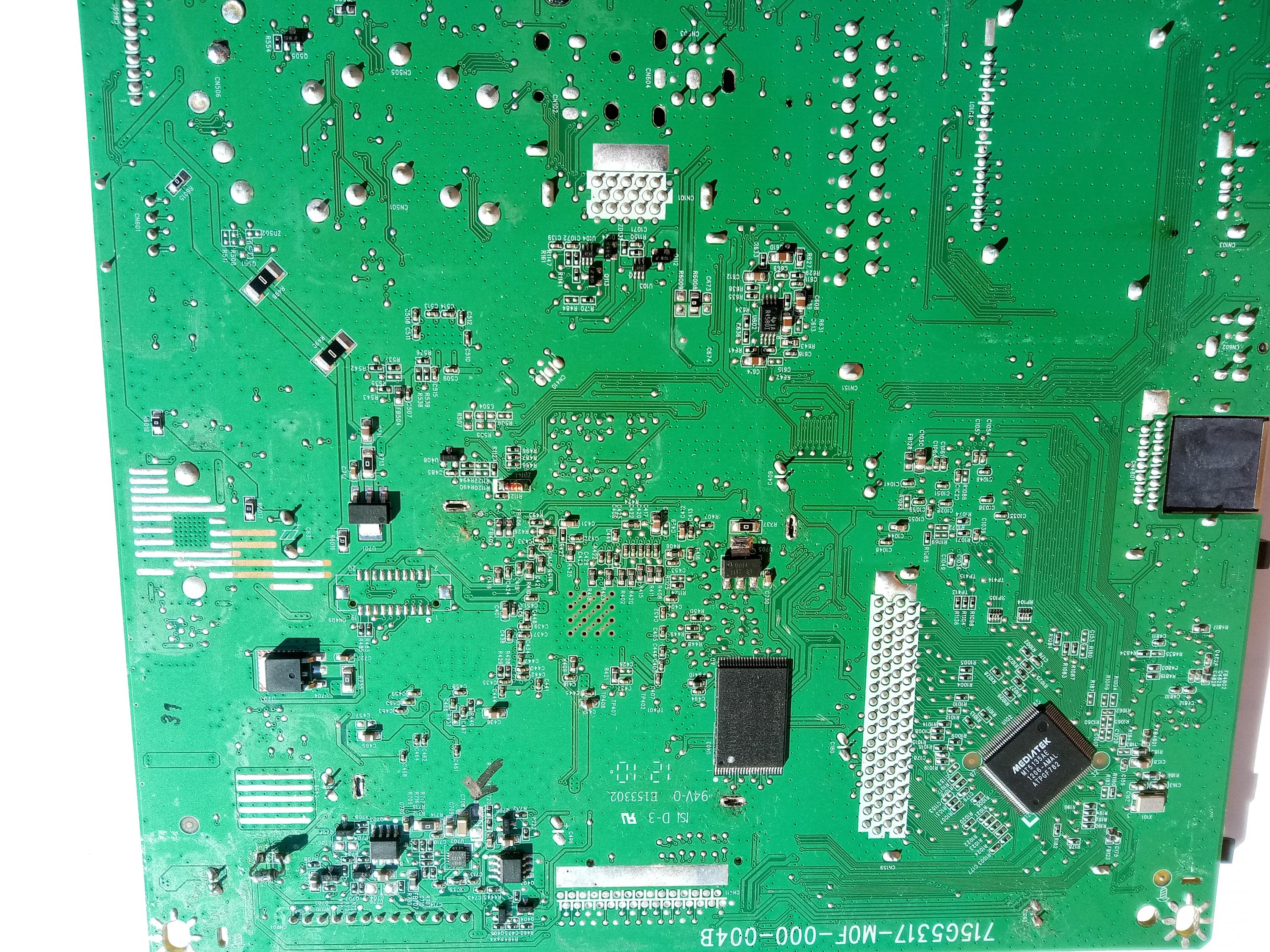

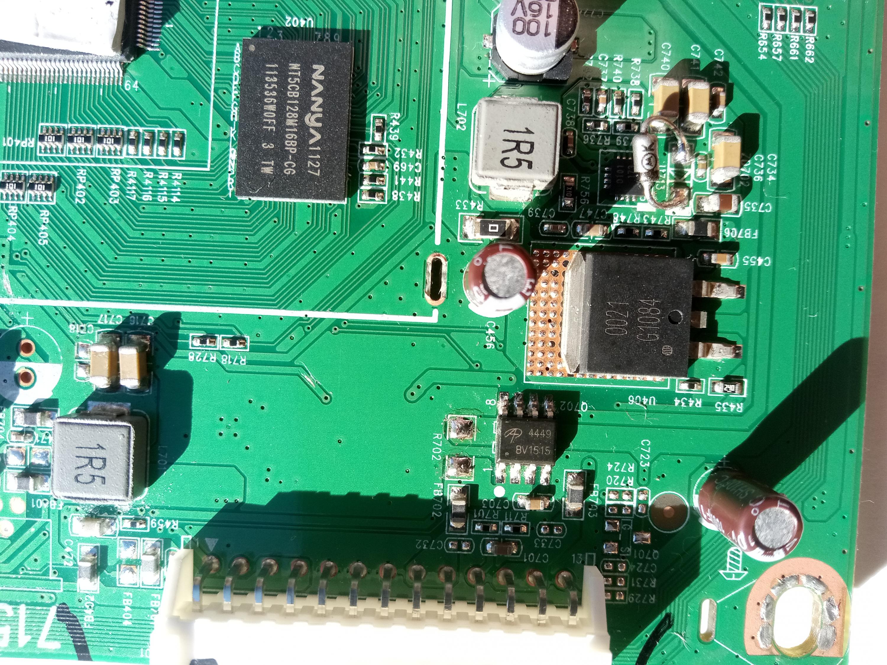

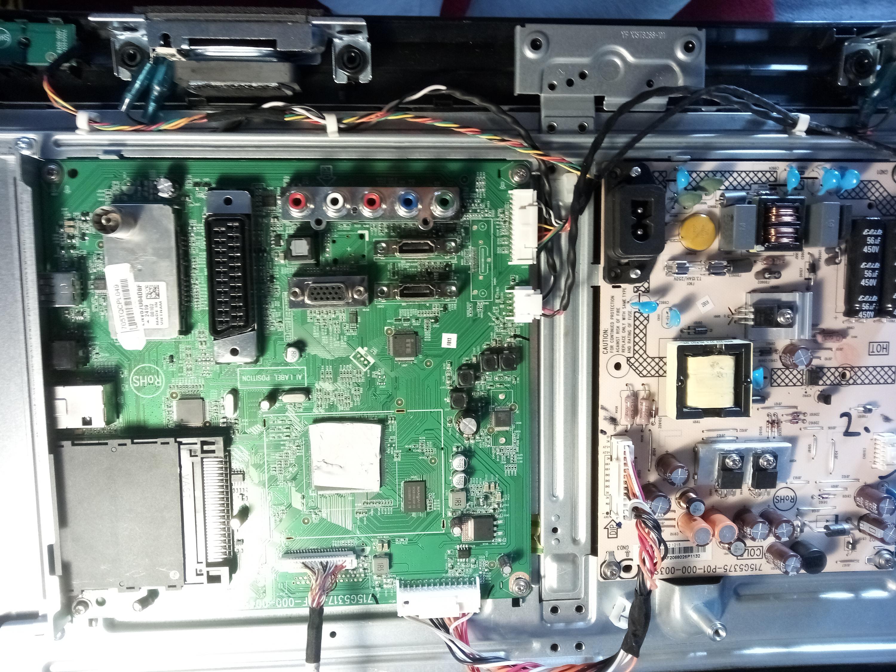

          here are some pics
          i found a good working zener with same colour code in centre of pic 3 so i removed it and tested its zener voltage
          ( with 10k and bench supply)
          it read 5,4 v
          so i fitted tempory 5.6 v diodes (there silver in color )
          i now had 5.2v 3,3v ,
          the 16v supply is 19.5v but thats to be expected as theres no load on it .
          the sby led is not red but rapid flashing green for few seconds then off
          the 3.3v was present on the standby button and goes to 0v when pressed
          at this point i noticed a diode missing from board shown in pic 3 bottom left corner shown as d701
          clearly someone has been here before me ,i dont know the history of this tv as it was a freebee
