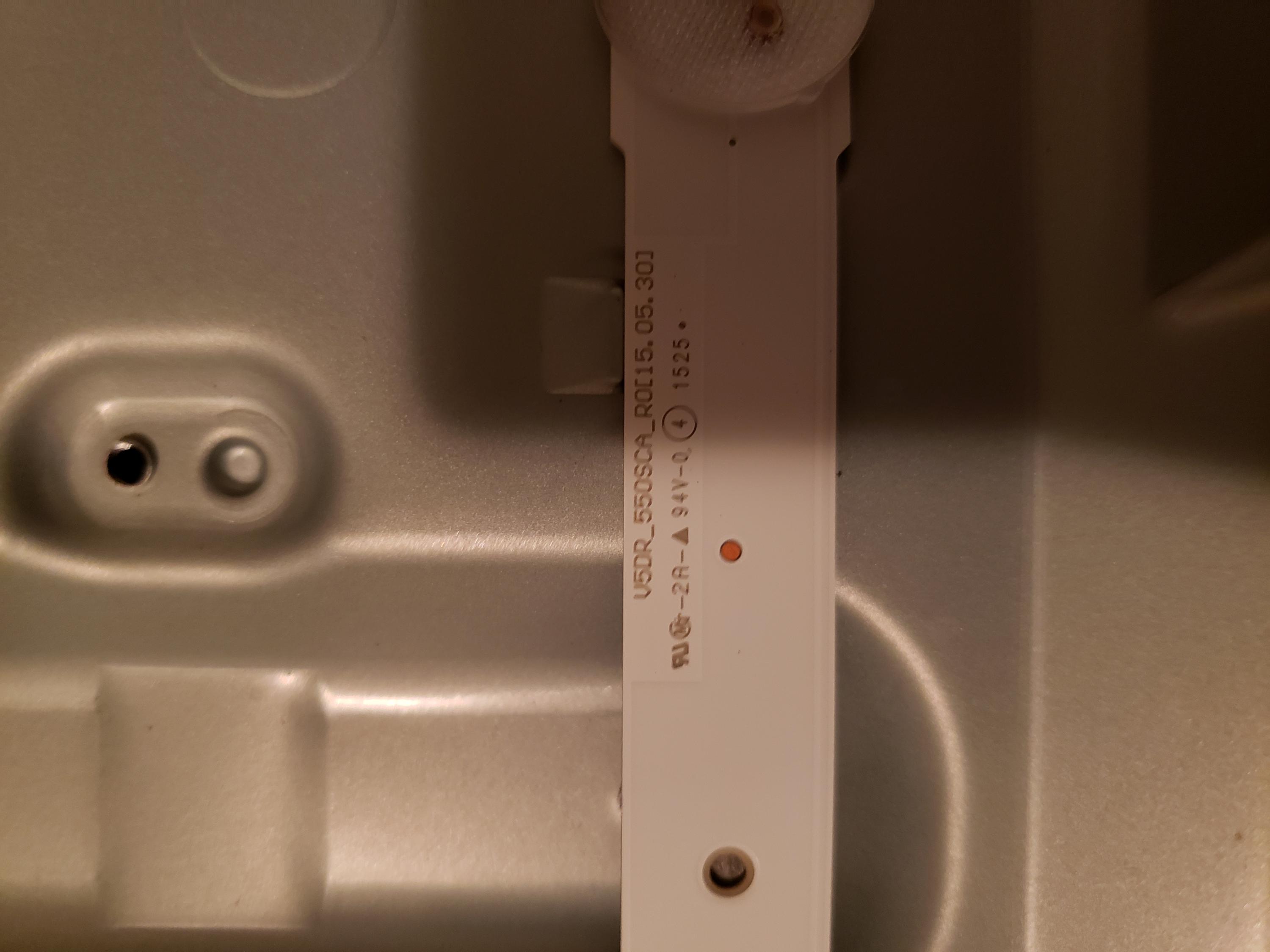

Probably don't have anything laying around that can handle 2 watts.
Would it be safe to test each of the led strips individually? It wouldn't be hard to plug just one in at a time. I can get the pins out of the connector without damaging itLast edited by Foofles; 08-24-2020, 06:47 PM.Comment

So take the Voltage readings on the LED connector again while the LEDs are still working.
May be loose contacts on the LED female connector.Never stop learning

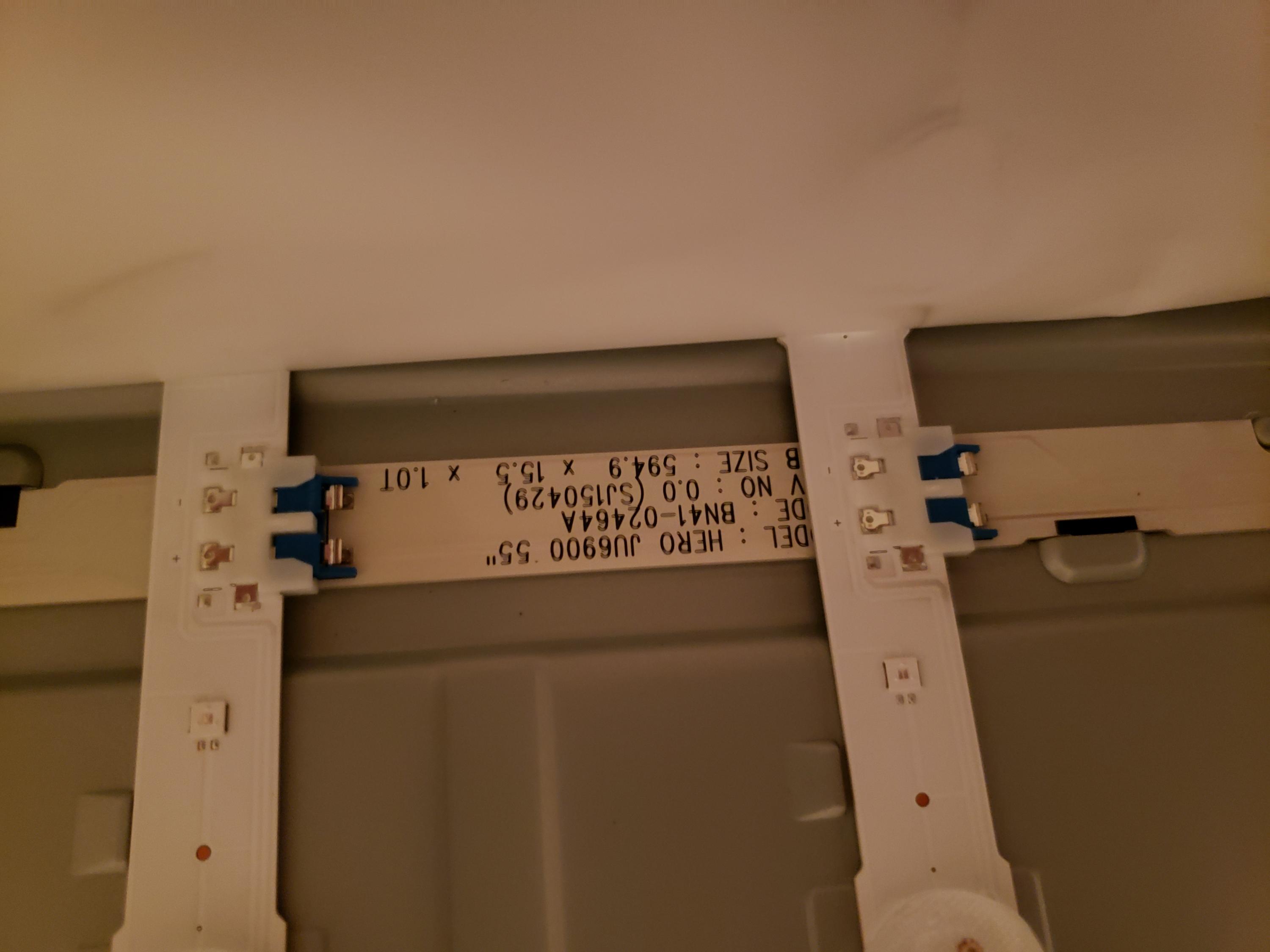

Re: Samsung un55js7000 no power
Well, at this point you have to carefully disassemble the panel to get to the LED strips to get the P/N as printed on the strips since there may be more than one version of the LCD panel.
Take good pictures so you will remember how the sheets are stacked and how the panel are put together.Never stop learning
