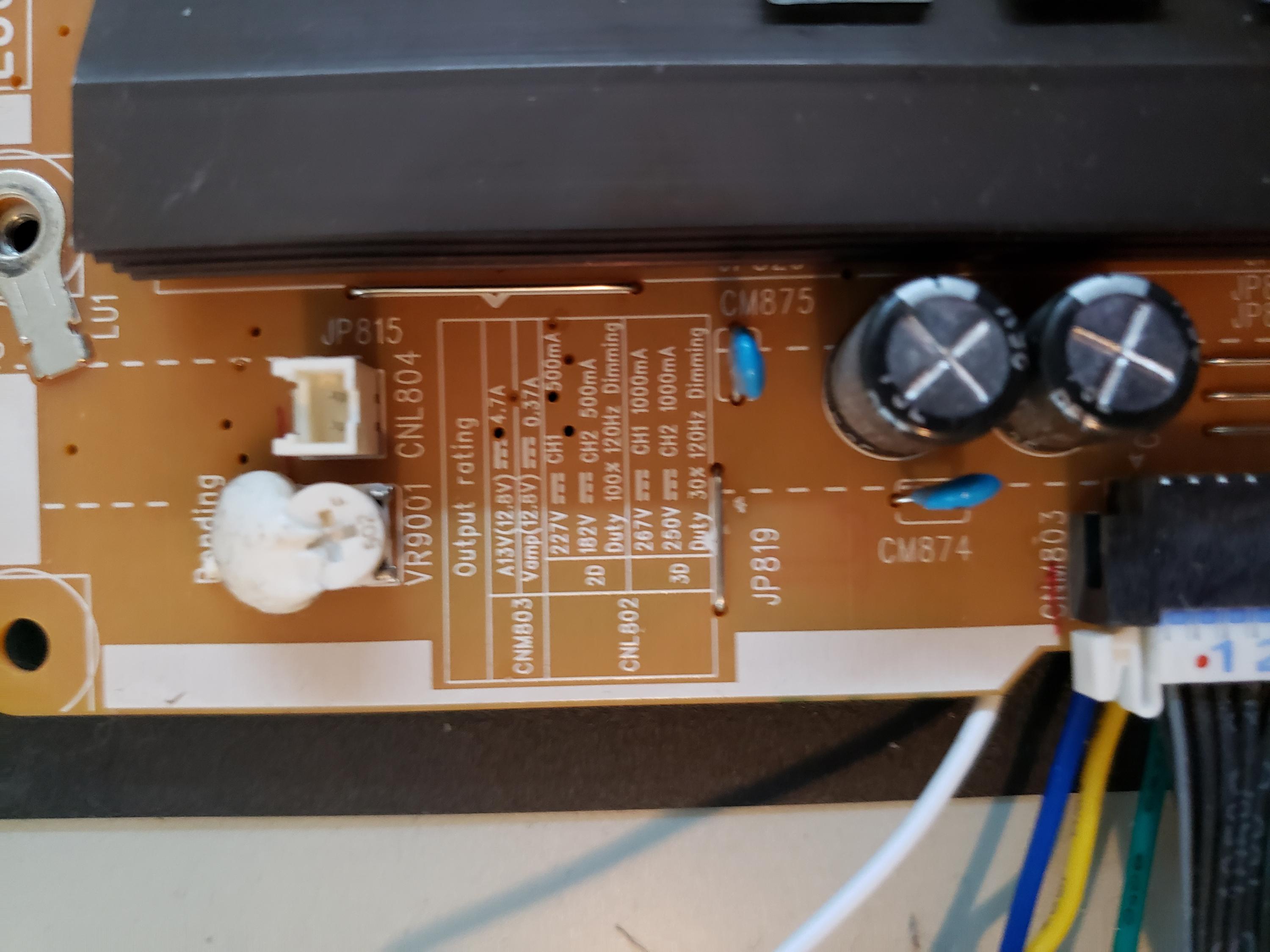

    Here's a better picture of the bottom of the led connector. The big caps near it had 390ish voltage.
    Are you talking about these 4 black caps 22uF 400VDC?
    https://www.badcaps.net/forum/attach...5&d=1597966857
    If that is the case, you should not be seeing <1V at the LED connector, but then I do not know where you put the probe leads at.
    The exposed pin of the LED connector you see on the top side of the board are the odd number pin, pin1 is marked with whit triangle.
    Pin 1 is 2+ which is the Anode of LED STRING #2.
    Pin 5 is 2- which is the Cathode of LED STRING #2.
    Pin 9 is 1+ which is the Anode of LED STRING #1.
    Pin 13 is 1- which is the Cathode of LED STRING #1.
    Bottom line, if those Voltages on the those 4 LED power supplies filter caps show 390VDC, that means you have open circuit in the LED strings some where due to bad LED's (more than likely), connectors that link the LED strip together, etc.
    BTW, you can see the LED Voltage chart printed on the board close byt he connector that goes to the main board. The two LED strings are not the same, one has more LED's than the other.

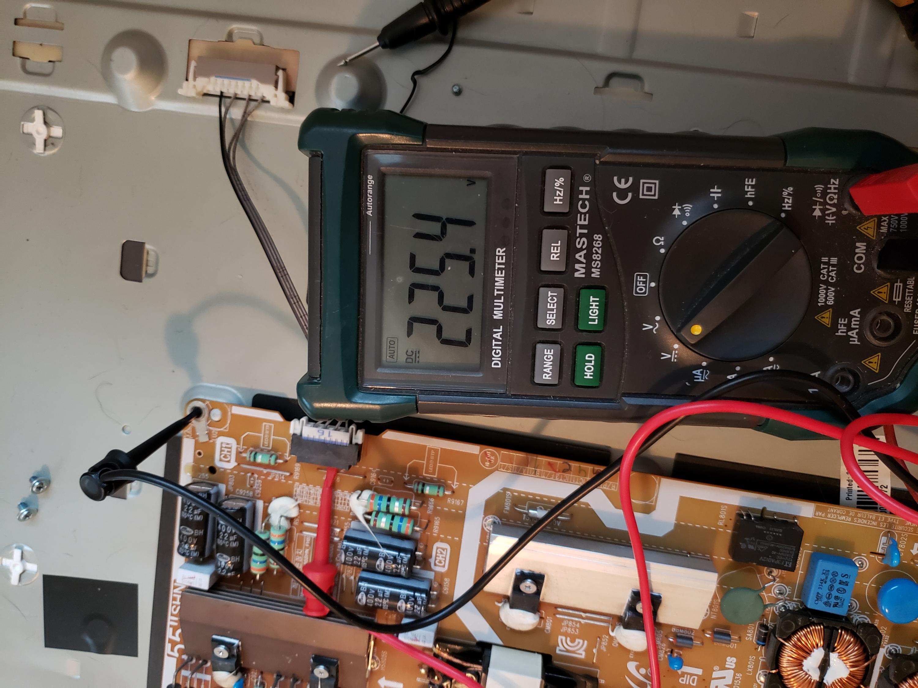

        Lets do the test like this to check the Voltages at the LED connector, LED connector and all other connectors must be in place.
        1) TV off, keep black probe on the chassis at all time.
        2) Red probe on pin 1 (2+), then turn on the TV while watching the meter to see how high the Voltage jumps up to, record that then wait a few minutes the turn off the TV.
        3) Red probe on pin 5 (2-), then turn on the TV while watching the meter to see how high the Voltage jumps up to, record that then wait a few minutes the turn off the TV.
        4) Red probe on pin 9 (1+), then turn on the TV while watching the meter to see how high the Voltage jumps up to, record that then wait a few minutes the turn off the TV.
        5) Red probe on pin 13 (1-), then turn on the TV while watching the meter to see how high the Voltage jumps up to, record that then wait a few minutes the turn off the TV.

                            Checked again.......... And now the voltages are high on all pins. I changed nothing. Here's a picture of me checking 2-
                            Edit - ignore the stray probe on the right. That's a different meter.
                              #34
                              Re: Samsung un55js7000 no power
                              Since now your new meter is showing difference reading, you need to repeat the test in step #23 with and without LED connector in place.
                              BTW, You must put all the board mounting screws back in place, I see that you put the black probe on the board with no board mounting screw on it.
                              The boards are grounded to the chassis with board mounting screws.

                                Sorry, I was unclear - when I tested it again, the new meter is getting high voltages on all pins just like my old meter was.
                                I think maybe a probe was loose when I saw the < 1v while LEDs were connected.
                                So - it's as it was before.
                                Connected-
                                1+ 2+ 320v max
                                1- 225v max
                                2- 245v max
                                Disconnected-
                                Same except both - pins were < 1v.
                                I'm playing with it now, and it doesn't seem to turn off when I press the power button ...
                                Edit - it may not be turning off because the power button is also the select button. Who knows what menu I'm in.
                                Double edit - universal remote allows me to turn it off.
                                Triple edit - was finally able to display something on it. I can see the image when I hold a flashlight to the screen.
