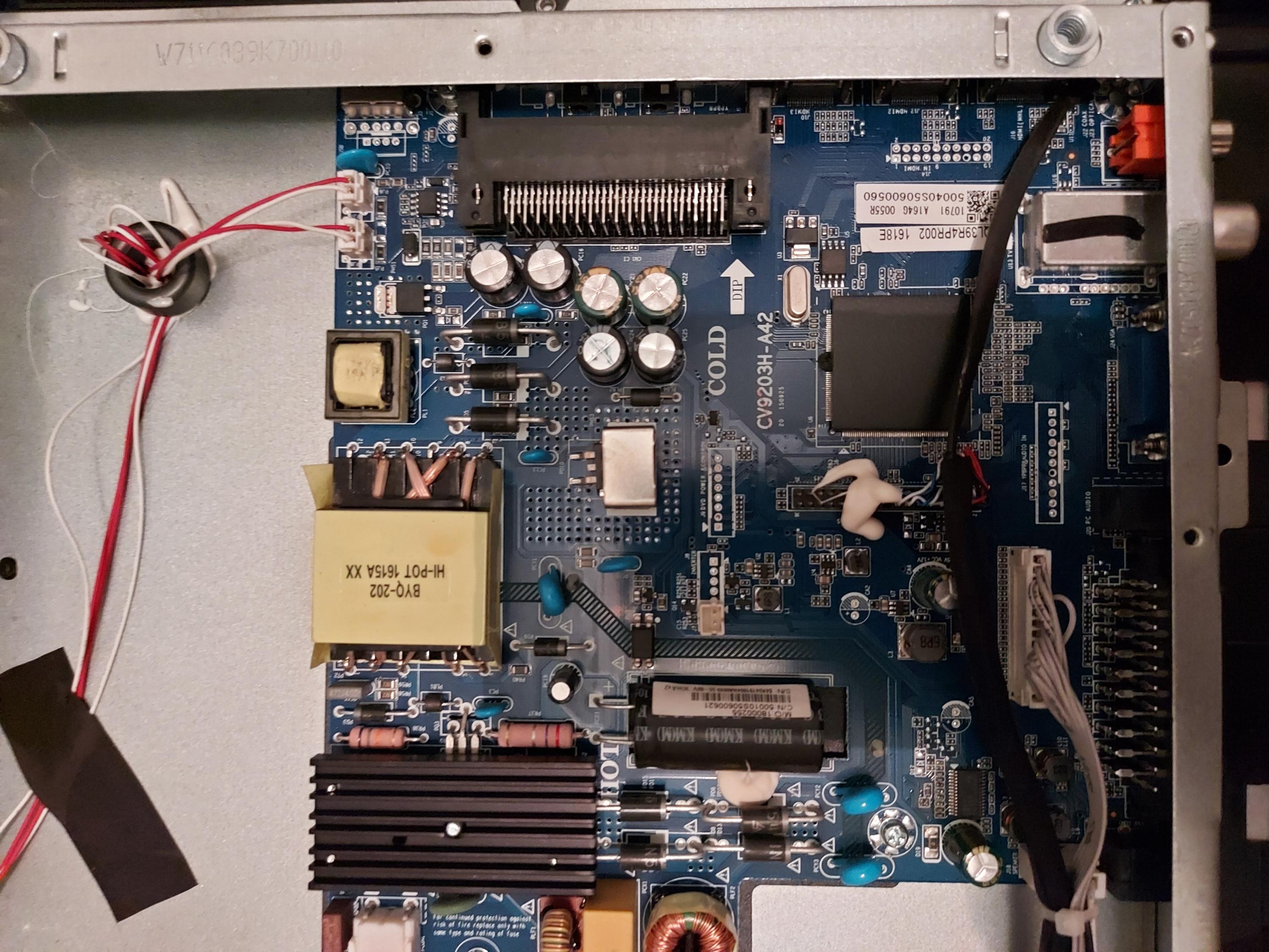

    i have an issue with my polaroid TV Model : tql39r4pr002
    the standby led is red , and when i turn on the TV it shows the polaroid logo and turns off, also the standby led switches to blue the back to red .
    capacitors are apparently ok, i have 320V in the smoothing primary capacitor, and 13V in the diodes in the secondary.
    i don't understand why the mainboard switches to this mode and don't turn on.
    don't find any service manual for this model ,or the main board schematic. cv9203h-a42

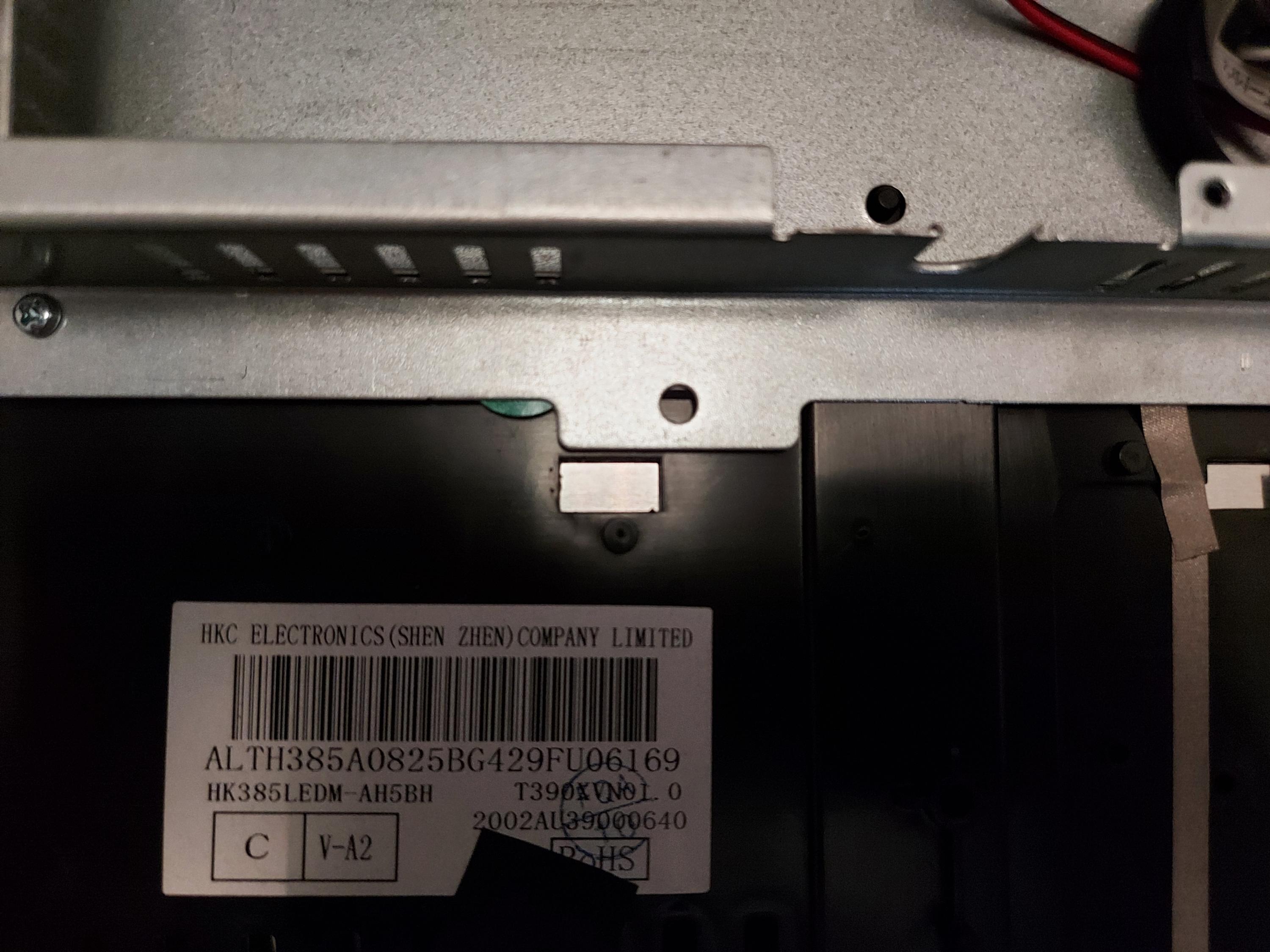

    sounds like it maybe a firmware issue after looking into a couple of threads using your mainboard number what is the lcd panel number used in this tv (usually on a white sticker on tv metal chassis)

      here what i found on the chassis (see attached picture) :
      HK385LEDM-AH5BH.

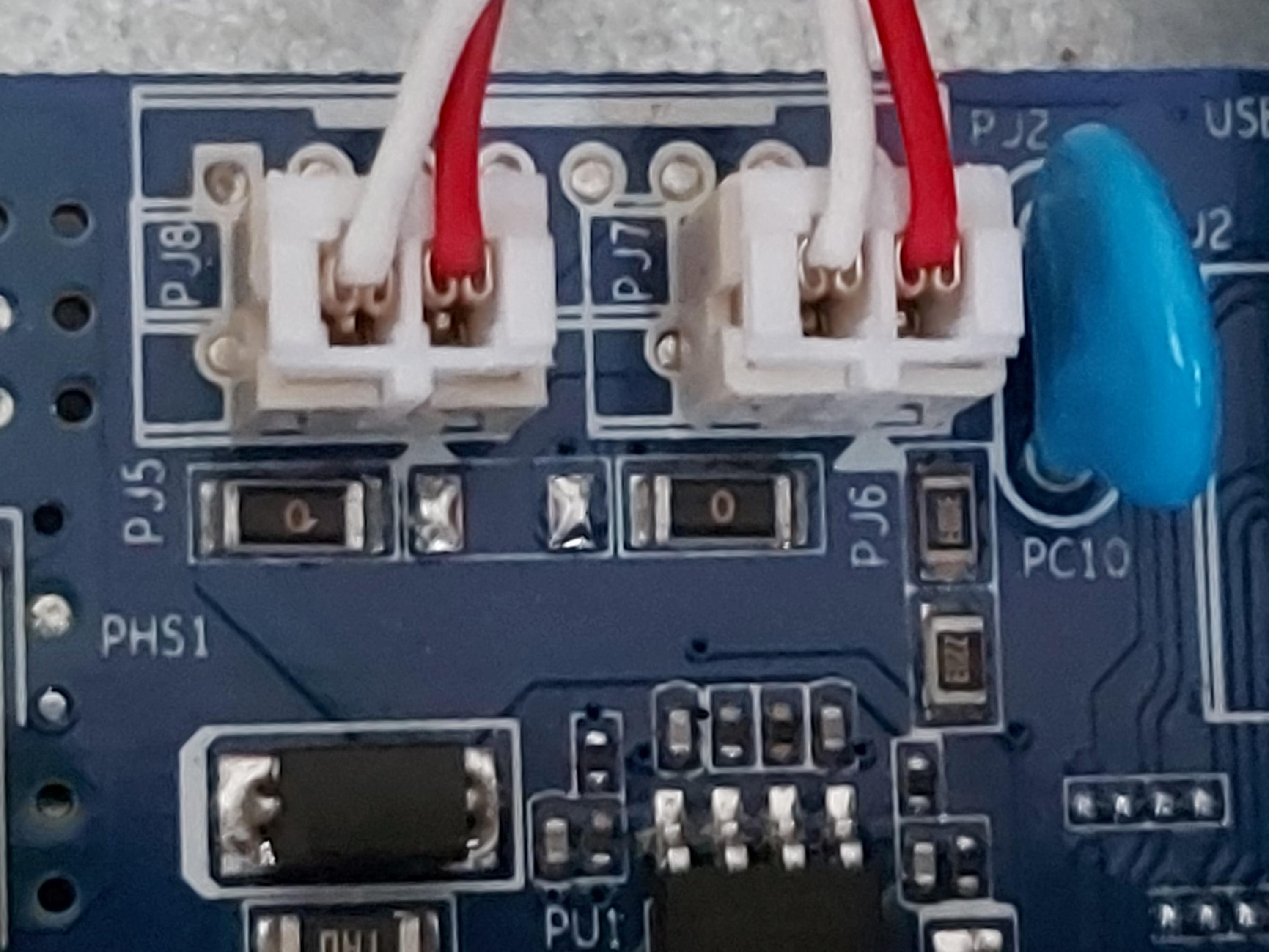

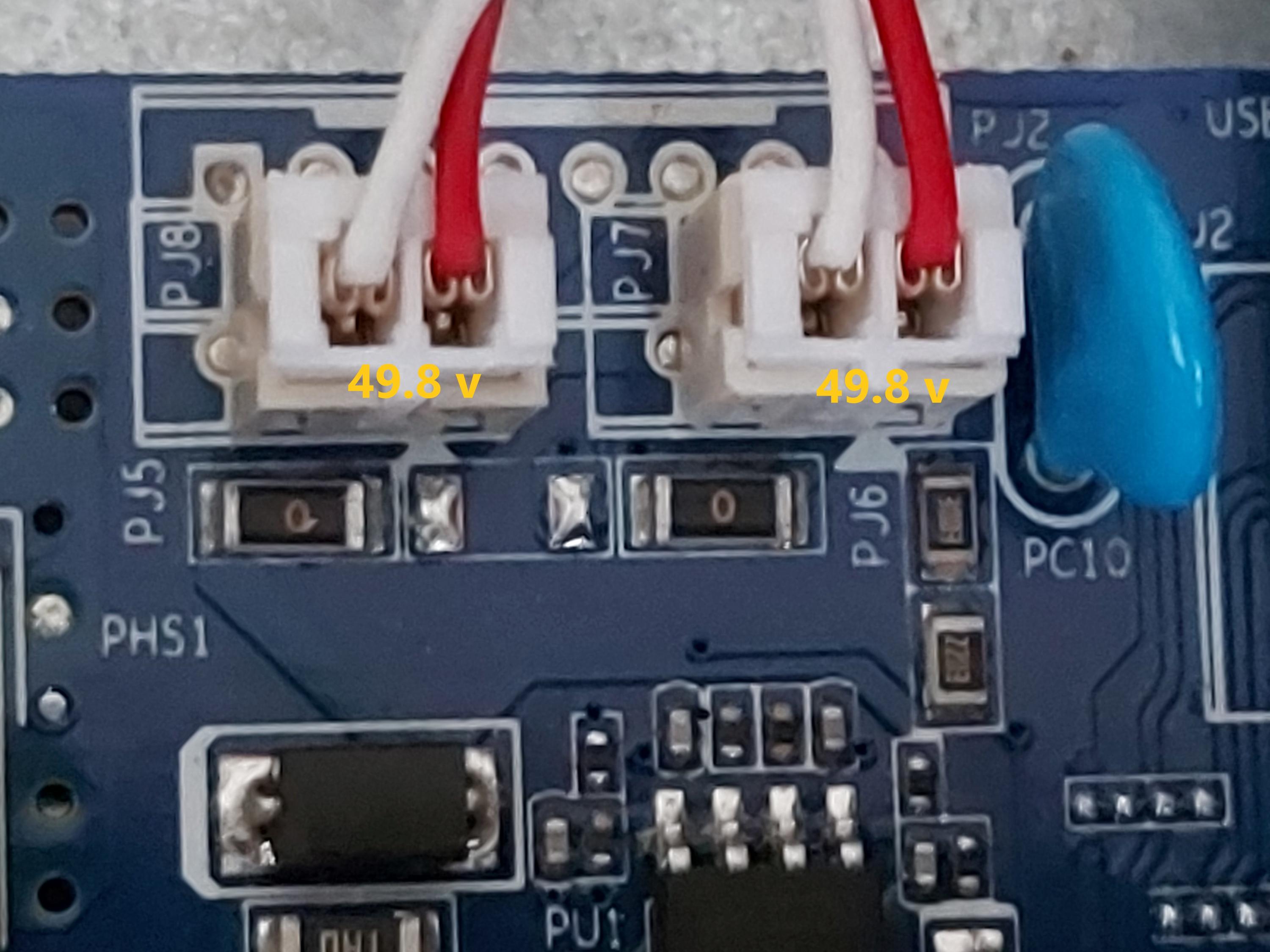

          i tested the voltage on cables connected to the Backlight LEDs (PJ8 and PJ7 connectors) and on standby i have 26 v , but when i push the On button it raises quickly to 40v then goes back to 26v .
          is that symptom of backlight issue ? or something bad on the board ?

            "is that symptom of backlight issue ?"
            Yes.

                With an LED tester you can find out which strip is not good. Or put the meter on the connector and turn on the TV. The maximum value read is the closest to the truth. Otherwise the protection enters immediately, the voltage decreases and the read value is erroneous.
                If the baclight appears and then turns off and the TV restarts, it may be a software problem.
                Also check if the BL-ON command (for backlight lighting) remains permanent. If so and the LEDs go out, it's the backlight problem. If not, it is the software problem or the motherboard.

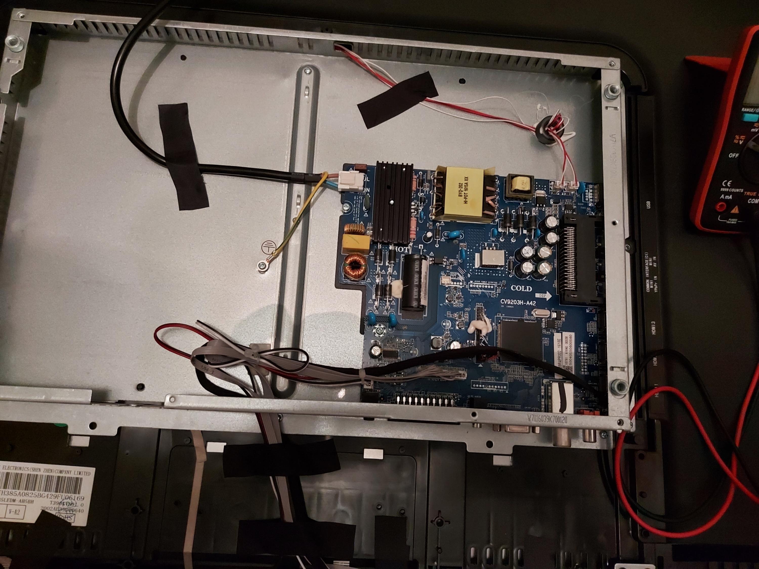

                  i tested the voltage with led backlight tester and it gives 49.8v for each connector , i don't know what is the expected voltage i should have ?

                    The LED tester is a constant current generator. With it you can light LED bars if they are good. If it is ok, the lights come on.

                      i don't know why but i didnn't change anything just doing some tests and now the tv turns on normally , and i have now the voltages of the back light at 54v and it was before at 49.8v (when conncted with led tester) ... strange !!! maybe something is at the end of his life either backleds or on the boost circuit of the led-driver ? ... what do you think ...

                        1. imperfect contact to the sockets
                        2. imperfect contact to an LED
                        3. LEDs with higher current
                        4. problems with the LED converter
                        If the TV is more than 3 years old and you want to keep it, it is worth replacing the LED strips with new ones.
