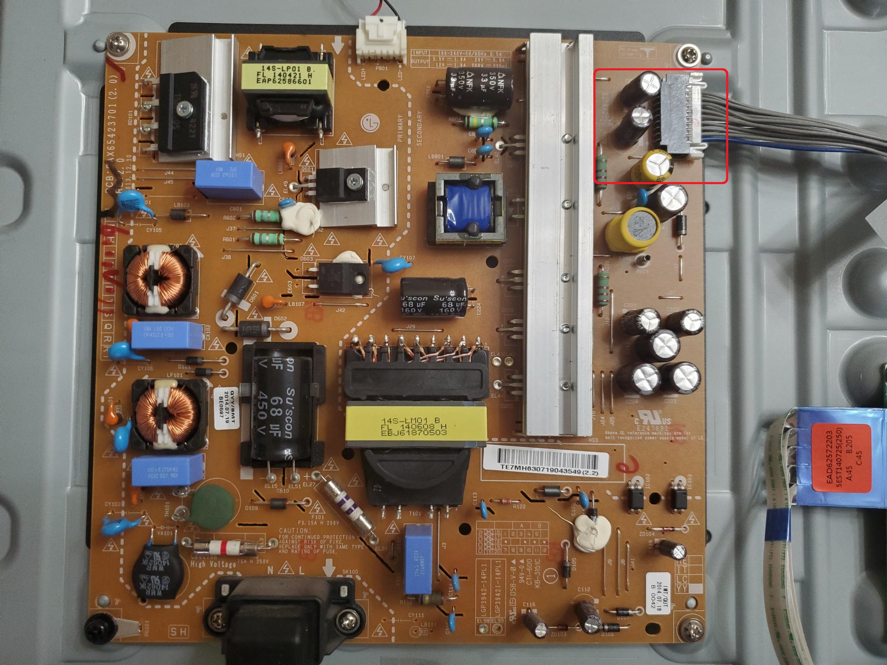

LG 42LB5600 standby light works but no picture and clicking sound
  • jmandawg
    • Jul 2020
    • 42
    I have a LG 42LB5600 when plugged in the red standby light is illuminated. i can hear a faint clicking sound coming from the part# 14S-LM01 (transformer? in middle of the board) When i press the power button, the standby light turns off but the display does not turn on.
    I do get voltages across the fuses and the large caps (did not check the small ones) but no voltage out the led power (top red and black wires).
    Did not see any burn marks or bulging caps.
    The faint clicking is only when the TV is turned off.
    Any ideas?

    Can you give the voltages on the connector as shown on the circuit board
    eg
    Pin No. Name Voltage
    Pin 1 GND 0V
    Pin 2 ON/OFF 3.5V
    PIn 3......etc
    and what volatge do you have between the two legs of C610

      Re: LG 42LB5600 standby light works but no picture and clicking sound
      i can only test the pins on the top without turning the board over. Here's what i got from top pins with tv turned on:
      pin1 GND: 0
      pin2 12v: 11.91
      pin3 12v: 11.91
      pin4 GND: 0
      pin5 24v: when i touch the prob to it it's goes from a voltage around 17v and immediately drops to 1v
      pin6 GND: 0
      pin7 3.5: 3.5
      pin8 3.5: 3.5
      pin9 PWON: 3.3

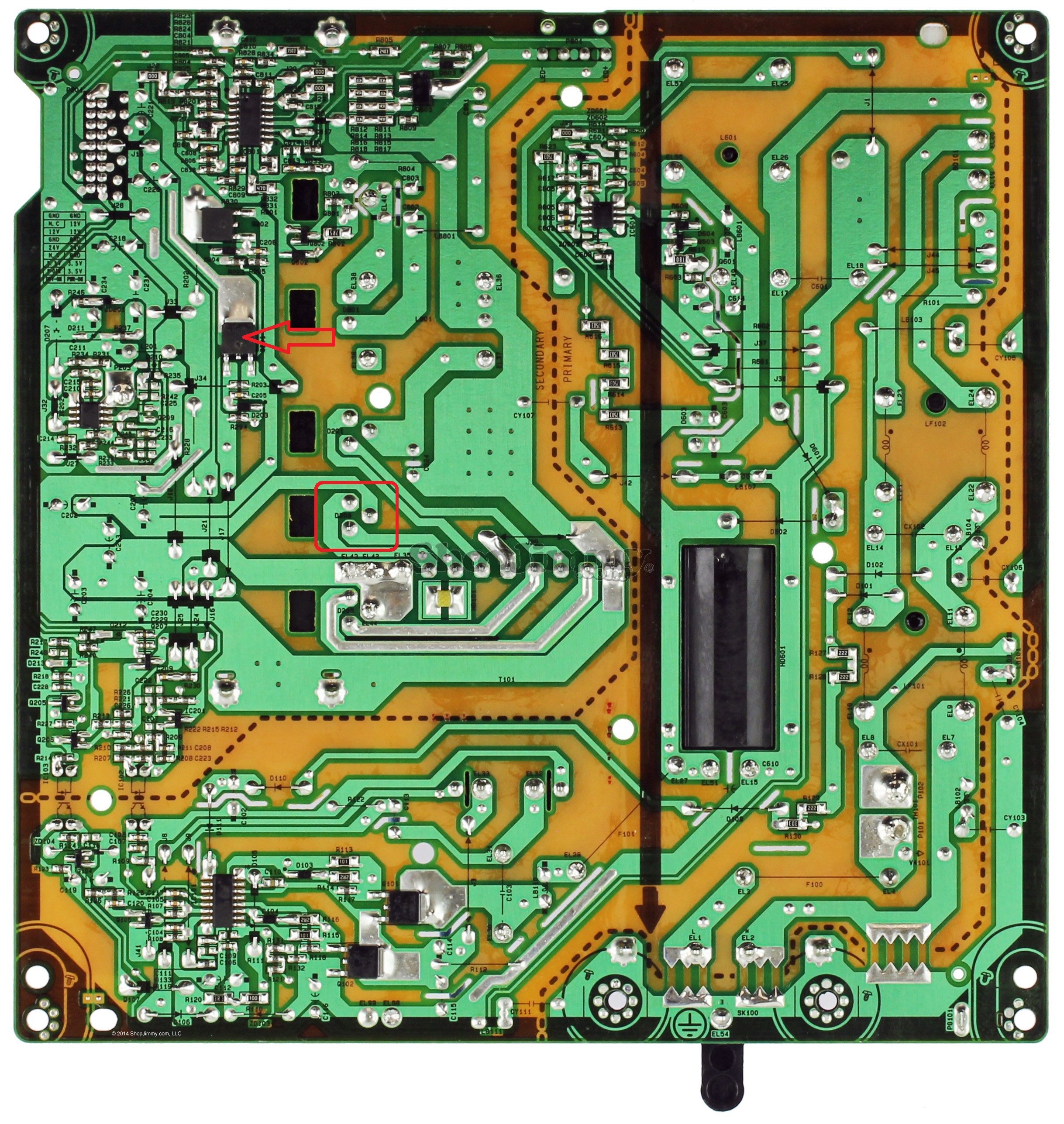

        How about DRV_ON. There are two sets of pins running in parallel on that connector so I think you missed out some of the readings.
        You need to check the diodes under the silver heatsink. Use your meter in diode mode.
        If this is similar to your power supply can you check the two items identified

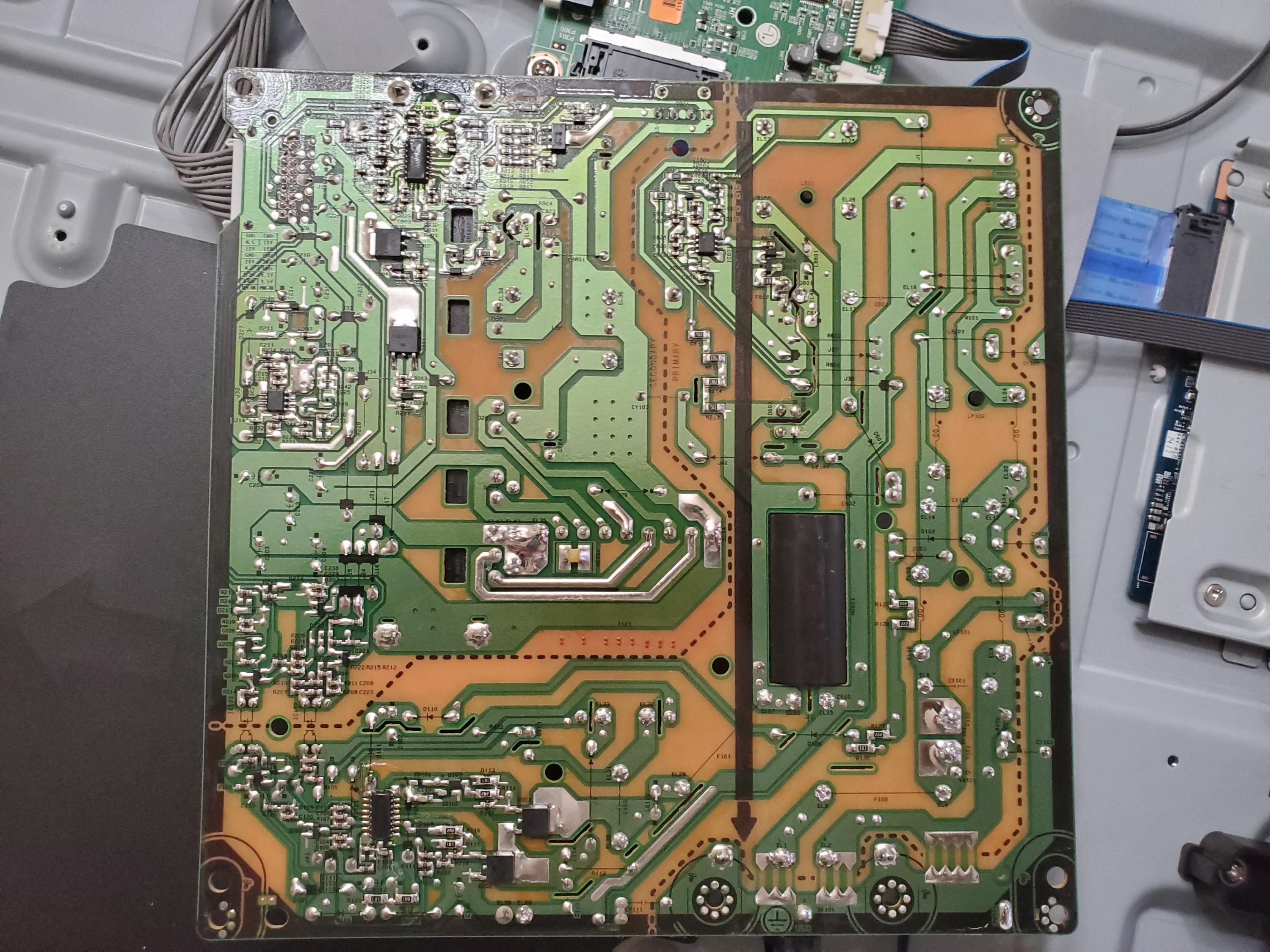

          Here is a pic of the underside of the board. and here are the other set of pins:
          pin1 GND: 0
          pin2 NC: -
          pin3 12v: 11.91
          pin4 G: 0
          pin5 24v: goes from around 17 -> 1v when touched with probe
          pin6: NC: -
          pin7 3.5: 3.5v
          pin8 P-DIM: 1.2v
          pin9 DRVON: 3.10
          • jmandawg
            • Jul 2020
            • 42
            I check the 2 transistors in your image. I'm assuming i do it with the TV unplugged.
            for the first one with the arrow: no reading between left and middle pin, but i got a reading between middle and right pin. (and same thing for the transistor right above it)
            2nd one with the box around it. I got a voltage reading from left to middle and right to middle.
            Please let me know if i'm testing them wrong.

                What were the readings. Can you see the part numbers written on them?
                                  the readings on the top one (with the arrow) was 532 (not sure of the units) on the middle and right pin.
                                  the bottom one with the square was 180 arcoss the middle and top and also 180 across middle and bottom pins.
                                  the part number for the top transistor is:
                                  MD3752
                                  F9004HGE
                                  The bottom transistor though the hole i can read:
                                  KMBRF20
                                  U100CTA
