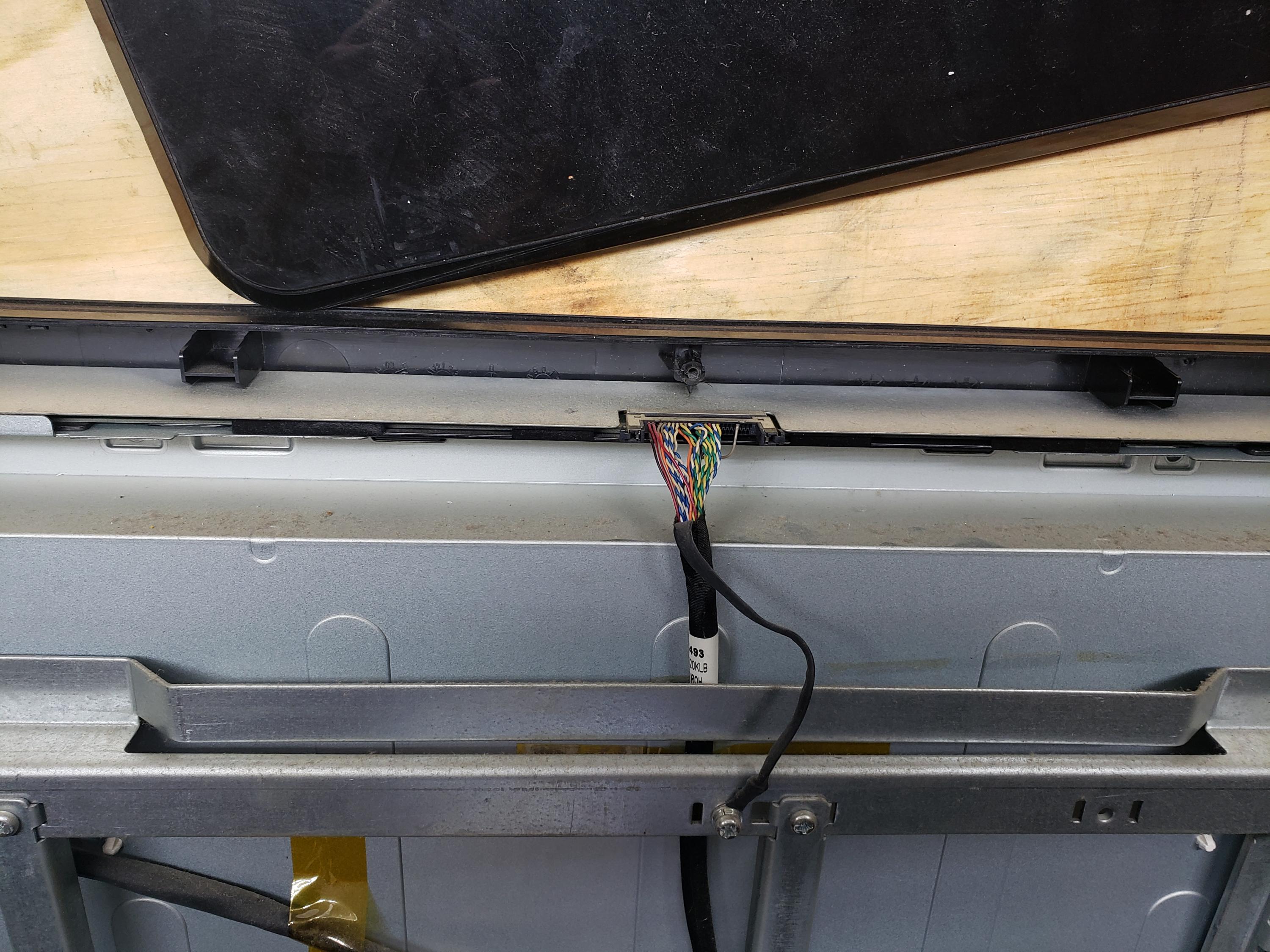

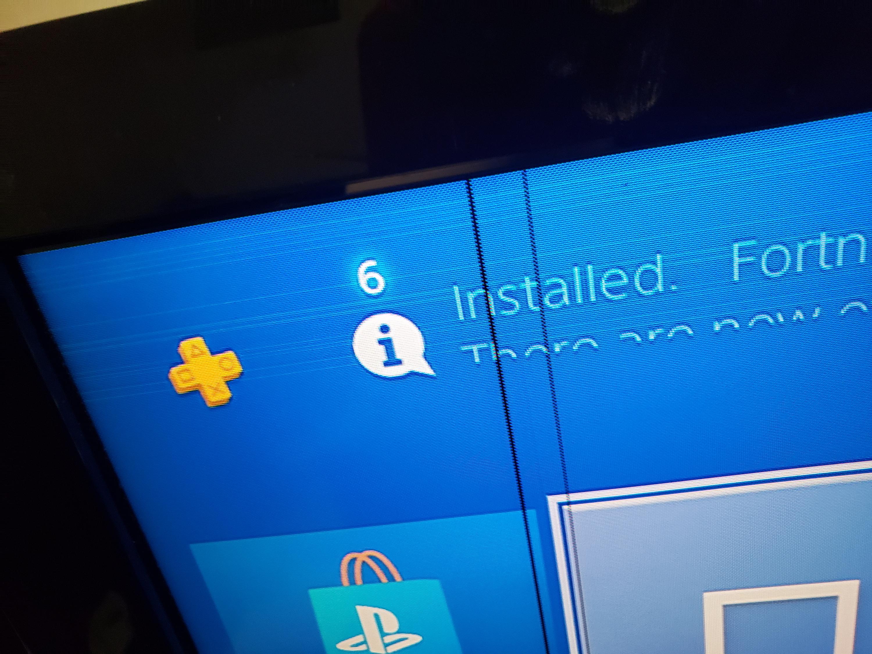

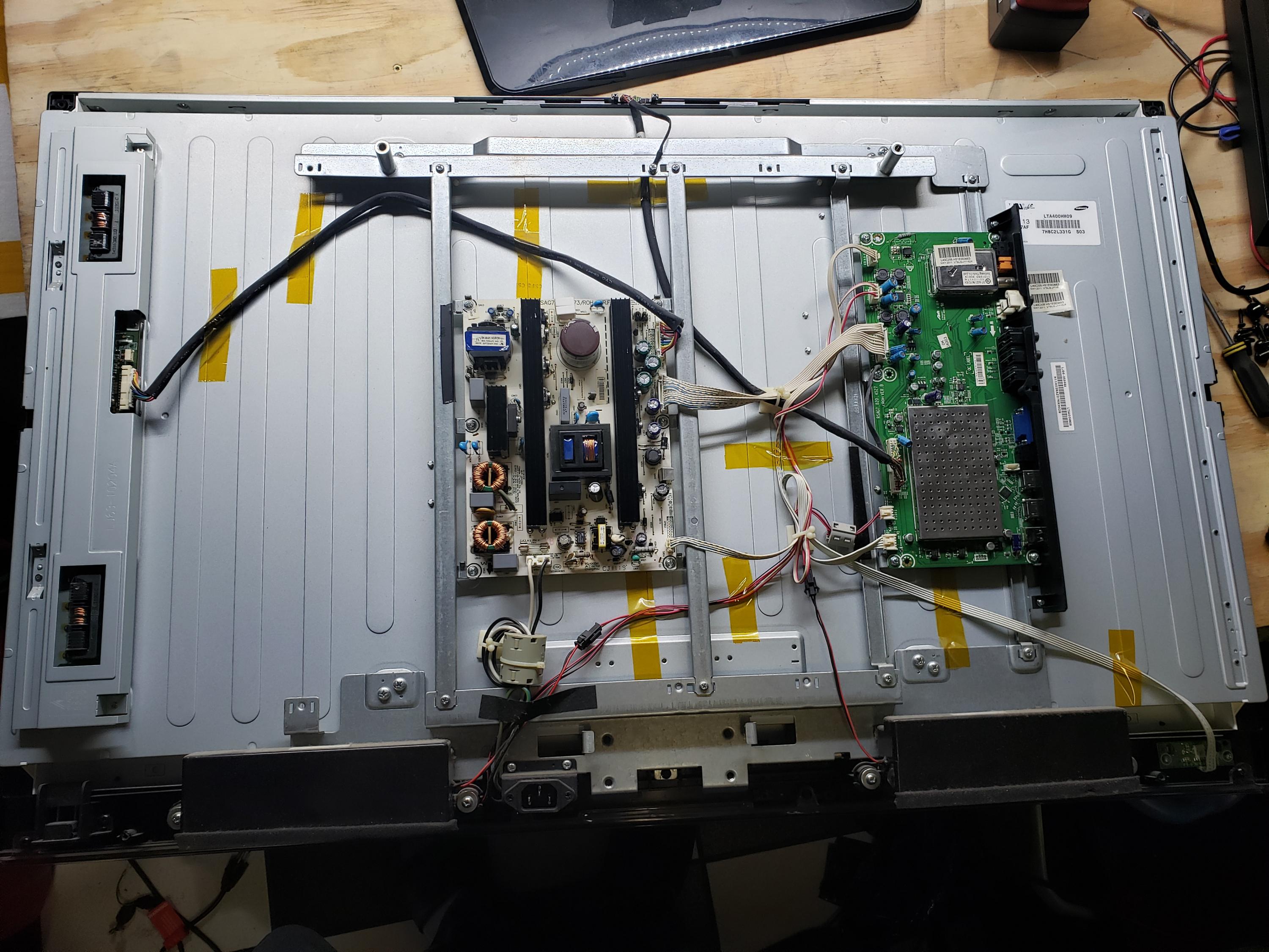

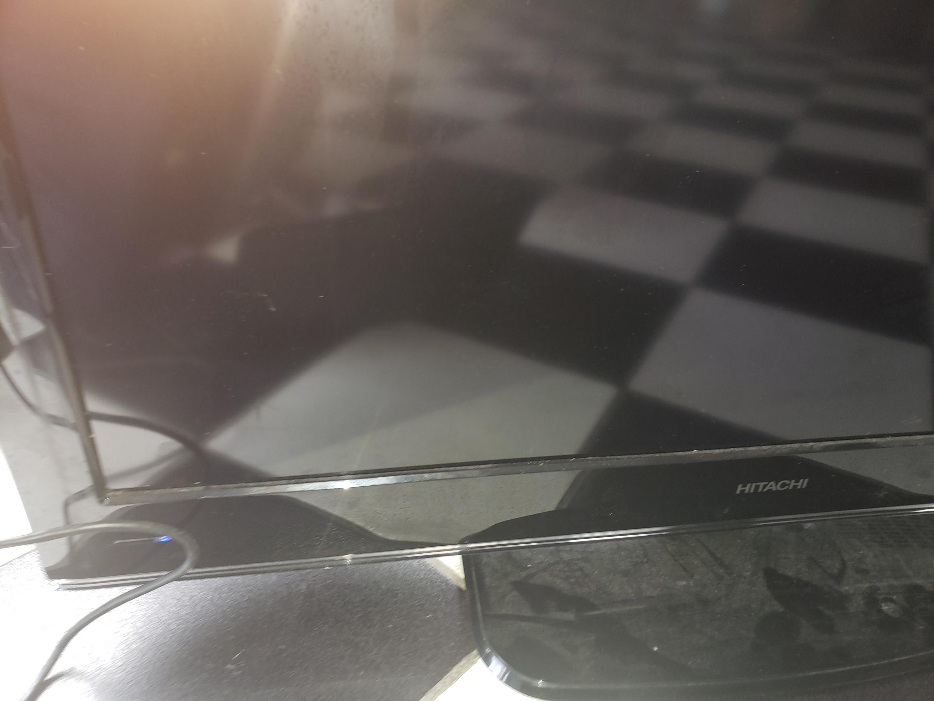

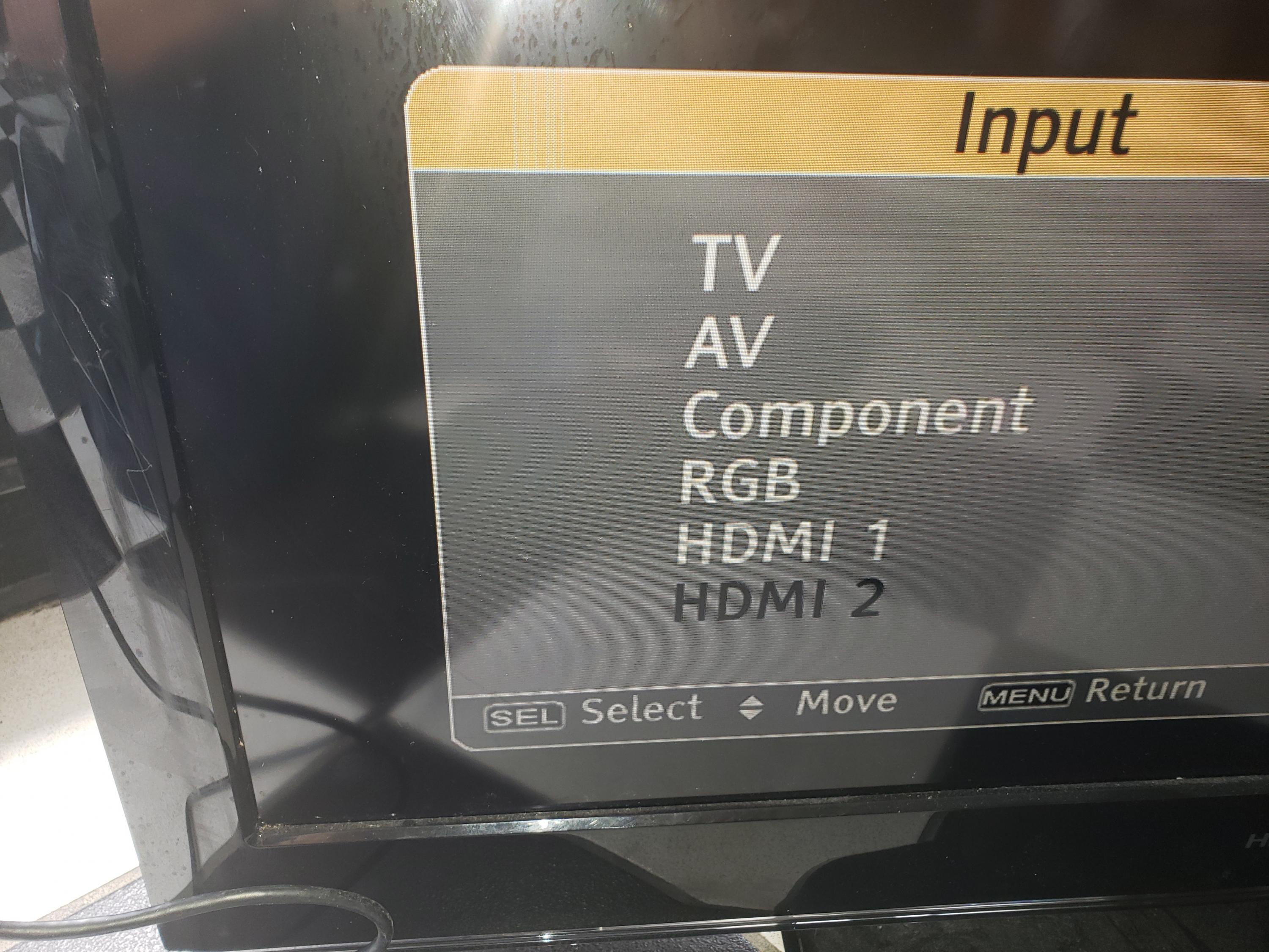

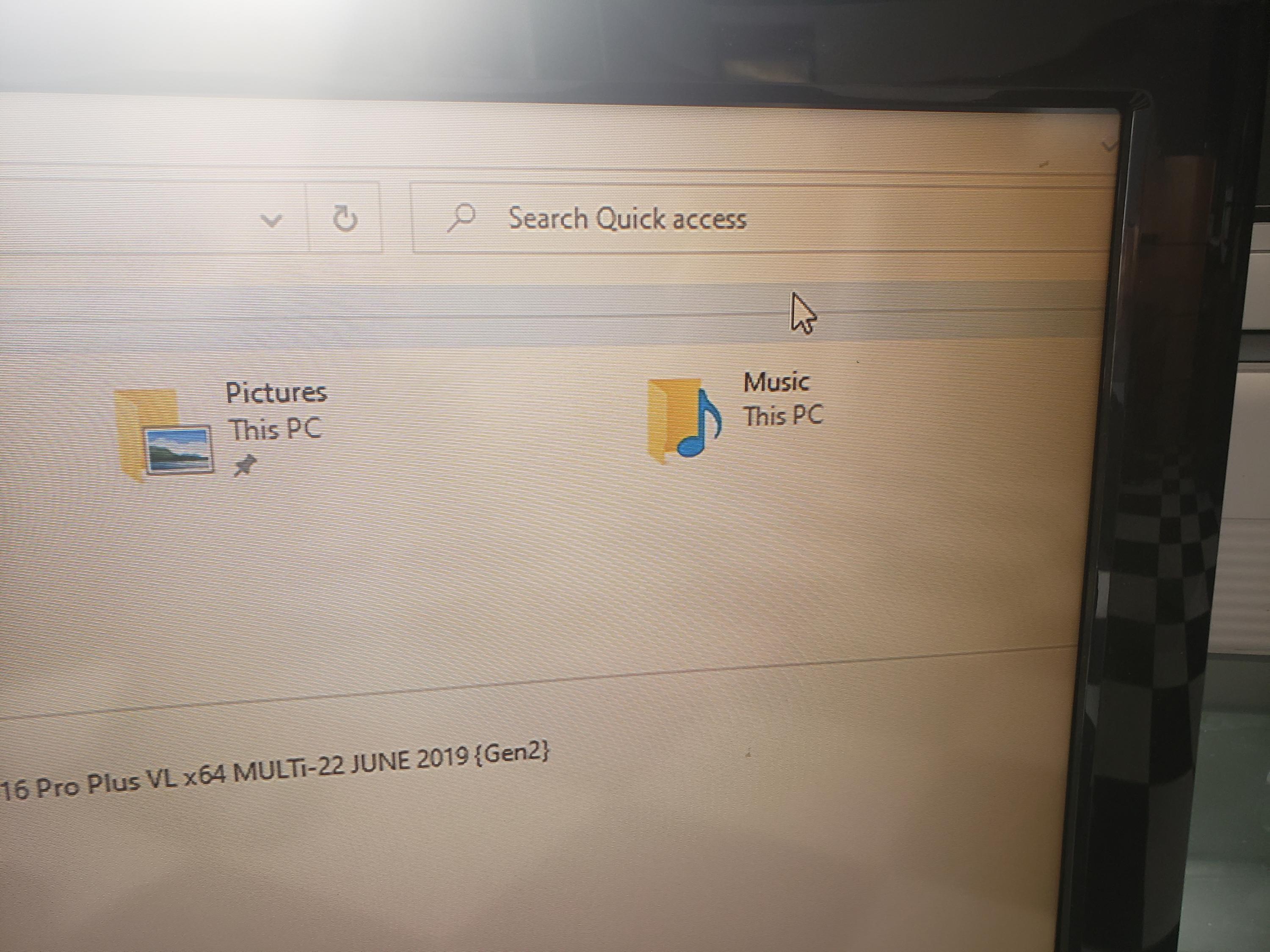

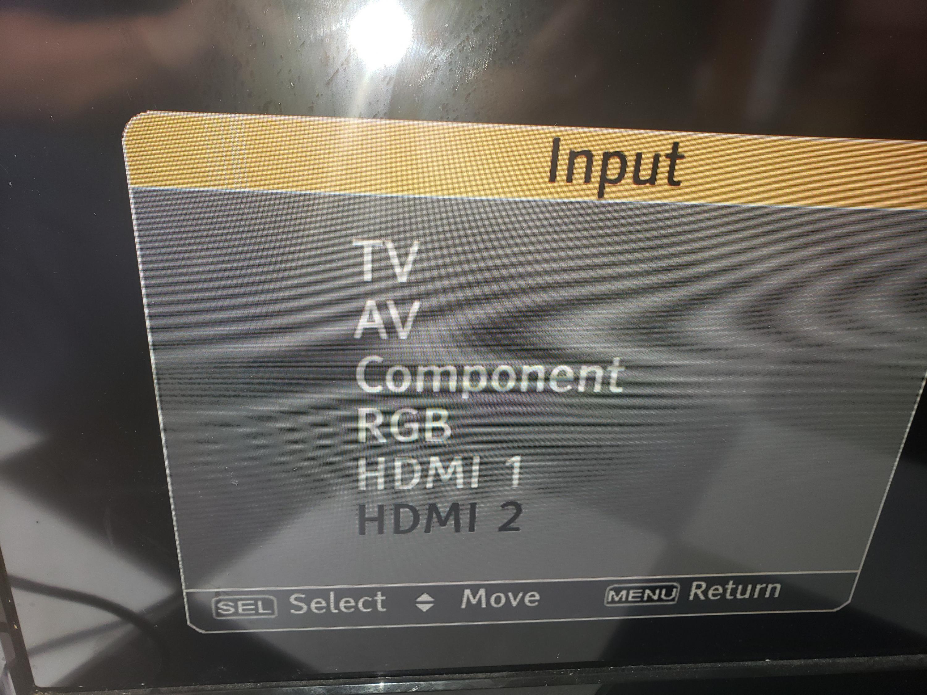

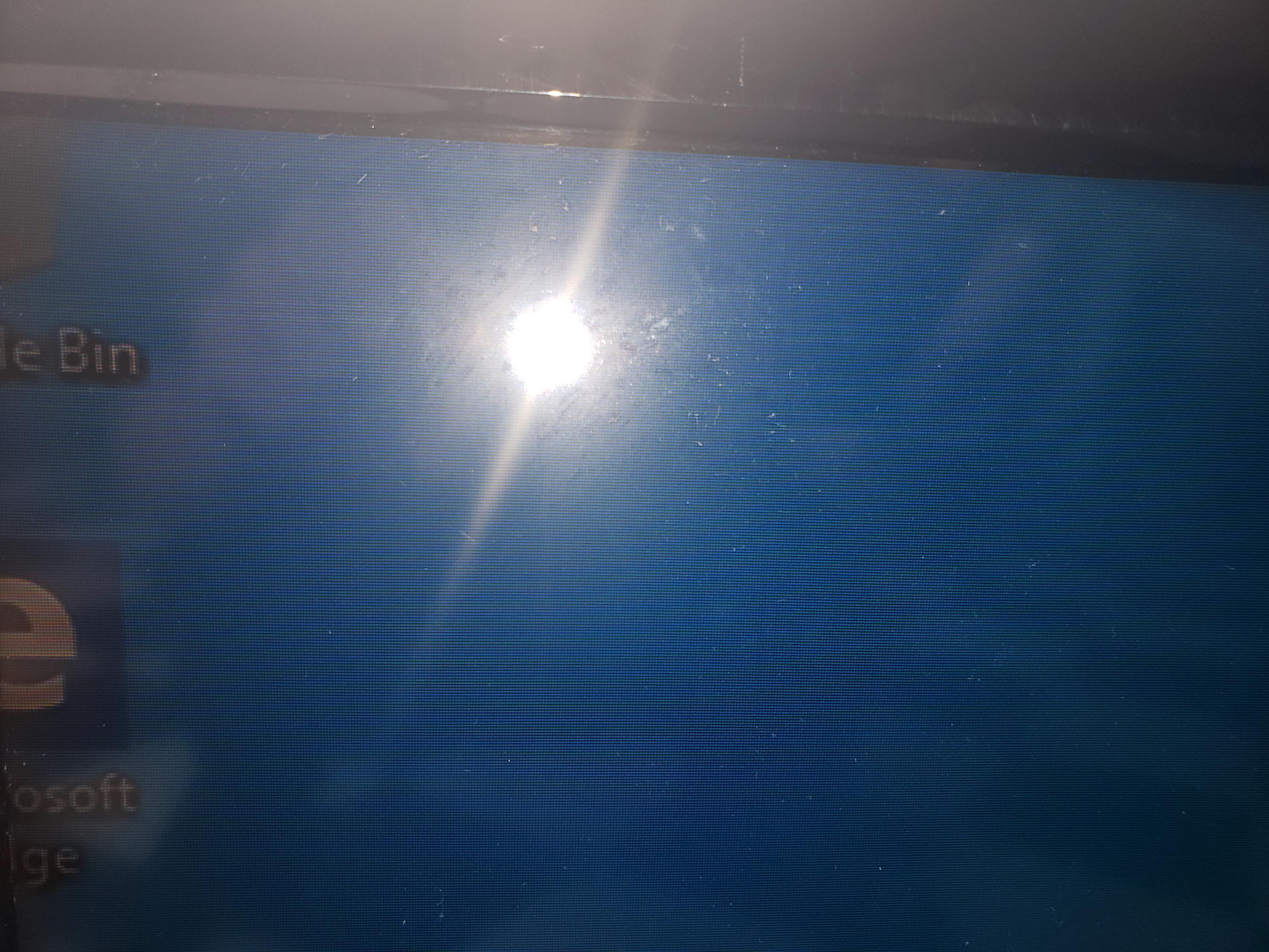

    Hello. I replaced the backlight inverter on this set for a customer and there are lines horizontally and vertically on the display. They show up sometimes I guess depending on the color of the background screen (will include pictures). The customer swears the lines weren't in the screen before the backlight inverter went out. I thought it may be a bad T-con board at first but this set has no T-con board. So if anyone can help, do you think my problem is in the mainboard, the backlight inverter I replaced, the power supply, a cable, or the display (which means the customer is lying or just didn't notice it). What do you think? Thanks in advance.

    what is it like with a tv picture ?
      Re: Hitachi L40C205 lines in display after Backlight Inverter Repair
      I am having a hard time seeing the symptom on those screen shots.
      For example like this one: https://www.badcaps.net/forum/attach...3&d=1596227528
      The LCD panel has integrated T-CON board so T-CON board is not replaceable.

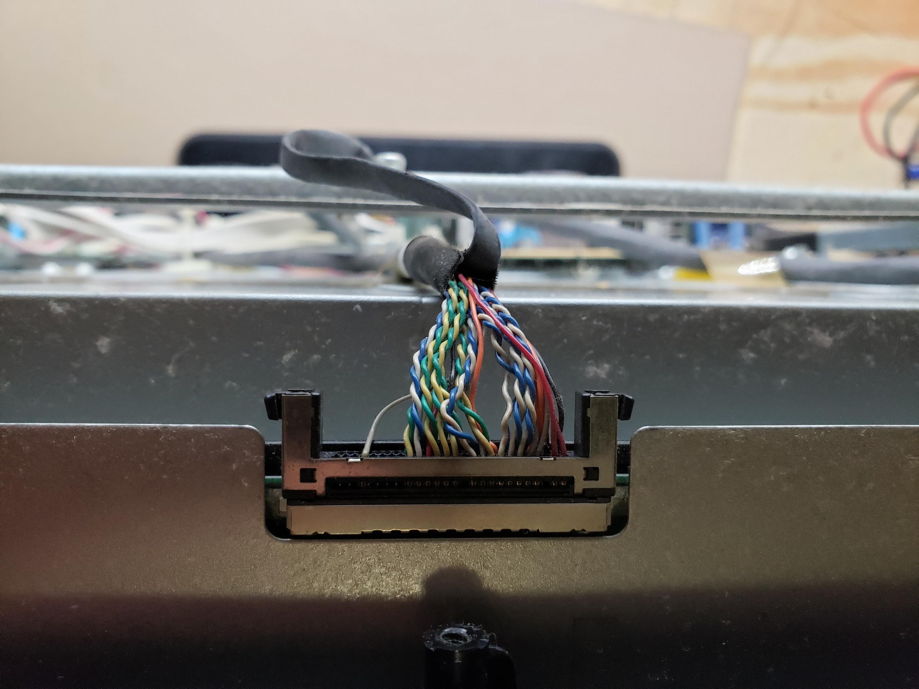

      Did you try re-seating the LVDS cable?
      Did you try tighten all the board mounting screws?
      Did you try heating/cooling the main board?
      If it is the panel/T-con issue, you will have to get to the Tab bonding/T-con board and try heating and cooling and some pressing probe on that Tab bonding/T-con board.

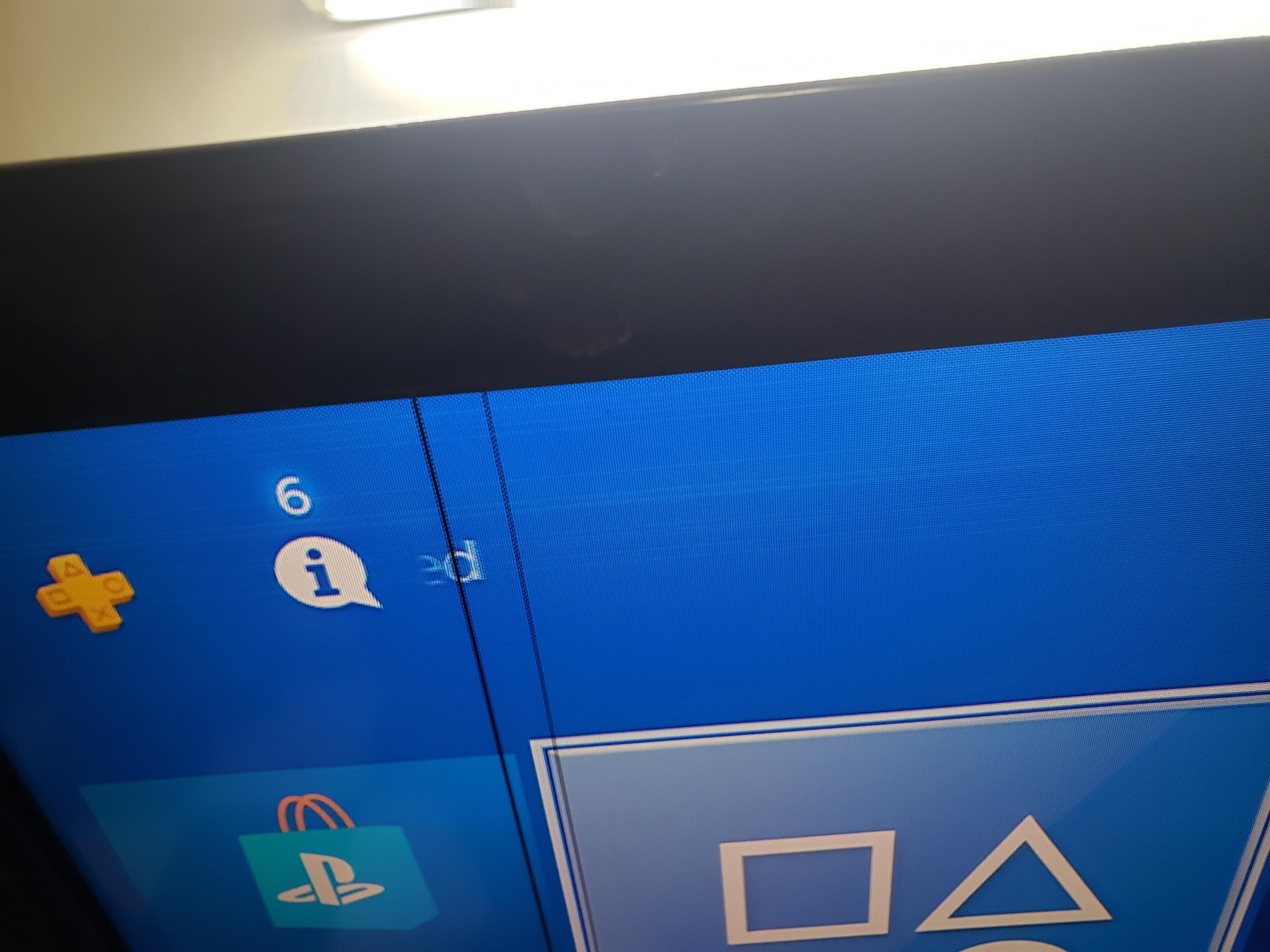

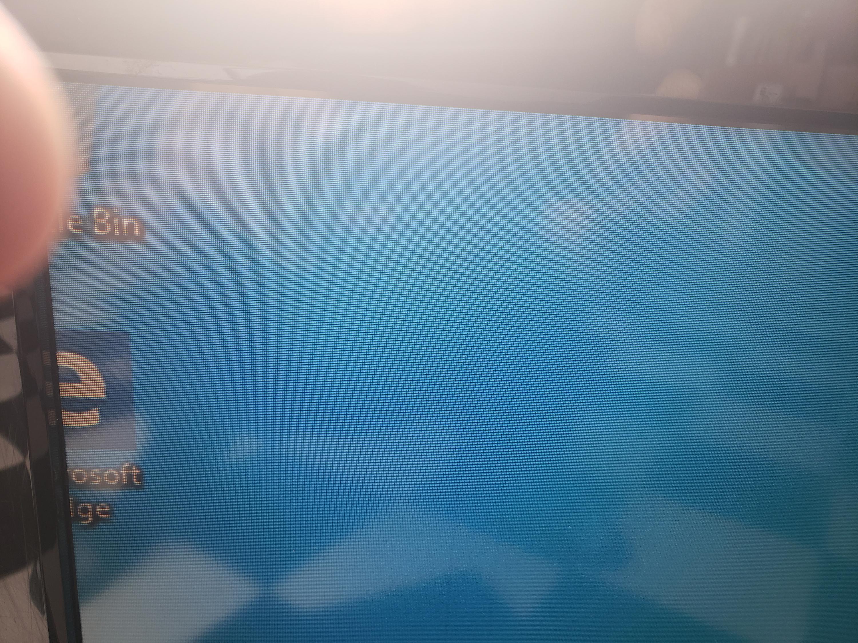

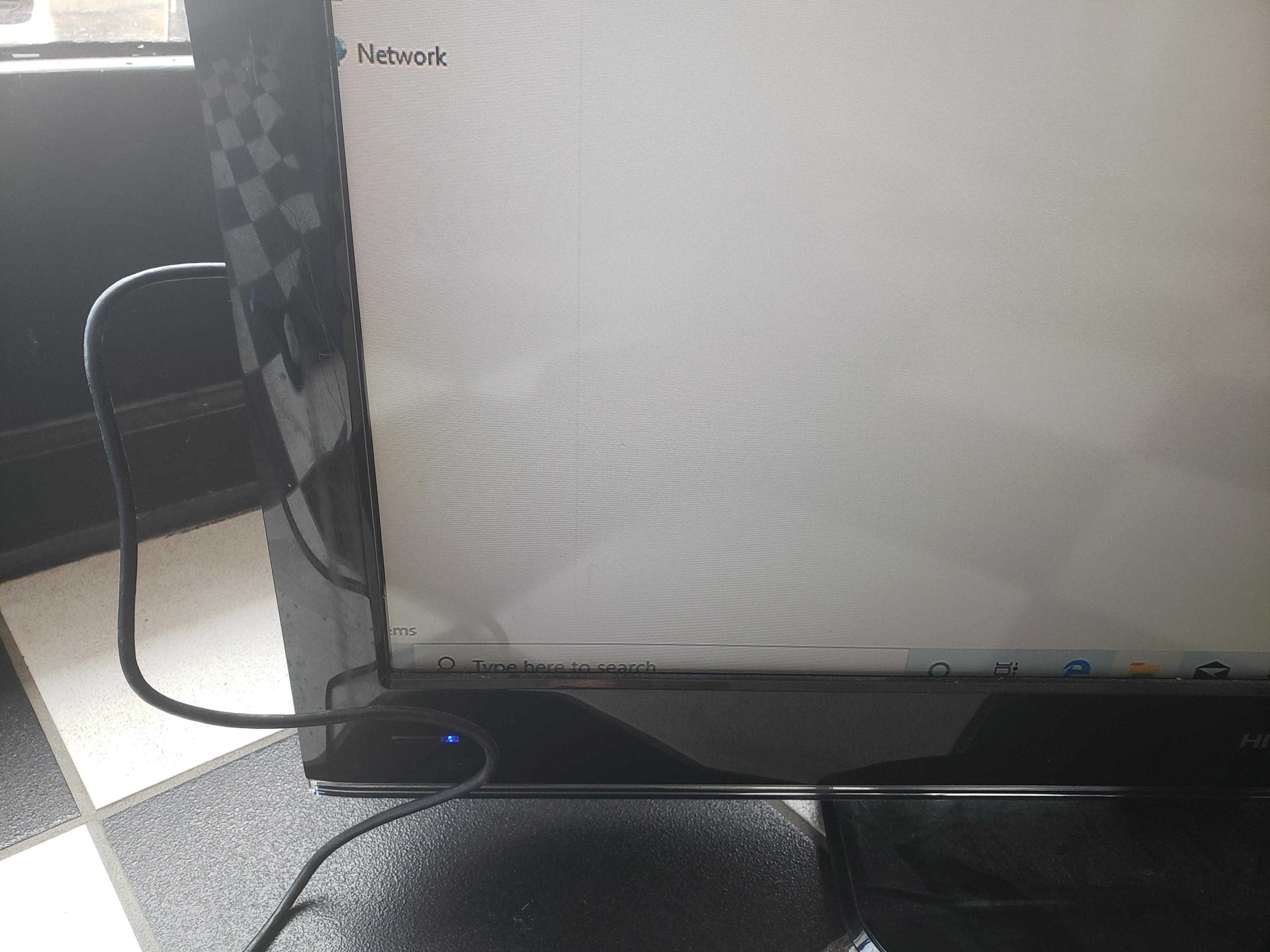

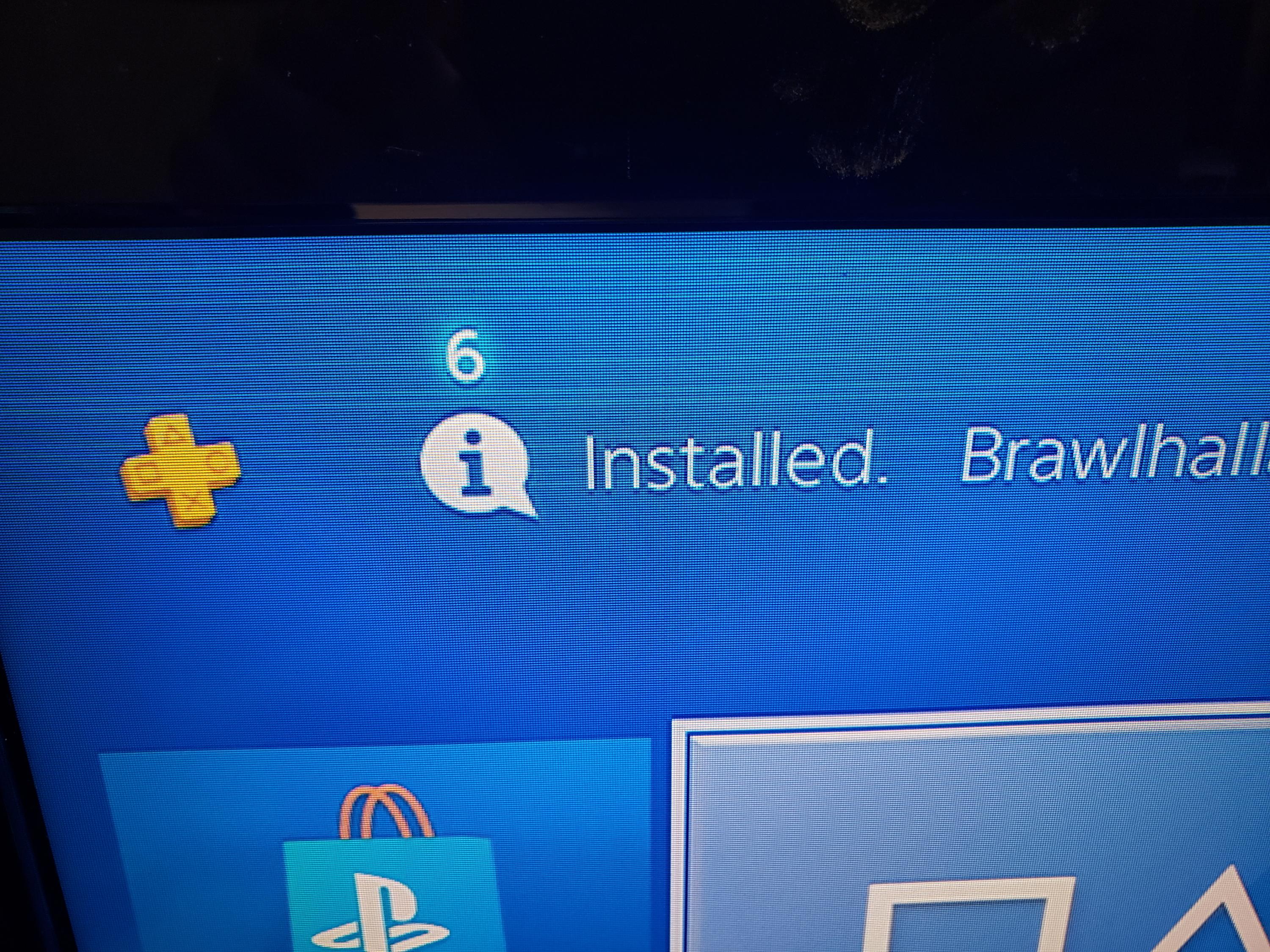

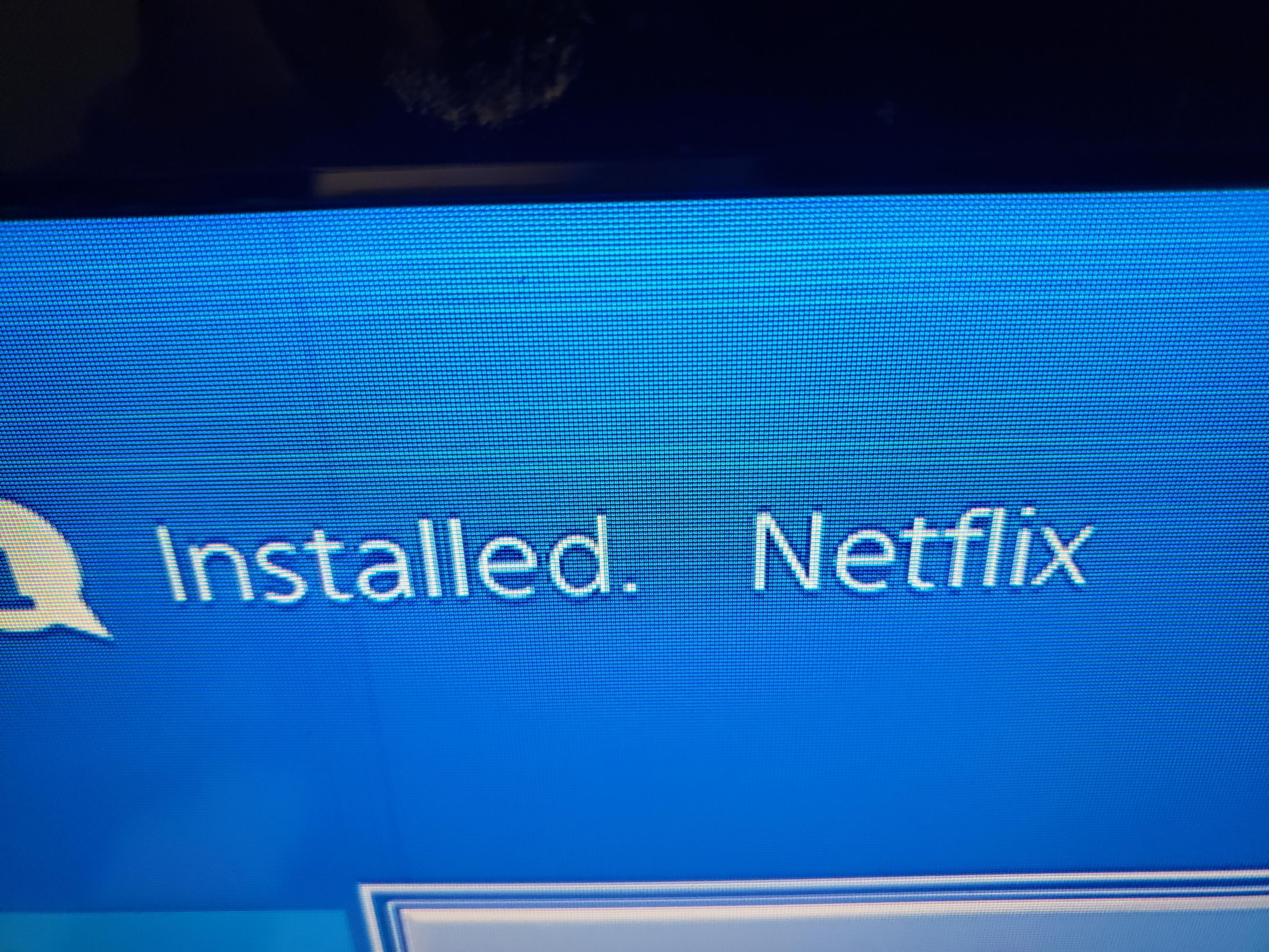

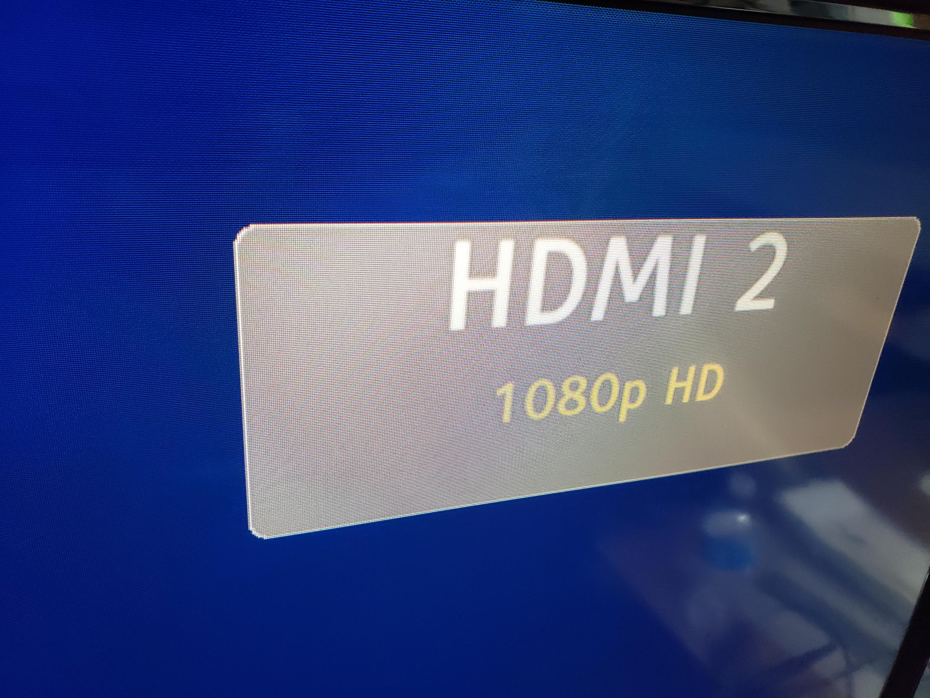

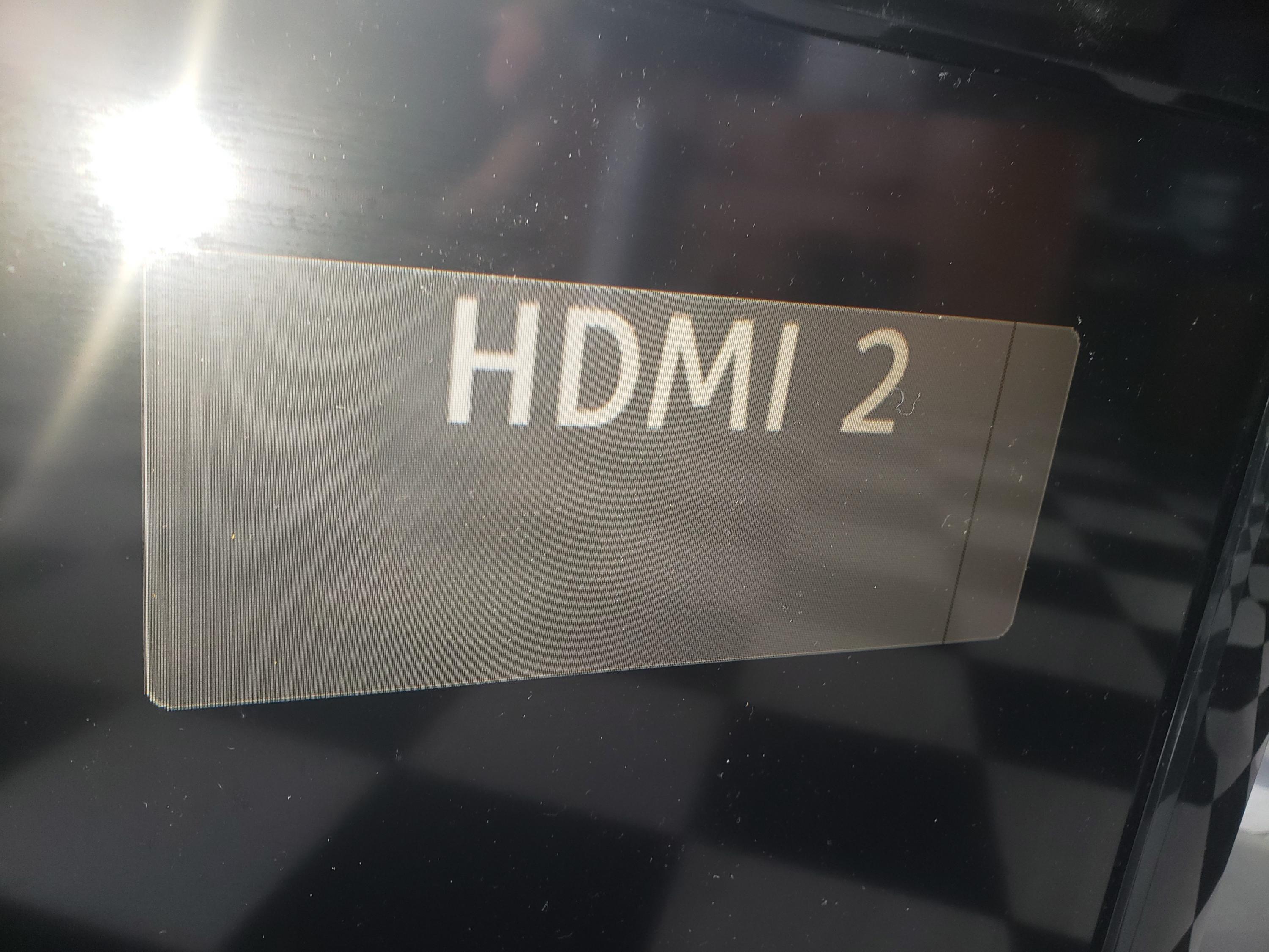

        Hi. These are photos of it with a ps4 attached. The vertical lines in the HDMI box has now vanished after reseating the lvds connector to the tab board. The vertical lines are affected when I push in on the lvds connector. Don't know if its because of movement of the board causing tabs to move or connector or cable itself. The horizontal lines don't ever go away. I think the vertical lines are panel/tab related and the horizontal lines are caused by another issue. What do you think? I've included more pics of what I'm talking about.
          someone did a "hand job" on the cabling with a made up cable as opposed to the normal ribbon cable. As a result, this could cause a "timing / impedance" problem with signals to the panel which you are likely seeing.
          • fharris1977
            • May 2017
            • 132
            I think is the original cable. Just an older LCD set.
