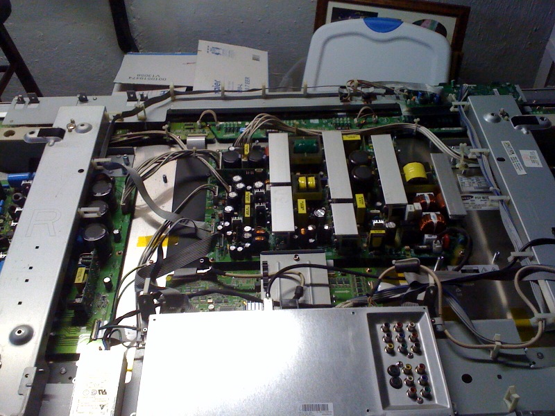

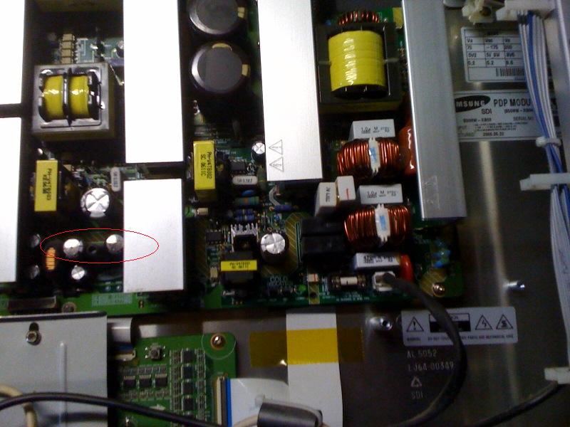

    Hello again all. I wasn't going to post this but it is so related to these threads. I'll try to keep it a short story. With these forums I was able to fix more than just a few tvs cheap. My Bigbros (BB) set died we got it going again in another thread. Meanwhile his neighbor Dug had a philips 50" plasma only 4 years old that was giving him some trouble
    (the turn it on turn it off 10 times and then it works again kind) he took it to a repair shop were it sat awhile the repair bill was way to high so he decided to toss it. My BB bought himself a new 42" led which is awesome. BB found out Dug was now watchin the game on a tiny old set and gave him the polaroid we fixed
    at the end the philips is now mine here are couple pics that I took with my iphone Ill get a better pic of the bad caps later. Fingers are crossed hoping for another easy one

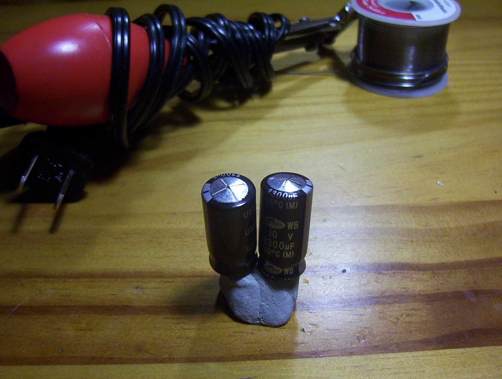

    Yup. 3300uF 10V Samwha. Replace with Digikey P12735-ND, Panasonic EEU-FM1A332. The pair will set you back about $5.00, including shipping. A definitive test: When you turn it on it will try to start, then you will get a blinking red led in either a 6 flashes - short pause - 3 flashes - long pause 6 flashes etc pattern or just 7 flashes.
    Then visit the Philips web site and download the latest firmware for the set. The also have the instructions for updating the firmware.

        Wow thanks Bill you totally nailed it. I ordered 10 caps 2 for the tube 8 for the parts bin around 10 bux shipped. Bill you should change your name to capacitorgod . If this is another easy one I will give it to my nephew (BB's boy) for his first xmass home from Iraq. See how things kind of go full circle in a manner of speaking. The lil blank bag was claiming the thing before I even took it apart lol. I told him I was gonna keep it but I have plenty already so he knows. I do need to get a good esr meter that I don't have to build any suggestions? Not that I don't like building stuff I just don't have a lot of time with work and all. That's why I think the easy ones are so rewarding because of the amount of time spent. A pic of what you already know.

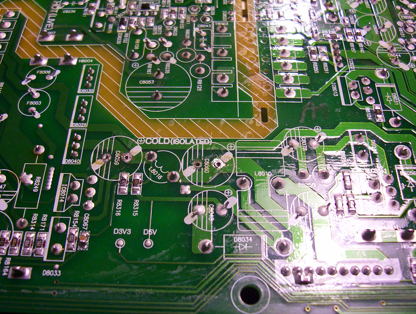

                      I got the parts today and was gonna get them in before work but ran into a snag. I lost a surface mount and need advice on bridging it.

                        Where is SMD location that went missing? Doesn't look lost. What you lost is a eyelet for the through hole capacitor. Fixable.

                          When I put the new cap in and turned the board over the pad was on the end of the lead
                          P.S. I circled it in red

                            This what tore out is ground. Drill a small hole "1/16" (caution! make sure the spot you chose to drill is clear of both sides except ground plane, this board is only 2 layers), next to this torn eyelet and feed a wire from other side and make sure to solder that end on the ground plane (scrape mask off). Once done, wrap free end of wire to the installed capacitor loosely and once. Solder.
                            Keep in mind, keep it hot when you rock one pin out of old cap and another pin till capacitor is out. Vacuum out solder plugged holes. Work gently (pressure on it with soldering iron.)

                              Thanks for the great advice guys and add another tv to the list I was able to get solder in the barrel. Now that cap will be very hard to remove in the future hopefully I won't have to. also I did a search on youtube for tv repair the other day and found lots of good stuff. Do you guys do any of the tv repair tutes on youtube? Man my nephew I gonna need to change his drawers when I show up with this at his house on friday here is a pic of the tv on.
