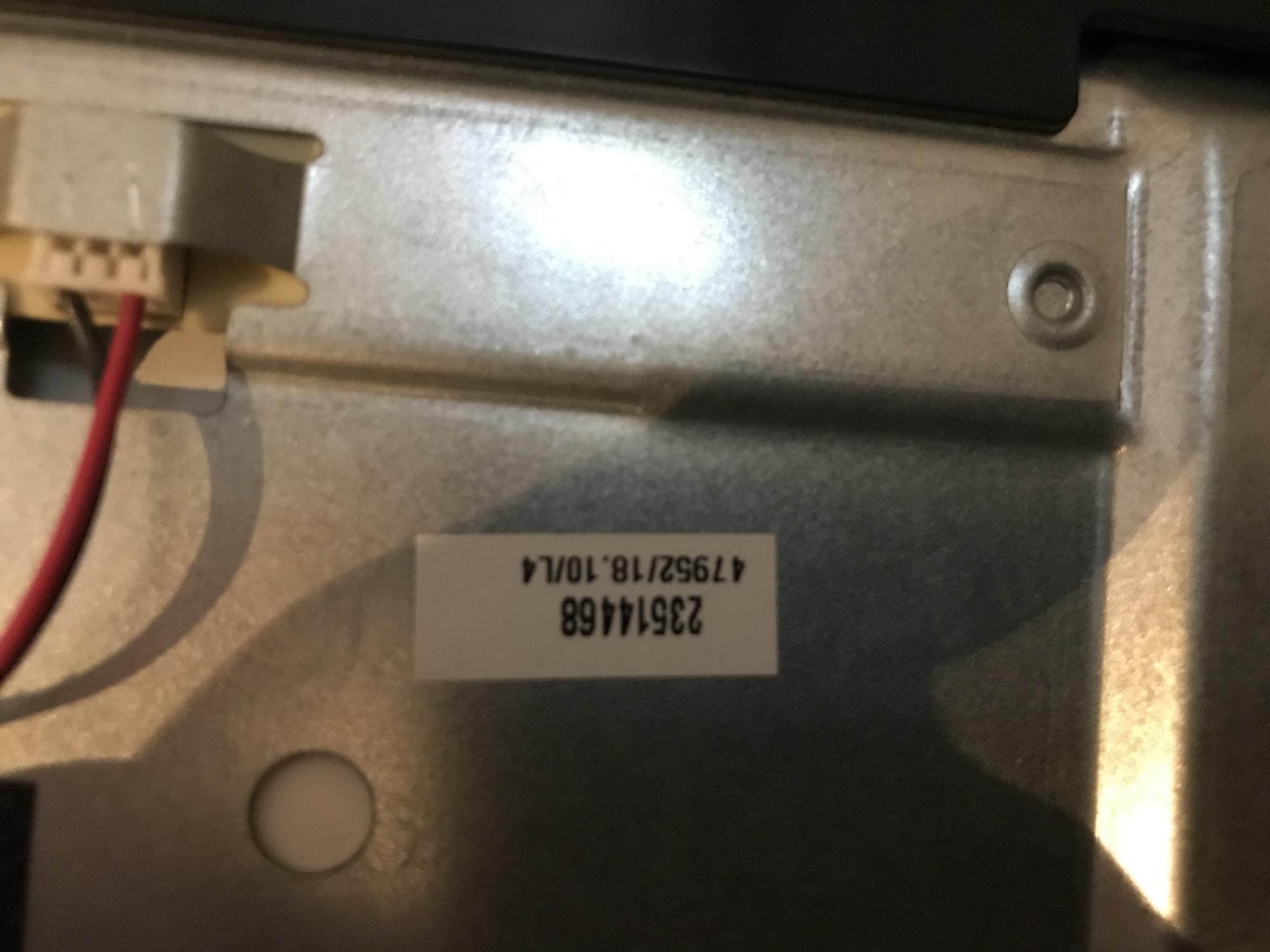

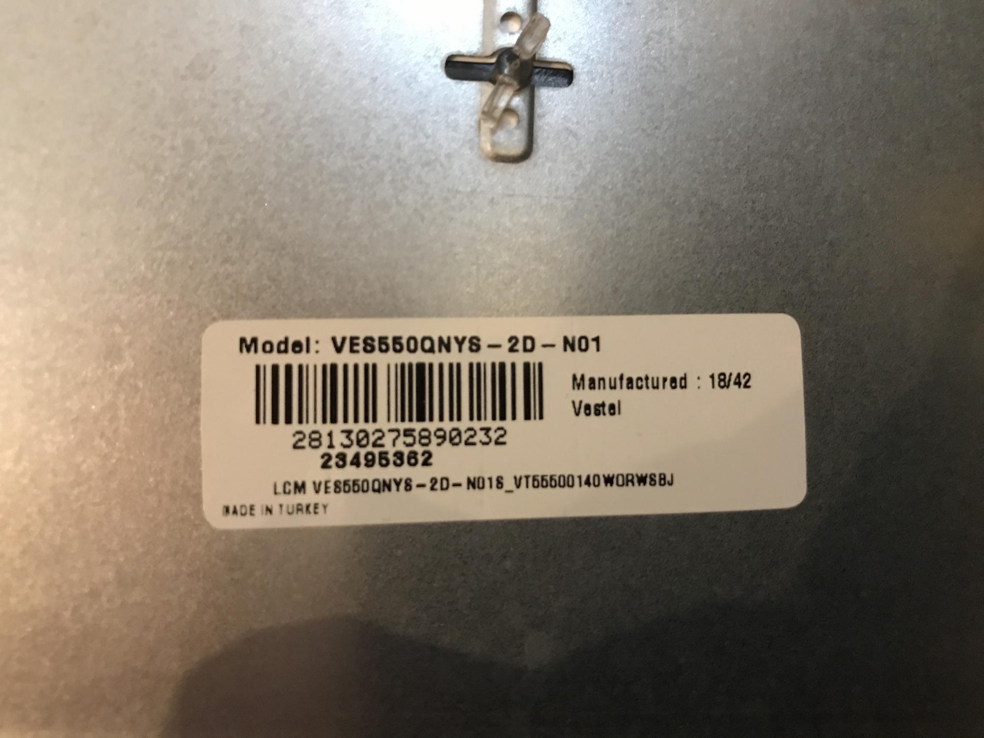

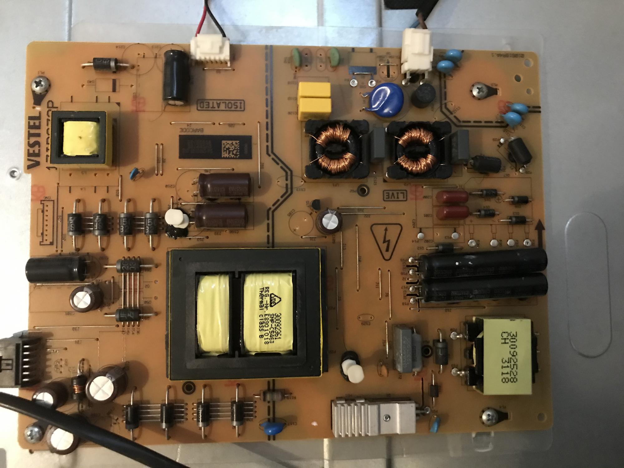

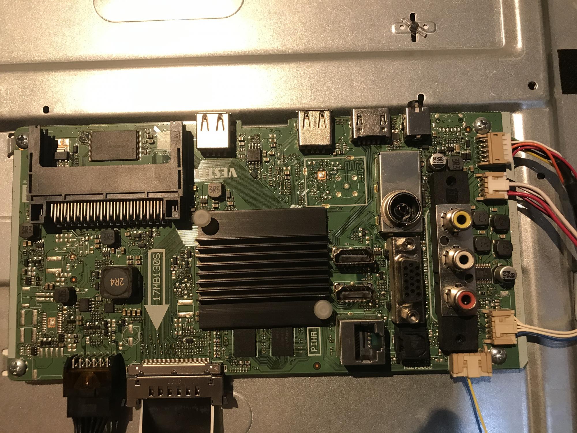

      upload here high resolution photo of yours Main boards showing all sticker on it

        I have attached photo's of both boards and stickers as requested.

              don't play with NVRAM at all, just use V5 recovery Firmware the last links i gave you before, and use the methods i described for you too

                      Diah, Obviously I am very greatfull for your help but i have tried a couple of them files and I keep getting the same message on screen in a blue box "Software download error".
                      When using the USB Flash drive formated to Fat32 then putting the firmware file on.....
                      The file is only 1 single file but all the advise I keep reading on line say's about 3 File's that should be on the flash drive when attempting the flash/update of the Firmware, ie; an MBoot file aswell as the firmware file and one other???
                      Am I wrong or do I need other file's aswell as the Firmware file???

                        Arıza Notları gave you link to download 3 files did you tried them ?

                          Diah... Well good and bad news... 1st the good= the files did load and the tv turned on!
                          2nd the bad= the firmware was for a Finlux tv and now the remolt will not work and the control button on the tv wont work either which means I am now stuck at the first screen where the language is selected for the tv.
                          I have tried to change only the firmware file on the usb flash drive and re do it but as the remolt will not work it just goes to the language screen.
                          Even though I am greatfull that you have got me half way there and confirmed that the tv is not broken and it's just a firmware issue I am still stuck with a tv that won't work.
                          I am thinking that I need a universal remolt control programed for a finlux tv to sort this out? Any advise???

                            easy way use mouse usb or air mouse to control the tv direct..
                            or use remote apk for android on any device mobile had IR sender such Galaxy S5

                              Even though the firmware was for a finlux tv now I have a all for one remolt I have set up the tv and it is working fine and I like the finlux set up better than the panasonic one as there is more options for app's etc.. so even though I have the latest SEC. file update from the panasonic site I don't think I am going to use it... I am enjoying the TV as it is as a Finlux!
                              A BIG THANK YOU TO YOUSELF "DIAH" YOU SOLVED IT FOR ME SO THANK YOU VERY MUCH......... THANKS!!!
