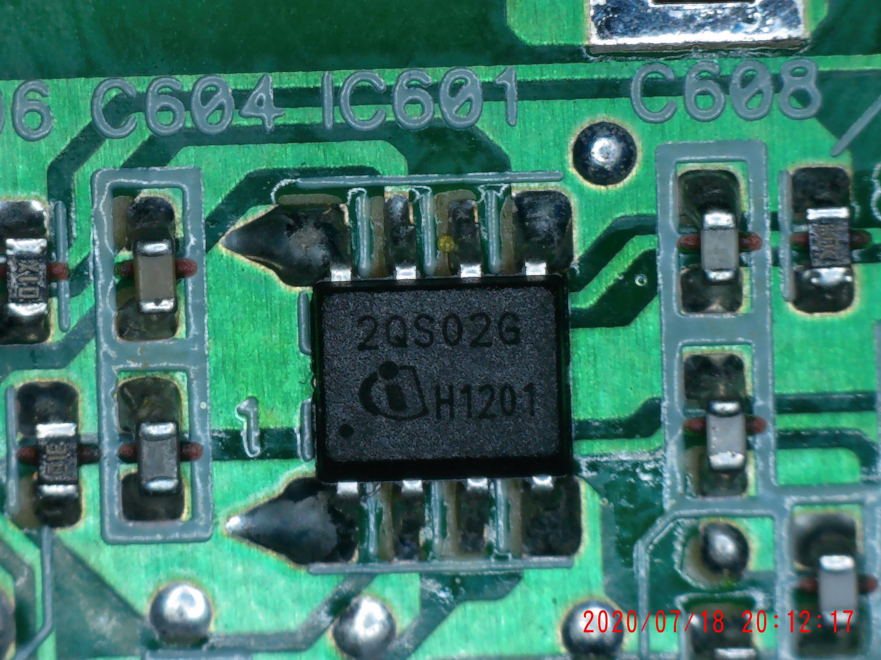

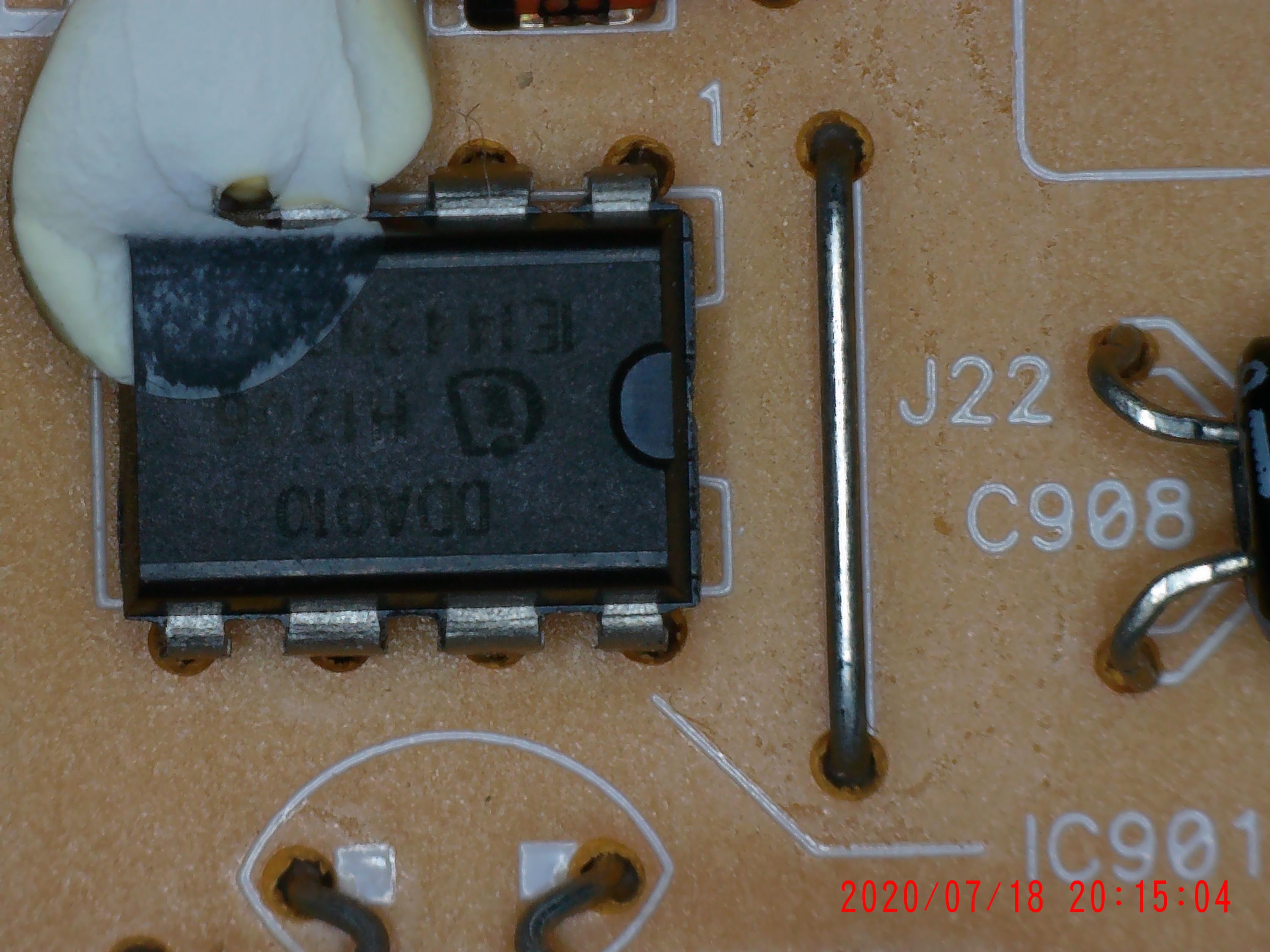

    Hello

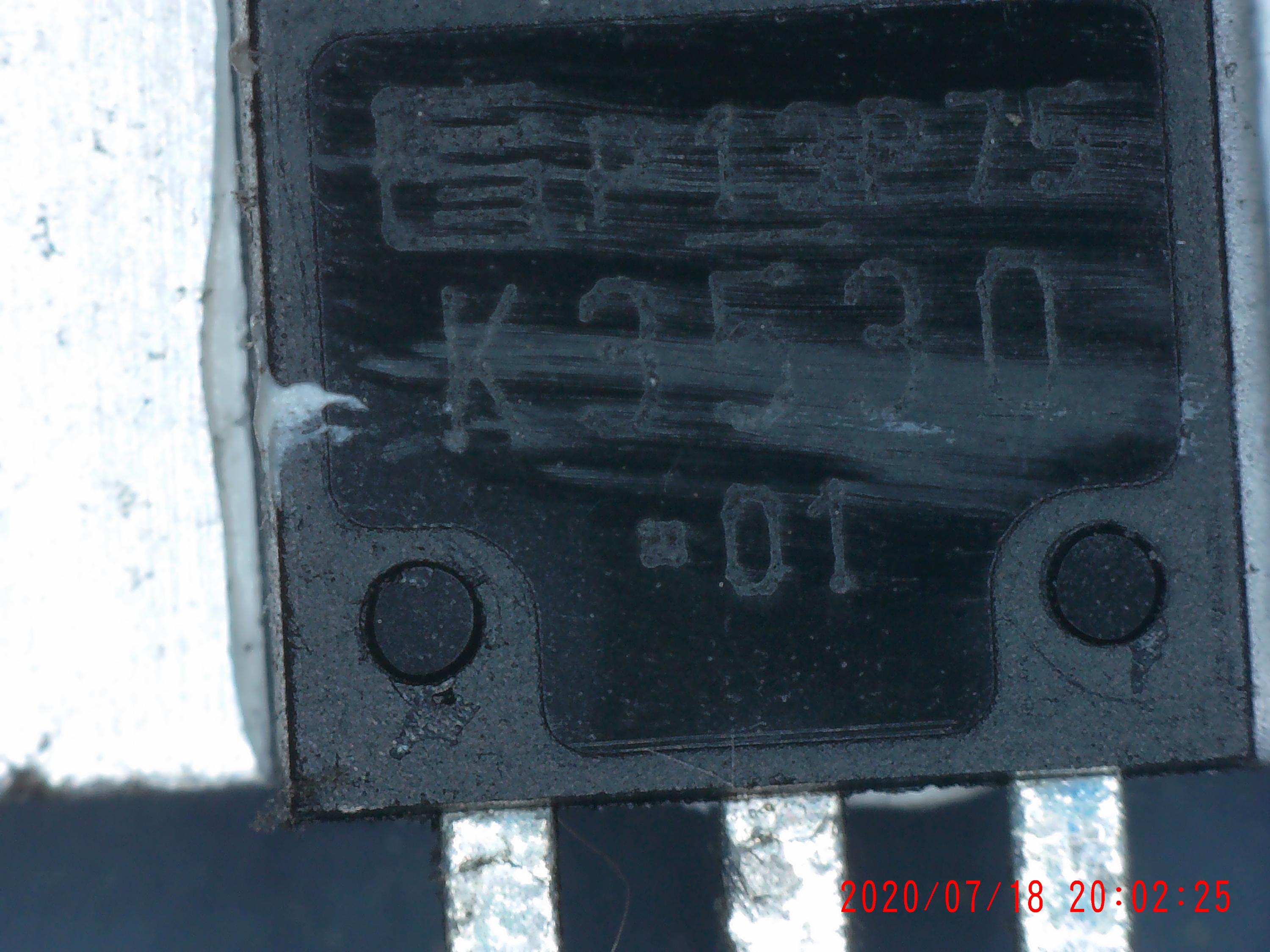

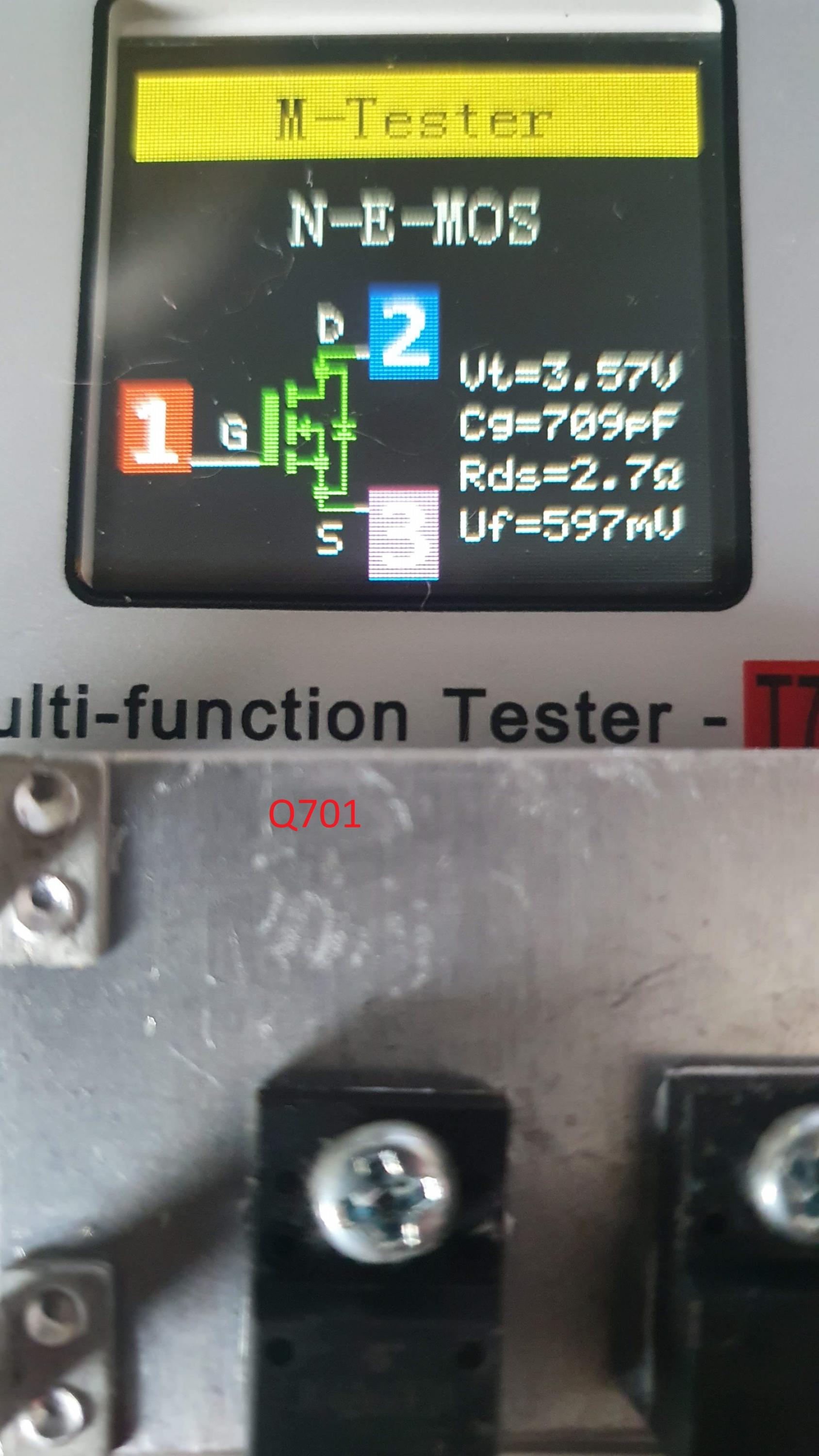

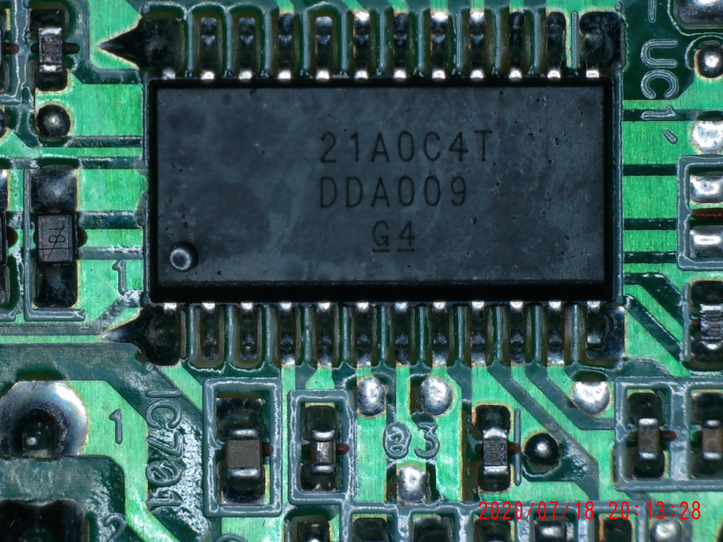

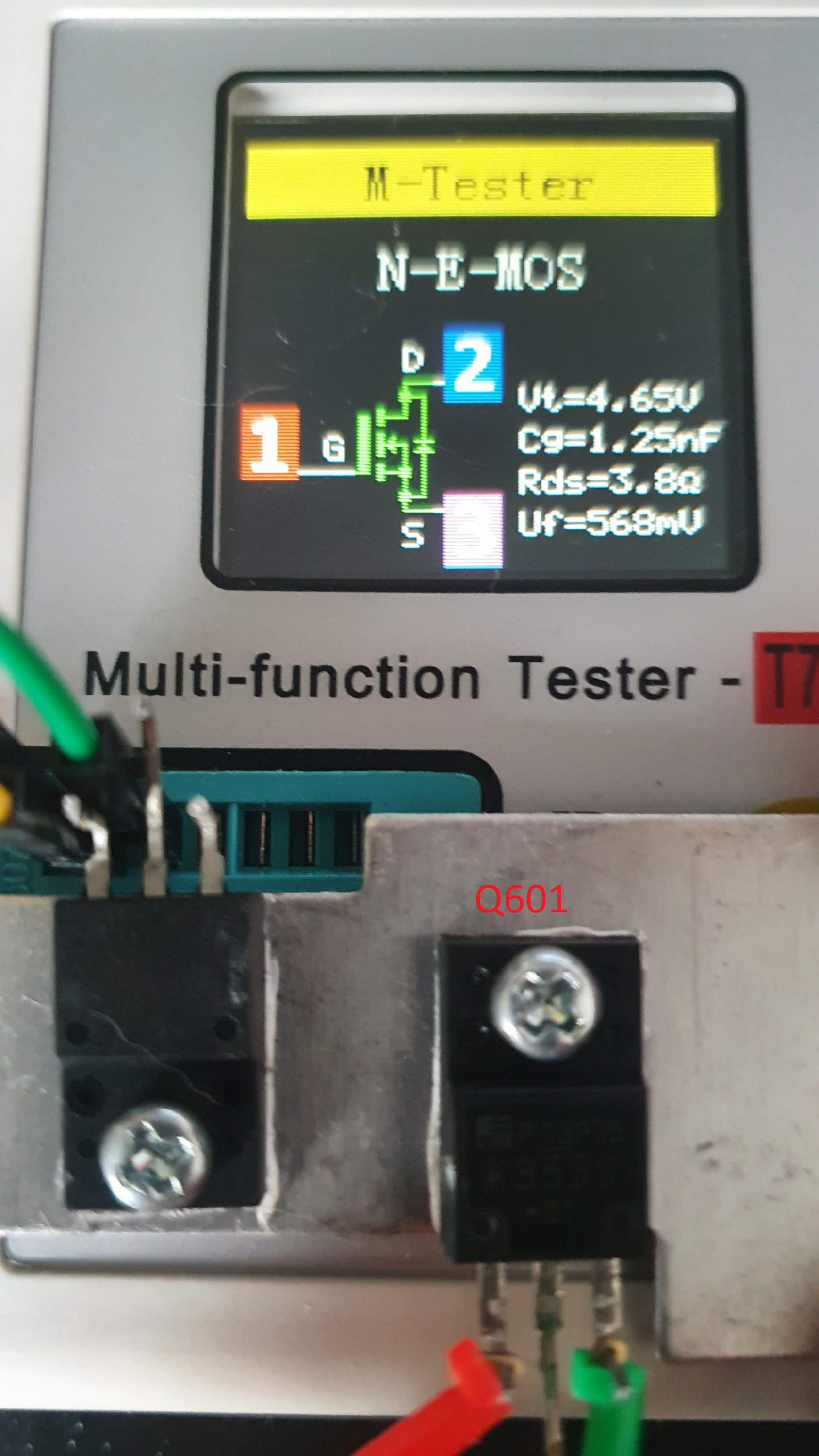

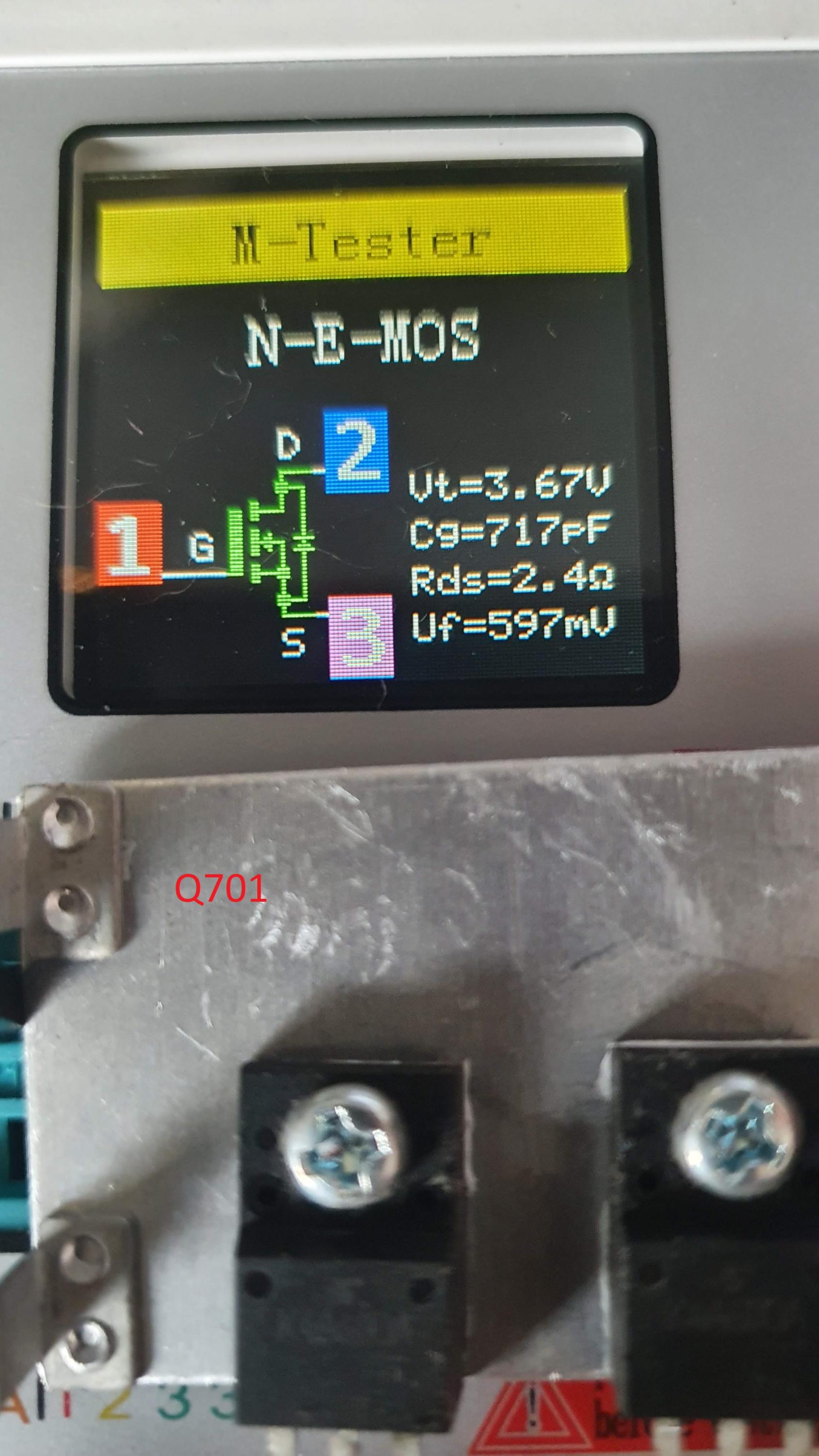

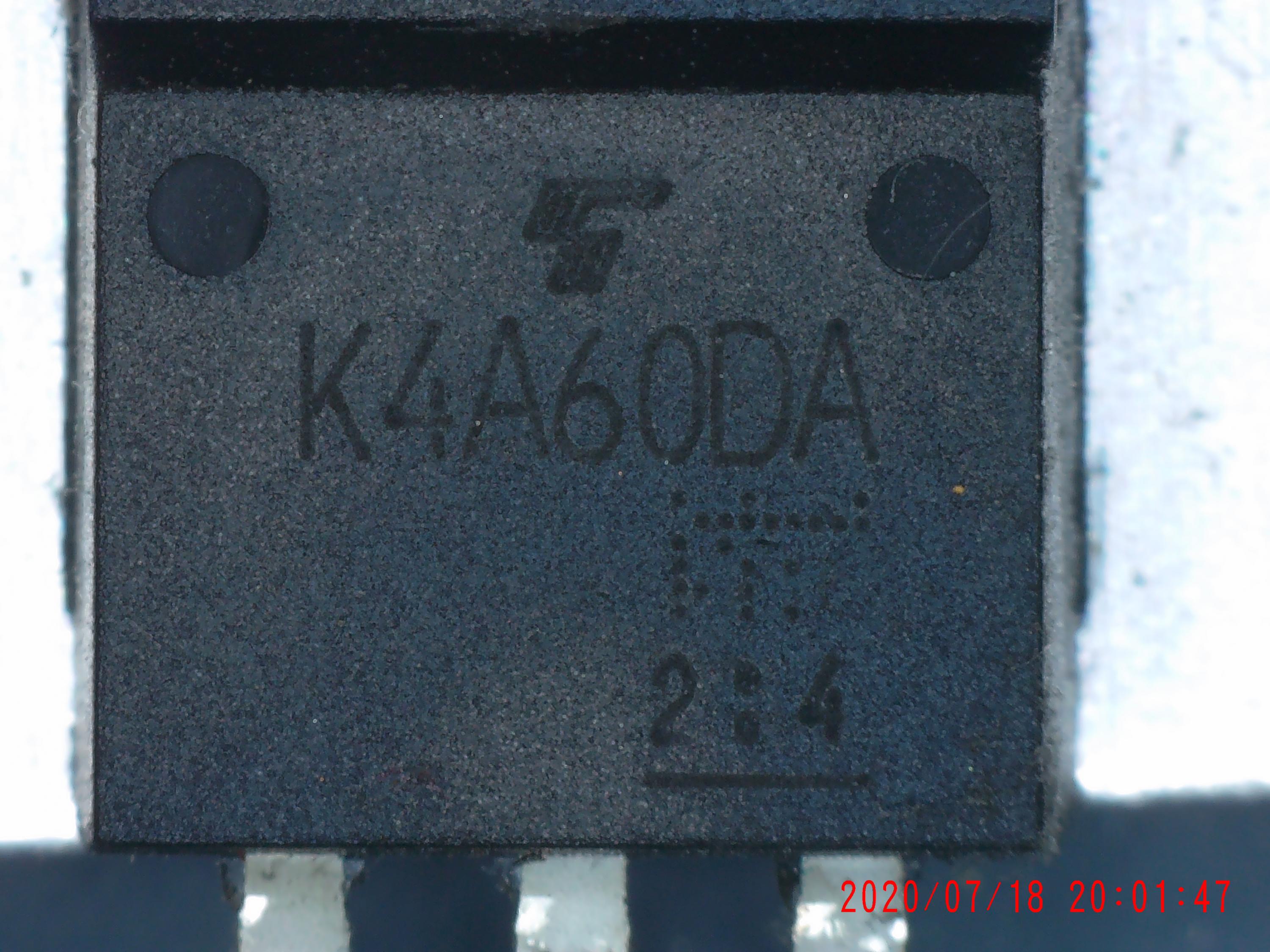

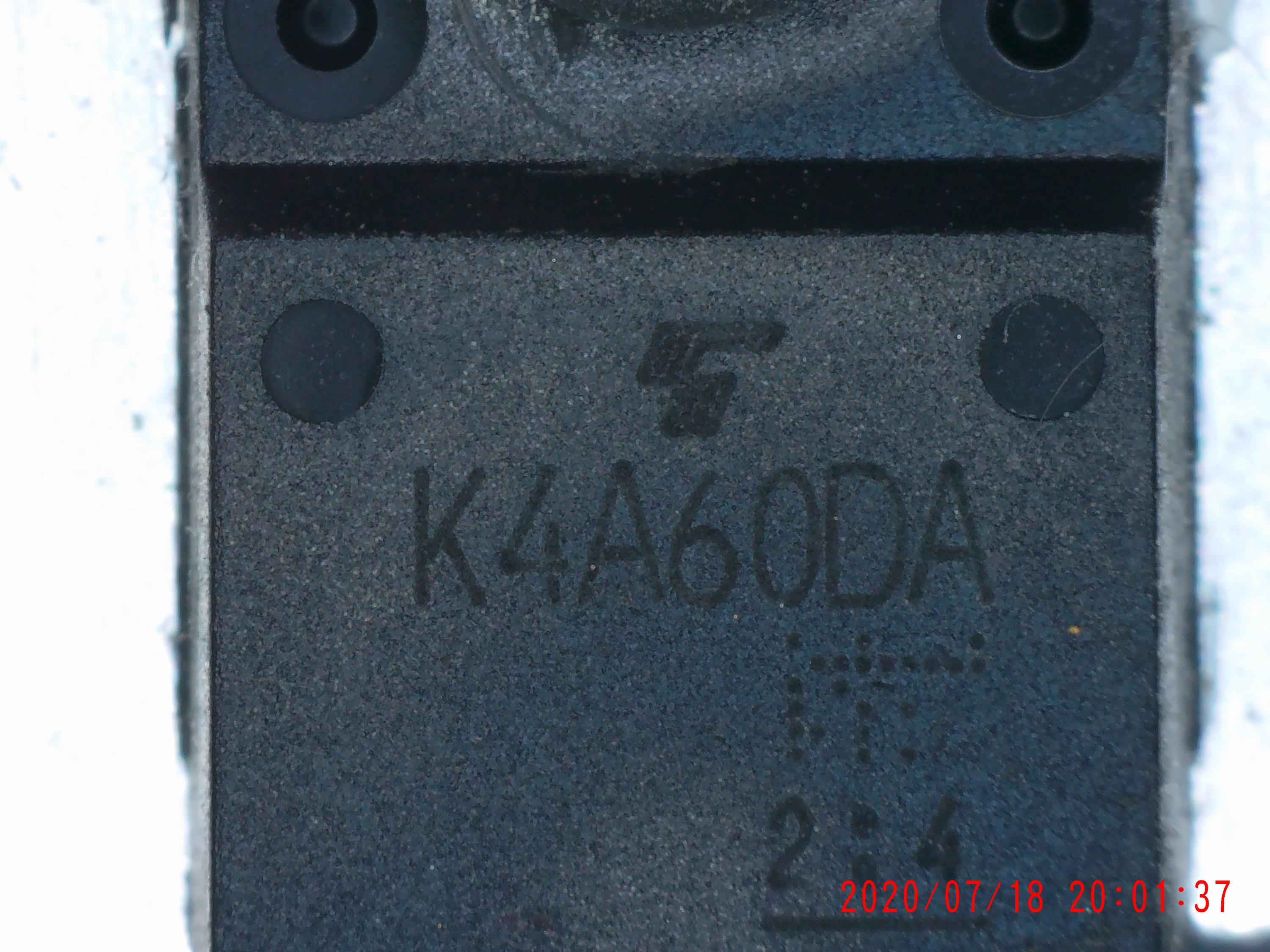

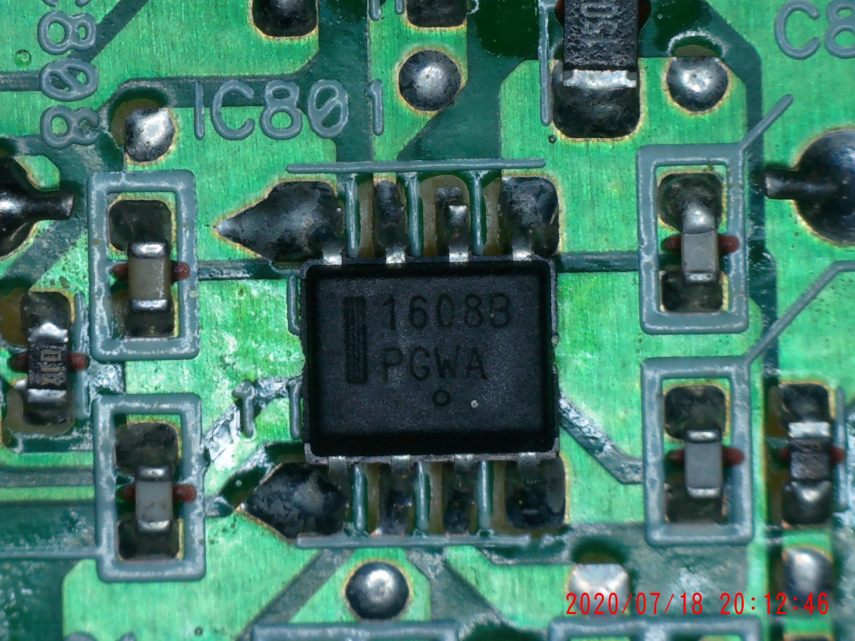

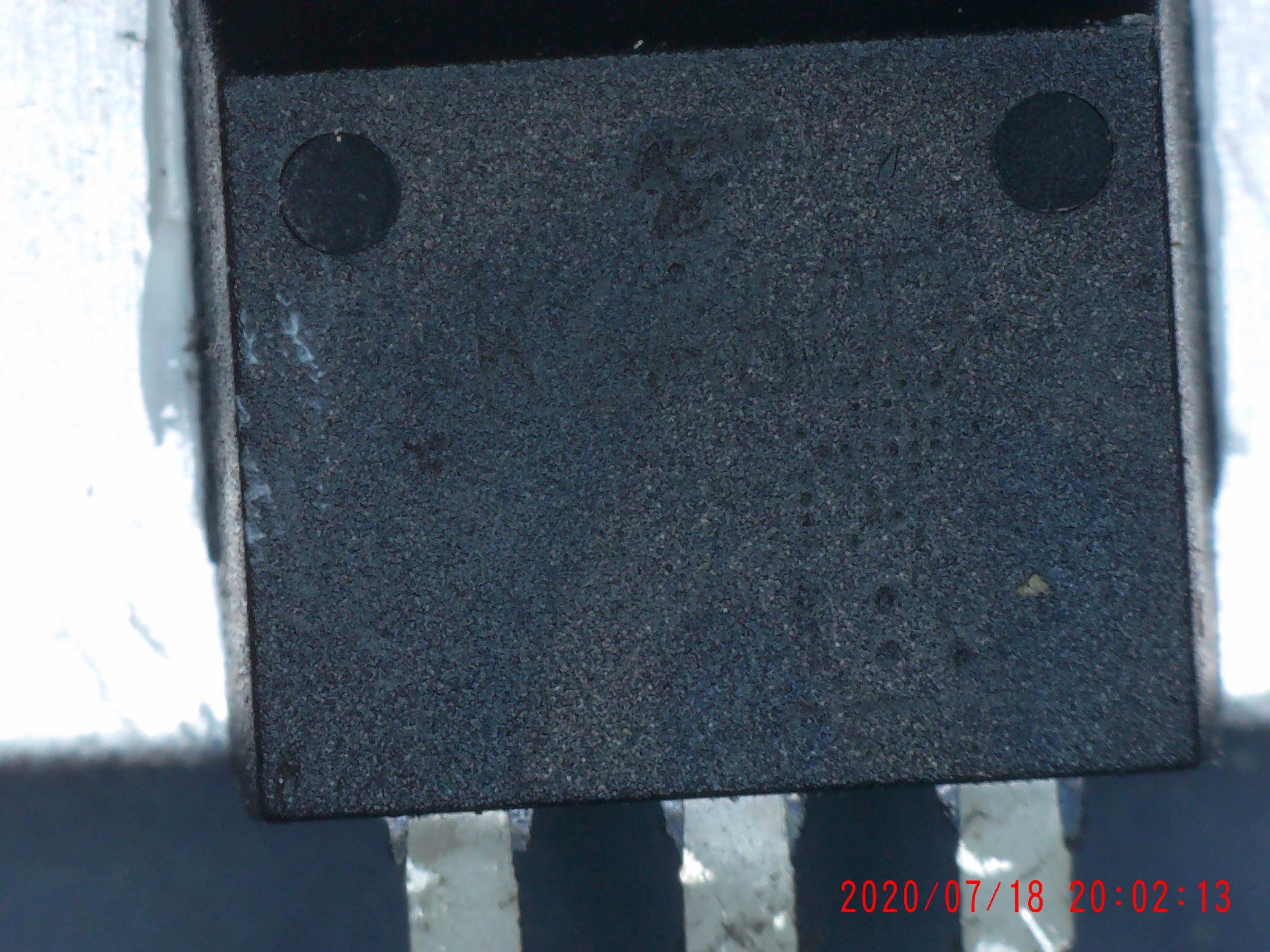

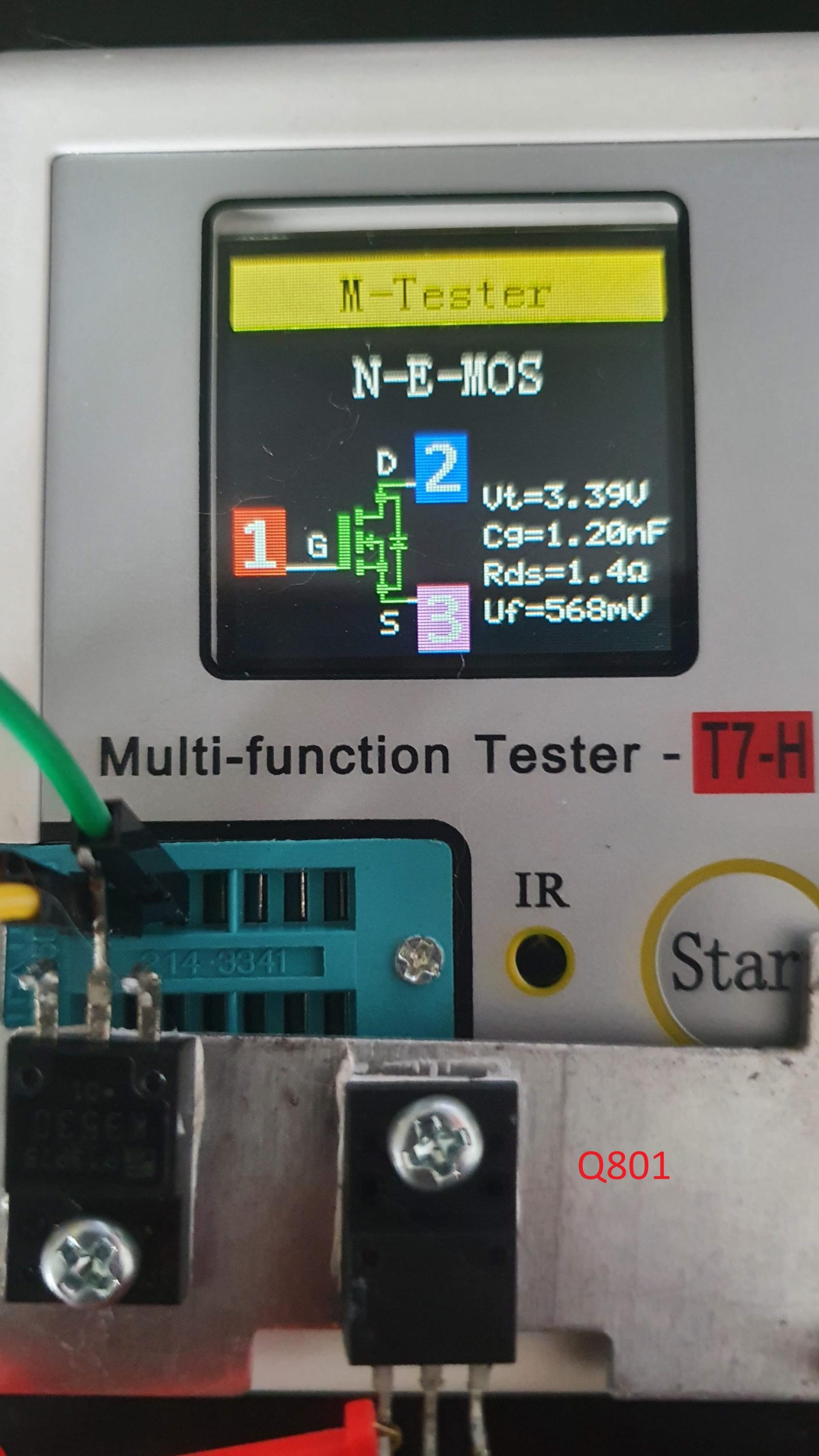

    this are the part numbers of those parts
    Q601 = K3530
    Q801 = Cannot read
    Q701A = K4A60DA
    Q701B = K4A60DA
    IC601 = 2QS02G
    IC801 = 1608B
    IC701 = DDA009
    IC901 = DDA010
    IC902 = S101202D

      Originally posted by thommyX
      IC901 is a DDA010 and IC902 is an ST9S101 / IN1M101.
      If the brown out is faulty, you have fluctuating tensions.
      LG Thomas
      Changed both IC and problem is still the same

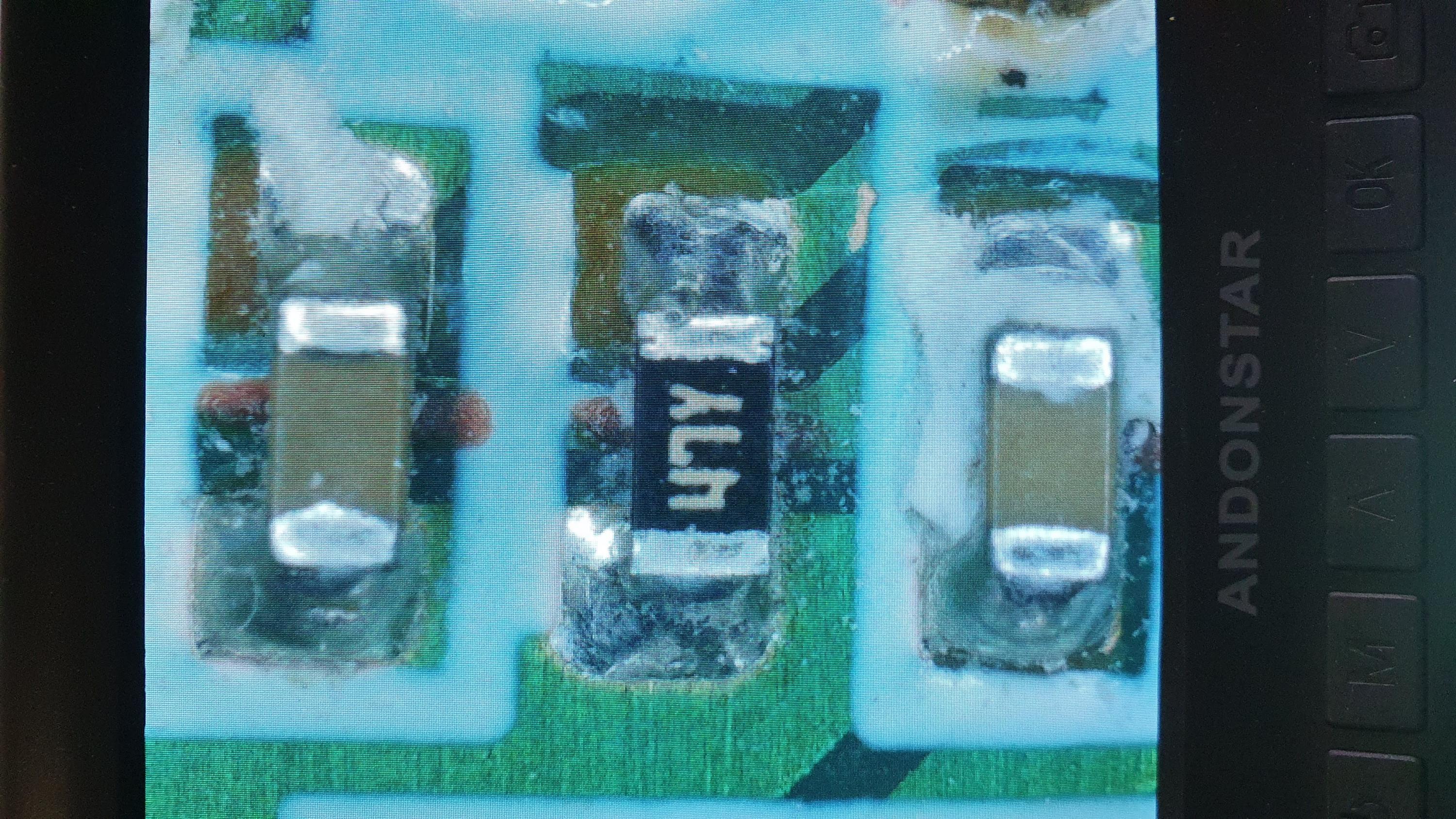

              When ZD904 soldered out iam getting 3ohm in R902 also when soldered out it is 3ohm marking on the resistor is 47Y
              • dick_barton
                • Aug 2015
                • 6643
                • Wales
                Re: 42PFL7406 No Power
                47Y is 47 ohms according to http://kiloohm.info/eia96-resistor/47Y
                Are you certain it's 47Y since that seems to be a high value resistor as a source resistor.

                  iam confused.. according to the same site it is an 3.01 ohm
                  Please see picture in previous post for resistor
                  • dick_barton
                    • Aug 2015
                    • 6643
                    • Wales
                    #29
                    I stand corrected it is 3.01 ohms.

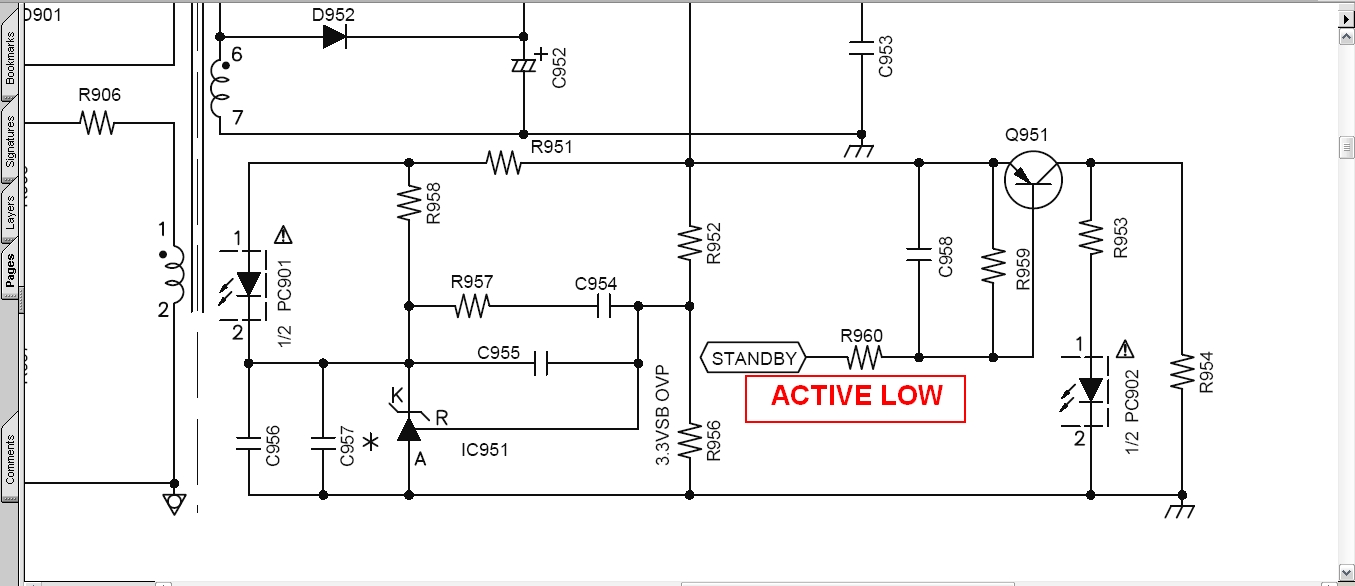

                          The PS-ON (STANDBY) for this Philips power supply is Active Low, so you need to Ground pin 2 (STANDBY) of CN4 to Ground pin 3, 4, 8, or 14 using 100 Ohms resistor or so to turn on the power supply.

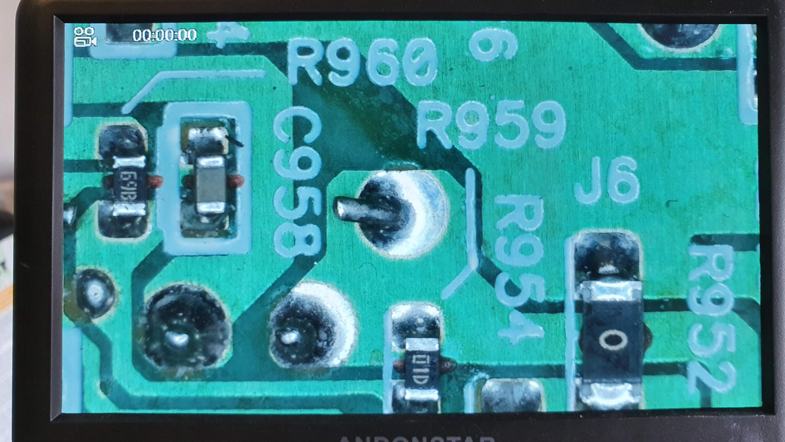

                                Both resistor measure oke, measured them in circuit
                                R959 = 01D = 100kohm
                                R960 = 69B = 5.11kohm

                                  Looking at those values I think it's safe enough to short standby to ground.
                                    #37
                                    I suggest using resistor just in case OP ground the wrong pin on the connector by mistake if he jumps directly, OP can jump STANDBY pin to ground directly with no problem, I am just afraid that OP will make mistake and ground the wrong pin.
