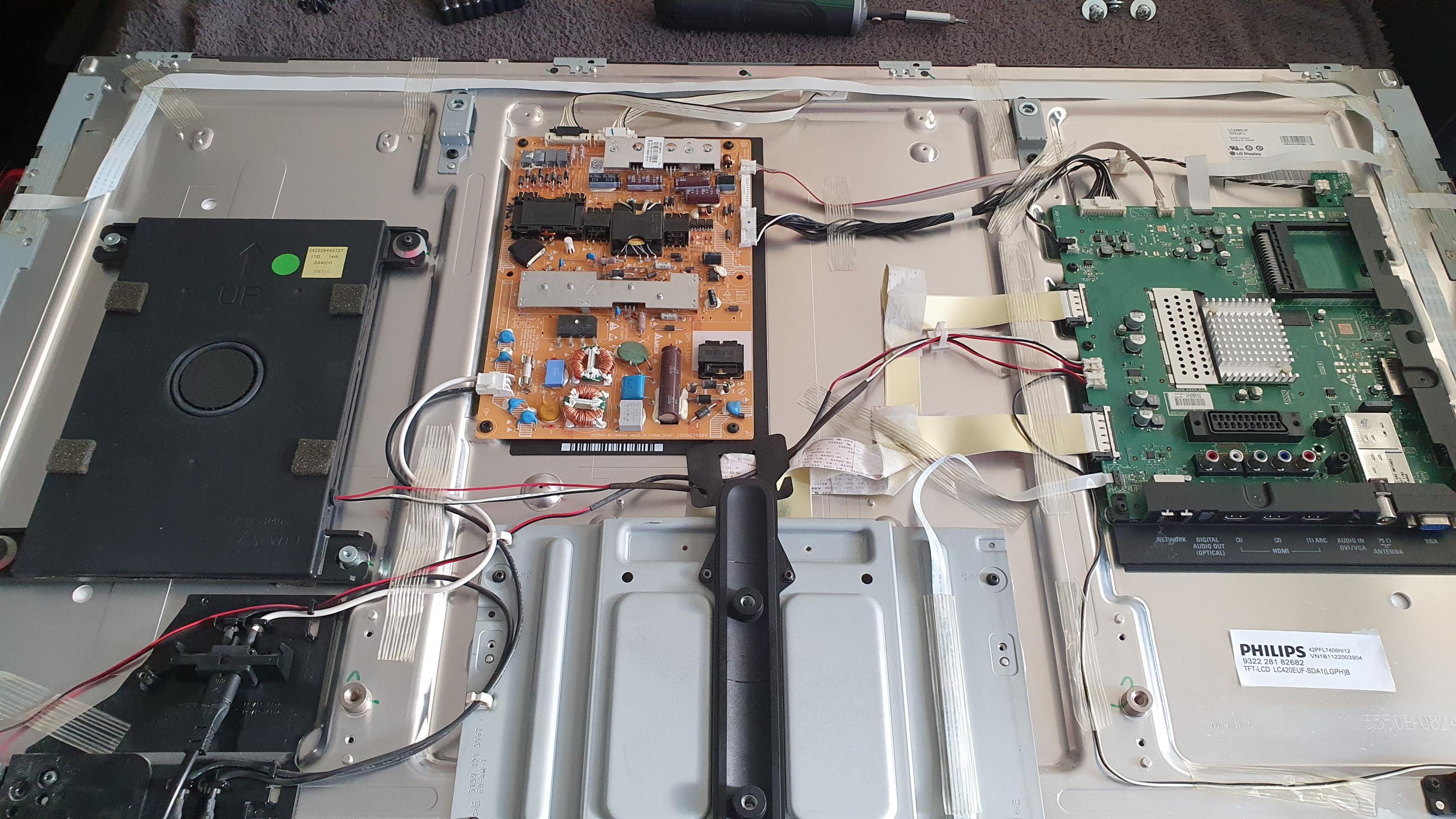

    Hello
    ive got an PFL7406 with power supply DPS-139AP looks like the PFC Boost wont start.
    When Power supply connected to the mainboard iam getting these readings from the rectifier voltage changes from 290V to 315V and over the filter cap iam getting 390V to 410V
    All the caps on the board have an good ESR tested with an Peak ESR 70

    The PFC Voltage booster is working otherwise you will not have that 390V to 410V on the main filter cap, 410V is in the high side, the PFC boosted Voltage is in typical range of 380 ~ 400V, so is your meter is accurate?. BTW, the PS-ON from main board is also OK otherwise the PFC will not be running right now.
    How about other Voltage on the power supply connector that goes to the main board?

      Re: 42PFL7406 No Power
      Hello
      Meter iam using is an UNI-T UT181A never had any issue with this one !
      Also on connector to the mainboard iam getting weird readings.
      3V3 = Jumping all around from 2.9V to 4.5V
      12V = Also jumping around from 3.2V to 5.9V then OL.
      24V = Jumping around from 19V to 25V
        Are you getting steady 3.3V at 3.3VSB at pin 1 of connector CN4 per schematic?
        • trunks81
          • May 2020
          • 265
          • Nederland
          Hello Budm
          No that is also jumping around from 2.9 to 4.5V
          Measured it multiple times
            Disconnect the cable between power supply board and the main board to see if the 3.3VSB is steady or not, BTW it is important to use the correct name for the pin.
            • trunks81
              • May 2020
              • 265
              • Nederland
              When mainboard is disconnected 3.3VSB is steady
                So it can be weak 3.3VSB power supply or the main board is loading down the power supply too much and causes the 3.3VSB to go into shutdown/restart loop.
                You can check the capacitance and ESR of the caps C908, C910 in the hot side of the 3.3VSB section (SCHEMATIC PAGE 1), or just replace them if you do not have EER meter.

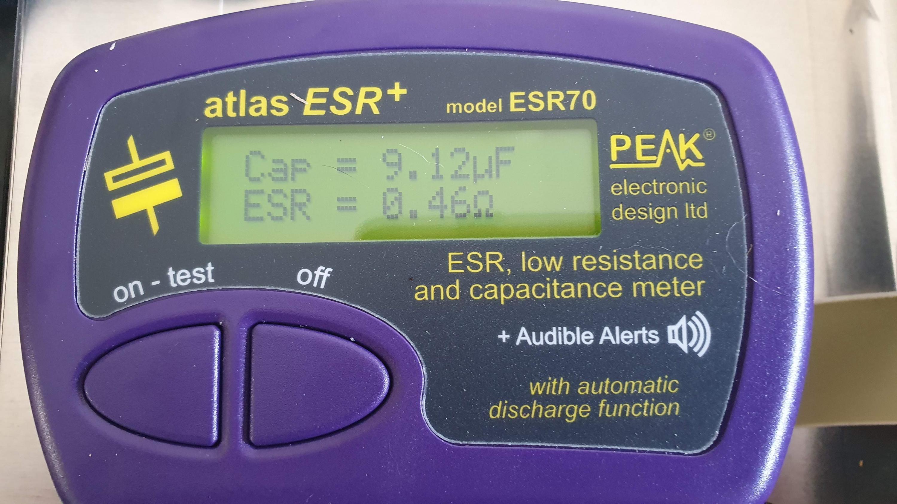

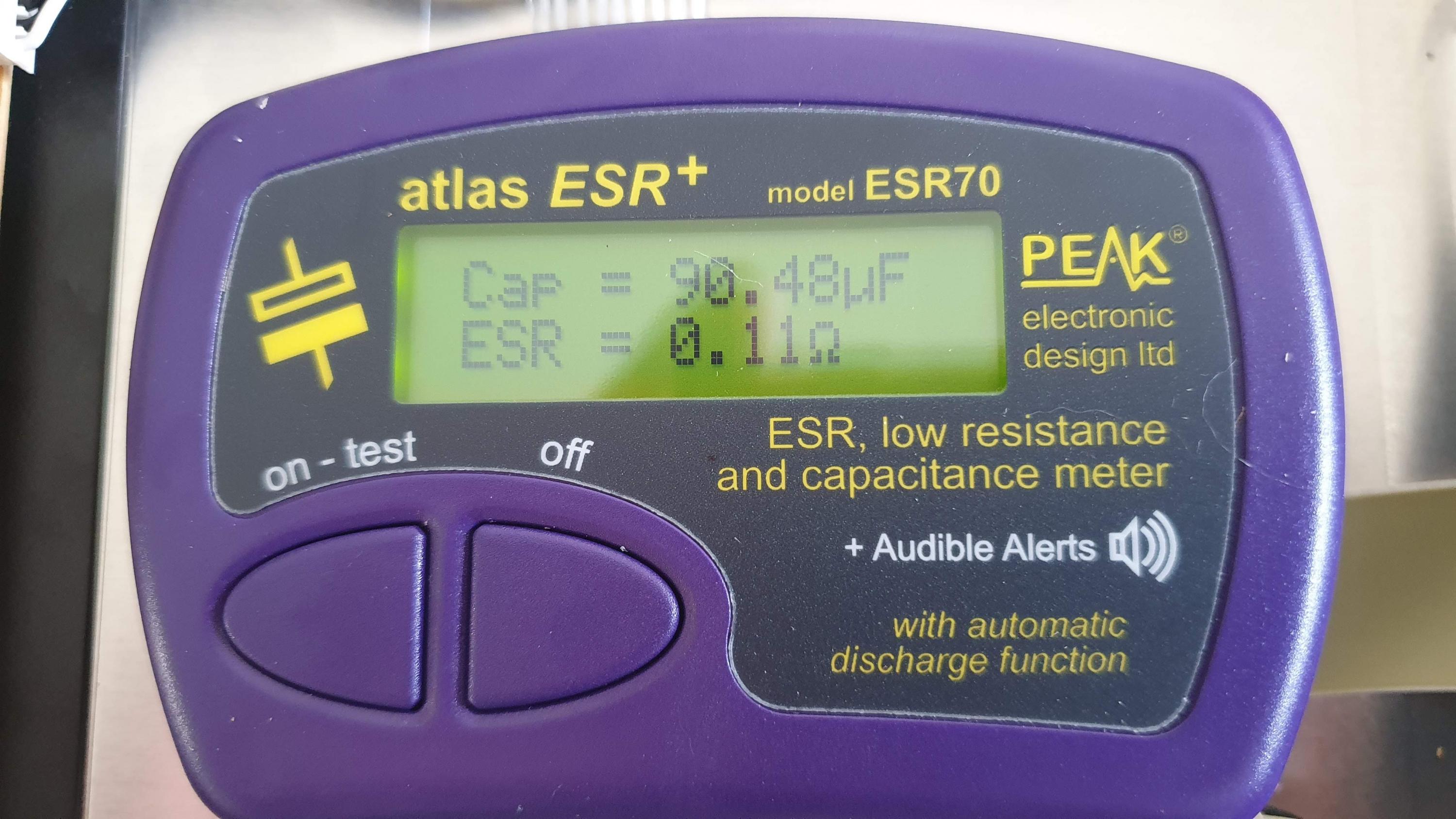

                  Hello
                  Tested both caps and the look fine
