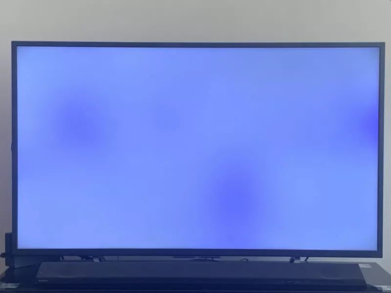

    Hi Guys
    Just wondering what might be wrong with this tv. I only have a pic so cant get too in-depth withe the testing.
    Just after rough ideas.
    The Tv is a Sony KD-X497000D
    The info I have is that it is showing "purples spots" on the tv that are particularly visible on white screen.
    I think it may be burned out LED's but not sure. I have had a few tv's before that have had LED issues, but it was always - 2 blown led's, dark screen - so I dont know if a tv will even light up like this if it was a few blown led's?
    Ideas?

    Re: Sony KD-X497000D showing purple spots?
    Purple or blue LEDs on a TV occur when the phosphor coating has been burnt oway due to being over driven.
      So the led's have been set too bright and its a damaged screen and not fixable?
        One problem is that the light emitted from the led turns blue when they have been overdriven.
          The fix is backlight replacement if the leds have turned blue/purple, a current mod would be advisable too or at least set the backlight to as low as tolerable.
            so its not a panel issue and is fixable with led replacement?
                No not panel fault, just overdriven leds.
                  They want $150 for this tv and a glass unit it is sitting on (that MUST be taken with the TV lol) so maybe it is worth it?
                  49" 4K smart tv for $150 + new led's
                    Have you priced out the cost of replacement led strips?
                              Havent been able to find the right part number for this one yet.
                                That's a good question, I'm not seeing any backlight strips that match this model.
                                      But where?
                                      Im gunna get annoyed if I have to pull it all apart to get a part number.
