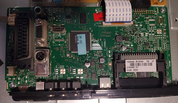

    Hi, I have this TV, which makes 3 flashes, a pause and three more flashes, everything repeats cyclically, the power card is: 17ips11 300413-r14, the card is fully functional and for safety tested on a working TV, the the main one is: 17mb82-2 where the error is surely hidden, now I ask you to help me find it, the Led strips have been checked and they are very efficient, the panel is: VES315WNDA-01_TW

          ok, procedure performed, the procedure starts as you can read the key but the TV returns to the three flashes, now, or the main board has some problems or the software is not compatible, I have another TV same characteristics only the panel code which is: VES315WNDS-01 and the Bar code of the main which is: 23134897 of course and always a 17MB82-2, another detail ... instead of three flashes it makes 5, if I succeed in the evening I do a test on this TV, I'll keep you up-to-date.

              The posted software is a recovery software for all 17mb82 and 17mb82s boards regardless of the panel code. If it did not work you may have a hardware problem. I have other software but it is for writing spi memories with the programmer.

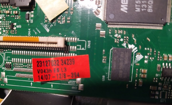

                ok, thanks, as soon as I have more time I will try to replace the two IC 12 and 10

                  ok, thanks, as soon as I have more time I will try to replace the two IC 12 and 10, if you find the single software for the two IC 12 and 10 related to the panel VES315WNDA-01_TW, will you pass them to me? thank you

                    17MB82-2 panel VES315WNDA-01 flash U10+U12

                        If it does not work you can copy the software from the functional mainboard and rewrite it on the defective mainboard.

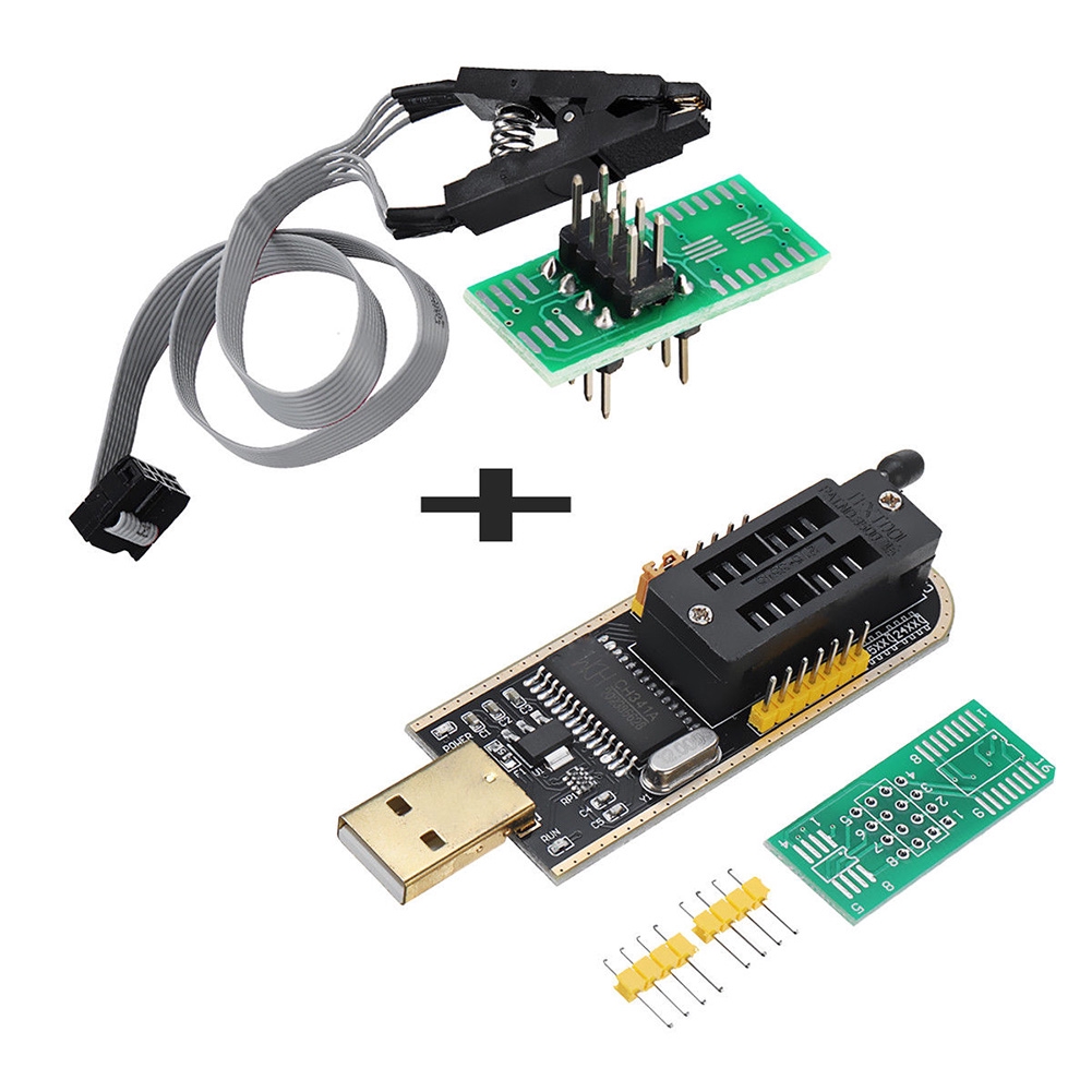

                          thank you very much for your availability, I would like to buy an RT809F programmer but I have no idea how to use it, by the way if I have not misunderstood the instructions are all in English ... which unfortunately is not my strong suit .. .
                          • yokoono
                            • Apr 2010
                            • 488
                            Re: telefunken TE32182B29C10
                            Se sei solo un dilettante, RT è piuttosto costoso. Il programmatore CH341A è sufficiente per ciò di cui hai bisogno + adattatore SCOIC.
