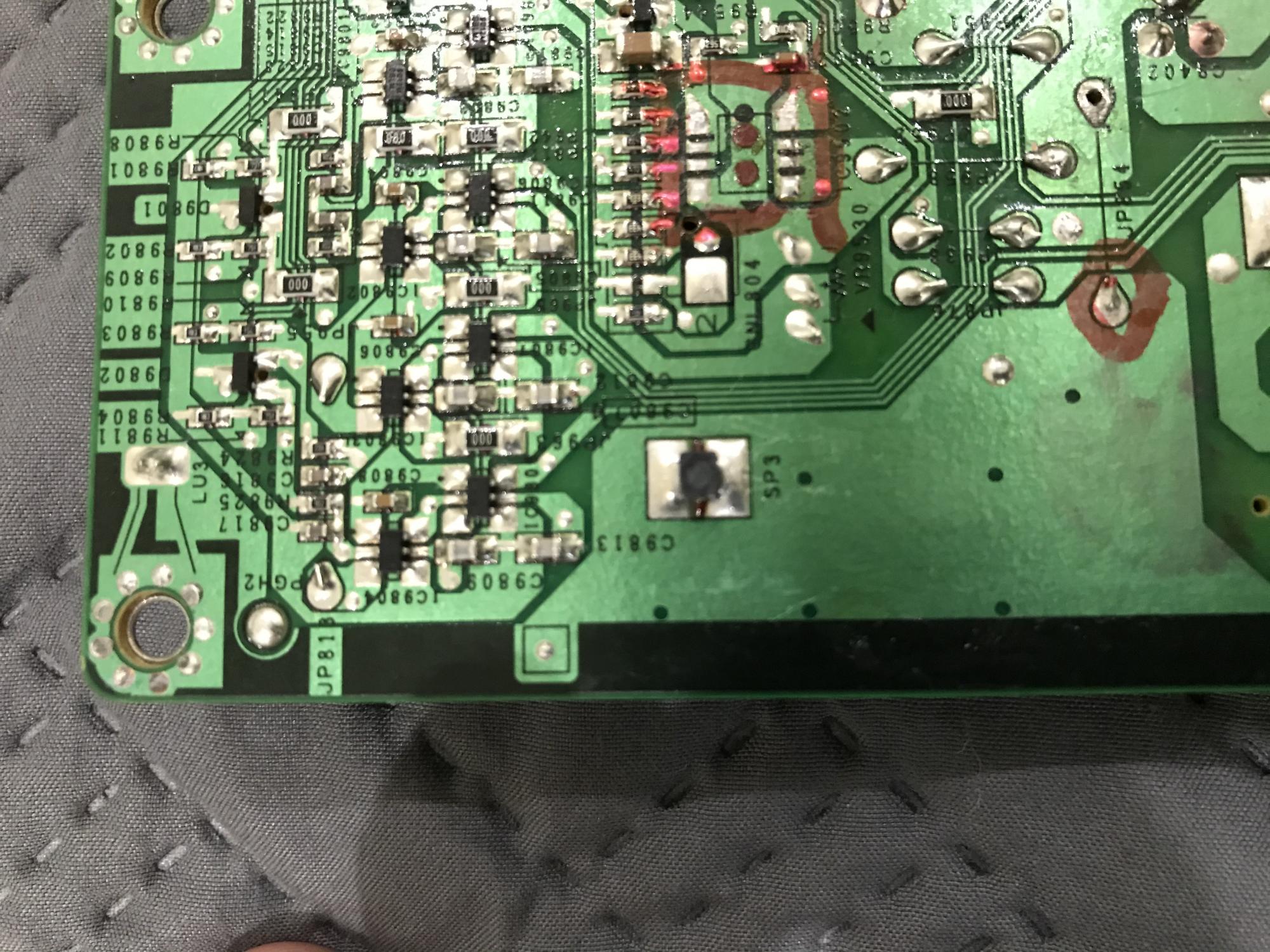

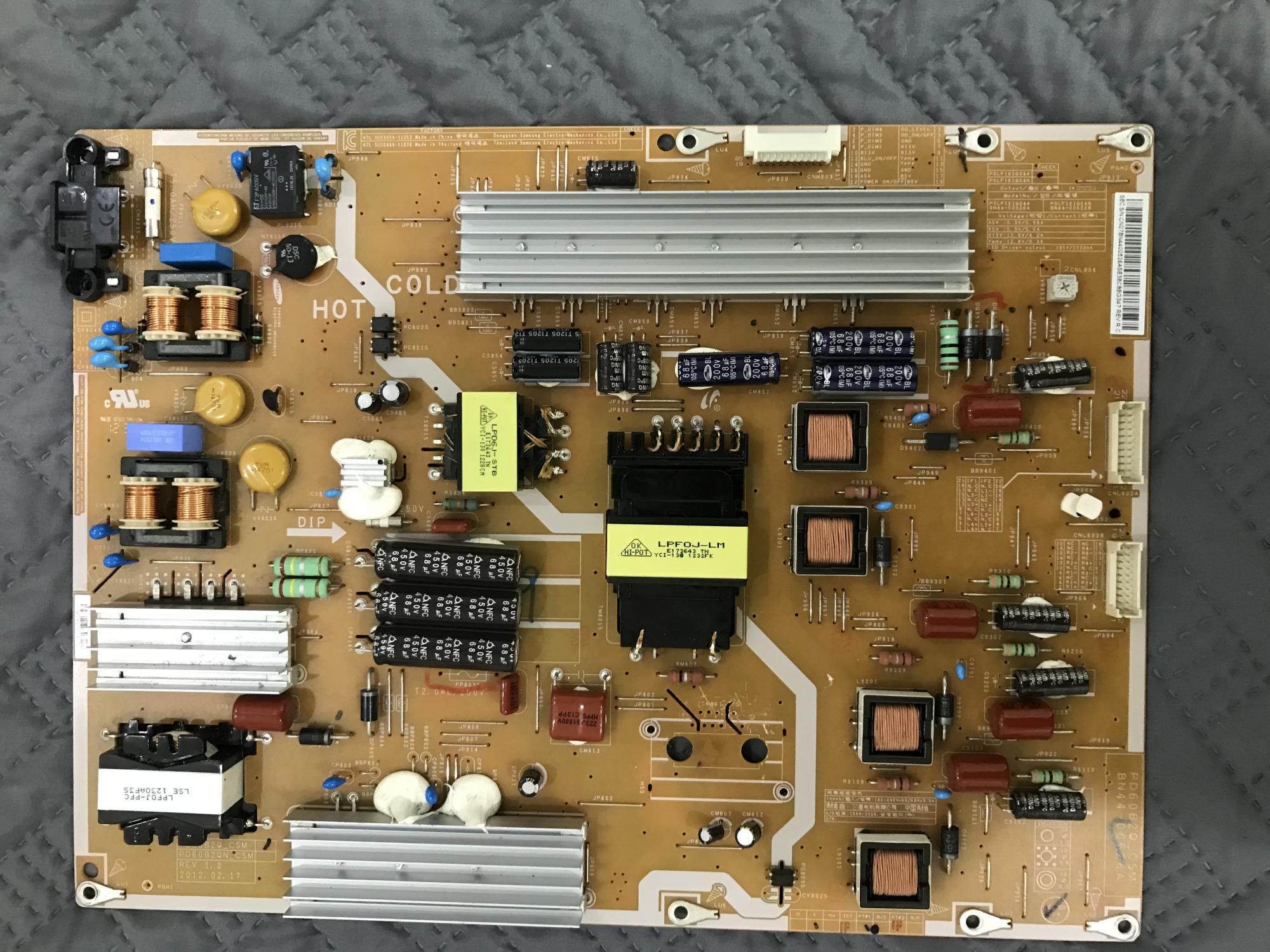

    Hi everyone. Need a little help here. I'm working on a 2012 Samsung 60”
    Model # UN60ES7150. I have orders a repair kit from shop jimmy to replace some of the bad components.
    However I have traced down a short on the board, but have no clue what the part is.
    It's labeled sp3. There are a total of 5 of these on the board starting at sp1, sp2, sp3 etc...
    I'm new to troubleshooting and electronics in general so be easy if this an easy one. .
    Any help would be greatly appreciated.
    Thanks in advance

    Can you post a focused and shart image of the SP1 item? They look like posts to keep the board of the surface but can't really tell from the photo. What's the power supply number BN44-xxxx

      I'm not sure what the spx are exactly, but they are not the problem, they are usually not connected to anything. I think they might be used during the manufacture of the board, maybe a spacer. Post the PROBLEM with the board and any voltages that are there or missing etc.
