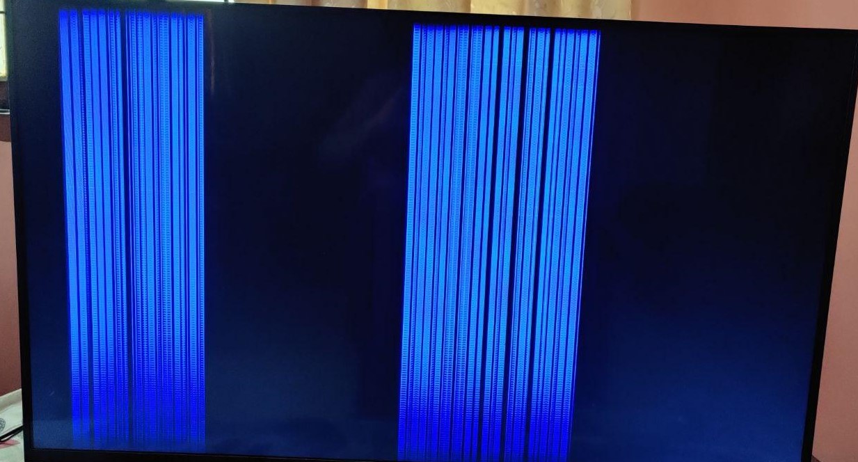

Sony W650A: Blue vertical line, no picture
  • invisiblebond
    • Sep 2012
    • 3
    • India
    Please let me know your opinion
    Model: Sony KDL 42W650A
    Complain showing:
    Blue vertical line, no picture when I connect to HDMI port. (FireStick)
    When I remove all the cable it showing White colour around the edge of the LCD tv.
