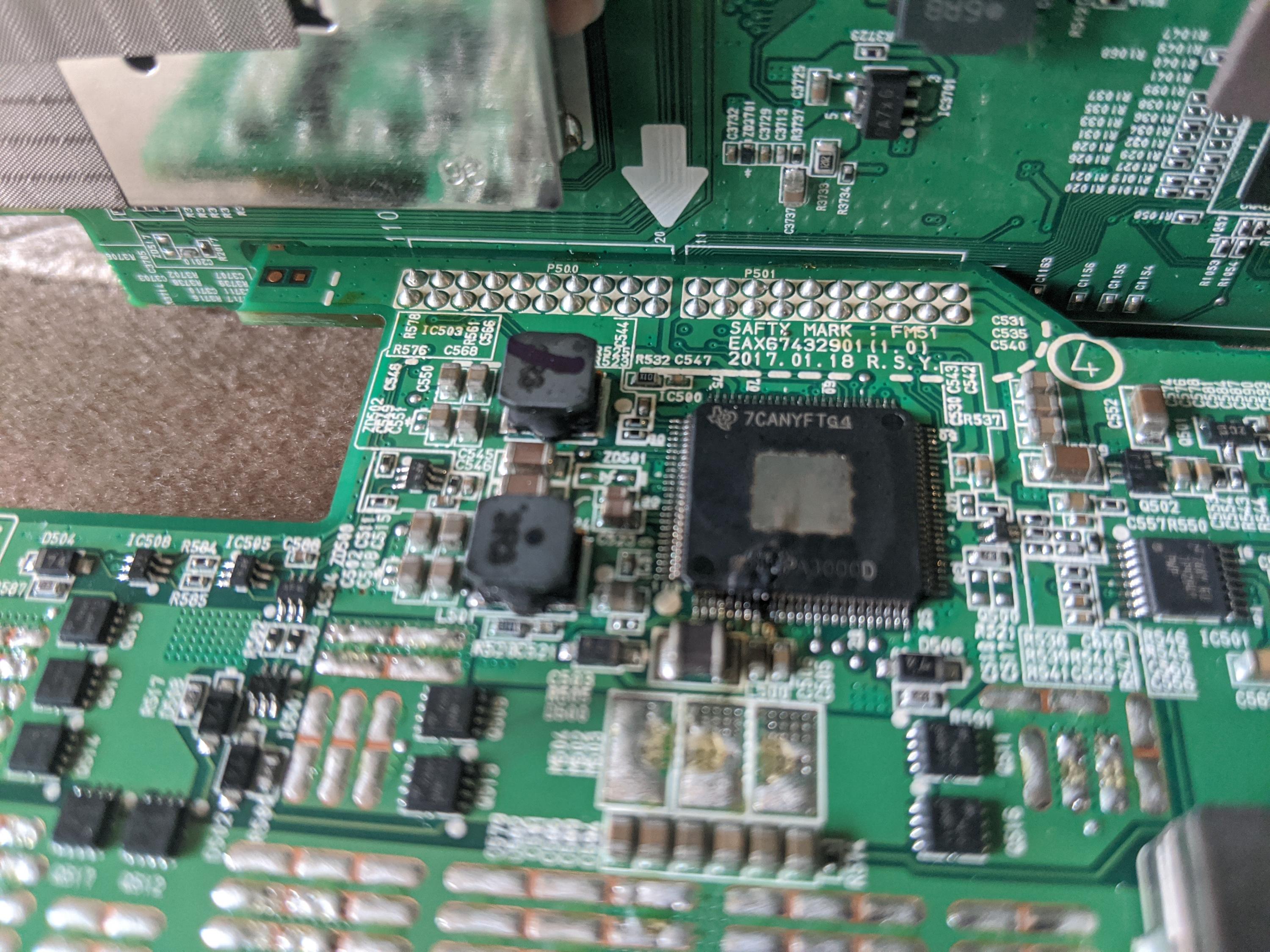

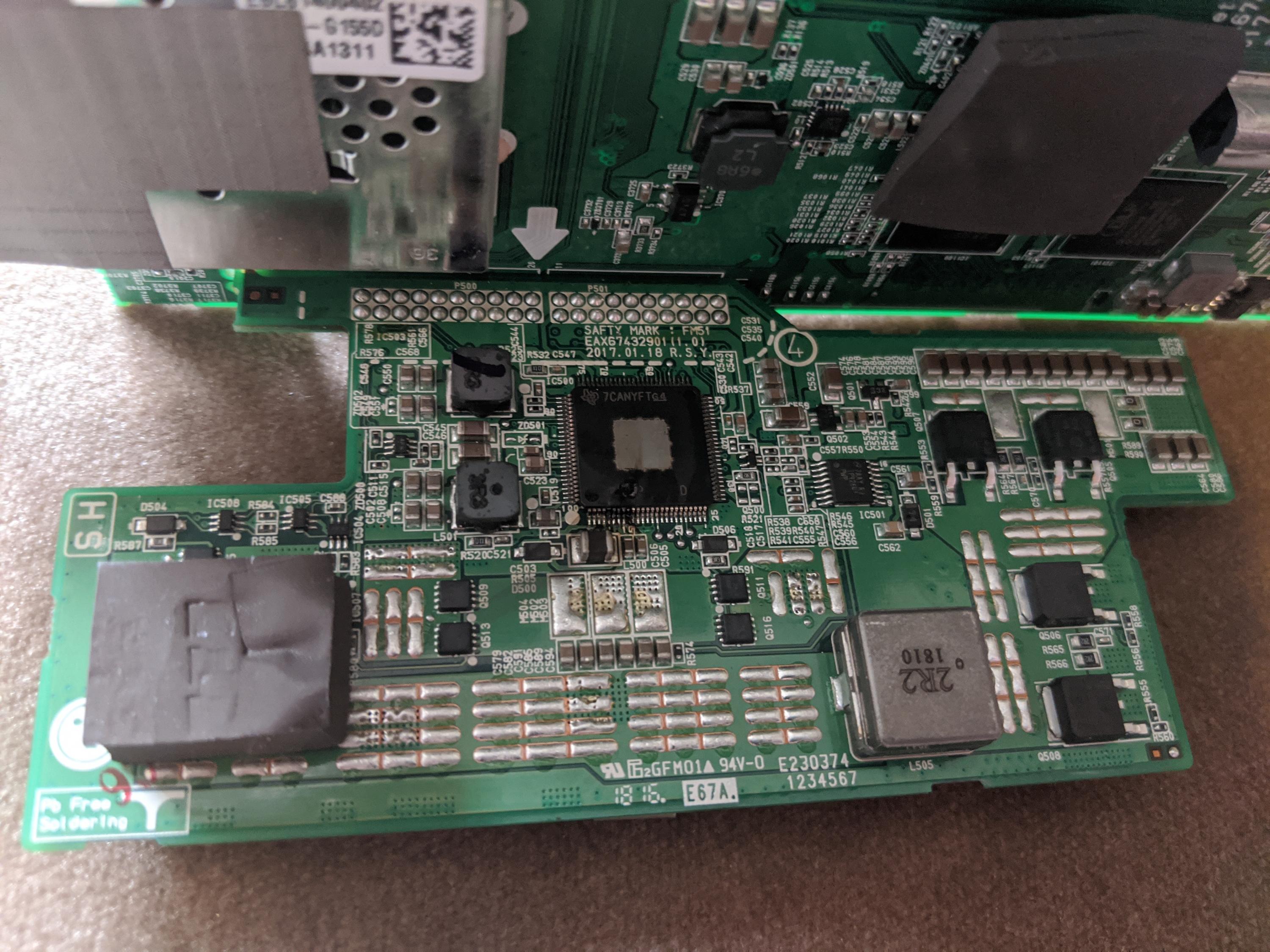

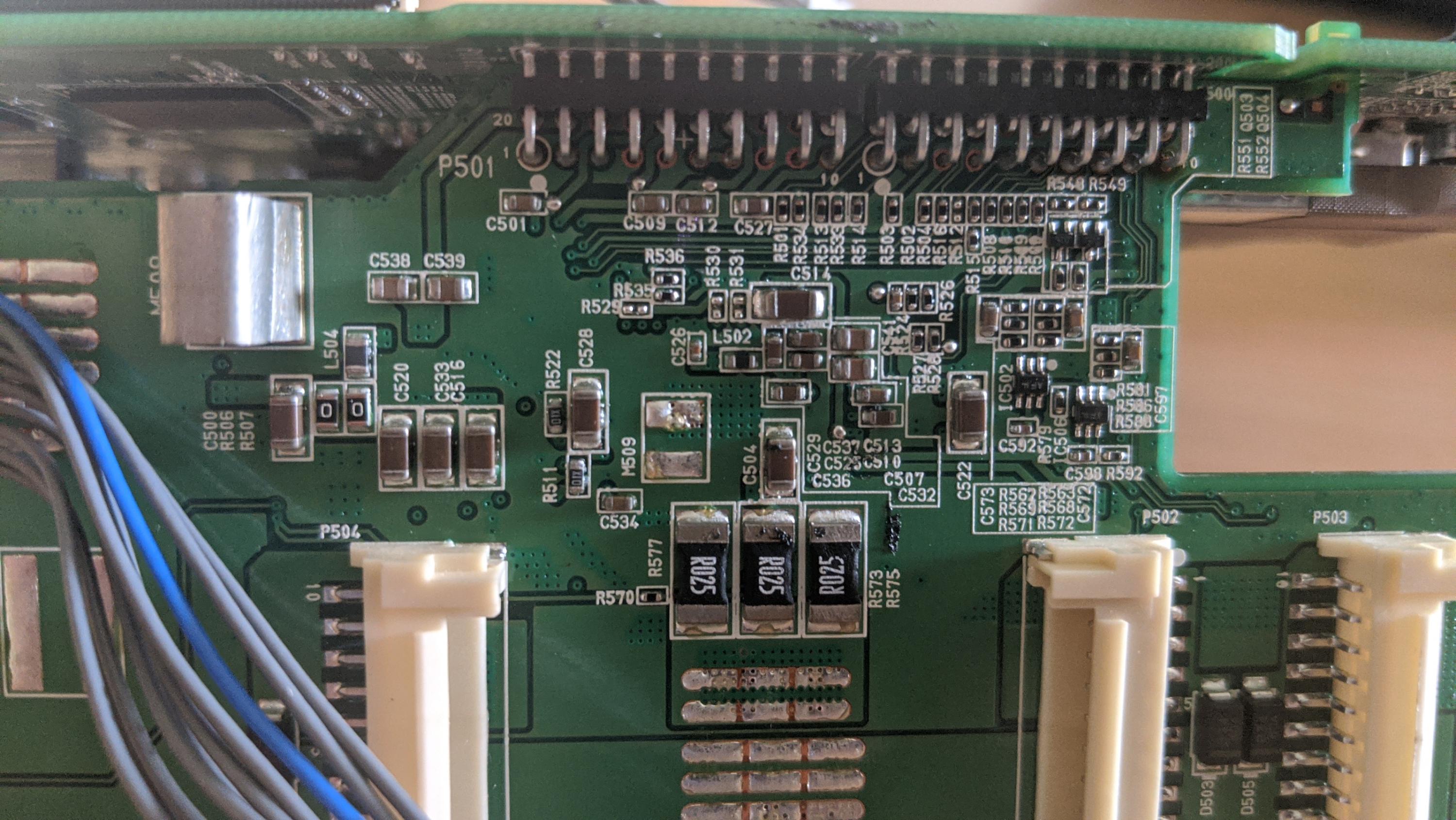

    Hi everyone
    My projector died out a couple of weeks ago.
    It's not techically dead, I can turn it on and I can hear it boot it properly, can turn it off as well, the fan boots but there was no image, no led turning on at all.
    Yesterday I finally had the time (too busy at work) to disassemble it.
    I opened it up and found out that the led drive part of the board had a short and had burned out. The part is the dlpa3000d from texas instruments.
    It appears that pins 5 to 10 got a short and burned down, hence there is no power to the RGB leds.
    Do you think it is the driver itself that went bad or there is another short on the board probably?
    I have attached the dlpa3000d technical data sheet and some pictures of the led board.

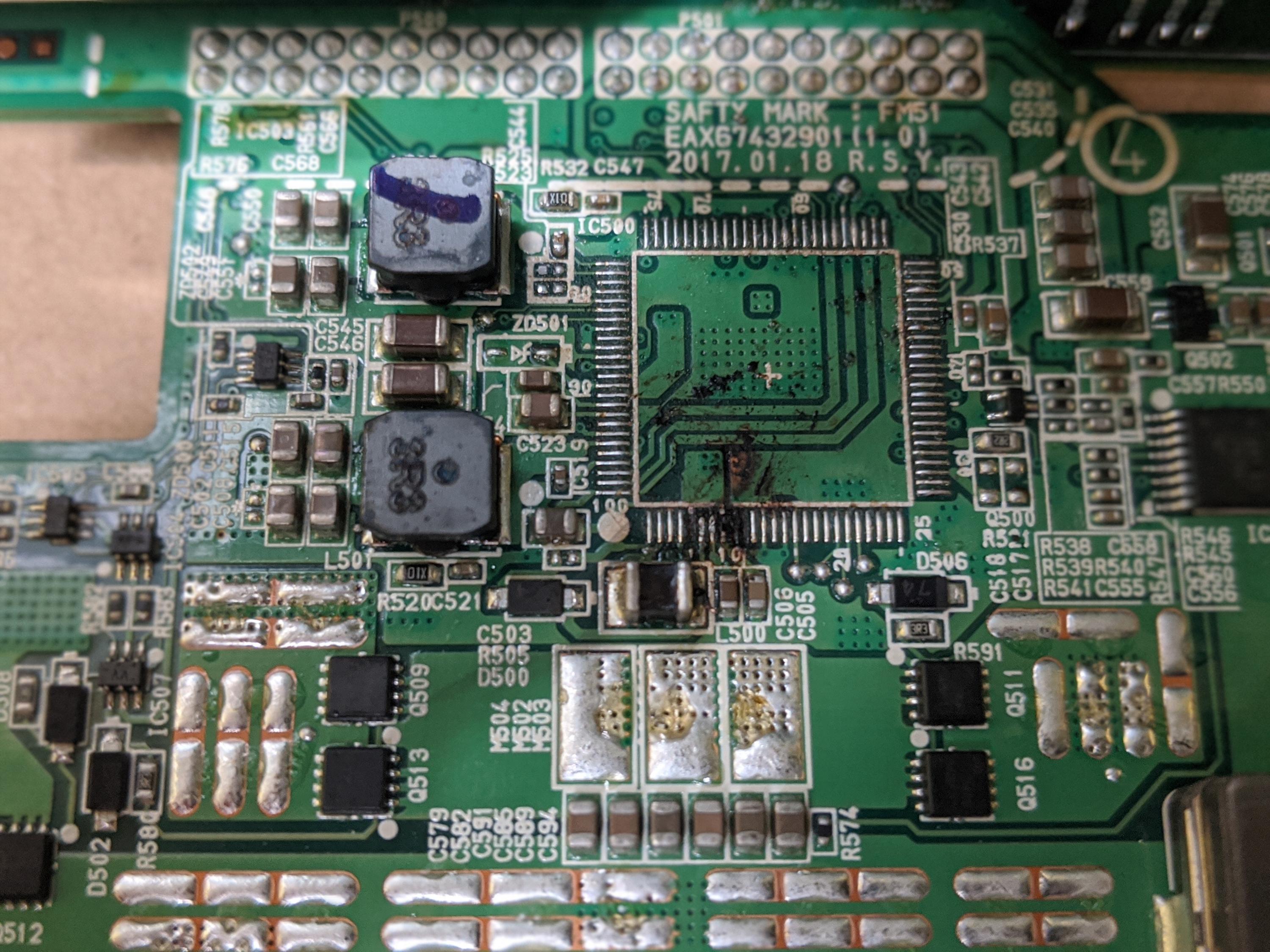

    Pin 9 and 10 are low mosfet switch for led. I am starting to suspect that the short is in one or more of the 4 mosfets.
    I will have to test them.

        Have you removed the faulty IC and checked what damage may have been done to the board and tracks. The IC itself is pretty cheap around £10
        • Cryogen
          • Jan 2015
          • 91
          • United Kingdom
          Re: Lg led projector burnt led driver
          yes I bought the chip but when I removed the burnt one I found out than the tracks are gone.
          I will have to check for someone who can repair burnt tracks. I don't have the tools to do so.
          Any idea?

            How bad is the damage. Post a sharp focused photo.
            • Cryogen
              • Jan 2015
              • 91
              • United Kingdom

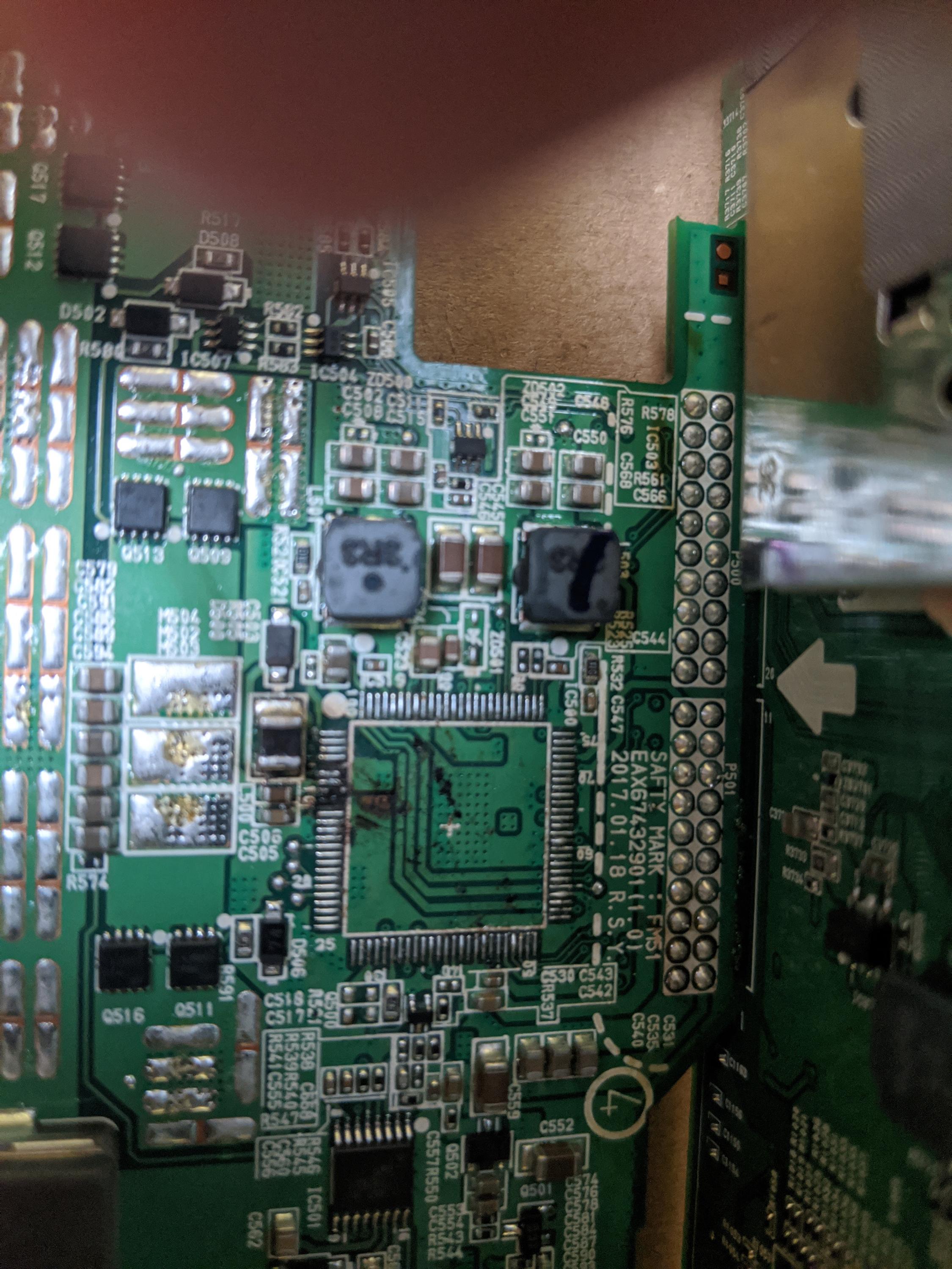

              Hope they are clear, I can't find the macro in my phone.

                the problem u have the area under the IC. need to take look under side which i think belong to pin 9
                pins 5,8,10 easy to jumper them

                  give it a good clean
                    You mean like the short is on the other side of the board?
                    Edit. Wait, you mean you think the short is on any of the 3 smd capacitors beneath the led drive? Yes I thought of doing a full recap anyway.

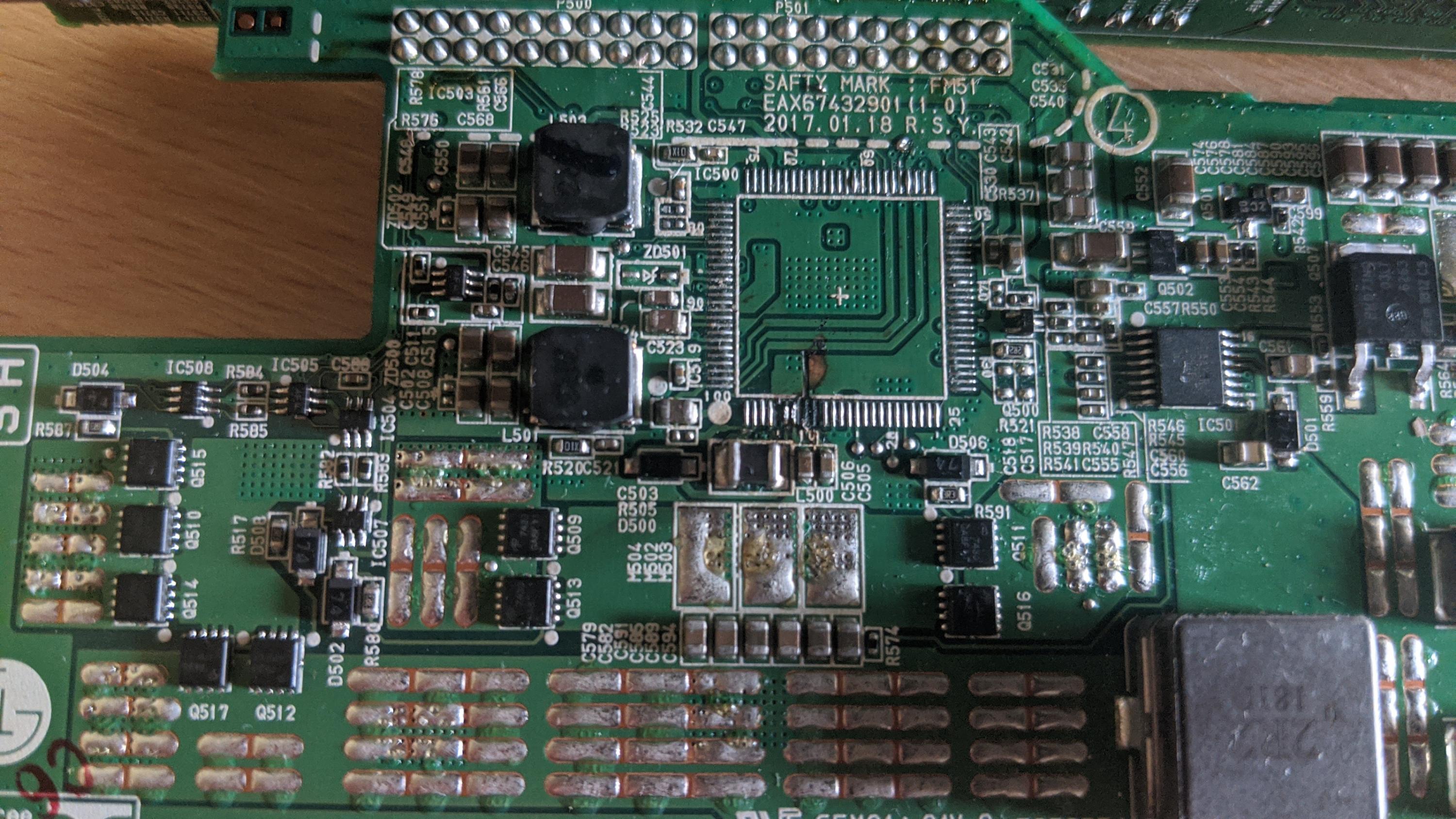

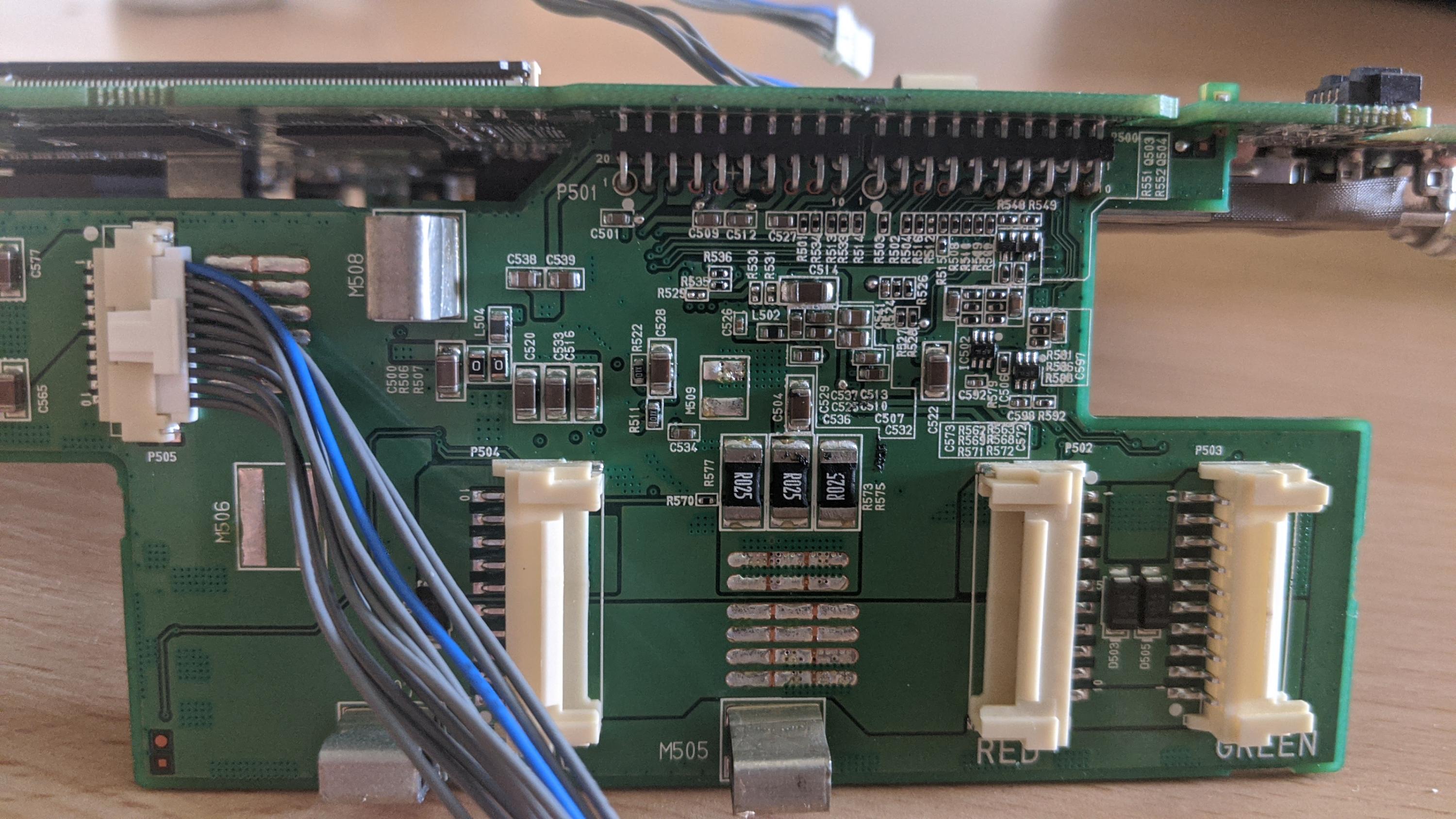

                        Here new pictures with board cleaned and other side of the led drive.

                              Pin 9 is probably on c504 on the back of the board?

                                i think so too, but before you go further.. apply 12 VDC to the LEDs see if they come on and there no one shorted or open.

                                        I was going to apply 5v on the led drive board and see if something overheats.
                                        I need to know if pin 9 is the c504 thought.
                                        I don't wanna jumper and then short the chip again.
                                        I only have a 12v 3A power supply, that doesn't look like low currents.
