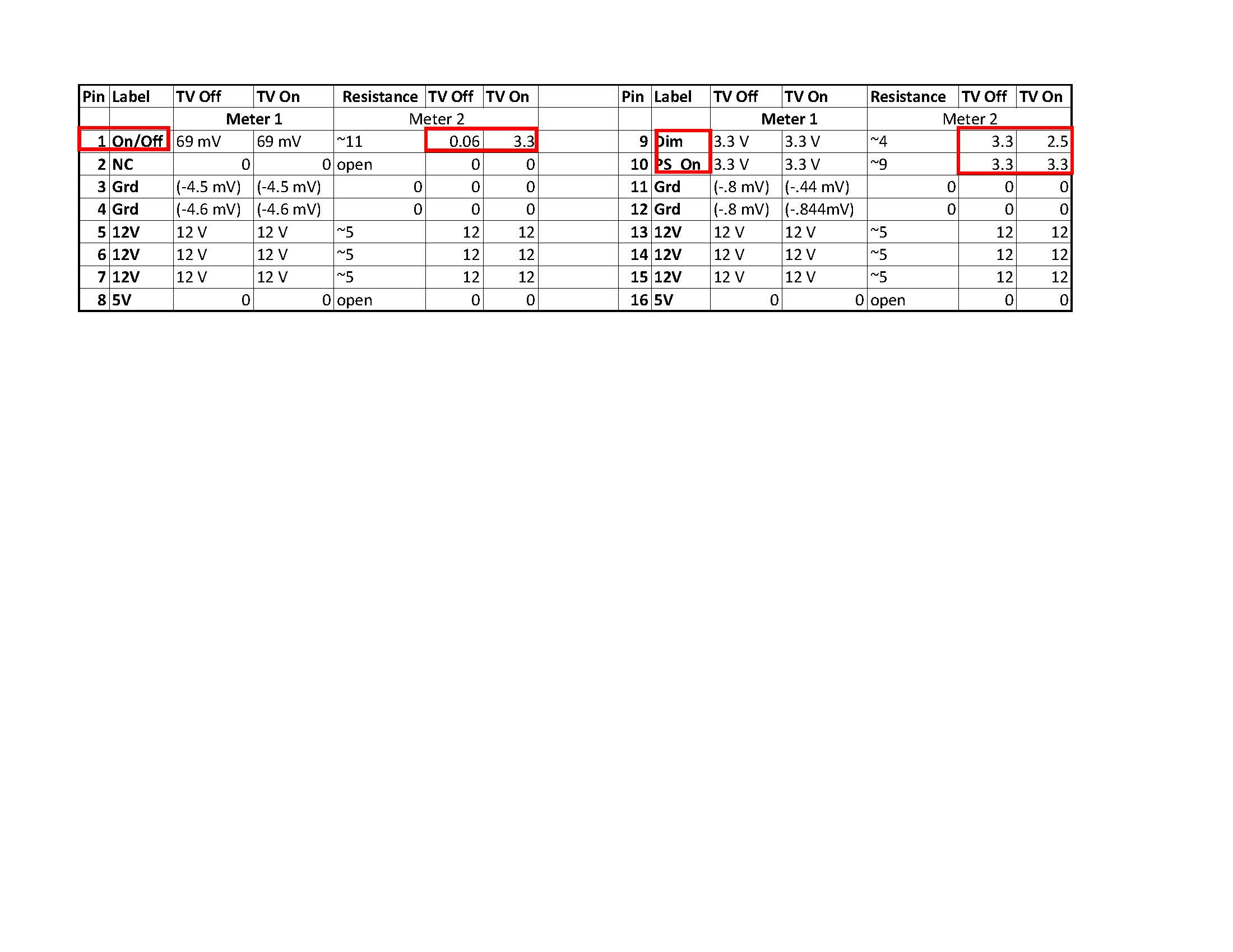

    Below are the readings from the power supply:
    Pin Label TV Off TV On Pin Label TV Off TV On
    1 On/Off 69 mV 69 mV 9 Dim 3.3 V 3.3 V
    2 NC 0 0 10 PS_On 3.3 V 3.3 V
    3 Grd (-4.5 mV) (-4.5 mV) 11 Grd (-.8 mV) (-.44 mV)
    4 Grd (-4.6 mV) (-4.6 mV) 12 Grd (-.8 mV) (-.844mV)
    5 12V 12 V 12 V 13 12V 12 V 12 V
    6 12V 12 V 12 V 14 12V 12 V 12 V
    7 12V 12 V 12 V 15 12V 12 V 12 V
    8 5V 0 0 16 5V 0 0
    I don't understand the readings as I would expect different readings with power off (i.e., plugged in, but switch off) vs. power on (switched on). Though from above there is no 5V reading. Does this seem to make sense to anyone?

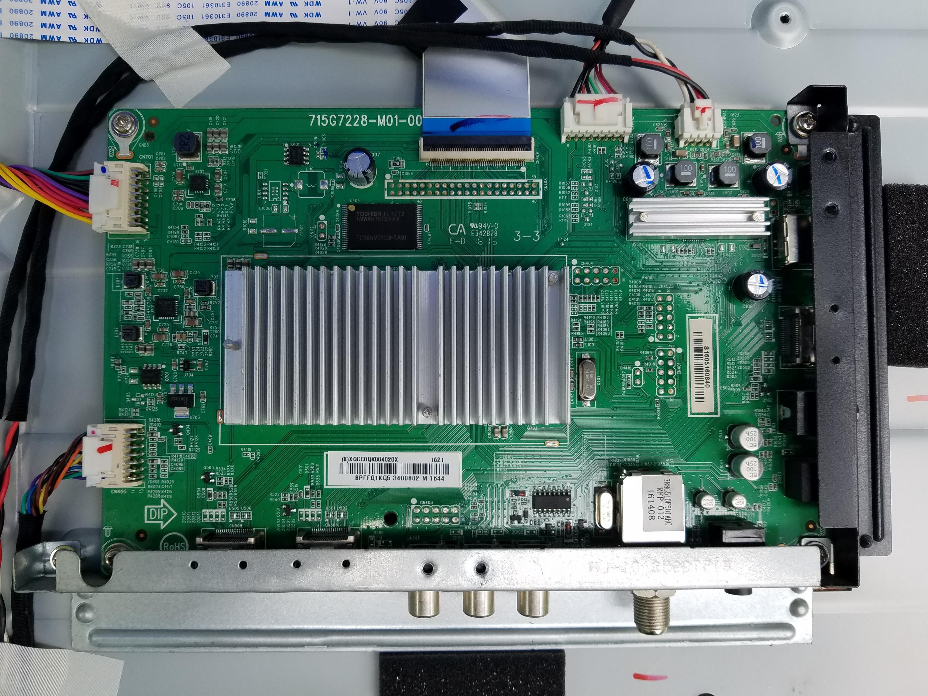

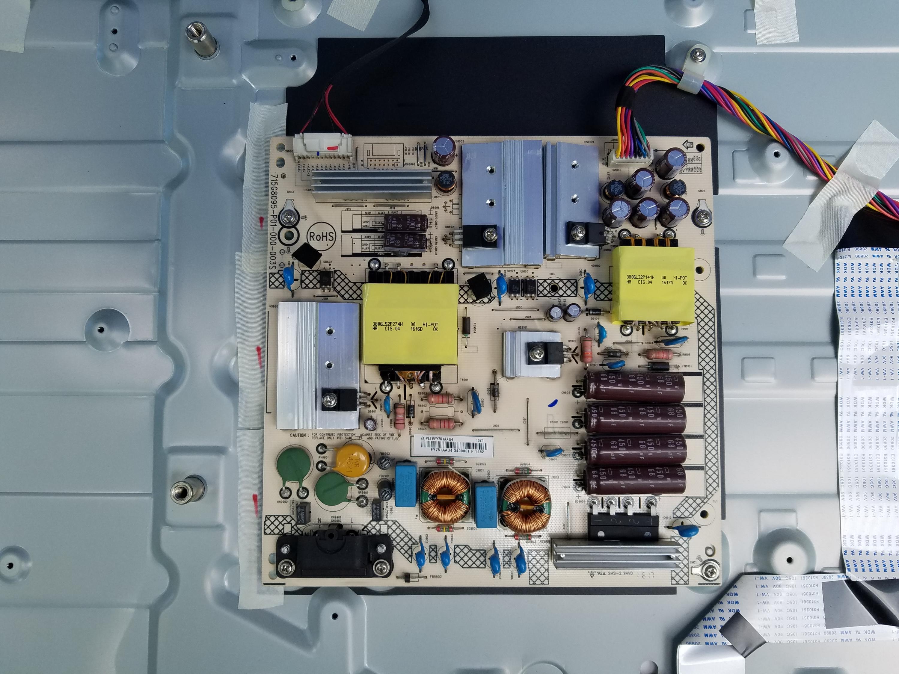

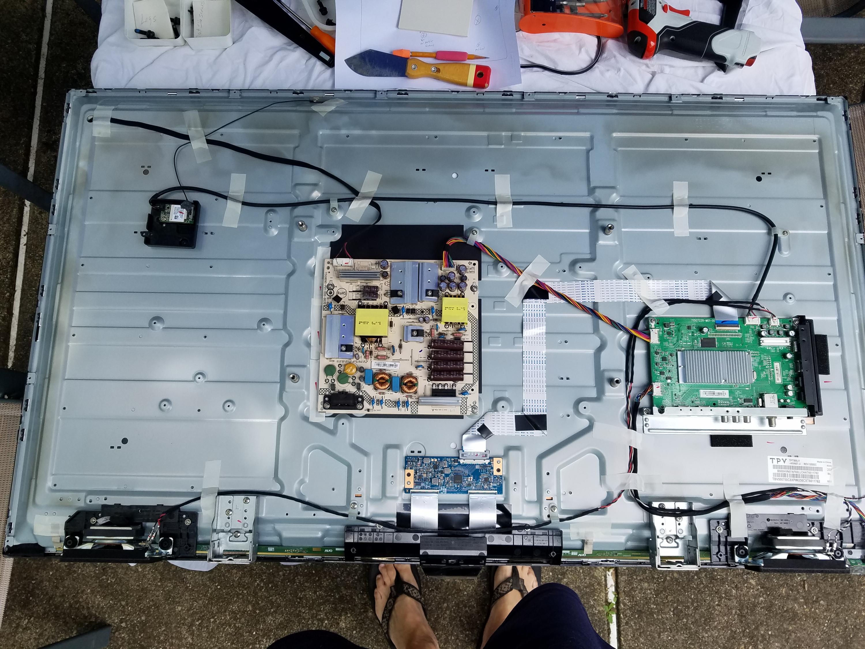

      Lets see the pictures of the whole backside of the TV showing all the boards.
      It is correct that the ON/FF (BL-ON) is not present to turn on the backlights circuit.

        If you look at the bottom of the board you will see no connection for +5V. Check the voltage on CN8601, pin1,2,11 or 12. Then check the voltage on pins 3~6 and 7~10. Check these led voltages as the tv is turned on.
        The voltage you checked on cn9102 can't be correct if the tv turns on. (audio and video with external light) I suspect open led in the panel.

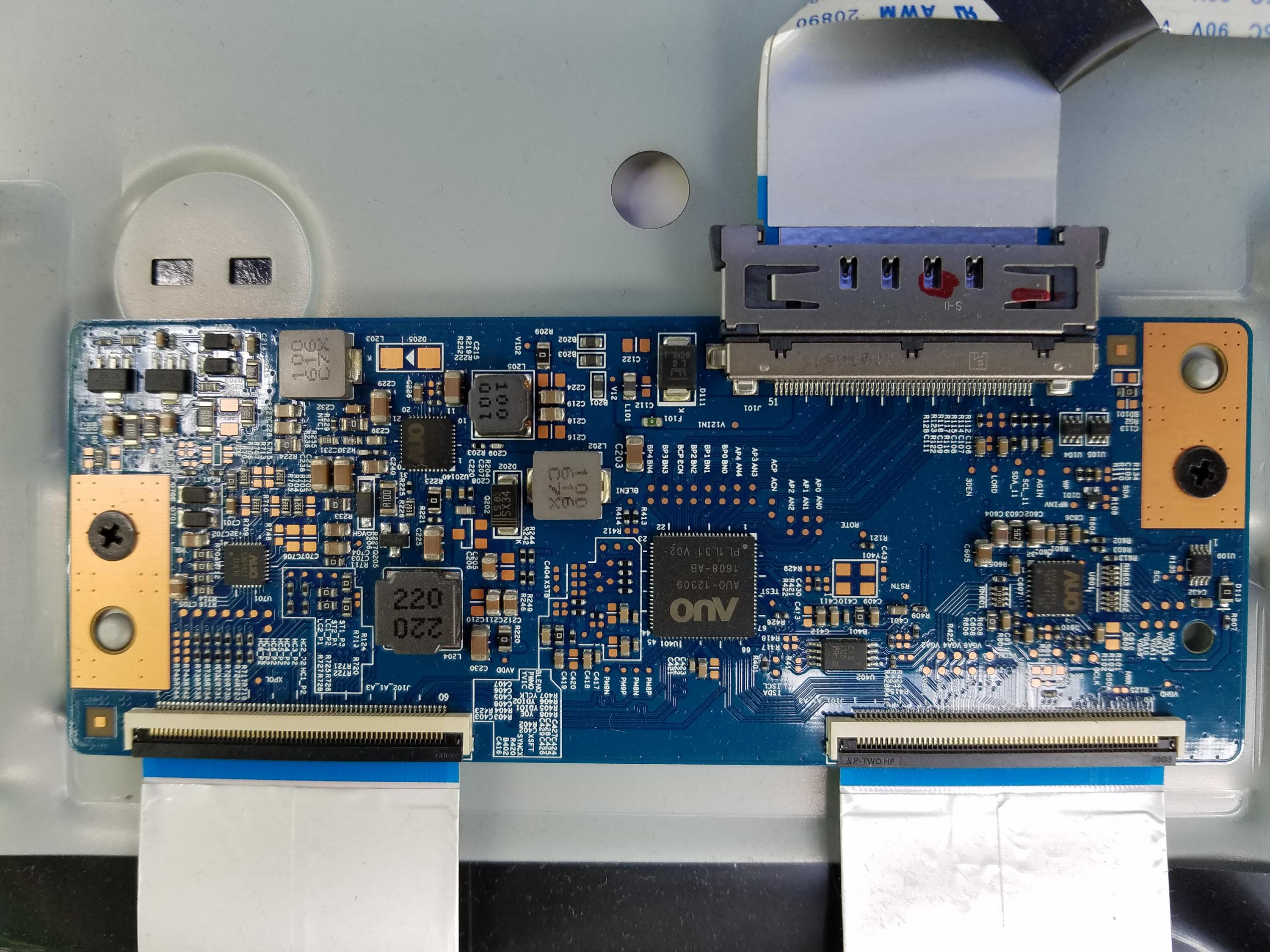

              Re: Sharp LC-50LB481U Backlight problem
              Here are some pictures.

                      I redid the CN9102 readings with a different meter, attached pdf shows the results. Pretty much the same except DIM goes from 3.3 to 2.5 V. As i understand it, PS On should change voltage when the power button is pressed, yet it doesn't. However, the TV seems to work fine except no visible picture.
                      I am also assuming that the "picture" I can see with a flashlight is what is seen on the screen when the backlight is lite. Is this correct?
                      To what does pin one "On/Off" refer? What does Pin 9 "DIM" do? Beyond this the 12 V seems active and the 5V isn't; however, I would have expected that the 12V wouldn't become active until the power button is pressed. What am i missing here?
                      On CN8601 there are only four connections; 1 & 12 are red (presumed positive) and 4 & 9 are black (presumed negative). Are these the power to the LEDs? There is no voltage shown between 9 & 12 and 1.5V between 1 & 3.
                      As far as jumpering PS On/ & On/Off with 5V, i haven't done this yet and will look to see if I have a 1K resistor. If I don't is there something else that will work? What is the purpose of this? Does the 5V run the LEDs and therefore I am trying to get 3.3 V into the 5V circuit to see if the lights power up?
                        ON/OFF = BL-ON = Backlights ON/OFF control.
                        DIM = Dimming control, it can be Analog Dimming or PWM Dimming control.
                                https://www.shopjimmy.com/sharp-pltv...-50lb481u.htm#
                                If you look closely at your board, you will see that the 5V pins are not connected to any circuit on your power supply/LED driver board, this is power supply is supplying only 12V to the main board, no 5V, so you should use 680K (Based on the schematic of the power supply) resistor between 12V & PS-ON, then you need to make Voltage divider to produce about 3V output based on 12V for ON/OFF pin. If the backlights do not come on then you may need Voltage divider to provide about 5VDC to the Dim pin, the test is done with no cable to the main board connected. It will be easier using 3-AA battery pack and 1K resistors to provide the needed control Voltages instead of using 12V as the source, if you look at the schematic you will understand why.
                                Using 2k resistor will limit shorted circuit current to only 6mA so you cannot damage the 12V power supply if accidentally short the lead to ground, resistor is not being use as fuse.
                                The above test is for testing the power supply board without main board connected, but based on your PDF, you do have all the correct control Voltages when using Meter 2. What is the difference between meter 1 and meter 2? Different brand?
                                But since per you readings which indicated that you do have correct control Voltages, then I would check the Voltages on the LED connector to see what you have, do this with all cables back in place.
