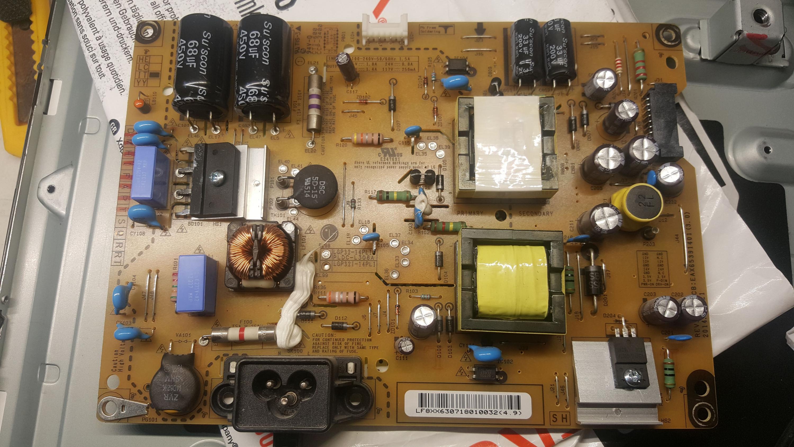

    I have a TV that suddenly stopped showing pictures. After searching in the internet, i find that could be the LED tapes. I opened the TV and it really had a burnt and scorched tape led ... i replaces them all.
    When I connected everything is the same.
    Can you help me?
    I attach the photos and measurements on and off.

    You are missing a signal from the mainboard to turn the leds on. DRV_On should be approximately 3.5V
    Disconnect the mainboard from the power supply and connect a 1K resistor from 3.5V to PWR_On and a second 1K resistor from 3.5V to DRV_ON

          Hello, i make what you said and the led poweer on, then i disconnectt the led and check 142vdc in led connector.

            So the backlight works when you tested using the resistors, yes?

              Re: Lg 32lb5700 no power on led
              Yes
                It looks like you have a mainboard problem not providing the signal and your leds are OK.
                Can you follow the DRV_ON pin on the mainboard and see if it connects to a transistor/mosfet.

                    After search i find that c701 is missing, there is olny the place with solder.
                    I attatch picure with the pin DRV_ON and the component that is missing.
                    And i don't know what is...i search the board but i can't find the manual..eax65610905

                      Why would the smd capacitor C701 be missing? It does look as though it is. Was this TV working for you or do you have it for repair? Has the mainboard been replaced or worked on?

                              That's definitely looks broken off, non filled pads have more rounded solder domes. I have an identical board here and have just pulled that capacitor, it's 10uf.
                                There's also an smd resistor in the photo I posted that I could not see on his original photo. Is it on your board and can you see its value.
                                  It's tiny and black which is why it doesn't look like it's there. It's in circuit with the two black devices either side of it, it sits lower than them so it's very unlikely it could be knocked off, unlike that cap.
                                    Yep, looks like it fell off or was removed, what's the tv history? another pic. there: https://www.ebay.com/itm/LG-32LB570V...-/273575219348
