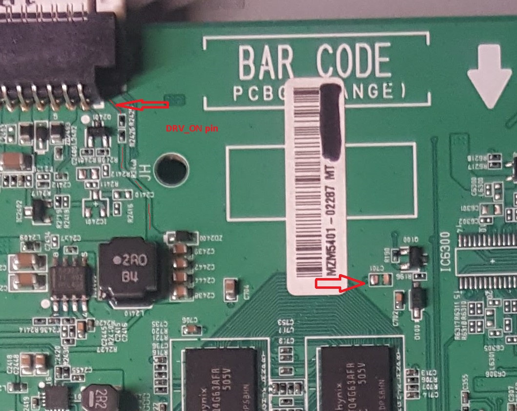

                    After search i find that c701 is missing, there is olny the place with solder.
                    I attatch picure with the pin DRV_ON and the component that is missing.
                    And i don't know what is...i search the board but i can't find the manual..eax65610905
                      Re: Lg 32lb5700 no power on led
                      Why would the smd capacitor C701 be missing? It does look as though it is. Was this TV working for you or do you have it for repair? Has the mainboard been replaced or worked on?

                            That's where a MLLC capacitor would go, see all the others, look around tho, maybe this setup did not require that cap, there are many more places on that board that don't have those caps in place, see them, just because there's a place for one does not mean it was needed in this particular setup/configuration.
                              That's definitely looks broken off, non filled pads have more rounded solder domes. I have an identical board here and have just pulled that capacitor, it's 10uf.

                                There's also an smd resistor in the photo I posted that I could not see on his original photo. Is it on your board and can you see its value.

                                  It's tiny and black which is why it doesn't look like it's there. It's in circuit with the two black devices either side of it, it sits lower than them so it's very unlikely it could be knocked off, unlike that cap.

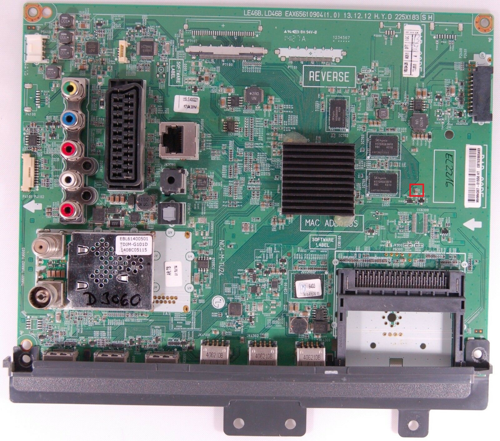

                                    Yep, looks like it fell off or was removed, what's the tv history? another pic. there: https://www.ebay.com/itm/LG-32LB570V...-/273575219348
