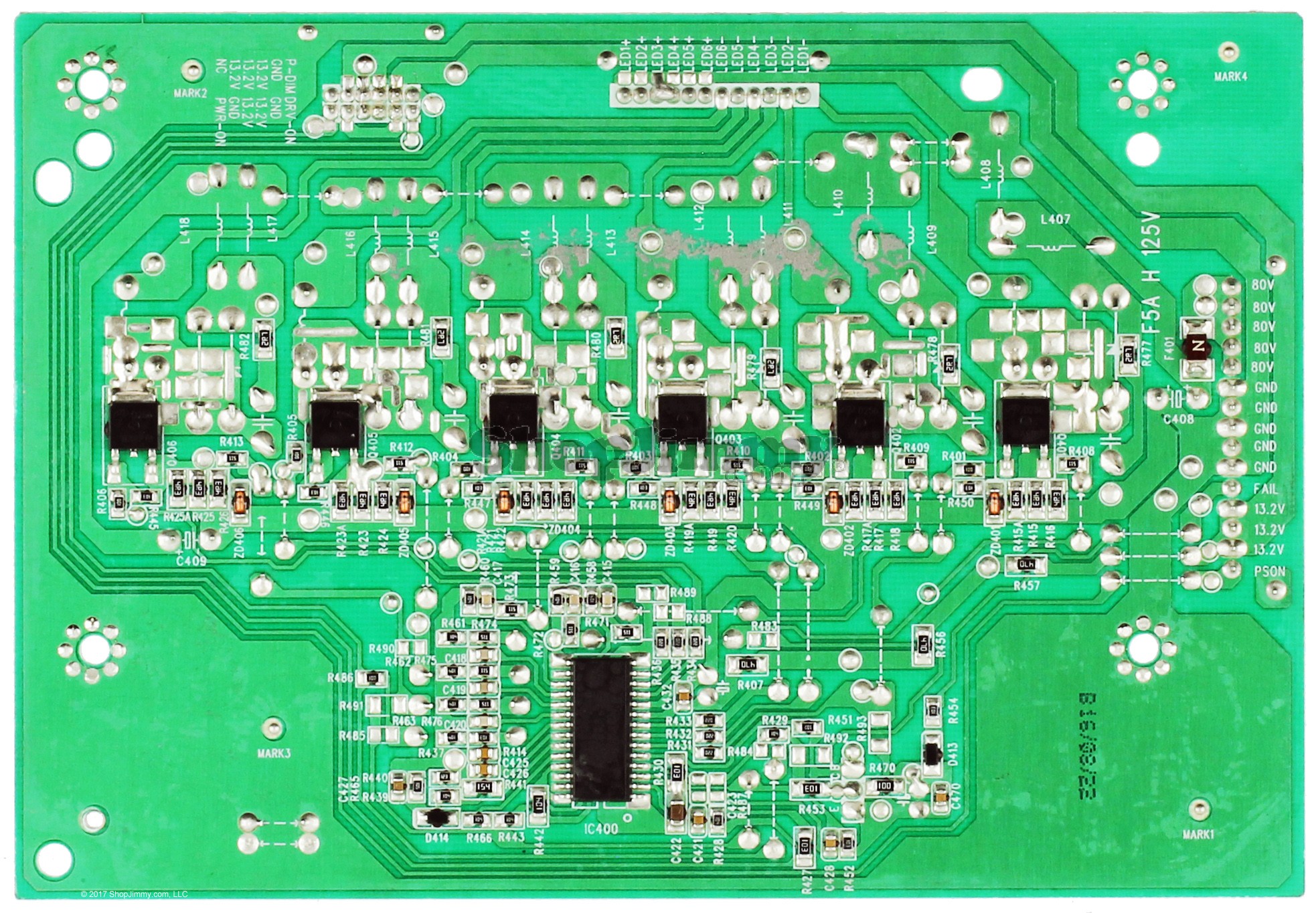

            • mmartell
              • Oct 2013
              • 3189
              Re: LG 65UH5500 flashes on and shuts right off
              So I looked up a photo of the board we're discussing and I can see now you're testing the voltages at CN401 when you should be testing them at the LED connector, CN403.
              Try again with connector plugged in. Red lead to LED1+, black lead to chassis ground and turn on tv. Note the voltage. Lather rinse repeat for all six positive pins.

                      • mmartell
                        • Oct 2013
                        • 3189
                        Remove the led driver board and on the backside remove ONE of the group of three 4.3ohm resistors at location R415a, R417a, R419a, R421a, R423a and R425a for a total of six resistors - one for each led string.
                        The current to the leds will be reduced by about 30% if I remember correctly. I did not notice much if any change in brightness as a result. YMMV.
                        Picture courtesy of Shopjimmy.
