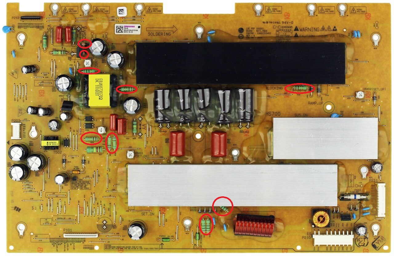

      Re: LG 50PJ350 plasma blowing Y-Sustain board
      I thought it was only one of the Y boards that was working properly.
      Since it is both of them, discard my previous reply.
      Never saw a bad panel do this, this is some board's doing.
      The Z-sus job is to light up the panel's brightness, it could be messing up the image.

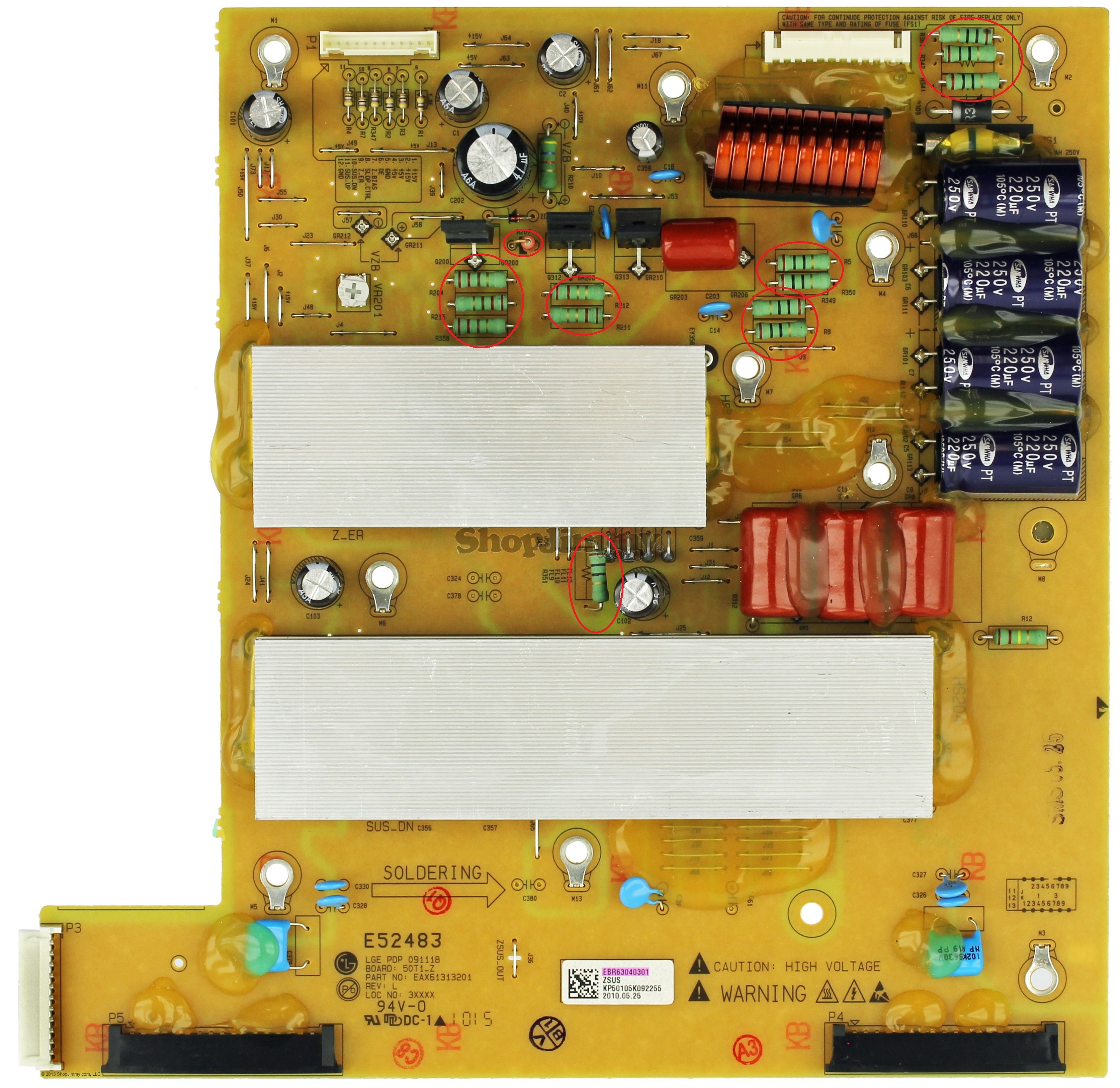

      On repair kits online they include a transformer, the big one on Y board, but if this transformer open any windings the Y-SUS does not work at all.
      Just to be sure, I'll send 2 images with the resistors circled. Also the fuses have to be good too, the big ones for VS, as well as those green and orange ones.
        Thanks much for the reply and pictures. I have gone through and measured all of those low value resistors and checked them a couple times. I don't remember if I previously mentioned this, but the 1st time through, I found open resistors in that group of 3 in the upper left corner of that 1st picture. One was at 22 ohms and the other 2 were wide open. I'm guessing something blew them out but that's the only obvious problem I could find. The diode in parallel with them measures good and so does the fuse. And BTW that Sus_Dn section of the Y_Sustain board gets warm in a short time even with the Z Sustain board unplugged from it. With the Z board unplugged I get really dim ghost like unintelligible images so it's at least somewhat working. And the Z bias test points read a perfect 95V, didn't even have to adjust it. The reason I'm suspecting the Z board is because I was reading online that a bad one can cause image to be slow to update. If I go into the menu and then back to the TV station, I can still see the menu on the screen for over a minute before it completely fades out. Also if I change channels, the writing and header from the previous channel will be visible for awhile. I don't have much experience with plasma TV's so I'm basing my assumptions on what I read online so please let me know if I'm wrong. I can get a used tested Z board on Ebay for only $27 and free shipping. For that cheap I'm thinking of giving it a try. What do you think? Thanks again.

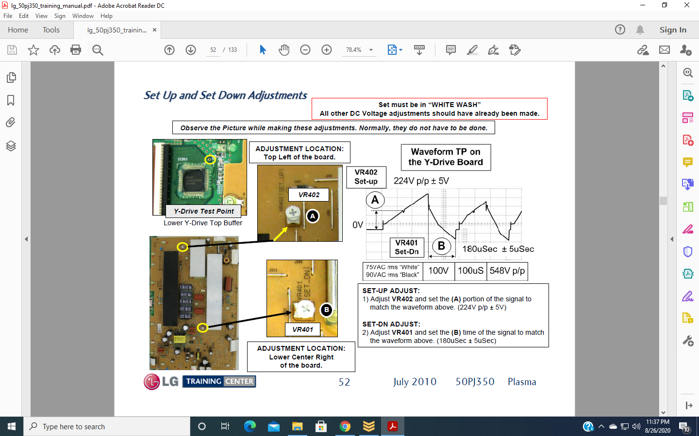

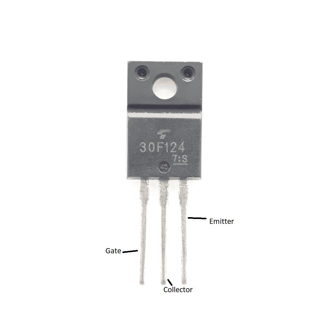

          First, try running the set without the Z-SUS plugged in, if the TV allows that (some LGs refuse to power on without it) you should see the image with a purple tint and very dim brightness, they screen may show black spots but with a fullscreen static input it will slowly fill out.
          The image I uploaded shows a Z-SUS board not working entirely, like powering up the TV only with Y-SUS and buffers.
          The SUS_DN part is linked to SET_DN trimpot, it generates a important part of the signal, as with SUS_UP/SET_UP, if it is abnormally hot in a short amount of time even on a black screen something is wrong, if SET_UP and SET_DN are incorrectly set, it causes image retention and some pixelation, but seeing your uploaded images there is also green and red pixels blobs on the screen.
          Also you said that in one board you replaced 30F124 IGBTs, are they original parts? Was that board the original Y-SUS that failed first?
          Those 2R2 resistors don't fail without also something else failing, they act as fuses, if you replaced nothing else on the Z-SUS some IGBT must be bad, following their traces on Z-SUS it leads to 2 IGBTs, and I've circled the others in the same heatsink just in case.

            OK to answer your question, yes the initial failure was on the Y-Sustain board. It had just about every IGBT shorted and I replaced them all with the same part numbers as the originals. After replacing them with original same parts, should there still be a need to adjust the Set_Up and Set_Down, or should they be fairly close? My scope went through a house fire in 06 and got damp and I haven't attempted to power it up since so I don't even know if it works. Also I don't know how to get an all white screen like they say to have in the training manual. Is that necessary or can I adjust those with a regular picture on screen?
            Besides the IGBT's, there were some open smd gate resistors on the bottom side of them. My original board also had a shorted gate driver IC, IC 70 smd on the bottom side too. The Vcc and ground were shorted together on the IC itself and when I missed it the 1st time, all my new parts went off like firecrackers. The spare board which I got free from a friend in the business also had 7 IGBT's shorted, some gate driver resistors open, and a couple of 1W 2.2 ohm resistors open. So both had similar failures and the original was a little worse.
            None of the IGBT's on the Z board are shorted but I guess it's possible they may have blown open. Being MosFets instead of standard transistors, I can't really test them with a meter so replacing them might be the only way to troubleshoot.
            And yes the TV does work with the harness to the Z-Sus board unplugged from the Y-Sus board and the image is as described, and that heat sink still gets hot even with the Z board disconnected. What did you want me to check for with it disconnected?
            And finally the resistors I mentioned that were open are actually on the upper right of your picture, upper left as the board sits when mounted in the TV. They're actually 20 ohms, not 2.2 so 3 in parallel is just under 7 ohms. I wonder if a power surge from the Y-Sustain board blowing took them out? I'm thinking I'd spend over $10 on replacement IGBT's for the Z board and have to wait awhile if they're in China plus the time to install them is why I'm considering the used complete board on EBay for $27 and it's only 1 state away from me so I should have it in days. I've been working on this off and on since late March/early April and this thread goes back 3 pages. I think a lot of what I just told you is posted there and maybe some other relevant information. I know it's not worth half the time and effort I have into it but it was a project while my work was closed for covid and I'm considering it an educational experience so I can have better luck next time someone wants me to fix a plasma. At this point, it's become a challenge to get it working even though it won't be profitable. I really appreciate you taking the time to help me.

              It's been a while since I've repaired LGs Y-SUS too, so I forgot some details, yes the resistors are 3x20 OHMs in parallel, correct, the others are 2.2OHMs and the red ones are 1 OHM.
              No need to adjust SET_UP/DN if the IGBTs are the same, but it doesn't hurt to try, if nothing gets better just put them at their original positions.
              At this point, my last suggestion before buying another Z-SUS would be to desolder all the Y-SUS and Z-SUS heatsinks with the diodes,MOSFETs and IGBTs and test them one by one with a multimeter to see if they are partially leaking, sometimes they fail but still have some kOHMs or greater resistance between source-drain or collector-emitter. A 50W soldering iron is recommended for this, since it's hard to melt the solder on those big pads.
              You can do it with a multimeter in the 6/20/60 MEGAOHMs scale, put the positive probe on the emitter, and the negative on the collector, should the IGBT have no gate charge, would read 1 megaOHM or greater, and if you swap positive/negative, it should be open, same goes for MOSFETs, diodes should read kiloOHMs forward(A>K) and open or way higher resistance when reverse(K>A). They have to be out of the board because otherwise you're measuring the gate drivers and other components resistance.

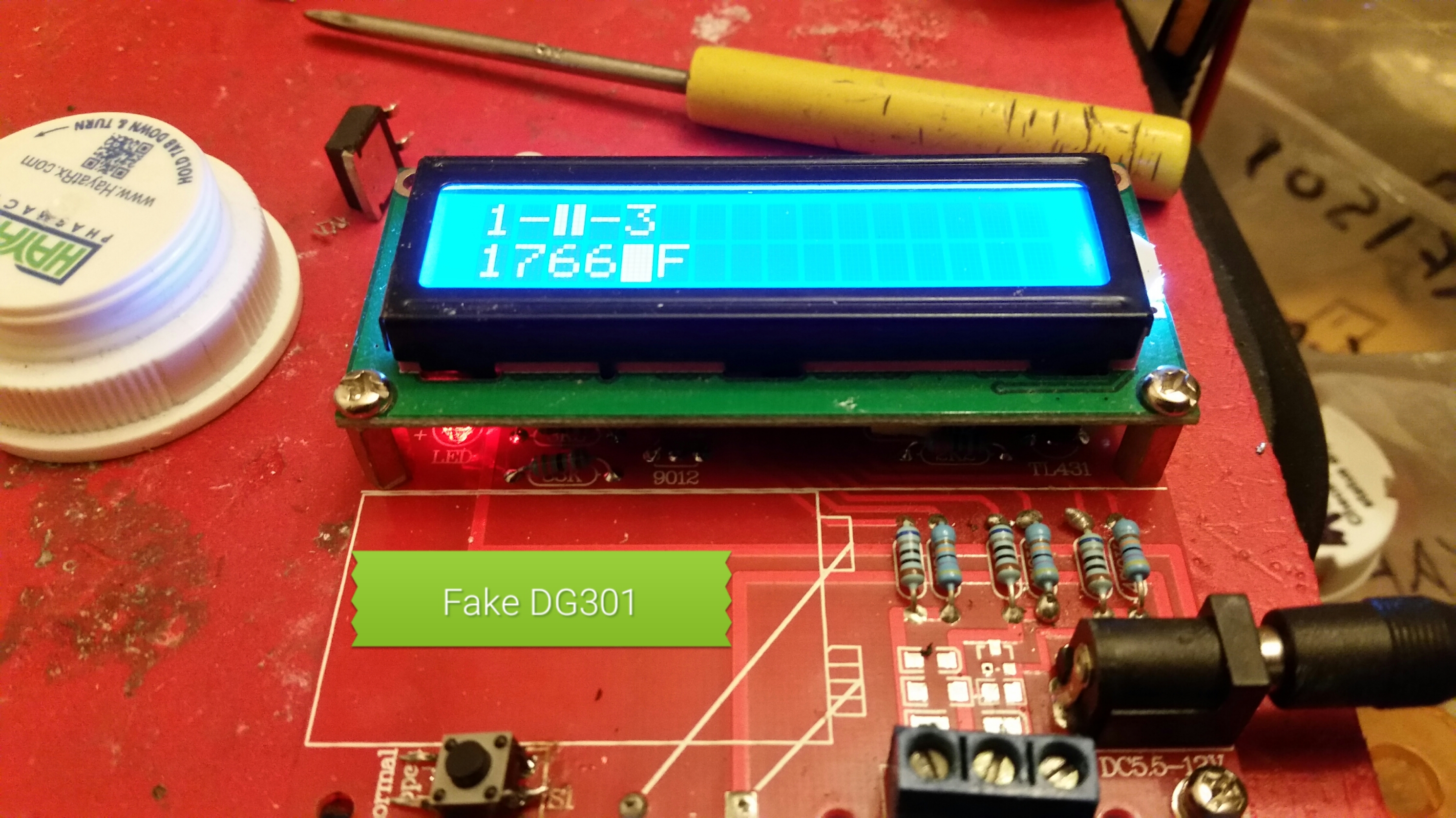

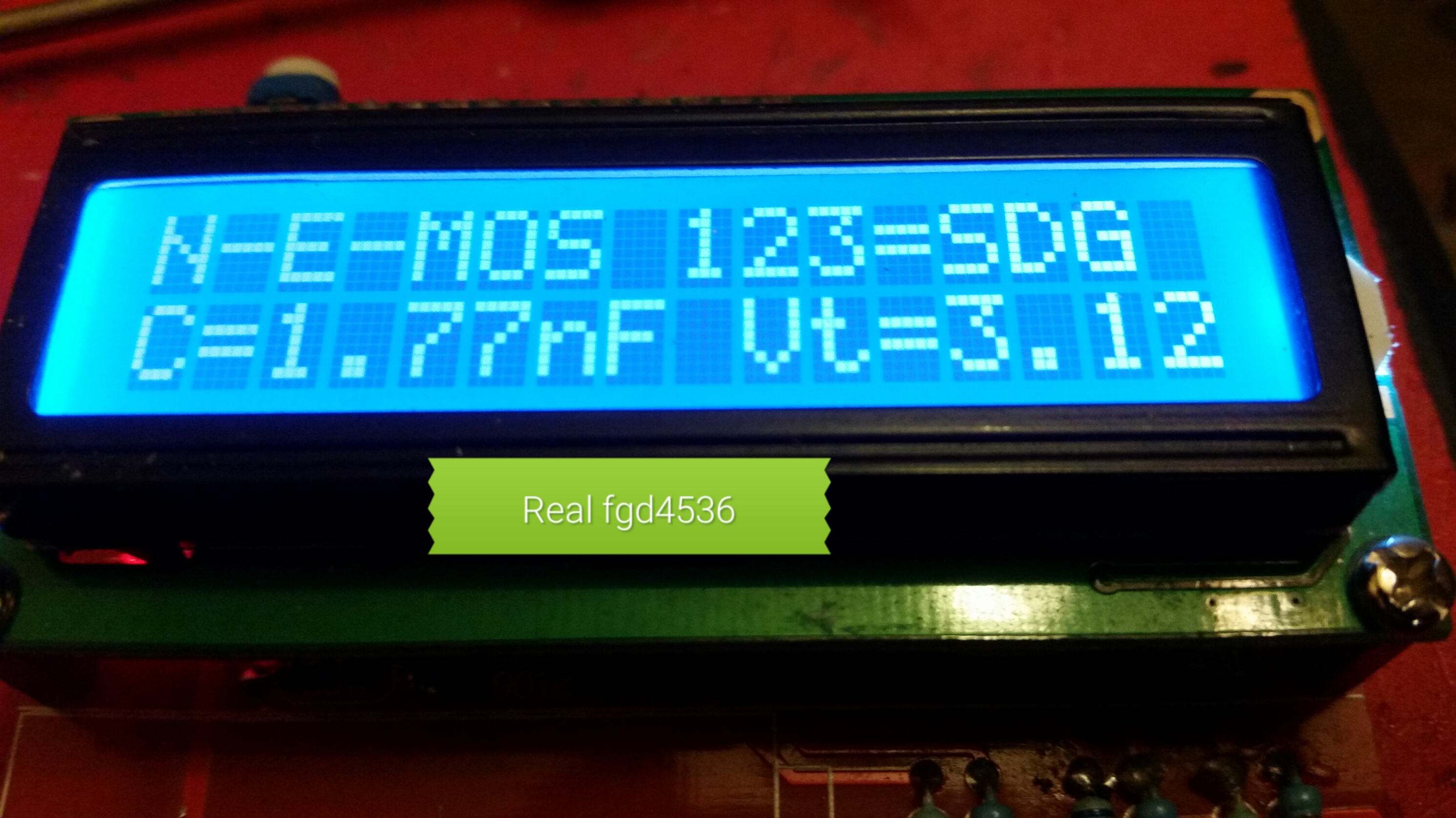

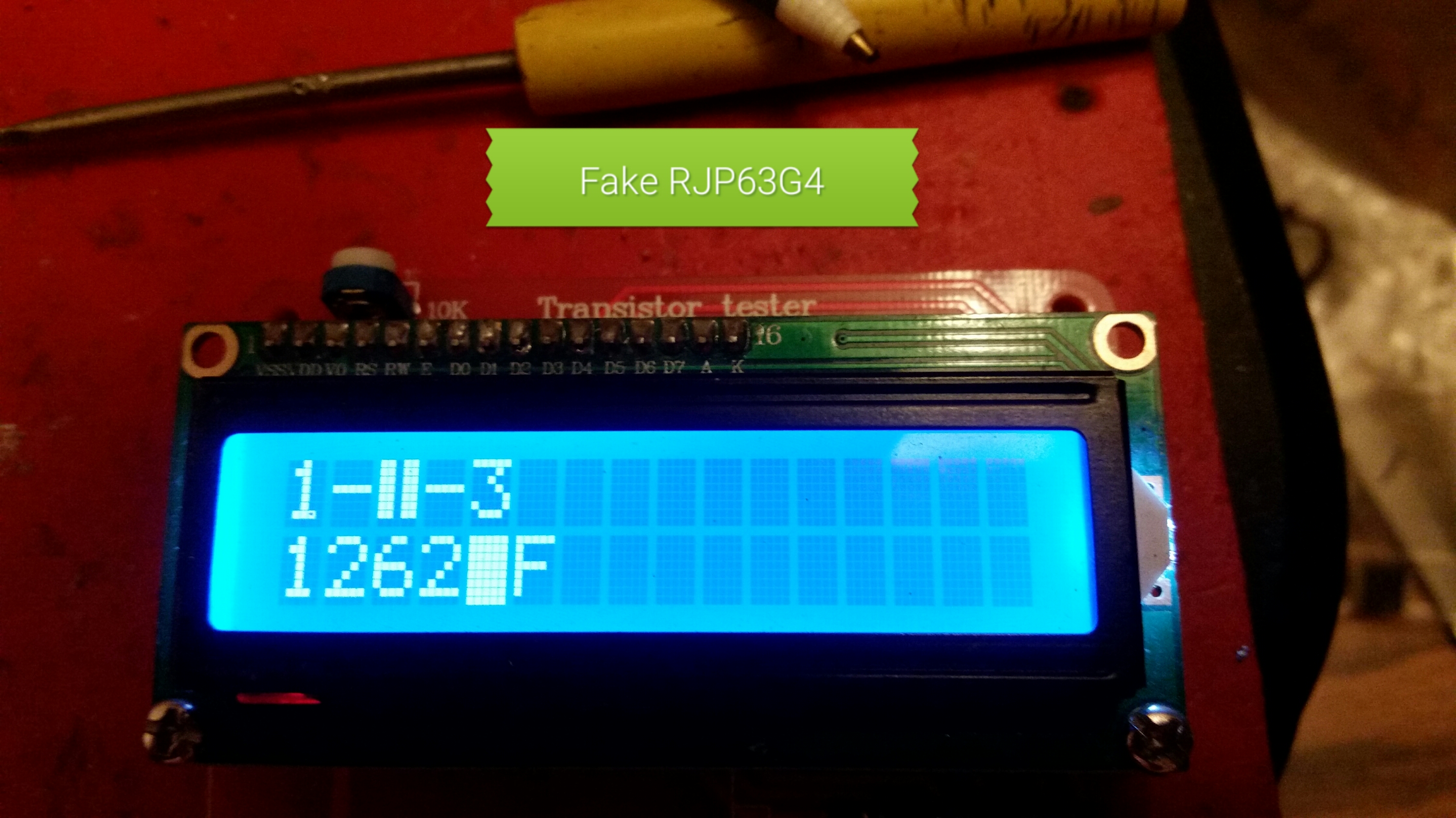

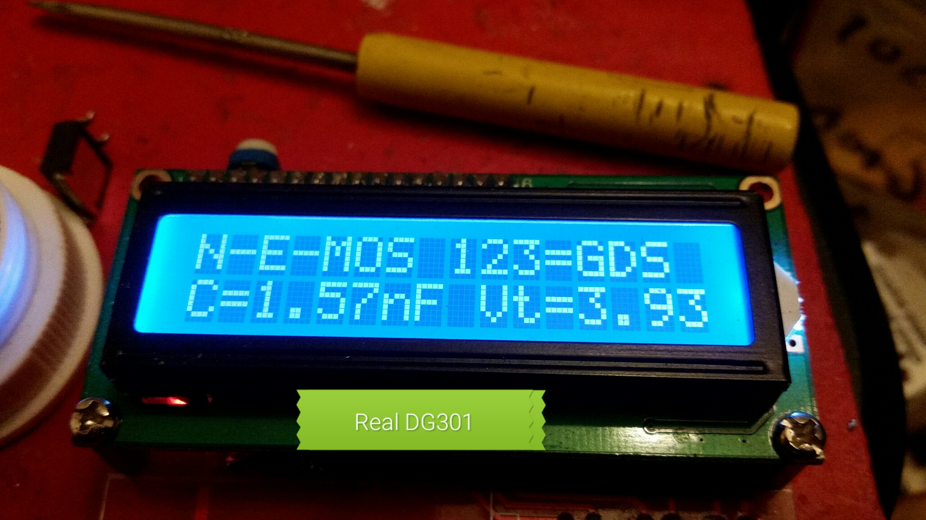

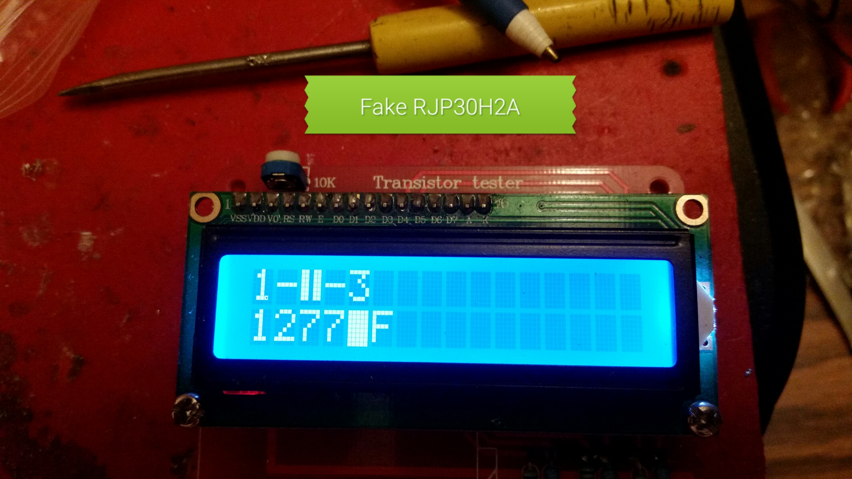

                  I have recieved LOTS of fake igbt's from China, Italy, and the UK. I bought a $15 transistor tester kit from Ebay, assembled it, and started checking things. The fakes only read as resistors. Check my pics.

                      I pulled all 5 30F124's out of the Z-Sustain board. I'm getting about 1.4 meg between the emitter and collector with the positive lead on the collector on all 5 but nothing in the diode scale between any combination of pins in any direction. Is this normal, and is there any way I can tell for sure if they're good or bad? Not sure if I should order replacements or just put them back in?

                        That looks good, but the resistance you're measuring is positive on the emitter, and negative on collector (middle pin), there's no other way a GCE IGBT can measure like that, compare those 1.4M OHM to the new ones you bought, they can't be far appart. Of course, use the same multimeter on the same scale.

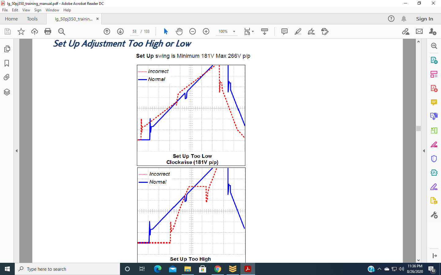

                            You can use the scope on the Z-SUS board to see if it's working properly, there's a metal jumper called ZSUS_OUT, you attach the scope there, on the buffers at every panel output IC some points are provided, they are pads filled with solder that extend out of the traces that go to the panel.
                            I don't think it's needed to use an oscilloscope on this TV, but I'll send this too, it's a really detailed training manual for a LG 50PQ30 plasma, which is different, so don't take it literally, I've only highlighted the waveform measuring part, the rest is not related to this TV, measuring the full Y-buffer signal requires a 800V pk/pk oscilloscope 100V/div, most have only 400V pk/pk 50V/div with 10x probes.

                                White wash means a full white input on the screen, no power saving options enabled, and also wait 15 minutes for the TV to heat up.
                                The panel is not the problem, the problem is poor sustaining, I bet on the 30F124 IGBTs that were replaced, you much probably have original 30F124s on the Z-SUS that you bought, try to replace the 30F124s in one of the Y-SUS boards.

                                    tvtimmy warned about fake IGBTs, you said you bought "original parts of the same model", but there's no way to know that without measuring and comparing them, I suspect they are fake, swap them with the ones on your spare Z-SUS board which should be original, unless someone replaced them already.

                                      Check them in diode mode. Check YouTube for igbt testing.
                                      I bought most of my fakes from US sellers. One clown asked if I knew what I was doing, I asked him if he owned a multimeter and to check them for himself . HE said no refunds, I think I told him to GFYS. Ebay took care of me though.

                                        I replaced 30F124's, A 2SK3667, some PFPF51N25's some RJP63F3A's and that IC. How do I know that one of the others isn't bad and not just the 30F124's? The seller for the 30F124 has a 99.9% positive feedback rating with only one negative in 12 months for an entirely different product out of over 1000 transactions. I should check the other sellers' ratings and see if there are any reports of bad/fake parts. If they all look good, I'm going to start with looking at that waveform on the scope before I go through the work of changing that board again. It has like 18 screws, all needed to make connections, and 2 ribbon cables that have the "force in" type connector with no release. They've been in and out so many times already I'm afraid of tearing a trace if I mess with them too much more. If I had fake/bad ones, would I even get a picture at all?

                                          Missed the part that you also bought some RJP63F3A, I've bought 15 of those on a local shop here and all of them were fake, looked totally different from the original part, exploded my y-sus board 4 times and never even powered up, got refunded though, they are rare to find genuine. The 51N25 is a regular mosfet, as the K3667, never saw someone try to fake those yet.
                                          Usually fake IGBTs work for some short time then fail, can't handle the pulse current, or the VCE breakdown voltage is not up to spec, or they have straight out crap inside them that can't even handle 30V VCE, immediately blowing up.

                                          Chech the board with the oscilloscope and try to adjust set_up/dn anyway, it should not damage anything.
