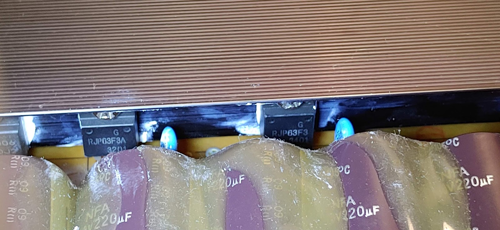

      Yes, this is a problem with either the RJP63F3 or the 30F124 transistors, or whatever drives them, I suggest desoldering all the heatsinks and testing each transitor and diode one by one to ensure you won't have to mess with them again, if you have an original RJP63F3 compare it against the ones you bought, and the Z-SUS 30F124s with yours.
      For last you can measure VSCAN and -VY with the oscilloscope to make sure they're flat lines and not noisy or oscillating.

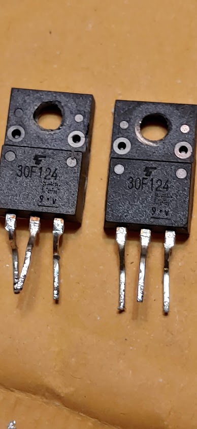

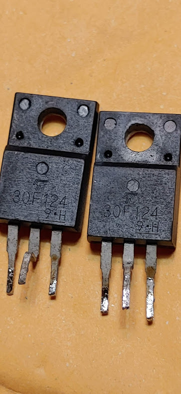

          @Biruslapio, good call, and many thanks! I was quite hesitant to do this at first because of the amount of work involved (18 screws just to hang the Y-Sustain board and they all have to be in, and 2 delicate ribbon cables that have been in and out way too many times already) and I honestly didn't believe I had bad IGBT's due to the 99.9% positive feedback rating of the sellers over thousands of transactions. But you obviously know a lot more about these things than I do and have a lot more experience. I was to the point of junking it so I thought what have I got to loose. What's one more evening compared to probably close to 100 hours I have into it.
          To make things a little easier, I had already pulled all the 30F124's out of my original Z-Sustain board thinking the problem was in that board. Then I bought that spare one just for process of elimination and it didn't fix the problem so I just left it in. 1st I swapped a pair of those originals from the spare board into that spare Y-Sustain board my friend gave me. Installed it into the TV and the picture is absolutely beautiful. Rich colors, no ghosting or speckling, and in the white wash mode I actually get a clean all-white screen with no blotches.
          But I wanted to make sure that it wasn't just a fluke, so I swapped another pair from the spare Z board into the original Y-Sustain board and the picture looks amazing with that one too. So I've proven with 2 different boards that the 30F124's I got from Ebay are bad or fake. Measuring Gate to Collector with the positive lead on the Gate, the Ebay ones measure 2.6-2.7 Meg Ohms, but the original LG ones from the spare Z board only measure 1.5 Meg Ohms. I've attached pictures of both for comparison if you want to see if they look fake. I noticed the originals have 2 indented dots, one on each end of the component body. But the Ebay ones only have a single one in the center. Lettering isn't quite as solid on the Ebay ones too.
          And funny thing is now that center heatsink with them installed doesn't even get warm. However the outside black heat sink closest to the buffer boards with the other replaced IGBT's (RJP63F3's) now gets quite warm (on both boards) and it didn't before. Wondering if that's normal now that the set is working properly or if it's possible those could be bad/fake as well? And finally I want to replace the 30F124's on that spare Z board and possibly try another set of RJP63F3's on the Y-Sustain boards to see if they run cooler, can you recommend a reliable source or tell me how to find one that has good/genuine/working components?
          Thanks again for all your help. 4 months and 4 pages of threat posts later, we finally got this one fixed!

              Glad to see that it worked, amazing, using the multimeter to measure Emitter to Collector resistance has saved me a lot with IGBTs.

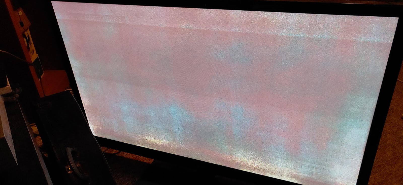

                  I'm also working on the same TV. Here are the symptoms https://photos.app.goo.gl/cgFEzQ5YE5vqzmdv9
                  I also happen to have two Y-SUS boards which I'm trying to repair
                  Both boards had Q22, Q24 and Q03 shorted. I now read through this thread and also discovered an open R503 on one of the boards.
                  Also, if I keep the TV on for more than a few seconds, it blows the FETs again.
                  Don't give up, I hope we can somehow work together through this and fix this plasma TV!

                                    I did check the buffer boards for continuity and it tested good, but as you can see the image on my tv is in the very bottom that makes me think it could be still something wrong with the lower buffer board. I had similar symptoms with another TV what had bad buffer IC.
                                    Is there a way to check if the panel is bad?
