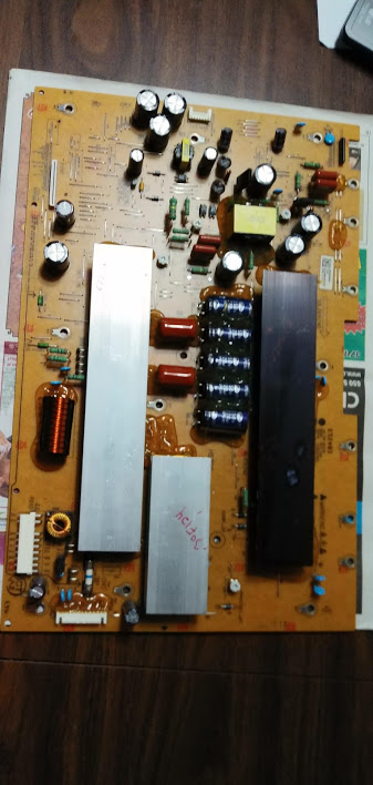

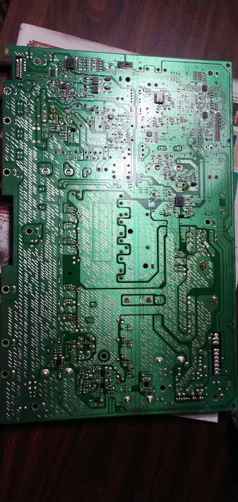

            Re: LG 50PJ350 plasma blowing Y-Sustain board
            Here are pictures of the front and back of the Y sustain board. Transistors that blew a 2nd time are still removed from the board. Also 1 pic of the entire TV with the board removed. My current cell phone has the worst camera I've ever had, just about everything comes out blurry. The Y sustain board is an EBR63039801 and there are some better pictures on Shop Jimmy's website.
              There has been some discussion regarding fake parts on sale which you may consider.
              I believe that when the Mosfets blow it can take down the driver IC's and gate resistors.
              I expect you have measured the resistance between Va & VS to ground.
              There's also the Ybuffer chips to test for which there are plenty of video's on Youtube showing methods.

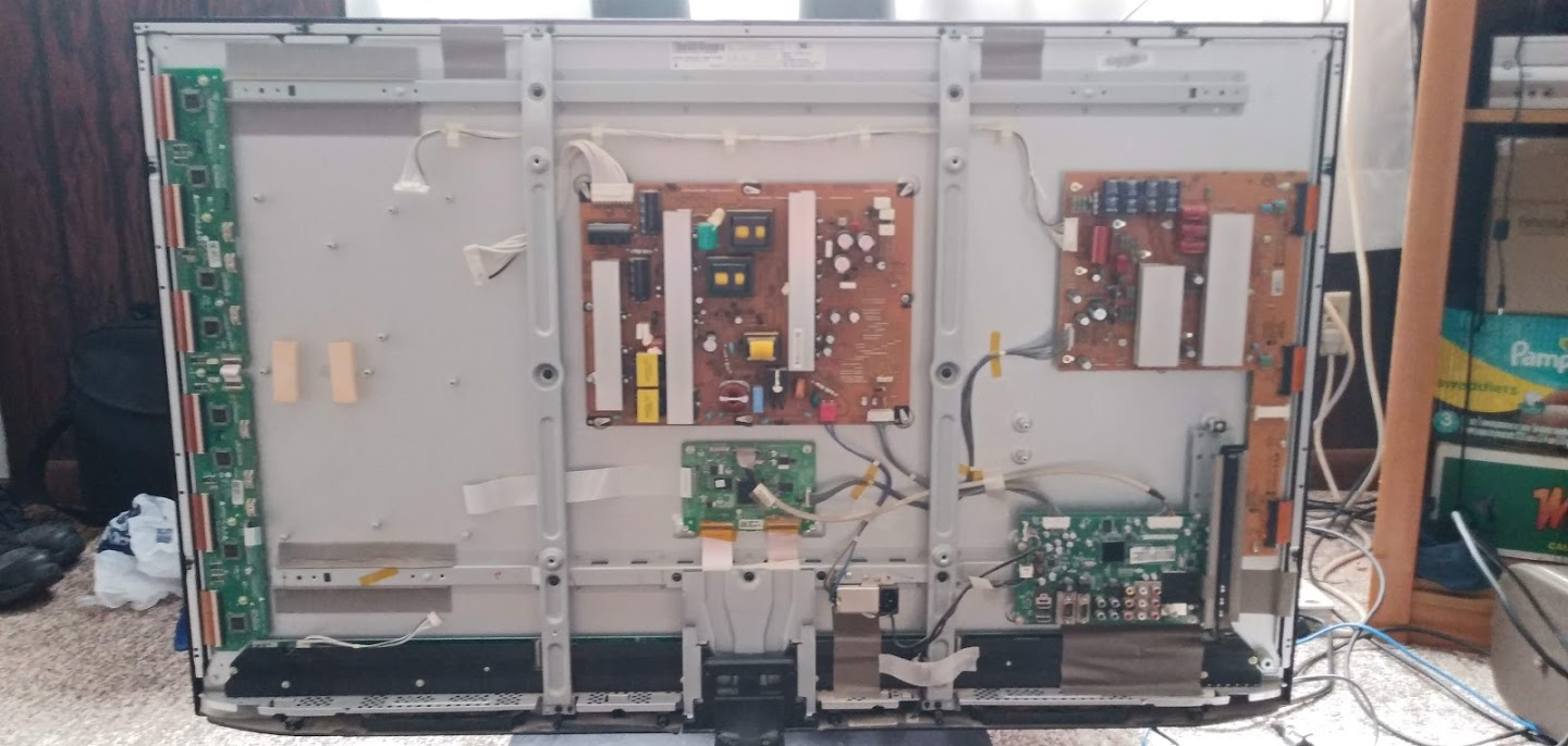

                  Can the Z board cause the Y board to blow? I couldn't find anything shorted on the buffer boards. I measured all the T0-220 mosfets for shorts without dismounting the board from the TV. Just wondering if I need to measure anything on the back side? Those ribbons look even more delicate than the ones on the Y board and I don't want to mess with them unless it's necessary. Also, can one open gate resistor on a mosfet on the Y board cause the whole thing to blow again? Every output has 2 10 ohms in parallel for an equivalent resistance of 5 ohms. One set measures 10 so one of the 2 resistors is open. I'm not sure if I missed it the first time around or if it opened up on the 2nd blow up. I have the Y-sus board all rebuilt but I'm afraid to power it up again and don't want to let it go until I'm sure I've fixed the problem. I'll be out of spare parts after this round.

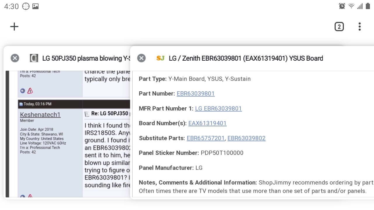

                              Ok I should have been more clear, the short is on the IC, stayed with the IC and went off the board when I removed the IC. It was like a couple ohms, I don't remember the exact reading.
                                According to shopjimmy you can use that board. Make sure you have every screw in place before plugging in the tv.
                                      I would like to ask for advice on something. I'm still struggling with this plasma. And the main thing that's holding me up is because I'm afraid of it. After it went off like a chain of firecrackers the first time, it sat a long time before I had enough nerve to try it again after the 2nd repair attempt to the Y-sustain board. As I mentioned above a couple months ago, I found an 8 pin gate driver IC on the Y sustain board that apparently gets damaged from the kick of the mosfets dead-shorting, location U70. On my original board, there was a Vcc to Ground short on the IC, and that same IC was quite discolored on the substitute board which also had several sorted transistors when I received it. So I ordered some from China and replaced it on both boards about 2 weeks ago, and finally powered it up with my original board last night. As soon as I plugged it in, it popped and threw a spark which scared the crap out of me again. However the screen lit up with the "no signal' message. It was a little dim and distorted, but the 1st time I've actually had video so I'm getting close. That pop and spark was a single mosfet in the section labeled "Sus_DN", location Q03, a 30F124. There's 2 mosfets in that section pretty much in parallel, Q02 being the other one, same part number. The cathodes and anodes are tied directly together and gates driven by the same source but with 5 ohms of resistors between the gates and the source on each one. (2 10 ohm smd resistors in parallel) Q03 blew apart, there's a big chunk out of it, and Q02 is fine. So I'm wondering if it could have just been a fluke or a bad one, or something else wrong that overloaded it like a bad panel or buffer. And this also may be relevant: One of the 2 gate driver resistors on Q03, the one that blew were open so the total resistance was 10 ohms instead of 5 and I caught it and replaced both prior to this last power up. They still measure good now after the transistor blew. I don't know how critical the tolerance is on these resistors and if the slight difference between the new and old ones could have attributed to the transistor blowing. Both sets measure 5.1 ohms identical including the lead resistance of my meter. I don't recall if I had replaced that transistor on my 2nd repair attempt or only the 4 on the dark heat sink so maybe it was even bad before I powered up?
                                      I want to try the 2nd board but just wondering if there is something I should check for before powering it up again? And does anyone happen to know what the Sus_Dn signal does? I tried looking it up online and couldn't find a clear answer. As far as I can tell, this was the only transistor that blew this time around and the other 8 that I replaced still measure good with an ohm meter where they previously dead shorted on power-up.
                                      Edit: I just figured out that I did not replace the 30F124's a 2nd time because I purchased a 6-pack of them. I used 2 in this board, 2 in the spare board, and I still have 2 left. (They were shorted when I first got the TV in and I replaced them once. 4 other transistors dead shorted on the first attempt, but not these so I left them) I should have replaced them given the open gate resistor and also because they are controlled directly by that gate driver IC. So there's a very good chance it could have been weakened and ready to blow. It also makes me wonder if I should replace that gate driver IC again in case it got and kick-back from that transistor that blew apart.
                                      And the other thing I wanted to ask is if anyone has any advice or ideas on how I can get over my fear of electricity? I'm an electronics tech with a degree and been working on this kind of stuff my whole life (35 years into my career) but anything that pops, sparks, etc is very traumatizing to me and I'd like to be able to get over it. Most of the time when I fix something with the potential to blow up in my face, I can't bring myself to power it up and usually have someone else do it for me. At work, I'll have the floor techs go test a power supply in a machine that I'm afraid to power up on the bench. And some of them have to be loaded to regulate properly anyway. But working on scary plasma TV's at home I have no one else to power it up and I've probably wasted a couple months already just by procrastinating powering it up when I get to the point of having to test it. And the fact that it's blown on me 3 times already doesn't make it any easier. Does anyone else struggle with this fear? And if yes, what have you done to overcome it? This is very real and serious for me so I would appreciate everyone being respectful and not laughing at me or making jokes. I'm pretty sure I have some PTSD from a traumatic event that happened earlier in my life. Thanks
