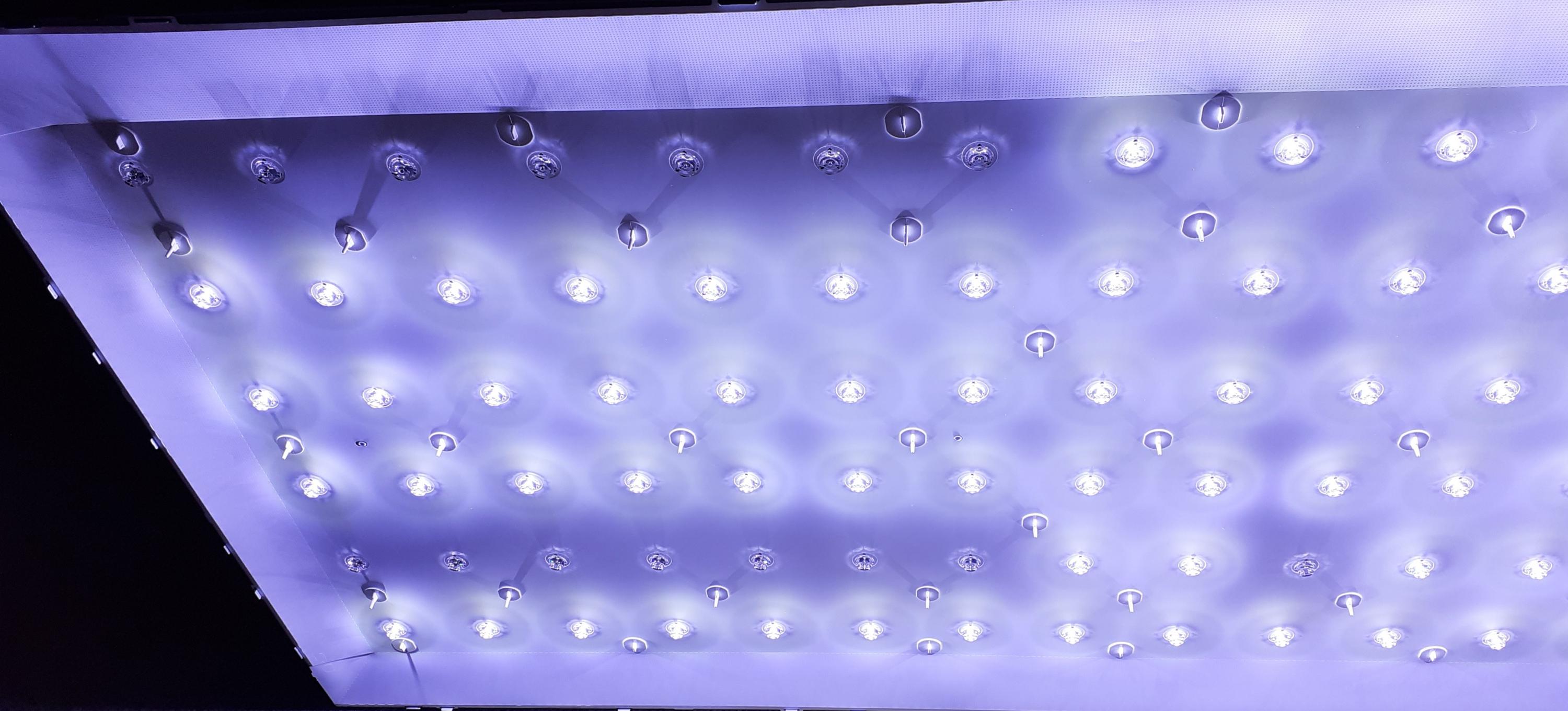

    Unplugging the LED's meant the tv startet up just fine.
    Some quick measurements with the multimeter showed that the voltages send to the LEDs were correct. So probably LED fault

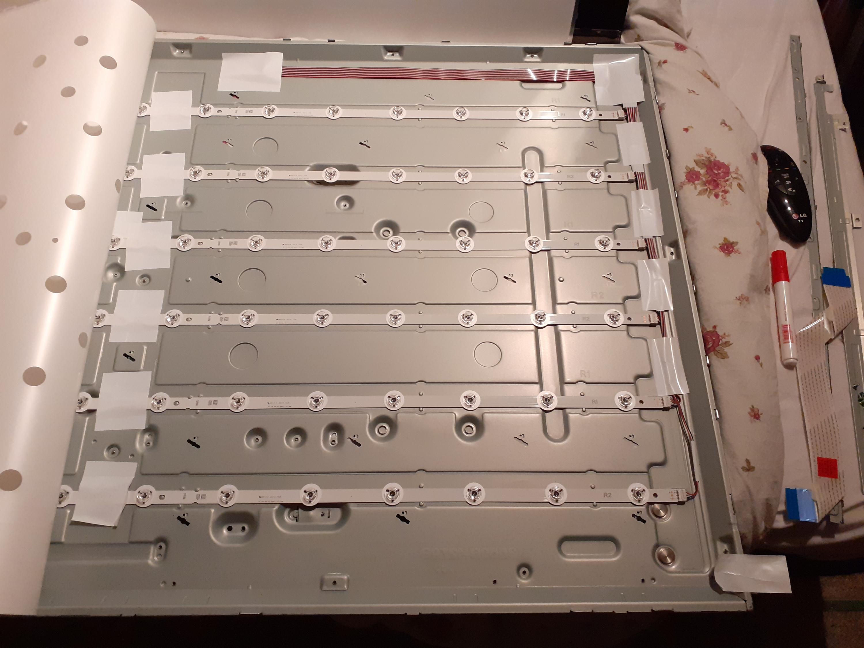

    I try and wait woth removing the panel for as long as possible. Especially with these 55" tvs theres always a risk of damage, but this time it seemed necessary.

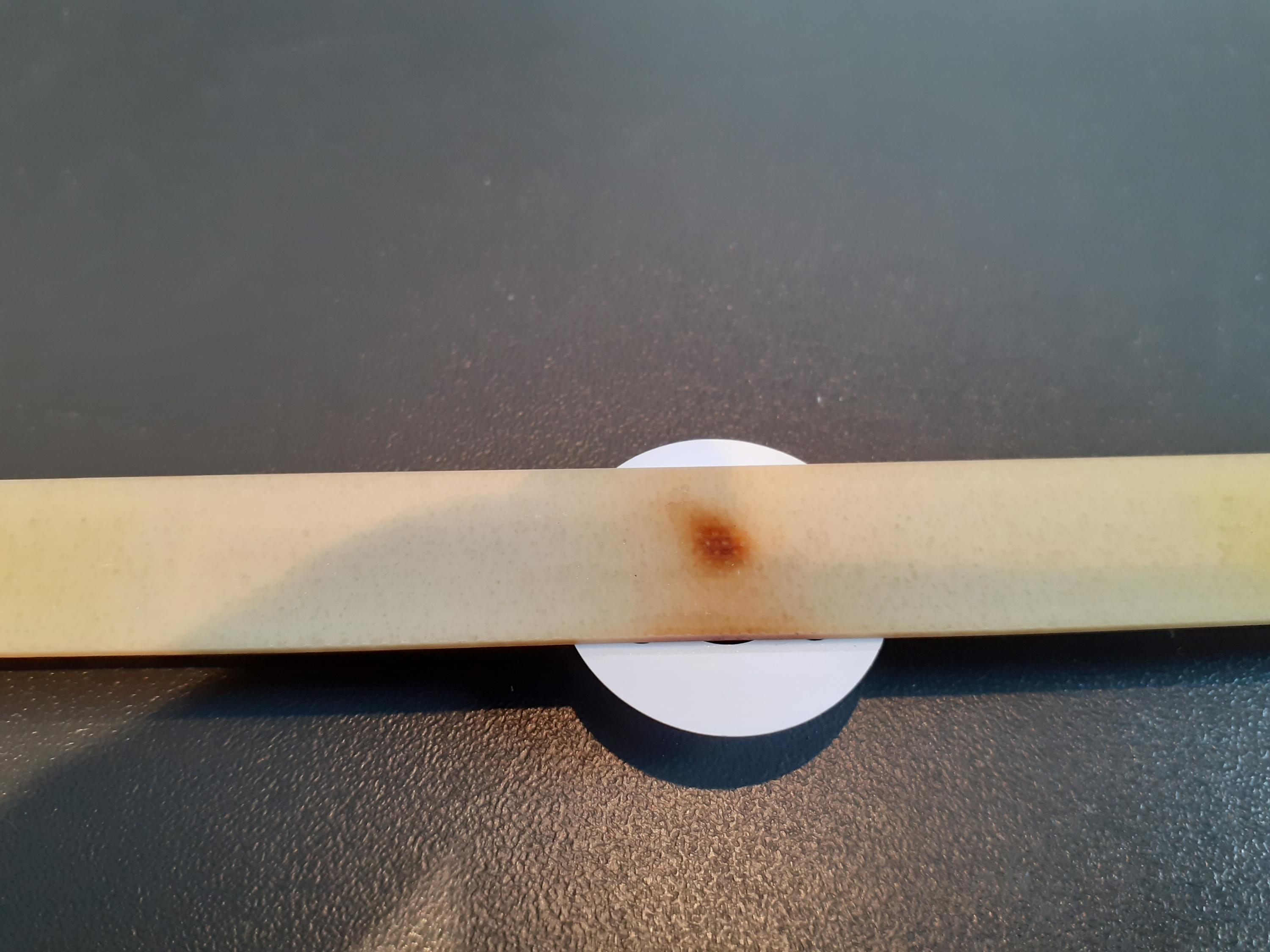

    I removed panel and sheets and turned on the leds again and found my fault.

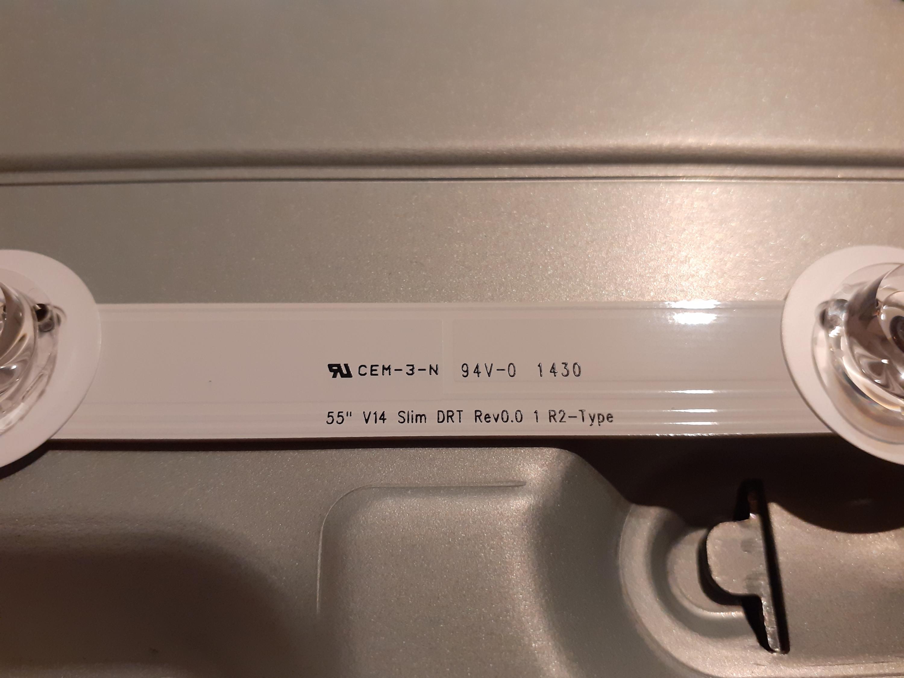

    Though it is possible to replace a single LED I always replace all the LED strips.
    After replacing all the LED's the tv now works perfectly.

      Good repair, it looks like another over driven of the LED's and caused the failure. Make sure to turn down the backlights level on all inputs as low as possible to extend the LED's life.
