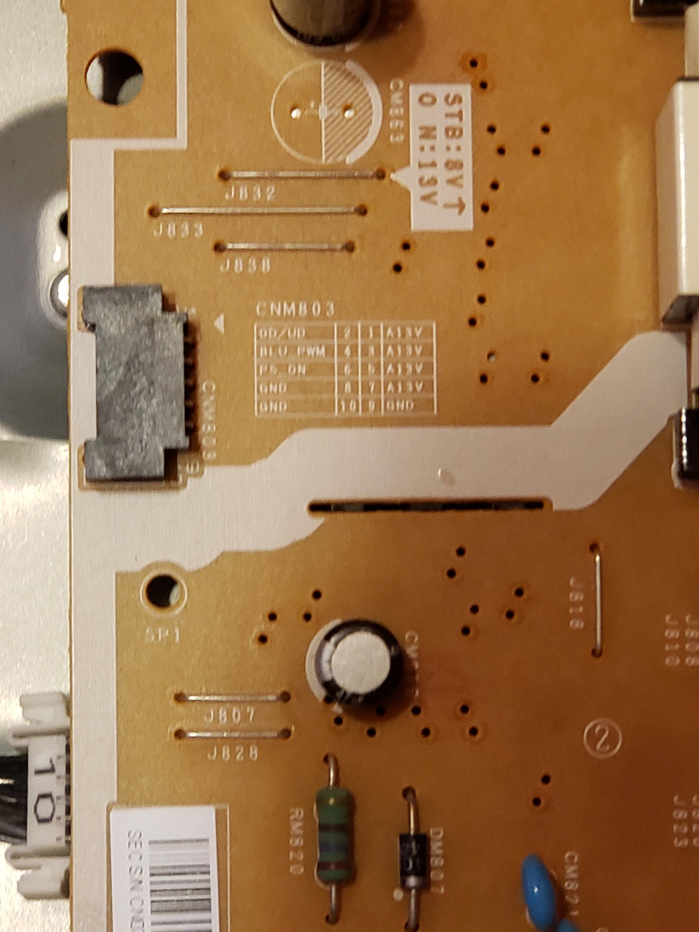

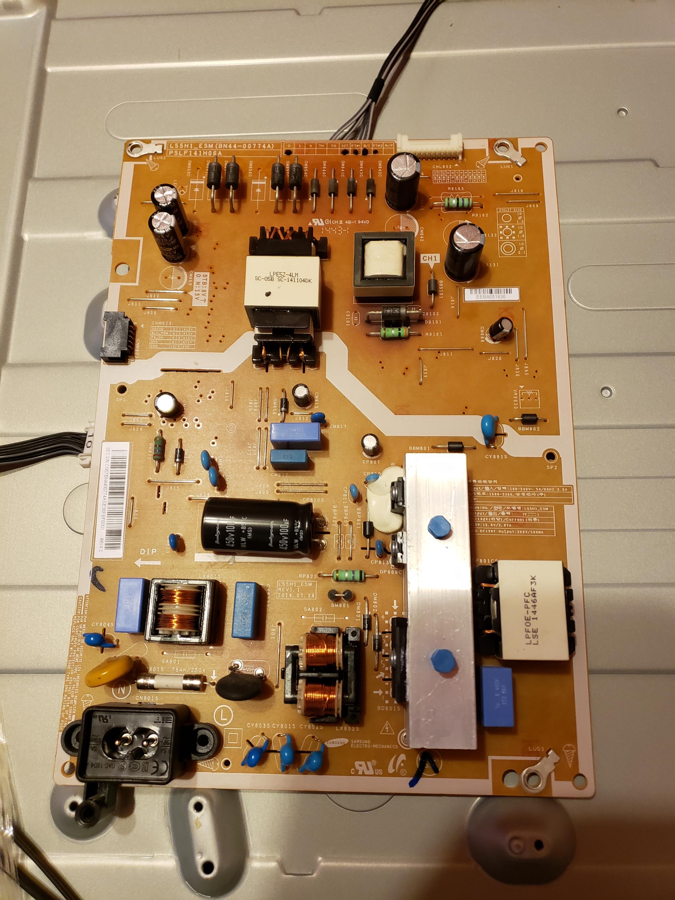

    Hi folks,
    I got this TV dead - backlight was out. Almost 50 LEDs out of 70 were charred - I don't know how it worked till it got to this point.
    Anyway, replaced all bad LEDs, assembled the unit, and it worked beautifully. I navigated menus, lowered Backlight setting and went to grab a bite.. when I came back the TV had turned off, and a burn smell in the room.
    Now, no STB (13 V is now 1.6 V), the large cap has 164 V on it (PFC is not on)
    I'm assuming the standby circuit went out, or whatever generates the 13V? LEDs are not on with the Main board disconnected as you'd normally expect.
    Any help is appreciated. I ordered a new power board - just was curious how bad this board is damaged.
    Thank you

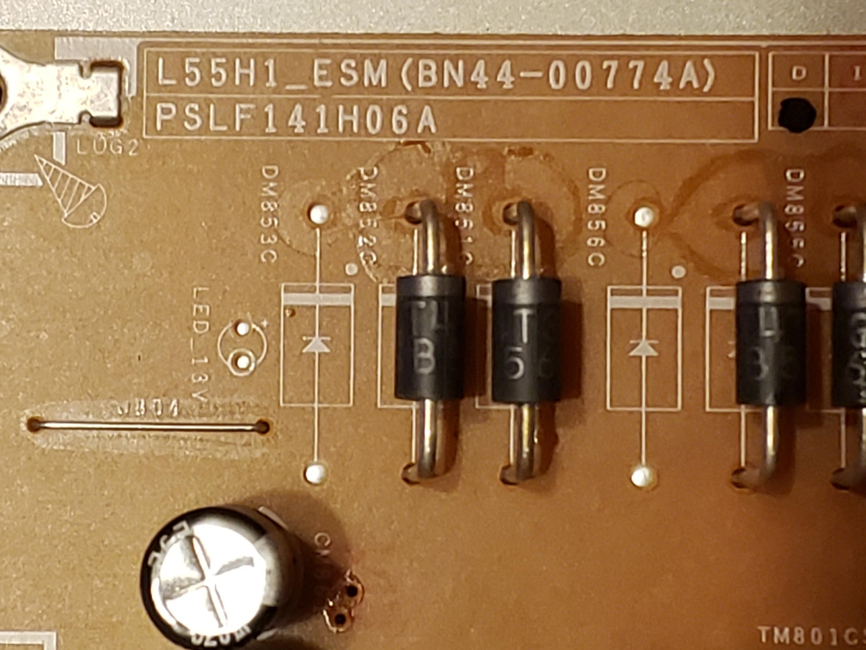

                  • jason123
                    • Oct 2015
                    • 1083
                    Re: Samsung UN55H6203 - Power Supply BN44-00774A
                    DM851, 54, 55 AND 56C are no longer being reported as diodes. The smaller diodes (41 42 43 44c) seem to check out

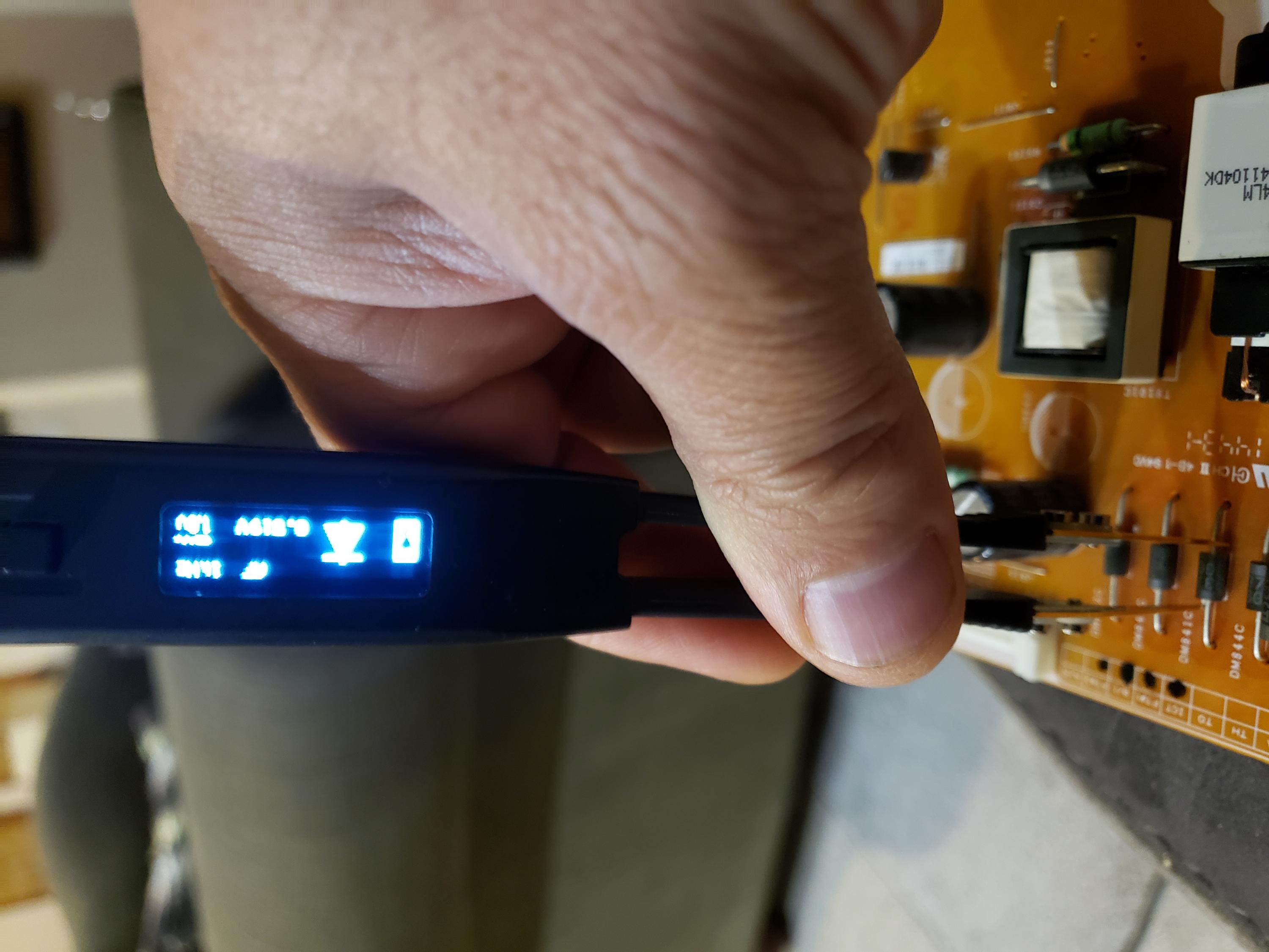

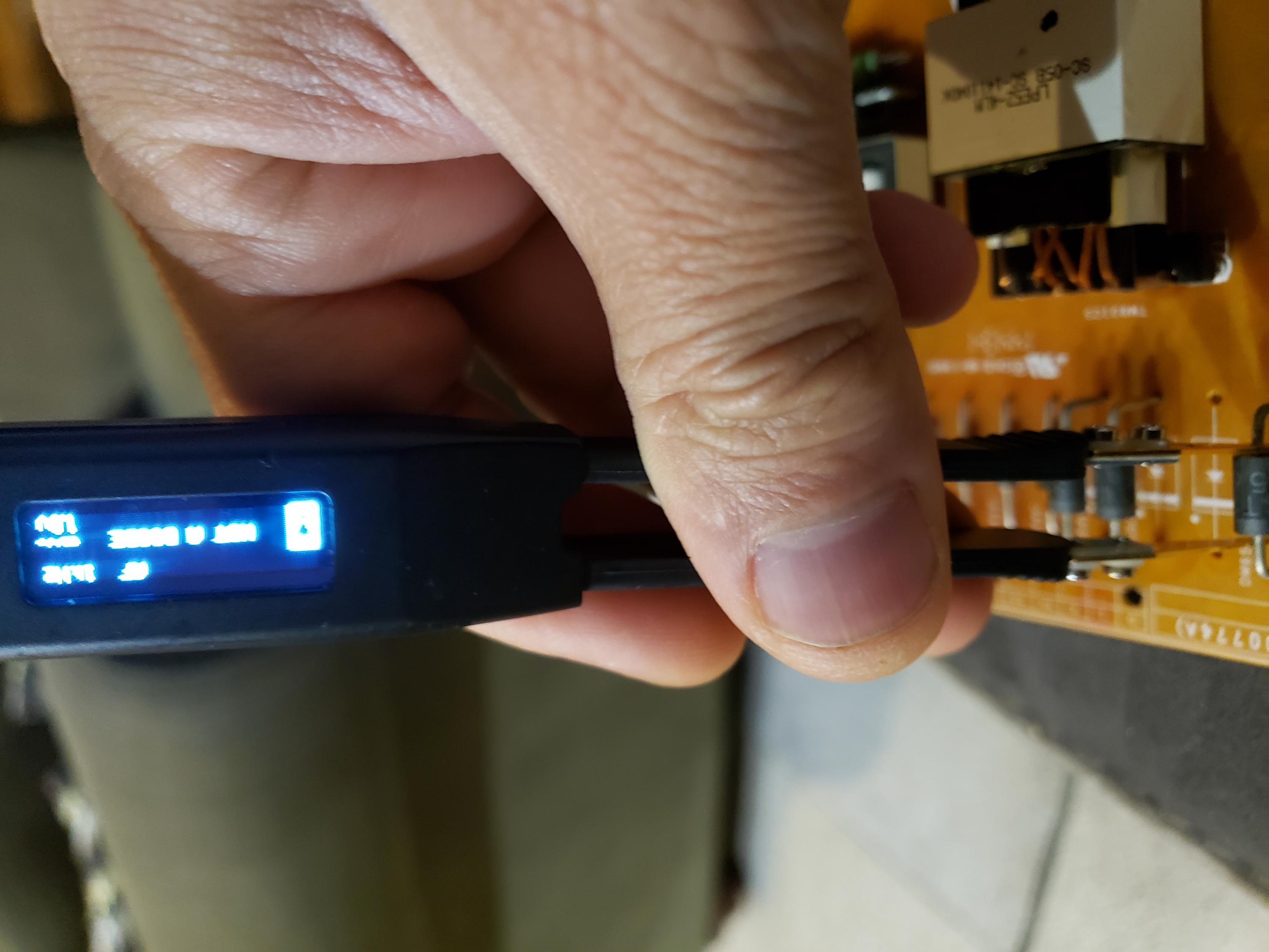

                      • jason123
                        • Oct 2015
                        • 1083
                        I use smart tweezers...in diode test mode...they usually show direction and Vf.... it does on the smaller diodes. The large diodes are reported as not diodes
                        • R_J
                          • Jun 2012
                          • 9588
                          Get a multimeter with diode test and check them, The diodes are likely schottky diodes and that hair plucker does'nt detect them.
                          • jason123
                            • Oct 2015
                            • 1083
                            Hair plucker is a birthday gift from the kids.. have to use it..
                            With my Fluke 87 V, I see all diodes are fine. Schottky (large) are 0.166 V and smaller are 0.465 V Vf.

                              Are you getting any voltage on the +13v like before? (1.6v)
                              Check the voltage across the main primary filter CP810s, is it 160vdc or 385vdc?
                              Check the voltage between J812(hot ground) and DM808 cathode

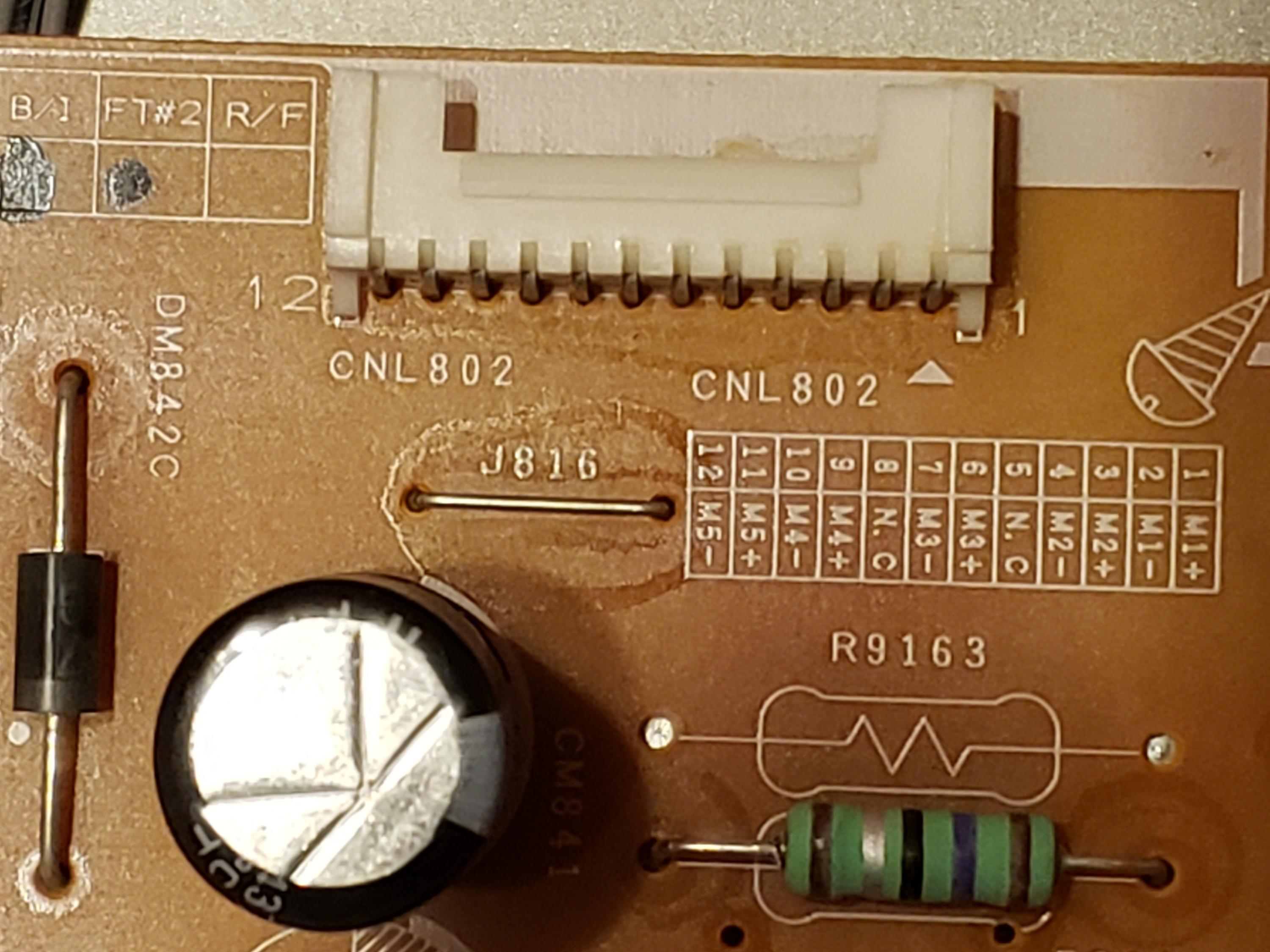

                                    Yes / Maybe? No backlight. On the backlight connector I see >290 V (fluctuates between 276 and 309 V) on M1+ (pin 1) and close to 0V on all the other pins on that connector.
                                    • R_J
                                      • Jun 2012
                                      • 9588
                                      If you are getting 290v on the led connection, you MUST have 13v. So the normal led operating voltage is about 268v The reason you have a higher voltage is due to the led string being open. I suspect another bad led in the string or bad connection during the last repair

                                        I can solder but the waiting game and shipping for parts tends to lead me to replacing full boards. In this case, I can't tell if the Power Supply is bad, or it is just the LED strips. LED Tester will be here in 3 days, but I wonder if I should buy a power supply too.
                                        What is really throwing me off is why am I getting fluctuating volatages of 290v-320v on M1+ when turned on, nothing on M2, M3, M4 or M5. And M1+ is steady at 167v when in standby.
