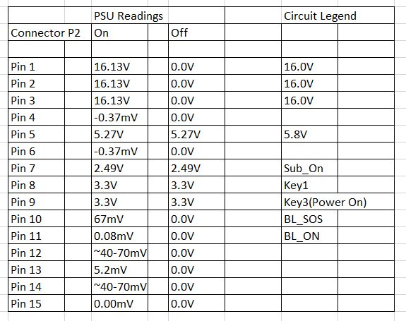

            Re: Panasonic LCD TV: TX-L42ETW5 won't display anything
            So finally I got a multimeter.
            Here are my readings starting from Pin 1 to P2 to 15:
            Power On
            Power Off
            16.13V
            7mV and decreasing
            16.13V
            4.9mV and decreasing
            16.13V
            4.4mV and decreasing
            -0.37mV
            -3.7mV
            5.27V
            5.27V
            -0.37mV
            -3.7mV
            2.49V
            2.49V
            3.3V
            3.3V
            3.3V
            3.3V
            67mV
            67mV
            0.08mV
            0.8mV
            ~40-70mV
            ~40-70mV
            5.2mV
            5.2mV
            ~40-70mV
            ~40-70mV
            0.00mV
            -3.7mV

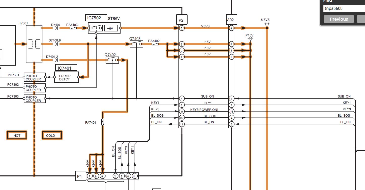

              I found some information on your power supply (page 35) which may be of some use.
              Check for 24V on P4 pins 7,8 and 9
                OK I've checked P4 (1-12):
                Power On
                Power Off
                5.1mV
                0mV
                0.8mV
                0mV
                67mV
                3.28V
                -4,3mV
                0mV
                -4.4mV
                0mV
                -4.3mV
                0mV
                24.7V
                15mV and decreasing
                24.7V
                12mV and decreasing
                24.7V
                10mV and decreasing
                3.3V
                3.3V
                3.3V
                3.3V
                -4.6mV
                0mV
                • dick_barton
                  • Aug 2015
                  • 6643
                  • Wales
                  You have no BL_On signal (P4 pin 2 = backlight on signal) so you need to trace it.
                  Edit
                  It looks like it may well come from IC8000 which is an MN2W50250B, a large BGA device.

                        • dick_barton
                          • Aug 2015
                          • 6643
                          • Wales
                          That's the power supply board only and shows BL_ON link between P2 and P4 so not of any help.
                          Can you find the mainboard schematic TNPH0993 (TXN/A10WNUE). Can't see the number clearly.
