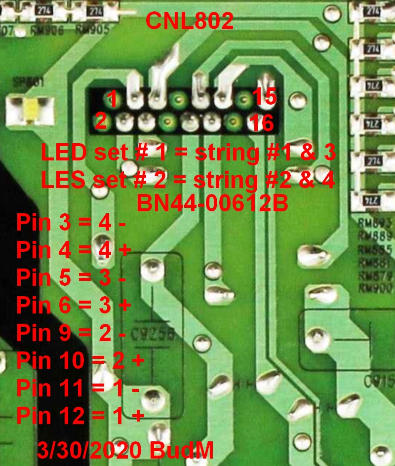

        OK, I trace out the LED connector CNL802 of the BN44-00612B. I think I trace it out correctly this time.
        CNL802 pin out:
        LED string set #1 (consist of LED string # 1 and string # 3 connected in series).
        Pin 12 is 1+ which is the Anode of the LED string #1 which is fed by the LED power supply #1.
        Pin 11 is 1 - which is the Cathode of LED string # 1.
        Pin 6 is 3 + which is the Anode of the LED string #3, it is connected the Pin 11 1 -.
        Pin 5 is 3 - which is the Cathode of the LED string #3, it is connected to the return circuit of the LED driver #1.
        LED string set #2 (consist of LED string # 2 and string # 4 connected in series)
        Pin 10 is 2 + which is the Anode of the LED string #2 which is fed by the LED power supply #2.
        Pin 9 is 2 - which is the Cathode of LED string # 2.
        Pin 4 is 4 + which is the Anode of the LED string #4, it is connected the Pin 9 2 -.
        Pin 3 is 4 - which is the Cathode of the LED string #4, it is connected to the return circuit of the LED driver #2.
        So check the Voltage when TV is turned on each time at
        Pin 12 (1+), Pin 5 (3 -) for LED string set #1.
        Pin 10 (2+), Pin 3 (4 -) for LED string set #2.
        440V reading indicate open circuit in the LED string.

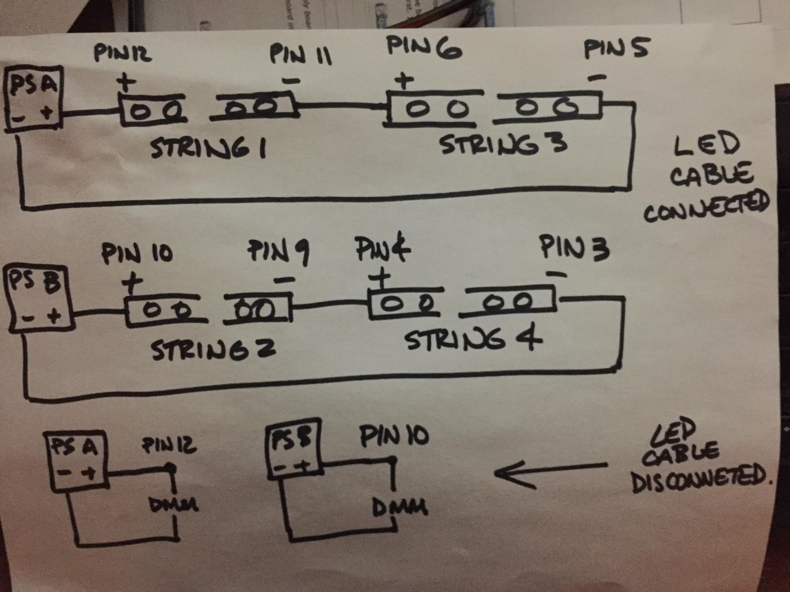

                  OK, still at it. Still confused. Please see my little drawing. That is how I think this is how it works, in my mind. if that is wrong let me know.
                  I took the measurements from the back of the board using the pin locations shown by budm. i don't understand this, but this is what i got. All measurements were taken with black on chassis and red on pins tuning power on each measurement.
                  Pin 12 - jumps up to about 350 V then drops to nothing.
                  Pin 10 - same as 12
                  Pin 5 - jumps to 400 V then climbs to 438V and remains steady.
                  Pin 3 - same as 5.
                  The backlights did fire up once for a few seconds when I was probing the CNL802 connector, but only once. Thanks again.

                          I do not understand your readings, in your picture you show having DMM connected but the LED connector not in place.
                          The reading showing pin 12/10, 5/3 to be the same, are those reading with LED connector in place?
                          I need to see the reading with LED connector in place.
                          My pictures on post 23 is the exact match to your board? Unless my picture does not match your board may explain why the readings do not make any sense.
                          You do have LED tester, correct?

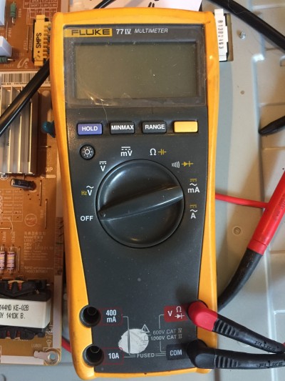

                                        R_J I have enclosed a picture of my meter. Should that be OK?
