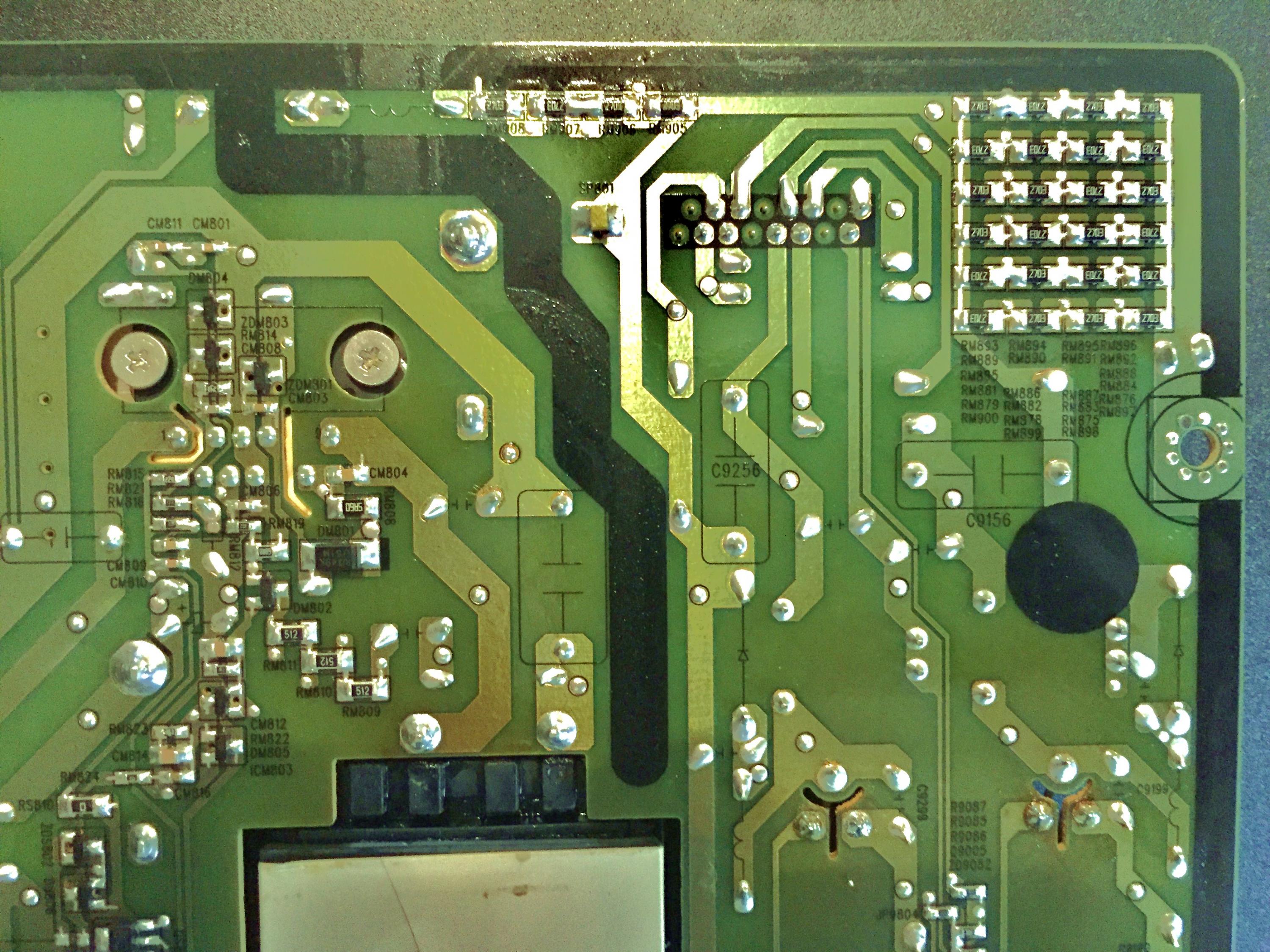

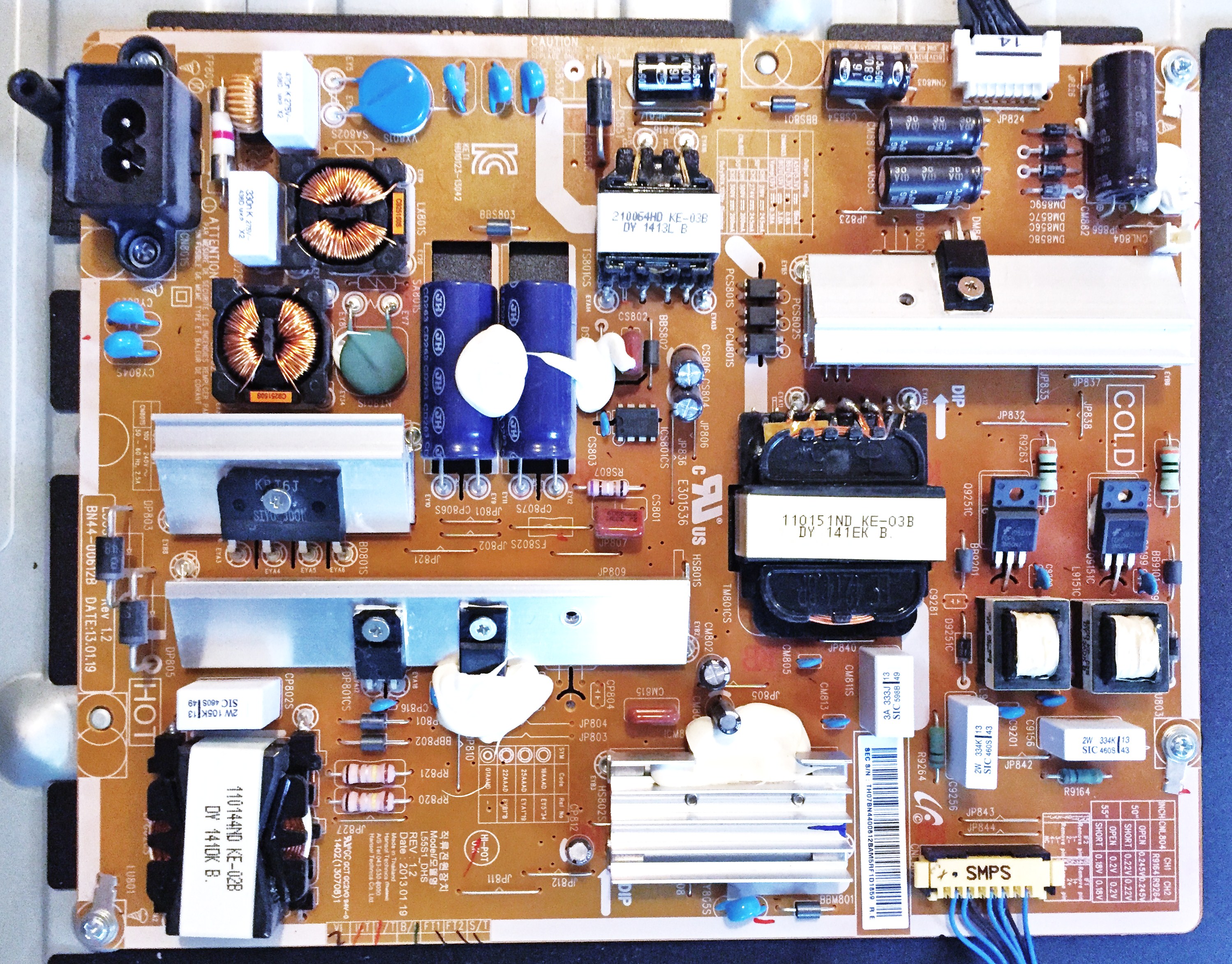

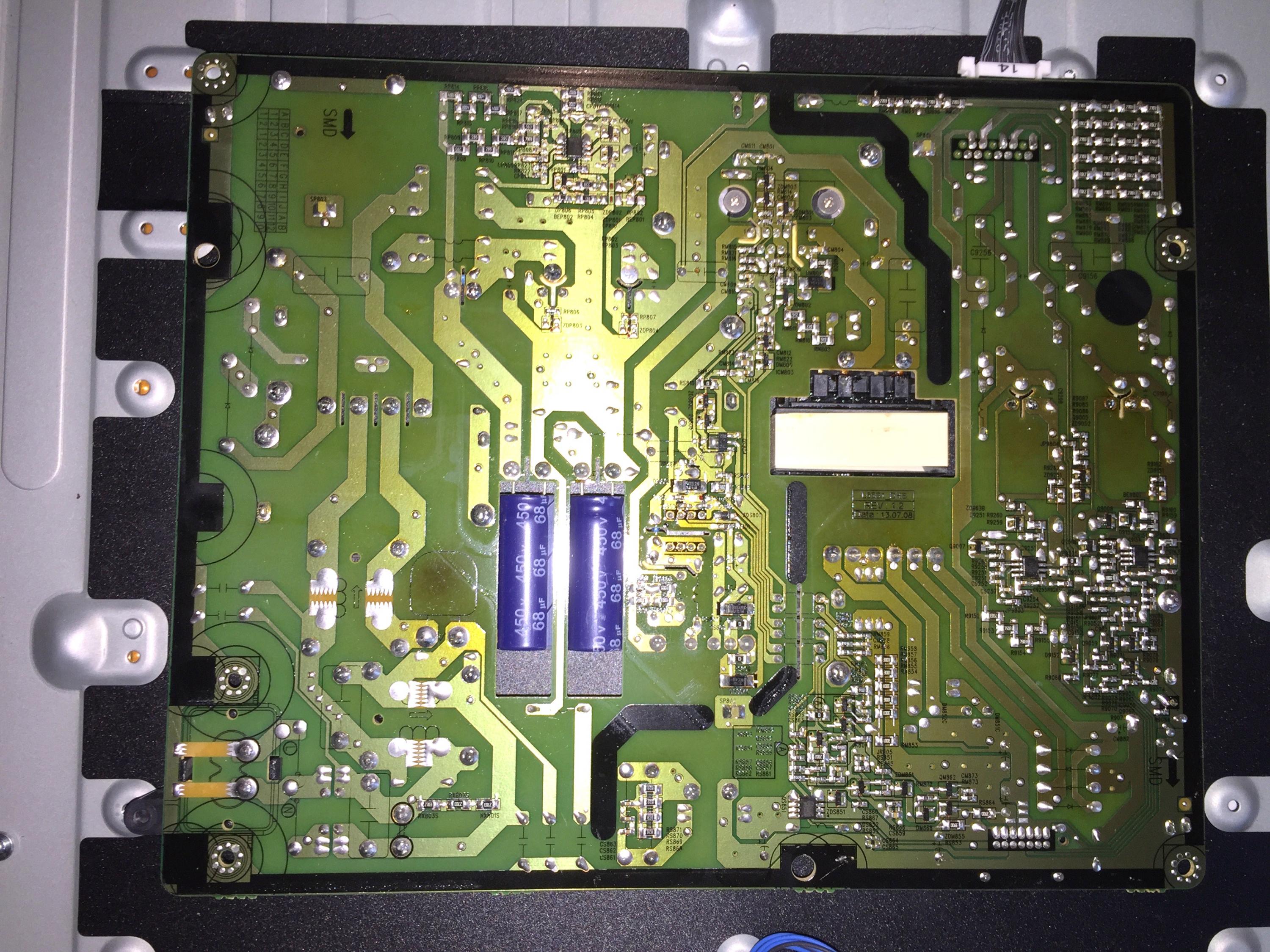

            Hello. My PSU is BN44-00612B and is the Shop-Jimmy board. I have included photos of my board and neilc6 (RJs) schematic.
            Per CapLeaker and noth82's post, I checked the voltages on 1+, 2+, 3+ and 4+ as shown below:
            OFF with LEDs connected
            1+ near 0 VDC
            2+ near 0 VDC
            3+ near 0 VDC
            4+ near 0 VDC
            ON with LEDs connected
            1+ 408 VDC
            2+ .3 VDC
            3+ 440 VDC
            4+ 440 VDC
            OFF with LEDs disconnected
            1+ near 0 VDC
            2+ near 0 VDC
            3+ near 0 VDC
            4+ near 0 VDC
            ON with LEDs disconnected
            1+ near 0 VDC
            2+ near 0 VDC
            3+ 440 VDC
            4+ 440 VDC
            I tried a few times and hope this is accurate and tells you something.

              Re: Samsung UN50F6300AF No Backlights
              Thanks.
              I think you have a open LED in the first string - you see 408V going into CH1+, but nothing on CH2+.
              Do you have an LED tester? If you do, you can confirm the issue is between CH1+ and CH1-.

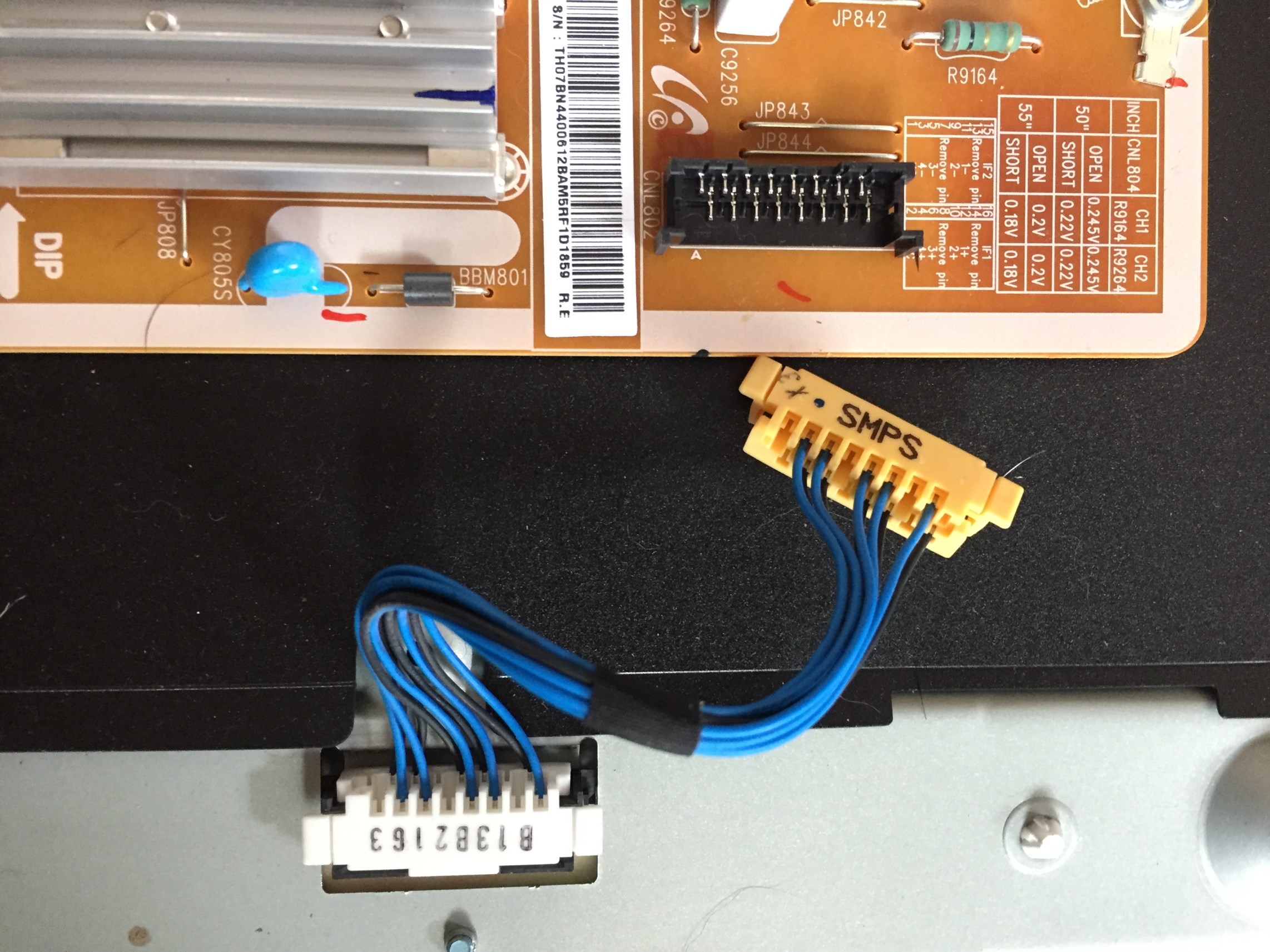

                  The connector has four strings 1+/-, 2+/-, 3+/- and 4+/-... on the power board, 1+/- and 2+/- are combined together as Channel 1... then 3+/- and 4+/- combined together as Channel 2. Look at page 3 of the schematics "DRIVER_POWER_1_A" and "DRIVER_POWER_1_B"
                  The current thought is that the LED strips that are fed in to 1+/- has an open (so it won't light up when tested... and that the LED strips that are fed into 2+/- works (should light up when tested).
                  The strips connected to 3+/- and 4+/- should also work (test to make sure).
                  Look at the PCB markings on the supply board under "output rating" -- It says "CH1 219V @ 245mA" "CH2 274V @ 245mA"
                  There are likely more LEDs on CH2 than CH1.
                  Strip 1+/- and 2+/- should each see no more than ~110V each when working
                  Strip 3+/- and 4+/- should each see no more than ~137V each when working.
                  -Thomas
                    Are you sure you count the pins correctly?
                    You also did not report any (-) pins.
                    Your reports do not look right:
                    1+ 408 VDC
                    2+ .3 VDC
                    3+ 440 VDC
                    4+ 440 VDC
                    1+ near 0 VDC driven by LED power supply A so it cannot be 0V.
                    2+ near 0 VDC
                    3+ 440 VDC
                    4+ 440 VDC this not right either.

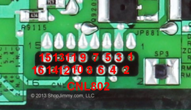

                    According to the schematic, the LED connector pin out:
                    LED strings 1 and 2 are connected in series to form one large string driven by LED power supply A
                    Pin 12 (1+ Anode of string #1) is connected to the LED power supply A output.
                    Pin 11 (1- which is Cathode of string #1) is connected to Pin 10 (2+ which is the Anode of string #2).
                    Pin 9 (2- which is the Cathode of string #2) is connected to return circuit for LED power supply A.
                    LED strings 3 and 4 are connected in series to form one large string driven by LED power supply B
                    Pin 6 (3+ Anode of string #3) is connected to the LED power supply B output.
                    Pin 5 (3- which is Cathode of string #3) is connected to Pin 4 (4+ which is the Anode of string #4).
                    Pin 3 (4- which is the Cathode of string #4) is connected to return circuit for LED power supply B.

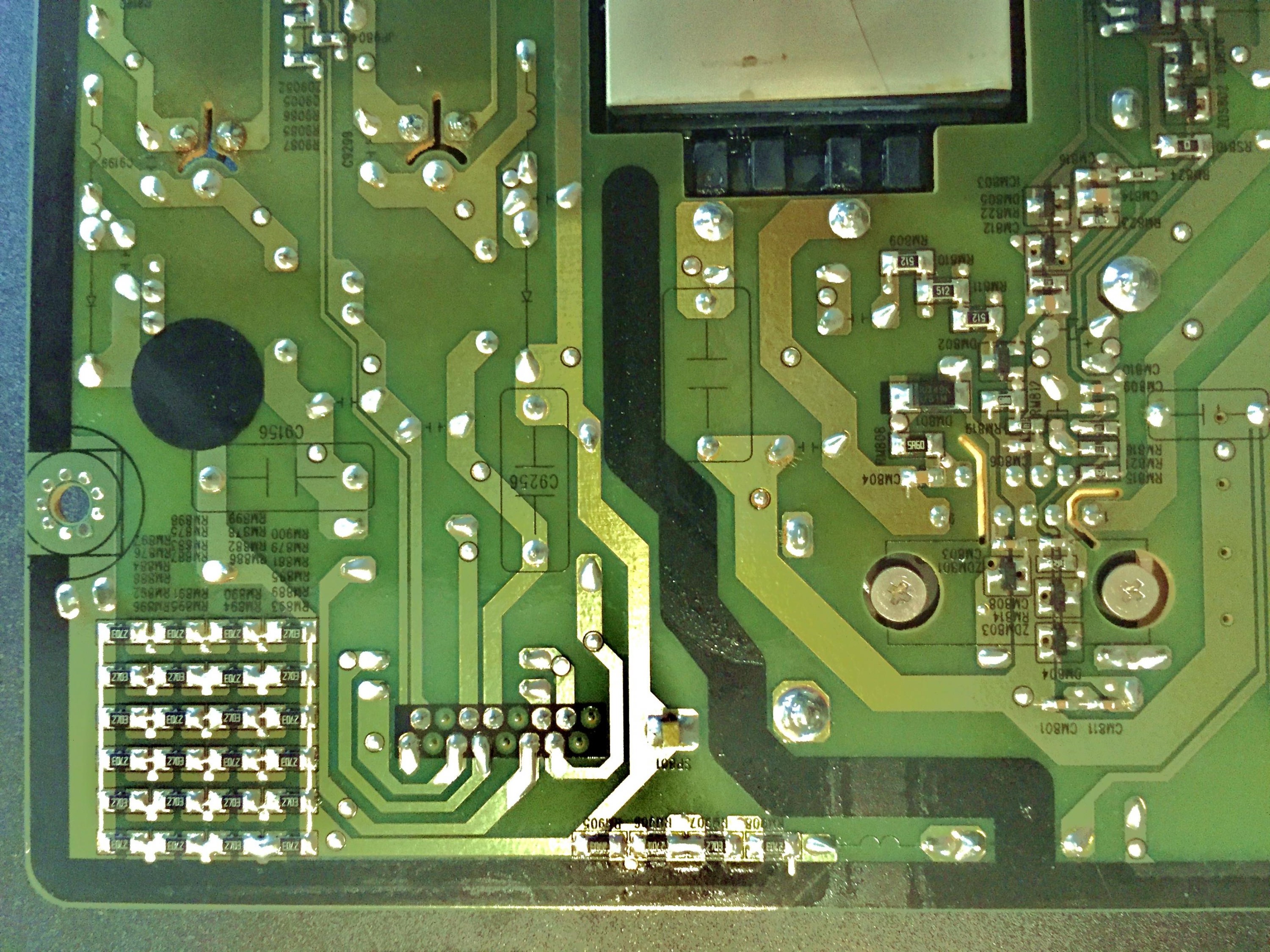

                          Pictures provided by SHOPJIMMY.
                          What is the resistance between Pin 4 (4 +) and Pin 5 (3-)?
                          Your meter probes resistance is 2.4 Ohms?
                          • MEB
                            • Sep 2013
                            • 371
                            OK, from the back of the board as shown, resistance between pins 4 and 5 is 0 ohms. From the back also, the resistance between pins 4 and 6 is 2.4 ohms. This is with nothing connected to the board. Note: my board and SJ photo are not the same as far as traces and components.
